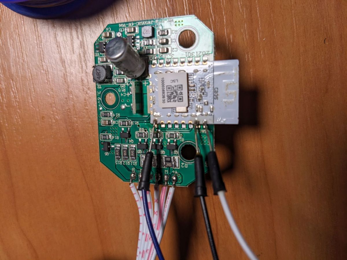

    This is an egg shaped 10 euro R-G-B-CC-CW 'moodlight' that can be found in Action stores in te Netherlands. There is no power supply included, it requires a USB power supply to function.
    The device consists of a top and a bottom shell, the main pcb with pushbutton and usb-c connector is screwed into the bottom half and the board with 3 phillips screws and the board with the LEDs is snapped with plastic clips in the top half. Nothing is glued, its all just snapped together.
    Opening the device up is fairly straightforward just squeeze it hard right on the seam where the two halves meet. A wood clamp will make short work of this. Both PCBs are far enough away from the center of the device that squeezing it hard will not damage anything and the housing is sturdy enough to jump right back into shape even after opening it multiple times.

    As you can see in the second picture there's little notches that you have to line up when you are snapping it back together.
    High-res pics of the board

    Solder point for flashing are as follows;
    LSC Smart connect Smart LED MOOD LIGHT 970743 teardown
    Rx and Tx as marked, brown is ground and orange is 3.3V. The orange/white wire is 'cen'.
    Flash like any other BK7231N and use the following configuration;

    Just please remember, do not power device from mains when flashing, many power supplies do not provide isolation from mains and there may be live potential on even the ground lane! It's better to power from USB or other safe power supply.
  • #6 20803697
    lewandek
    Posts: 35
    Yes - of course - but to be honest it wasn't connected to anything else than those 3 wires, visible on photo. I've flashed 3 units that way - don't know if it's a magic or just a science :)
  • #7 20803884
    Posts: 14622
    Help: 655
    Rate: 12638
    I think you can find explanation here: https://www.elektroda.pl/rtvforum/topic3977874.html
    There is a tiny current flow through protection diodes that sometimes may be enough to power the device.

    Today New Version Found
    Chip is WB3S
    Cloudcutter profil : 970743 1.1.16
    Pin Profil:
    P6 - PWM - 4
    P8 - PWM - 3
    P9 - PWM - 0
    P14 - Btn - 0
    P24 - PWM - 1
    P26 - PWM -2
