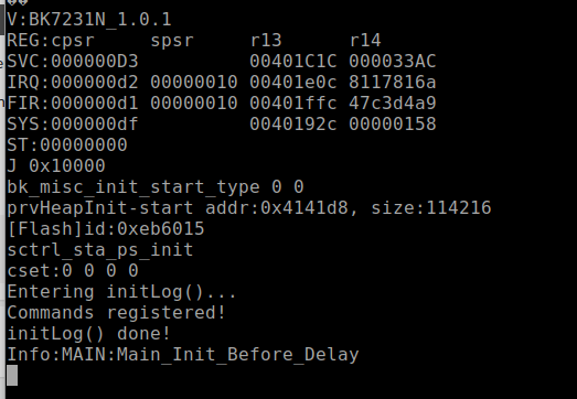

    So after a lot of test with the deep sleep method..... seems like the BK don't like it on startup script ..... i think it missed some verification. Somewhere.
    but anyway after a lot of test i have completely crashed my BK. i doesn't want to come back to life even after an uart flash....... so 1 down. i need to flash another one to continue testing but it will take some other time.
  • Safe mode boot after repeated short uptimes
    #38 20395797
    Posts: 14767
    Rate: 12909
    @dheenhasty first of all, do you know that device will boot into safe mode if it was up for less than 30 seconds for 5 times?
    You can change that behaviour in the settings. This can be used to recover device if startup script breaks something.
    How do you know that your bk is crashed? Maybe you need to wait for capacitors to discharge, I had something like that few times when testing deep sleep.
    Do you get a correct results while flashing via uart? If so, then bk is not dead...

    #39 20396099
    dheenhasty
    Posts: 111
    Rate: 17
    Yeap i bring back it online with uart flashing the original firmware and back to OpenB with uart. i suspect a corruption on littlefs side that prevented the firmware to boot up .......
    and another thing, the sensor original firmware have been update, so now cloudcutter doesn't work anymore ...... i will extract the new firmware and upload the new profile on git.
    But anyway, device up and running again, so i can continue my testing :)

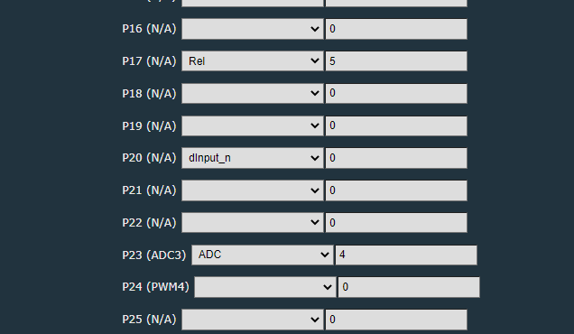

    Battery_measure :
    It will calculate and publish voltage and battery percentage base on min battery and max battery in args.
    The calculation is based on Tuya SDK ( /4096 * 2400 ) of ADC (done some check and seems like the volt is align with physical check :).
    IOR_ADC must be assigned
    mqtt topic => voltage and battery
    Ex : Battery_measure 1500 3000 // will give you the percentage of battery based on this 2 value.

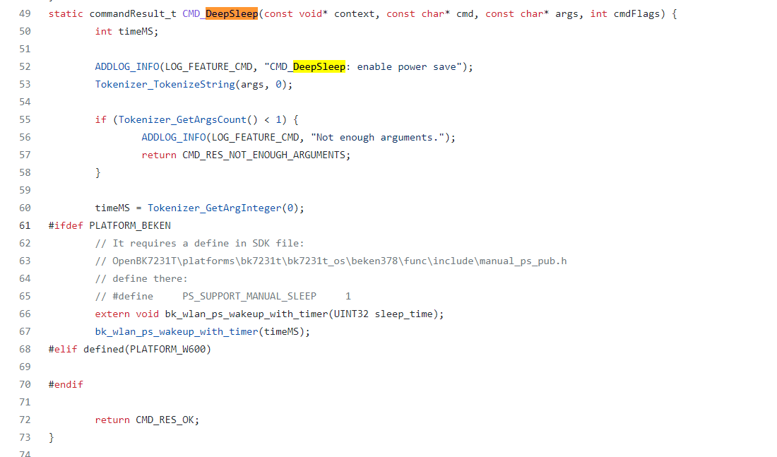

    @p.kaczmarek2 , i just found something weird and could explain a lot of issue. seems like the script don't take in account some of system void.
    Here's an example i have done modification on DeepSleep command to avoir boot loop. (i was suspecting that the system execute the script before the boot complete)
    static commandResult_t CMD_DeepSleep(const void* context, const char* cmd, const char* args, int cmdFlags) {
    int timeMS, WaitTime;
    ADDLOG_INFO(LOG_FEATURE_CMD, "CMD_DeepSleep: enable power save");
    Tokenizer_TokenizeString(args, 0);
    if (Tokenizer_GetArgsCount() < 2) {
    ADDLOG_INFO(LOG_FEATURE_CMD, "CMD_DeepSleep : Not enough arguments.( SleepTime , WaitTime)");
    return CMD_RES_NOT_ENOUGH_ARGUMENTS;
    timeMS = Tokenizer_GetArgInteger(0);
    WaitTime = Tokenizer_GetArgInteger(1);
    #ifdef PLATFORM_BEKEN
    // It requires a define in SDK file:
    // OpenBK7231T\platforms\bk7231t\bk7231t_os\beken378\func\include\manual_ps_pub.h
    // define there:
    // #define PS_SUPPORT_MANUAL_SLEEP 1
    extern void bk_wlan_ps_wakeup_with_timer(UINT32 sleep_time);
    ADDLOG_INFO(LOG_FEATURE_CMD, "CMD_DeepSleep : wait 120 Seconds to prevent bootloop");
    rtos_delay_milliseconds(WaitTime * 1000);
    ADDLOG_INFO(LOG_FEATURE_CMD, "CMD_DeepSleep : Go to sleep");
    rtos_delay_milliseconds(1000);
    bk_wlan_ps_wakeup_with_timer(timeMS);
    #elif defined(PLATFORM_W600)
    #endif
    return CMD_RES_OK;
    So when i execute it thru webapps command line, it works flawlessly. but when i execute it thru script. it jump directly to the deep sleep.
    any idea on what happens ?
    Another point i have done some comparaison between T and N regarding the deep sleep. seems like the deep sleep lib en N is more elaborate than on T..... i don't think it's an issue with the support the BK is really similar, and freertos is the same. but seems like the sys_ctrl lib and the manual_ps is clearly not the same. and modification is really deep .....
    I while dive a little bit more on the T one to find why it's not working. but i don't have any T device .... so i rely on you to test :)[/quote]
  • Deep sleep may be retriggered repeatedly
    #42 20399261
    Posts: 14767
    Rate: 12909
    Very good job @dheenhasty . I apologize for being silent for about a day but I worked on BL602 OTA and it was a real mess to solve. At least, it works now, BL602 platform finally has OTA, after all these months...
    Okey, back to Beken - my first guess would be a stack size. Maybe call is too nested and you run out of the stack?
    Another thing.... do I see correctly, are you trying to do a 1000ms delay?
    The script is executed from 25 ms (or so, I don't remember now) timer, trying to wait 1000ms there will have unexpected results.
    The web app commands, on the other hand, are handled from the TCP server which creates a thread per each client, so it can wait 1000ms....
    Maybe that's the cause of your problem?
    I can help testing, I have spare WB2S devices, you can look at this topic, I've did a little showcase there:
    https://www.elektroda.com/rtvforum/topic3951016.html
    I haven't yet experienced any issues with deep sleep, but I didn't test it much on N, and on T, as you know, it's just not working yet.
    EDIT: Maybe the root cause of your problems is that you call deep sleep several times? Maybe you can remove the delay and add a guard like that:
    static int bDeepSleeppStarted = 0;
    if(bDeepSleepStarted)
    return;
    bDeepSleepStarted = 1;

    ADDLOG_INFO(LOG_FEATURE_CMD, "CMD_DeepSleep : Deep Sleep cannot be launch at start");
    return CMD_RES_OK;
    main concern here is to avoid bootloop.

    I think I can see what's wrong. You have a wrong base assumption.
    dheenhasty wrote:
    again:
    echo "activate startDriver sht3x"
    startDriver SHT3X
    echo "DeepSleep"
    DeepSleep 300
    stopDriver SHT3X
    echo "looping"
    goto again
    This will NEVER work, because, as far as I know, "DeepSleep" command will purge all RAM content. This will just turn off the device. Anything below "DeepSleep 300" will NOT get executed. By design, never.
    This is because "DeepSleep" basically means "turn off whole device and reboot from 0 after N seconds".

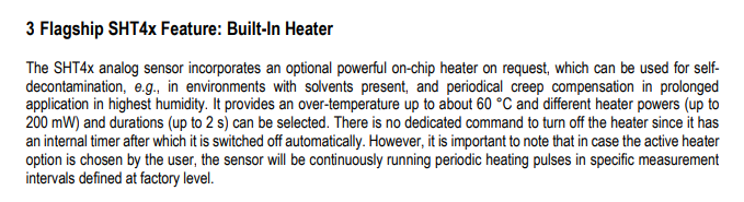

    Nice, but what is SHT3X_Heater ?
    Futhermore, what is the application of doing less samples (single measure etc)? It's not like that can save much energy.
  • Heater purpose and SHT3x capture mode notes
    #53 20400283
    dheenhasty
    Posts: 111
    Rate: 17
    Based on datasheet who is really complete.
    The heater is here for external purpose i think.
    cause it heat it ... pretty quick.
    For the capture method i don't have seen a difference, between them except that
    the one shot require a 15ms delay before reading.
    The periodical one store the last value so the fetching is pretty stray forward. And i suppose a prereq for alerting.
    i will try to work on alerting, it's really interresting, cause it permit the sensor to pull up a gpio and so leave the deepsleep too.
    https://sensirion.com/resource/application_no...TYQFnoECBUQAQ&usg=AOvVaw1QIoqDKNLpI6IpPoVJmTw
    I understand that you can find thar a little bit overkill :)
    We might need an expert on sensor to understand all that :)

    The heater you mentioned is described here (I first confused it with an external heater control):
    [BK7231N CBU] Generic Temperature and Humidity Sensor
    Still, I will note that any advanced control logic of, well, for example, external heater (by relay) with the temperature sensor should be done on channels level (outside the driver):
    The correct approach would be:
    1. make your sensor save the value to given channel (as it already does), just like any other sensors
    2. then you make a change handler for the channel:
    addChangeHandler Channel0 < 50 echo value is low
    3. in change handlers you can enable and disable heaters
    If you want a true PID, then we could also think of something else, maybe in a form of generic driver that can be linked to channels.
    The idea is to keep the generic stuff shared and channel-based so it will work also if we swap sensor to TC74, etc.

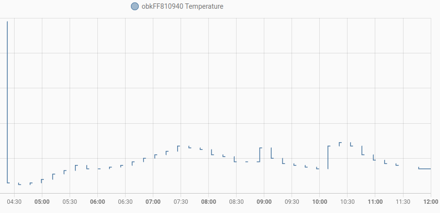

    Ok after one night run, i can annonce 2 good news.
    Battery seems ok no major drain :)
    And captor doesn't need the calibrate after 4 or 5 deep sleep temperature is pretty align with environment. (I suppose the 3 or 4 degrees issue is the heat dissipation of the bk or the regulator thru the board)

    Last pin config has been update in the repository so you should be able to use the automatic config from the webapp.
    "pins": {
    "7": "SHT3X_SCK;0",
    "8": "SHT3X_SDA;2;3",
    "17": "Rel;5",
    "20": "dInput_n;0",
    "23": "ADC;4",
    "26": "LED;1"
    You can change the LED to WifiLed if you prefer (it permit to verify that the device is correctly getting out of DeepSleep
    and then do as me forget to change battery...... and dead so need to be reflash .... (i'm really wondering if on battery low the littlefs does not corrupt itself .....
    So it works, but it's not really really stable. it clearly need more work.

    here's another exemple of corruption after going below 2V of battery ....
    initLog()done!
    undefinedinstruction
    Currentregs:
    r00:0xddbc00e2r01:0x00000000r02:0x005ddc12r03:0x00000052
    r04:0x005ddbc0r05:0xffbf5877r06:0x003ff1c6r07:0xddbc0000
    r08:0x08080808r09:0x09090909r10:0x10101010
    fp:0x11111111ip:0xffe377f0
    sp:0x004055c8lr:0x0080006epc:0x0080006e
    SPSR:0x800000ff
    CPSR:0x800000db
    separateregs:
    SYS:cpsrr8-r14

  • Deep sleep battery drain may corrupt config
    #60 20408243
    Posts: 14767
    Rate: 12909
    Thanks for posting the configuration.
    dheenhasty wrote:
    @p.kaczmarek2 Another thing regarding the Deep Sleep and the battery ..... i really think there is a corruption issue after batterie low and deep sleep seems like the device is frozen on Init_Before_Delay :
    i you have any hints to test before a do a Flash with uart method (seems like it's the only way to revive sensor) seems like the cfg is corrupted somehow ......
    Can you (in the future) provide a full 2MB dump for this issue? We could use it to investigate more.
