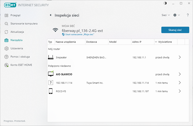

  • Sensor only sees repeater and computer
    #336 21365482
    SawekSenior
    Posts: 17
    Network inspection only shows:
    Strepeater
    and my computer
    Added after 4 [minutes]:
    The sensor was connected to a network amplifier that had a different ssid than the router it was amplifying, now I have moved the sensor closer to the router , but it no longer wants to connect to it and the amplifier already has a weak signal.
    Added after 25 [minutes]: .
    When I pair it with an "old router" - I mean amplifier, it's like this Screenshot from ESET Internet Security tool showing network inspection.

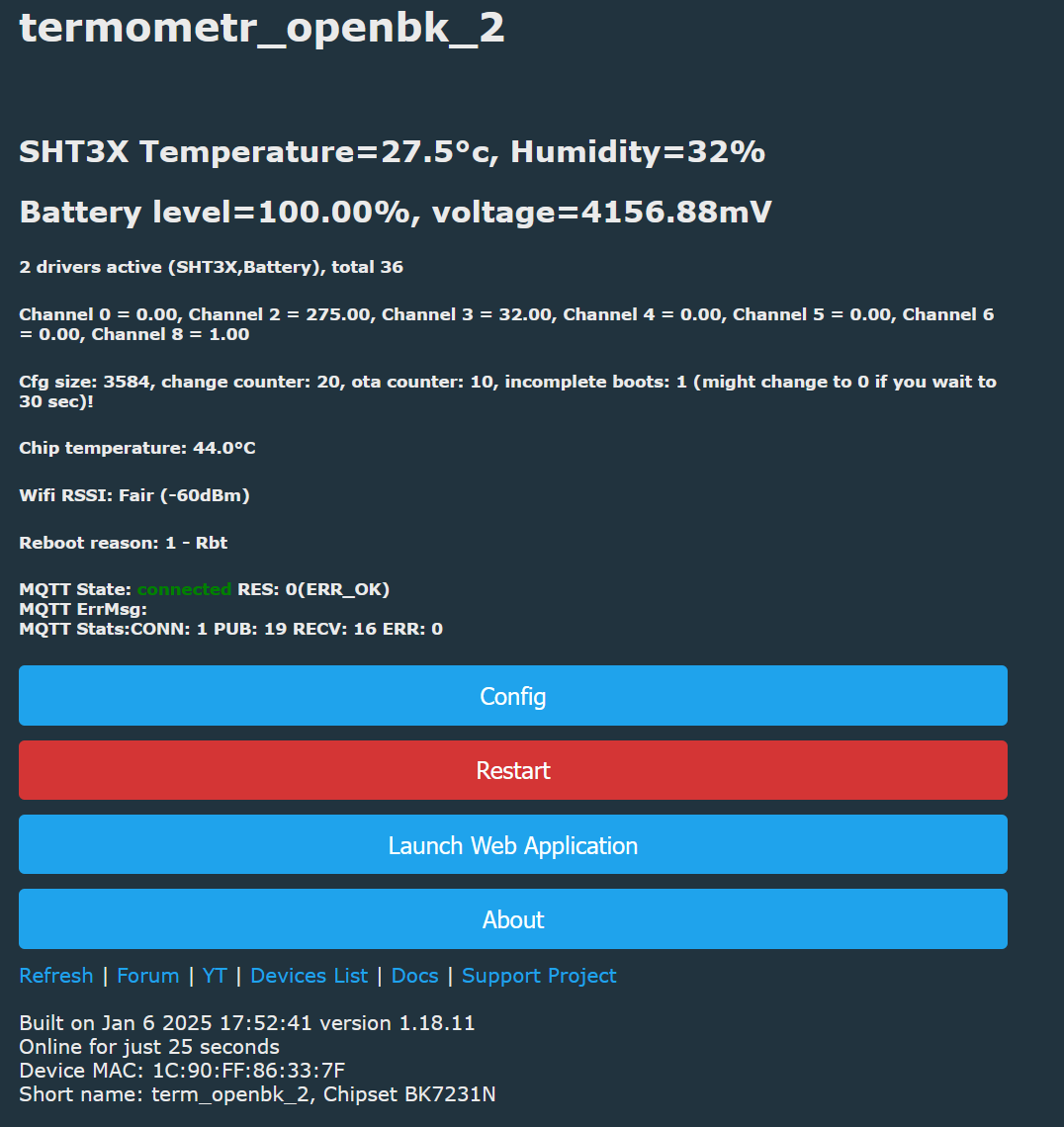

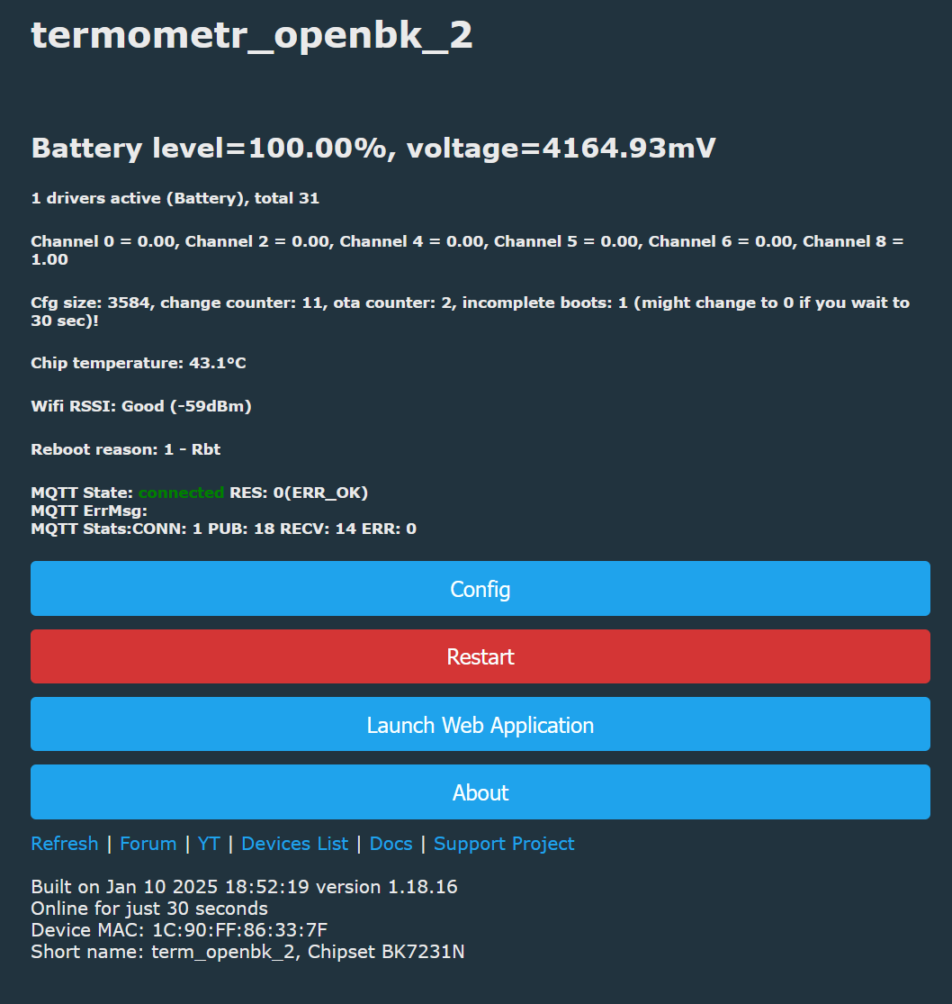

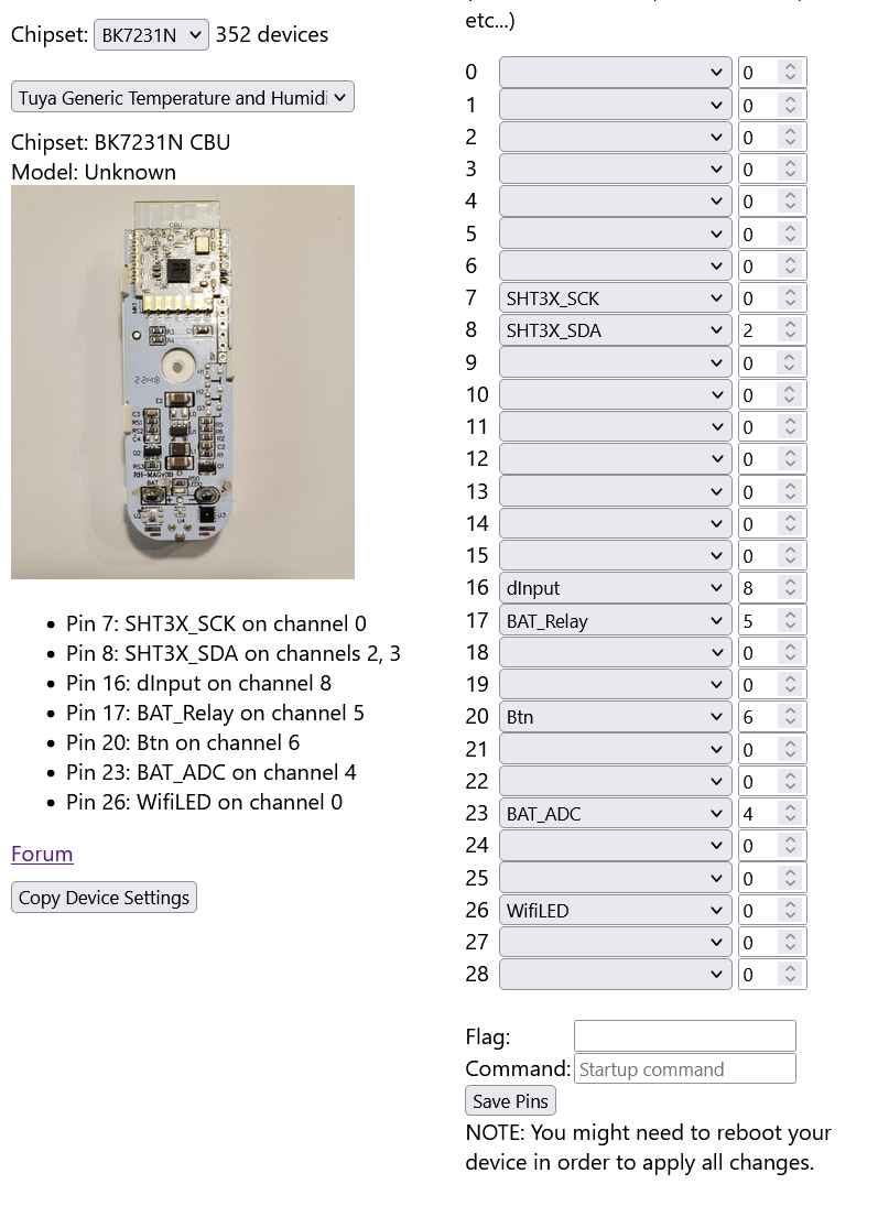

  • OpenBK 1.18.12 breaks SHT30 sensor support
    #338 21389134
    @GUTEK@
    Posts: 1561
    Help: 163
    Rate: 368
    There is a problem with the new version of OpenBK. As usual when replacing the battery I updated the module to a new fw version, currently it is 1.18.19 and after this update my SHT30 is not working. It doesn't show up on the home page and I have values of 0. I didn't change anything else after the update, the pin configuration is correct, just to be sure, once again I selected this thermometer model in the WebApp from the list and saved the settings.
    By downgrading the software version I discovered that the problem started with version 1.18.12, the earlier 1.18.11 works fine.
    Screenshot of BK7231N module settings and electronics board view. .
    Screenshot of the OpenBK thermometer interface showing SHT3X parameters and device status. .
    Screenshot of the termometr_openbk_2 interface showing battery settings and connection status. .
  • #339 21389176
    Posts: 14767
    Rate: 12909
    As far as I can see SHT30 has recently been disabled in the official builds, but no problem, I can restore it today.
    It's just that with the addition of drivers we have a growing problem with flash memory and it's looking more and more likely that we'll have to have separate binaries, e.g. one for sensors and one for power measurement.

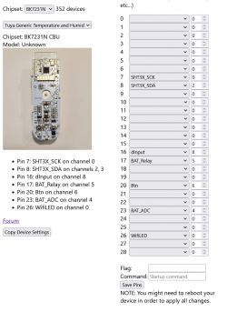

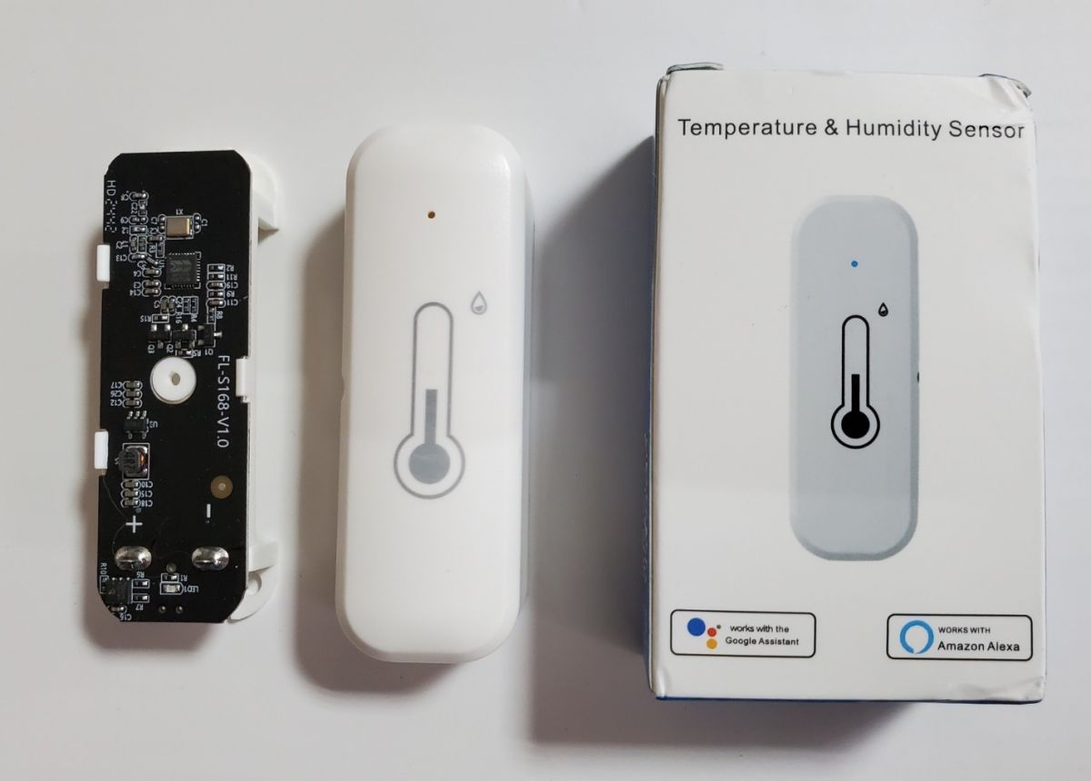

  • Working BK7231N CBU config with CHT8315 and deep sleep
    #344 21392543
    sns1
    Posts: 12
    >>21390738
    Finally seems to be working ok.
    Here's a picture of the device (BK7321N + CHT8315):
    Temperature and humidity sensor device and its packaging.
    Here's config and autoexec
    Spoiler:
    pins
     "pins": {
        "7": "CHT83XX_SCK;0",
        "8": "CHT83XX_SDA;2",
        "16": "dInput;8",
        "17": "BAT_Relay;5",
        "20": "Btn;6",
        "23": "BAT_ADC;4",
        "26": "WifiLED;0"
    autoexec
    PowerSave 1
    startDriver NTP
    startDriver Battery
    startDriver CHT83XX
    addEventHandler OnHold 20 SafeMode
    addEventHandler OnClick 20 delay_s 600
    DSEdge 0
    waitFor WiFiState 4
    Battery_Setup 2500 3200 2.29 2400 4096
    battery_measure
    publishAll
    delay_s 10
    PinDeepSleep 900
    Device seems to be working ok and measurements seems to be valid. I've noticed while testing thath CHT sensor is prone to heating itself as if it works continuously it shows higher temp (might be not exactly CHT problem but whole pcb heating, but anyway), so, if on DeepSleep - it shows realistic values.
    Another quirk I didn't manage to work out - how to make it, say, wait a minute on button press before going to sleep - for reconfig/flashing procedure if such is needed. Autoexec line for delay does not work as expected...

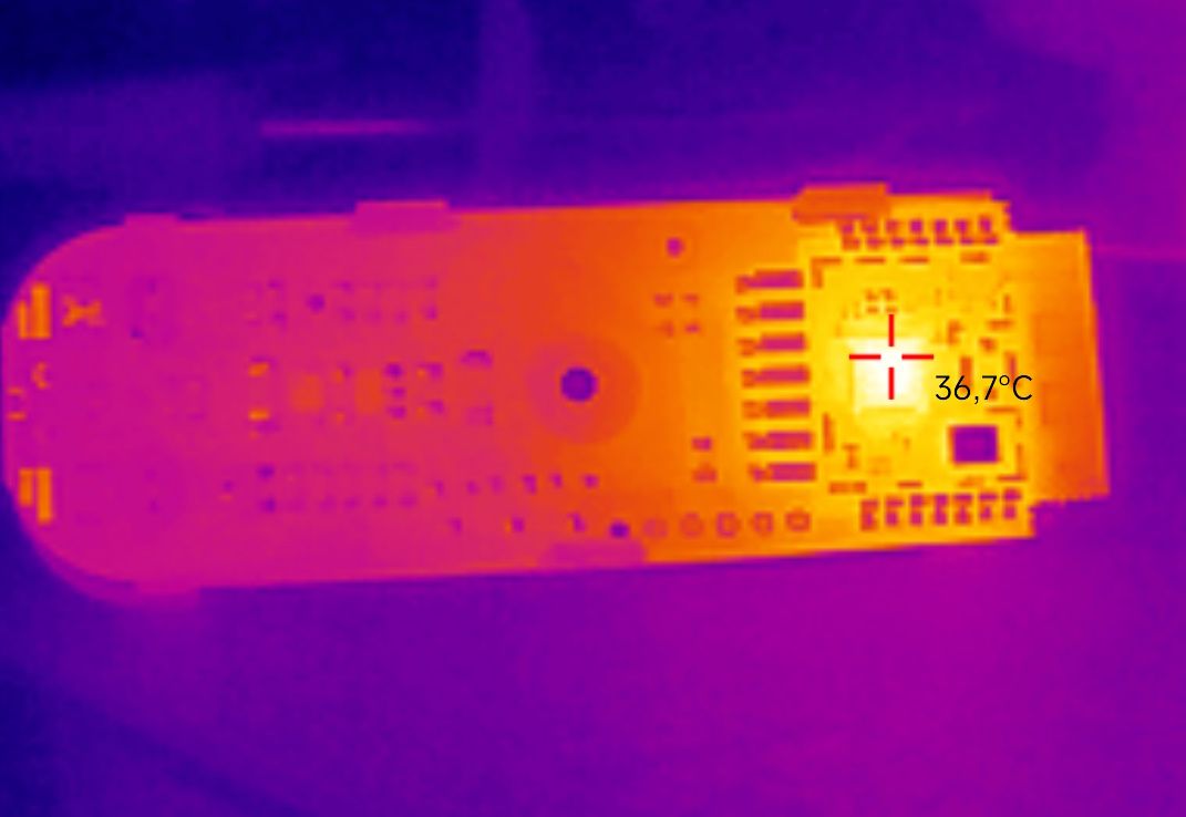

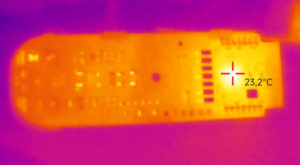

  • Beken chip self-heating skews temperature readings
    #345 21392637
    @GUTEK@
    Posts: 1561
    Help: 163
    Rate: 368
    It is rather the Beken chip itself that heats up and this heats up the whole board. I have the same thing with the thermometer from the topic on the SHT30. Fortunately, putting it to sleep and waking it up for a while does not affect the falsification of the reading by heating.
    As for the configuration changes, I have dealt with it in a different way. It is a bit tedious, but it is also not done often.
    While holding down the reset button, I insert the battery. Then the software starts in safemode. I go into configuration and command execution and execute lfs_format. This deletes the autoexec, then I click exit safemode and restart. Then the firmware boots normally and you can poke around.
    By the way, I have such entries in autoexec as in this topic: https://www.elektroda.pl/rtvforum/topic4025593.html

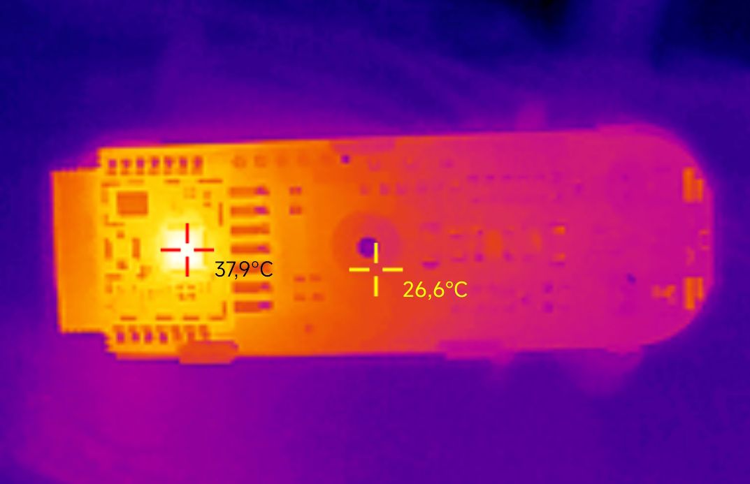

    With safemode running in hotspot mode, you can connect from your phone and go to the 192.168.4.1 configuration page and run the command.
    Such a curiosity, I checked what is heating up, the sensor itself is cold, the heat goes from the Beken chip:
    Thermal image of an electronic circuit with two temperature readings. .
  • #348 21393091
    Posts: 14767
    Rate: 12909
    And can you compare PowerSave 1 and without?

    @GUTEK@
    Posts: 1561
    Help: 163
    Rate: 368
    Here's the thing:
    - measurements after 5min of operation
    without PowerSave:
    Thermal image showing an electronic board with a marked temperature of 36.7°C. .
    with PowerSave 1 in the autostart:
    Thermal image of an electronic board with a marked temperature of 23.2°C. .
