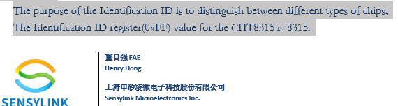

    @insmod

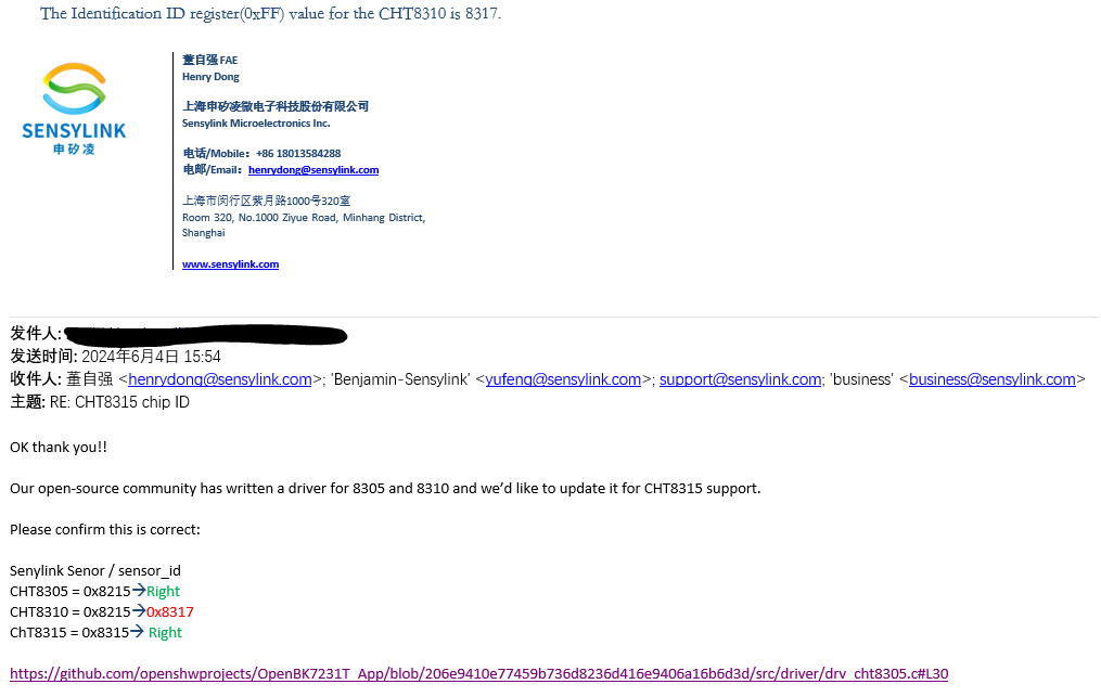

    Document excerpt about chip identification with Sensylink logo.
    The purpose of the Identification ID is to distinguish between different types of chips;
    The Identification ID register(0xFF) value for the CHT8315 is 8315.

    @insmod @artin961
    fearing I was not verbose enough in my original query, here is an update with corrected IDs
    Screenshot of an email about Sensylink's CHT8315 sensor support.
    and so

    Interesting, but didn't someone else here stated that some sensors have multiple IDs? Or was it incorrect?

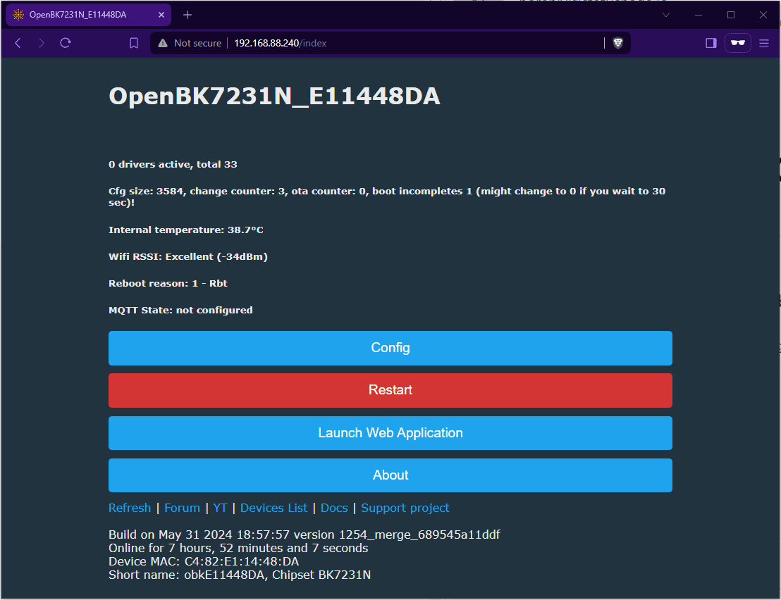

    OpenBK7231N control panel with diagnostic information.
  • #312 21108522
    pipelkrsk
    >>21107220
    Thanks, it's working. It's showing data within the normal range.

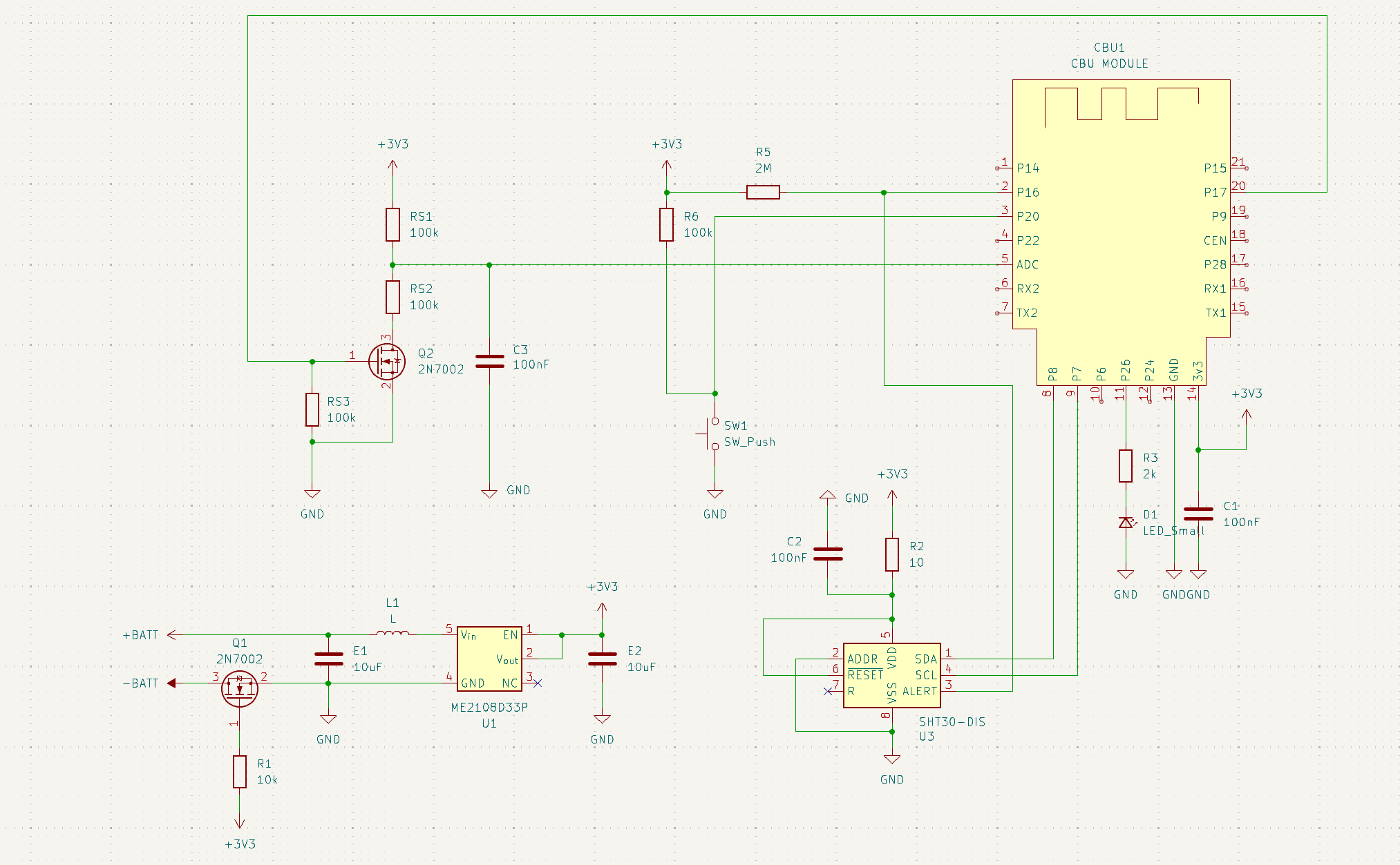

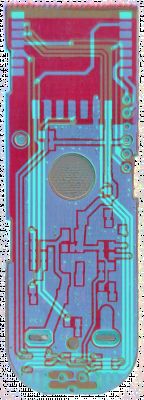

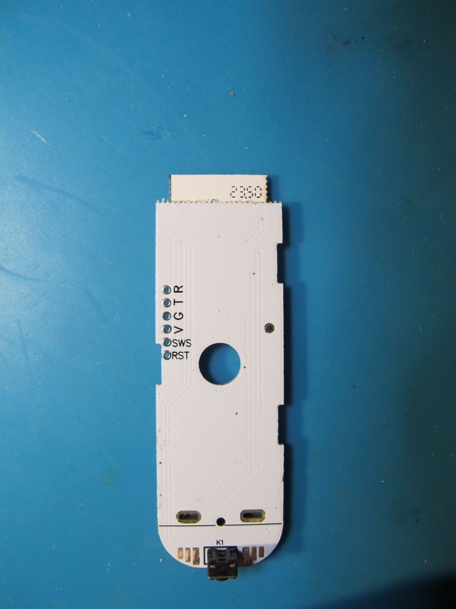

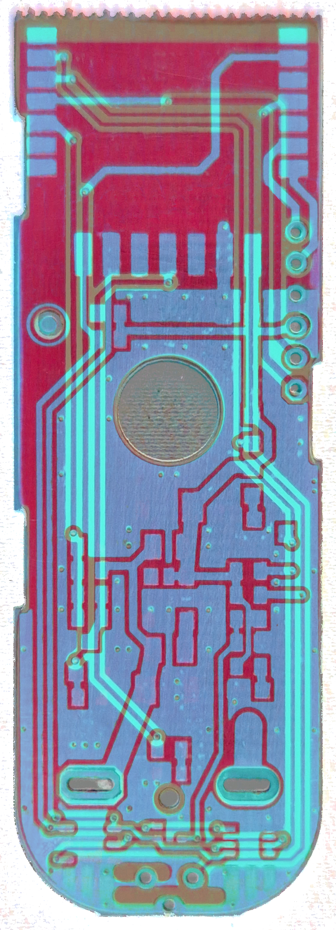

    we33
    DeDaMrAz wrote:
    here is a schematic
    Electrical schematic diagram with various components.
    but on my board:
    RS2 not 100 kOhm - marking "87c" (correct 78.7 kOhm), and connect to +Batt (not +3v3)
    RS1/RS2+C4 it's a Fuel Gauges Battery measurement
    C4 - N.C.
    ic U1 (sot23-5) marking H30F
    in your schematic wrote "me2108d33p", but me2108 haven't synchronous rectifier and need outside/external diode (between pin 2&5 )
    me2108D need external switch transistor
    me2108d33P it's sot89 (correct me2108c33m5)
    L0 - bypass U1 (N.C.)
    diode D1 reverse polarity and connect via RS0 (not R3)
    R3 R4 - pull up (2x10kOhm to +3v3) for i2c bus (U2,U3,U4)
    ISP pads:
    R - 16 (rx1)
    T - 15 (tx1)
    G - 13 (ground/common)
    V - 14 (+3v3)
    SWS - 4 (P22)
    RST - 18 (CEN)
    outputs Hall-sensors H2 (via inverter Q3) and H1 connect to "alert's in" P16
