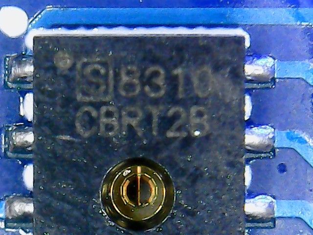

  • CHT8310 identified as SHT3x replacement chip

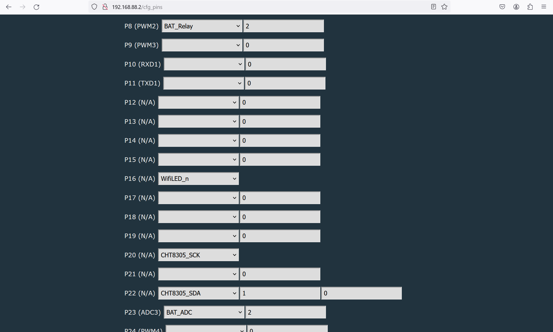

    #273 20905846
    sirhcsat
    Posts: 27
    Thats what I am looking into now @p.kaczmarek2. I looked at the 2 configs for the sht3 on here and used the same and that is what it comes up with. The led is always on as well. I need to get the microscope out and check the actual sensor to see if it is an sht30 as my eyes can not see that well under led lighting. here is picture of the sensor.
    Close-up of a chip labeled CHT8310 CBR128 on a blue PCB.
    It apears that I was "sold a dud" as the sensor was advertised as having the sht3x chip but it turns out it was a different chip and actually is a cht8310 chip and that explains the muddled I got into with this sensor. (never believe a thing Aliexpress advertises).
    its the same sensor as @kuba4321234 and even the same board as theirs. As @p.kaczmarek2 mentioned in the other thread this is actually the cht8310 and is compatable with the cht8305 driver ( great work ) and the temp and humidity readings are a lot closer than -49c and 3% so things are looking up. In the thread (https://www.elektroda.com/rtvforum/topic4019974.html) there is no mention of the led or button or even the battery adc etc . have i missed a thread or post with a complete config for this ? or is this still a work in progress to make a complete working config for other users.
    thx

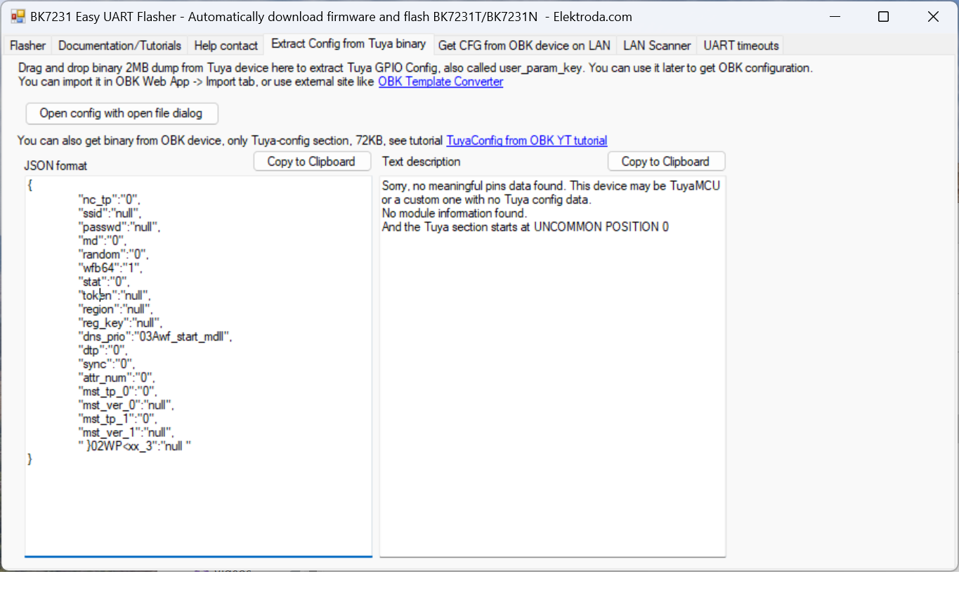

  • #275 20906563
    Posts: 14767
    Rate: 12909
    Are SCL/SDA pins really correct? Can you extract Tuya config?
    By the way, your config is very, very inefficient. This will drain battery fast. 50 seconds online? I'd just do wait for MQTT to report and back to sleep. Hm.

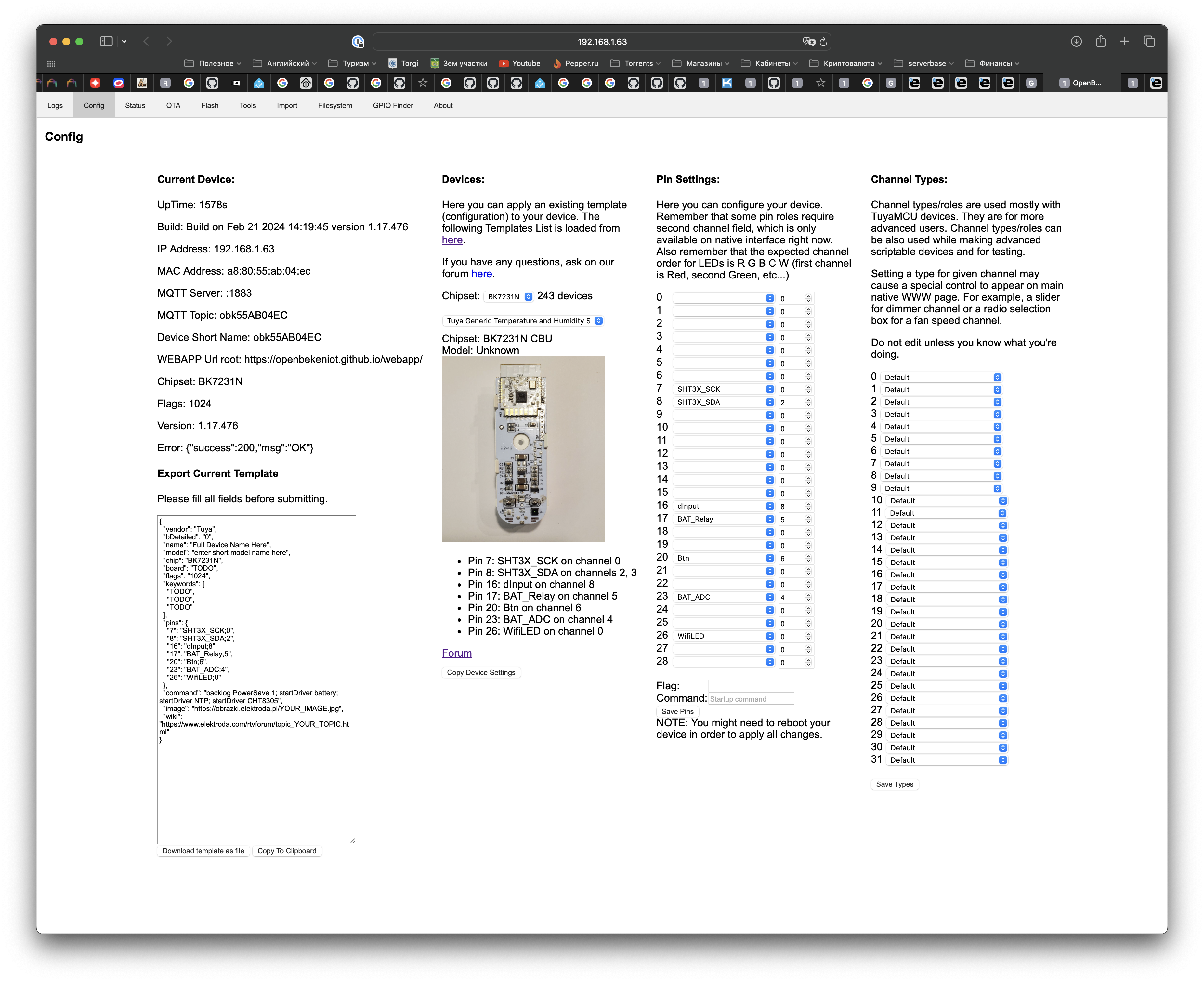

  • SDA and WiFi LED need separate channels
    #276 20906880
    sirhcsat
    Posts: 27
    I do not think the config will work very well, sda second channel is the same as wifi led and scl and as far as I know they need to be on seperate channels. ??
    the wifiled on 16 seems to be correct as it lights and flashes 6 or 7 times at power up.
    sck on 20 and dat on 22 is from the other thread and work if different chanels are used.
    bat adc & bat rel are unknown
    could these few posts be moved over to the other thread @p.kaczmarek2 since they are actually about the cht8310 ? that way it keeps this thread clean and puts this in the correct place with the other work done on the sensor ?

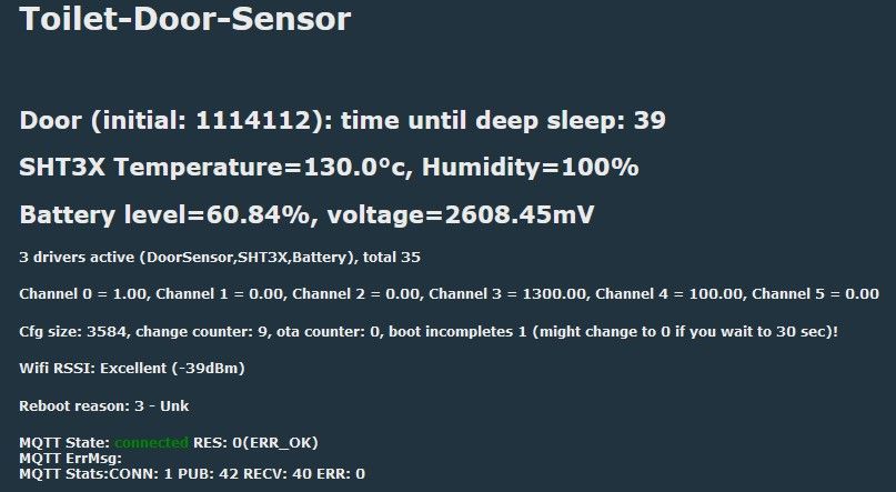

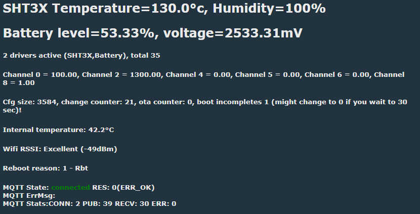

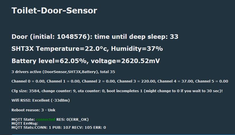

    sirhcsat
    Posts: 27
    I have transplanted an sht3x and R2-(10r), R3-(10k), R4-(10k) & C2-(100nf) onto the door sensor board, adjusted the config and it.... Sort of works.
    Screenshot showing information about a toilet door sensor, displaying temperature, humidity, and battery status.
    but only while the door sensor is open. with the door closed the temp and humidity blow to max readings
    Screenshot of toilet door sensor data showing anomalies in readings.
    config:
    "7": "SHT3X_SCK;2",
    "8": "SHT3X_SDA;3;4",
    "16": "DoorSnsrWSleep_nPup;0",
    "17": "BAT_Relay;1",
    "20": "Btn;5",
    "23": "BAT_ADC;1",
    "26": "LED;0"
    Future plans:-
    get the sht3x to give acurate readings while the door is closed ? could it be the hall sensor creating noise and messing the readings up.
    Could an autoexec.bat be made to take a reading from the sht3x every 15 mins and send via mqtt and maybe even send a door status at the same time (how would this effect the battery drain)
    Anyone any ideas. ?
  • #282 20919523
    Posts: 14767
    Rate: 12909
    Try setting different channels here:
    maybe 6 and 7
  • Door sensor closure delays SHT3X readings
    #283 20919579
    sirhcsat
    Posts: 27
    just the same on 6 & 7 as with 3 & 4.
    what I have noticed is that after about 10-15 seconds after the door sensor is closed the temp and humi readings return to the correct level most of the time. now and again they just sit maxed out until the battery goes to sleep after 60 seconds (that I have set in autoexec.bat) and just stay there until the door is opened again..
    I think it may need a juicy autoexec.bat to force a reading from the sht when the door sensor is opened or closed and poss every 10 mins or so to read them all and publish to mqtt for my home assistant system...
    I have been reading the example autoexec.bat files you supplied and got a rough (prob not working version) started.
    // start drivers
    startDriver Battery
    startDriver DoorSensor
    startDriver SHT3X
    //hold button to get into safe mode
    addEventHandler OnHold 20 SafeMode
    // press button to take temp & humi reading
    addEventHandler OnClick 20 // no idea what goes here.
    // wait for wifi to become WIFI_STA_CONNECTED
    waitFor WiFiState 4
    Battery_Setup 2500 4200 2.29 2400 4096
    battery_measure
    publishFloat "voltage" $CH4/1000
    publishFloat "battery" $CH4/25
    // extra wait
    delay_s 5
    // measure
    SHT_Measure
    // send data
    publishFloat "temperature" $CH2/10
    publishFloat "humidity" $CH3
    // wait for mqtt data sending to complete
    delay_s 5
    // sleep for 120 seconds and then wake up (from blank state)
    DeepSleep 120
    No idea if this is even close as my good old dos/basic code was forgot about 20 years ago the last time I needed to write a windows batch file to backup an hdd to cd, I vowed never to dig into it again.
    Edit :-0 simply removing the door sensor form the config and rebooting turns it into a normal temp humidity sensor and putting the magnet to the sensor as if the door is closed does not trigger the over reading on the temp or humidity so I think random noise from activating the hall sensor used for the door can be ruled out. but then it points to how the driver for the door sensor is doing its magic (the door sensor is still active and loaded in autoexec.bat)

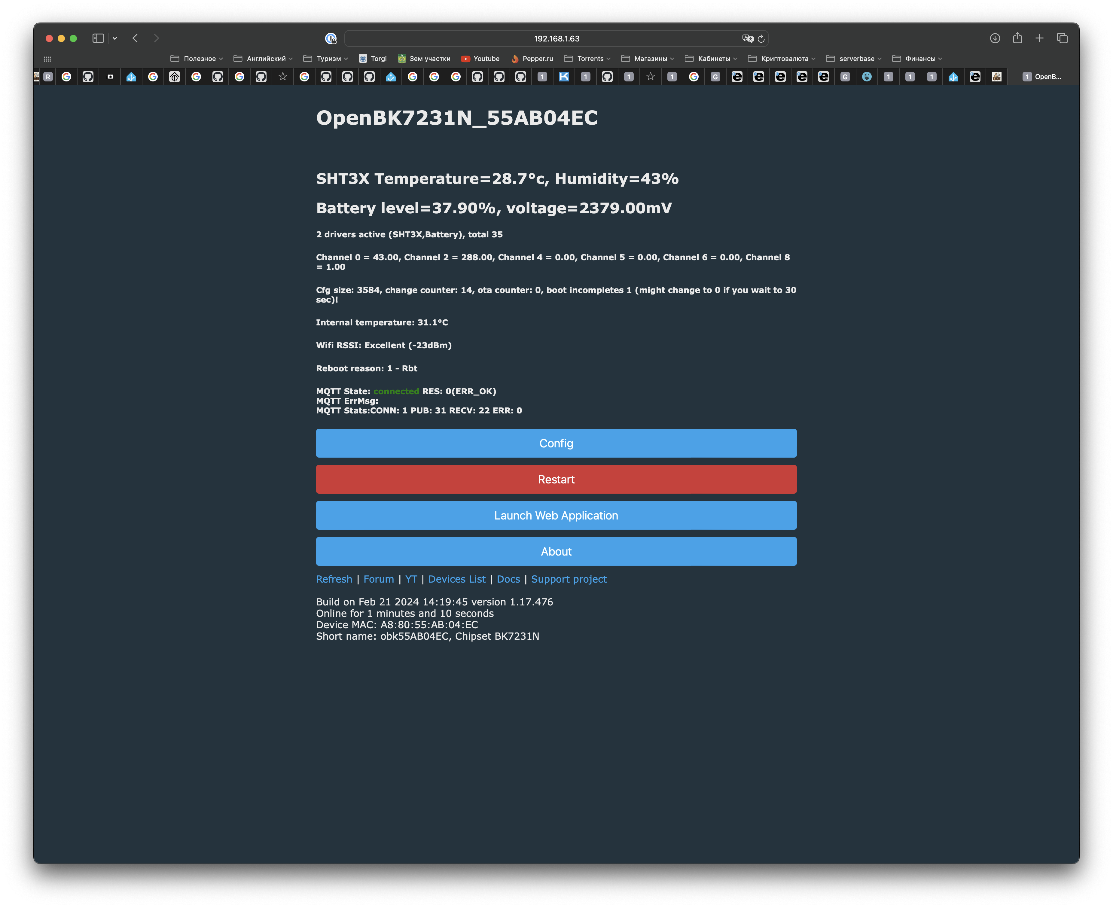

  • #284 20972227
    aleksey2
    why my temperature not correct? now 20-21 C
    Screenshot of the web interface for OpenBK7231N device, showing a temperature of 28.7°C, humidity of 43%, and battery level of 37.9%. Device configuration with BK7231N CBU module, visible on a control panel with pin settings.
  • Investigating duplicate MQTT broadcasts before deep sleep
    #285 20982756
    Xinayder
    Posts: 24
    @p.kaczmarek2 I have reflashed my device again and recharged my batteries.
    I have an issue now and I'd like to ask for help debugging it. This is my current autoexec.bat file:
    startDriver SHT3X
    mqtt_broadcastItemsPerSec 5
    //SHT_cycle 60
    //Battery_cycle 60
    // hold button to get into safe mode
    // AAA battery: 1500 3000
    // rechargable: 1800 2400
    Battery_Setup 2000 2800
    // Battery_Measure
    // SHT_measure
    // wait until wifi is connected
    waitFor WiFiState 4
    // go to deep sleep if mqtt can't connect
    addRepeatingEventID 30 -1 1337 DeepSleep 900
    // wait until mqtt is connected
    waitFor MQTTState 1
    cancelRepeatingEvent 1337
    publishChannels
    delay_s 5
    DeepSleep 900
    I have the following flags enabled: Broadcast self state every N seconds; [WiFi] Quick connect to WiFi on reboot (TODO: check if it works for you and report on github);
    and when I check Home Assistant, the device is broadcasting three times, the last ones were at 15:10:39 (I suppose it broadcasts when connected), 15:10:41 and then 15:13:17. Maybe the first broadcast can be ruled out because of the avty_t field, but why is it broadcasting two times? It looks like the sensor is being kept online for 3 minutes before going to deep sleep.
  • #286 20983085
    Posts: 14767
    Rate: 12909
    Can you provide more information, maybe a more detailed log what happens when?
    There is a flag that allows you to control the device state broadcast on MQTT connect.

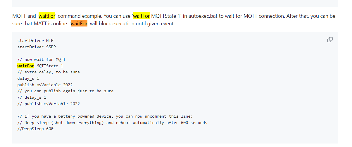

  • #290 21006720
    Posts: 14767
    Rate: 12909
    The autoexec you have posted now is incorrect. You need to use:
    // now wait for MQTT
    waitFor MQTTState 1
    before invoking
    The following script will not publish anything most likely because you execute publish commands before MQTT connection is established.
  • #291 21006809

    MPatern
    Hello guys,
    Can someone can explain to me, why I've got bad reading on my sensor ?
    Screenshot showing SHT3X sensor data with temperature 130.0°C, humidity 100%, battery level 53.33%, and other parameters.
    Thanks for all ! :)
  • #294 21052869
    Posts: 14767
    Rate: 12909
    Hello, what does the log say? Do you have correct GPIO roles selected?

    #295 21101835
    pipelkrsk
    >>21052869>>21052869
    I have a similar problem. I looked at the temperature sensor under a microscope. It's labelled 8315. This means that I have the third version of the device.
    I have tried all the suggested settings in this and neighbouring threads. Nothing works.
    Only P7-CHT8305_SCK and P8-CHT8305_SDA have some reaction shown when heating and cooling the sensor. But the readings themselves are very strange.
  • #297 21101969
    insmod
    Posts: 1432
    Help: 168
    Rate: 455
    What is the reported chip id? I haven't found a normal datasheet, but it is possible, that 8310 and 8315 are similar enough to work with the same code. If chip id is not 0x8215, then it uses default (8305) measurement code.

  • Tuya config reveals battery relay and ADC pins
    #300 21102133
    Posts: 5216
    Help: 448
    Rate: 917
    will see if I can find anything.
    on a different note it looks like Easy flasher is missing some pin extraction opportunities
    eg
    Added after 1 [hours] 3 [minutes]:
    hmm. haven't worked out Ghidra clearly to find anything yet and I'm off for the whole weekend in an hour. over to someone else...
