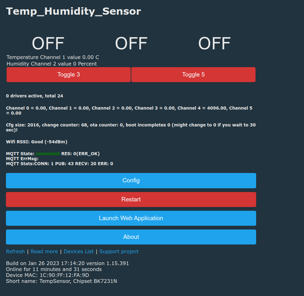

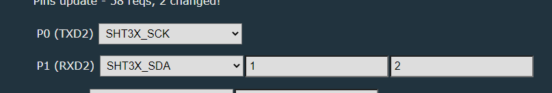

    Posts: 69

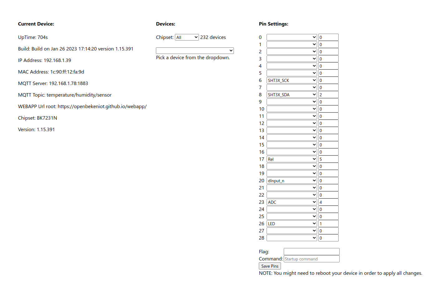

    I dont know why at me show like this after set pin:
    [BK7231N CBU] Generic Temperature and Humidity Sensor

    @dheenhasty says:
    "pins": {
    "7": "SHT3X_SCK;0",
    "8": "SHT3X_SDA;2;3",
    "17": "Rel;5",
    "20": "dInput_n;0",
    "23": "ADC;4",
    "26": "LED;1"

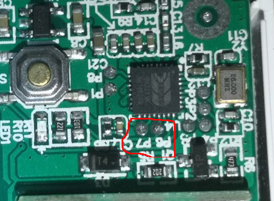

    P6 should be P7.
    And in P8 it should assign channels 2 and 3, not just 2.

    Yes don't why but the pin configuration in the webapp is kind of buggy. i'd prefer to pass thru configure module menu in web frontend configuration
    and you might need to wait for the last pull request to be merge to have correct behaviour regarding battery measurement and deep sleep.
    But as mention, be carefull if battery is too low you might encounter a freeze !!!! and it need to be reflash thru uart with a 2mb erasing.

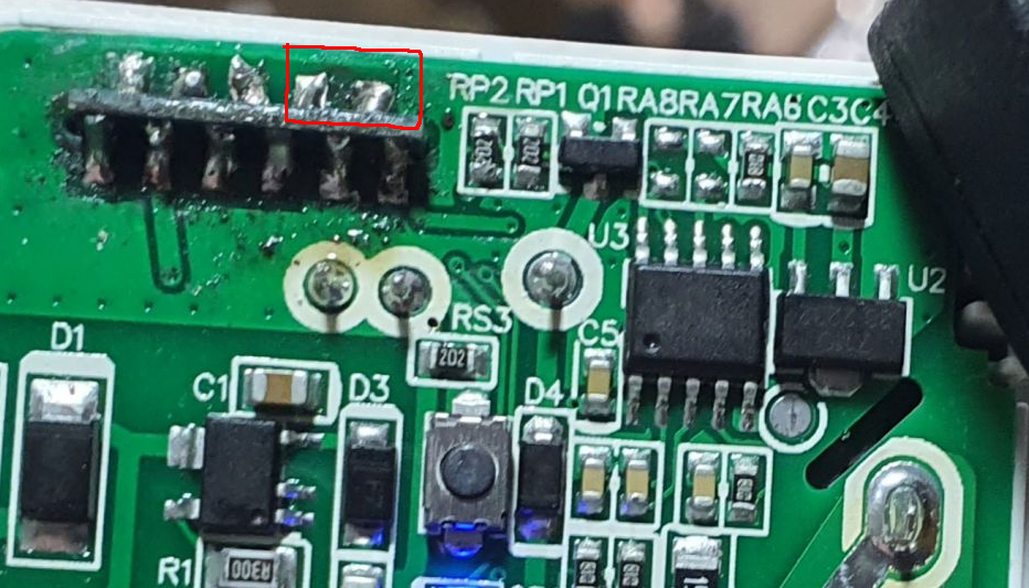

  • Q1 MOSFET may isolate direct 3.3 V supply
    #73 20428115

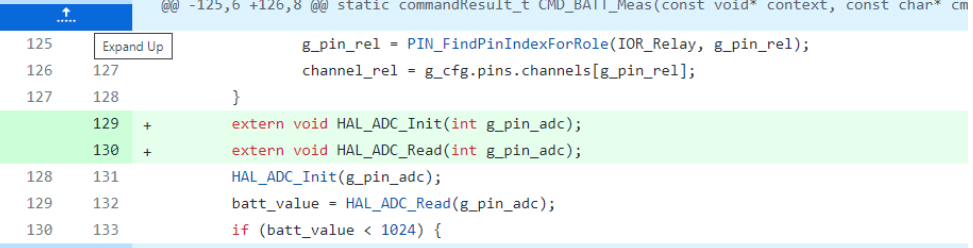

    Normally, I have Corrected the battery measurement in my last commit everything should be better.
    i have no plan to update the sht driver for the moment. they're load of work to do on this (implementing the channel mode for the heater, and alerting part) i'm clearly lacking some time to work on that .....

    Wasn't Q1 for reverse polarity protection?

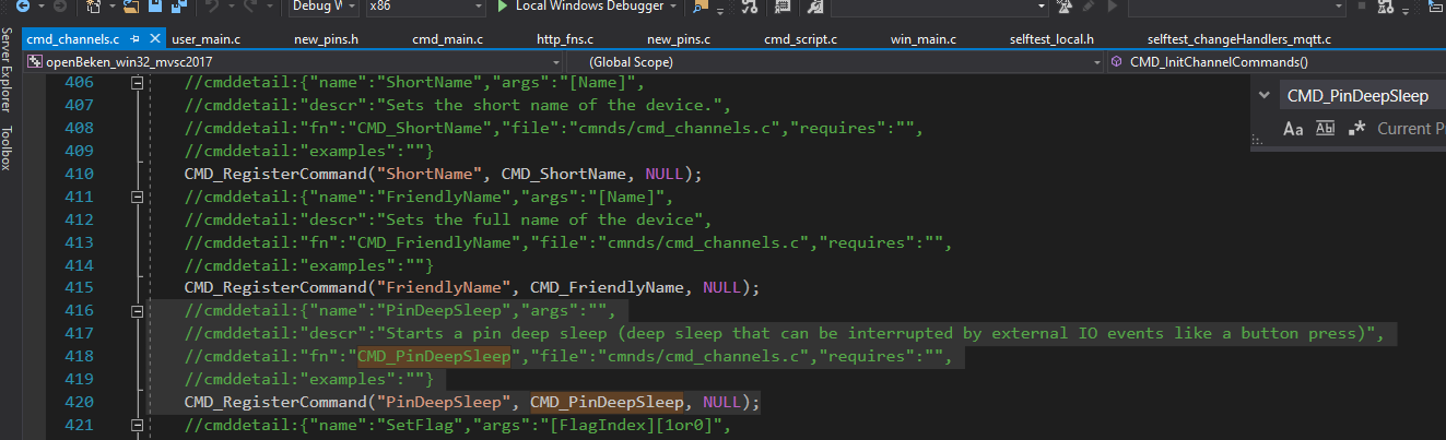

    By the way, it seems that "wake up on GPIO" works only on T and not on N.
  • GPIO wake works on T, not N

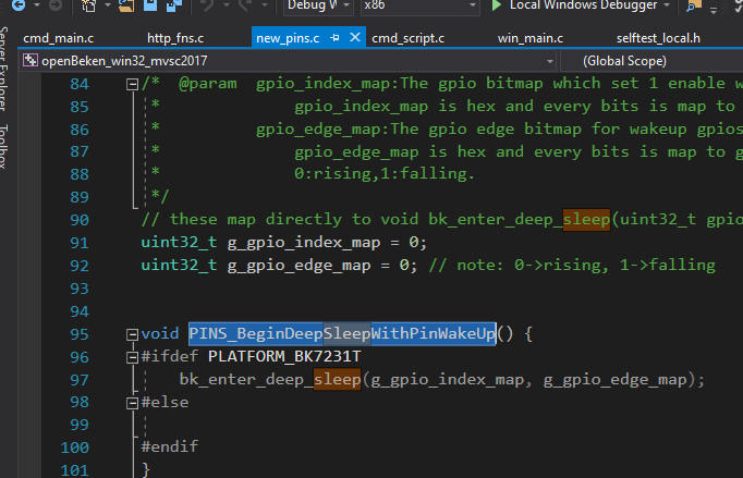

  • Deep sleep GPIO wakeup test and command changes
    #77 20435876
    dheenhasty
    Posts: 111
    Rate: 17
    @p.kaczmarek2 i have test the latest release 1.15.439 not sure it include your modification ? if so it works flawlessly :)
    i have done again a lot of test on deepsleep side, GPIO is working but i cannot figure how to handle the edge map and index map. if i put them on FFFFFF / FFFFFF it execute thedeesleep but go alive directly (so i suppose it detect a input) but i have try to play around the pin with the button and cannot find a way ....
    to play i have done some modification on manual_ps and cmd_c :

    #78 20437076
    Posts: 14767
    Rate: 12909
    My I2C changes are already in place, but I also have to finalize them and move shared I2C software code to separate file.
    All drivers are using now the same I2C functions.
    Regarding edge map, we already got it.
    Here is a command:
    See new_pins.c and search for g_gpio_edge_map and g_gpio_index_map.
    It works on T.
    It basically scans pin roles and then all buttons on device can wakeup from the sleep.
    It works on my BK7231T test device

    Hello guys!
    I'm also playing with those sensors and I was able to add one to a relay based on a CB2S board! But I'm stuck with another relay with a bare BK7231N on the PCB... Thing is: in this configuration, I cannot choose the pins I'm going to be using for the sensor, I have to deal with the test pads on the PCB. Fortunately, on both relays the UART2_RXD/I2C2_SDA and UART2_TXD/I2C2_SCL were available.
    Here is the pin config on both relays:
    And here is my autoexec.bat script:
    startDriver SHT3X
    startDriver NTP
    setChannelType 1 temperature_div10
    setChannelType 2 humidity
    SHT_Measure
    ntp_setServer 172.17.7.1
    addRepeatingEvent 60 -1 SHT_Measure
    However on the problematic relay the sensor would send measurements... until the relay is reset! After that the only data read on the bus is FF FF... This is what SHT_GetStatus shows anyways.
    I'm running the last release. Any idea? I can't understand why it is working on one relay and not the other, with the exact same wiring...
    Also, why are you using the TucaMCU for?

    #82 20440955
    Posts: 14767
    Rate: 12909
    I might be able to try soon, my sensor from aliexpress should arrive this or next week.
    Why not just let the measure be done automatically? It won't increase power consumption much, I think.
    and if you want to reduce power usage, you are still missing "PowerSave" command.
    @dheenhasty btw why are you reading the function decls to the function itself in your PR, while I already added #include for HAL header?
    in general, it's better to include the header. The same should be done for sleep functions.

    @ShadowLight30 hum i think you use the bad pin (TX2/RX2) for the CB2S, who can generate strange behavior. You cannot use other unused pwm on (p6/p7) for example ?
    You can find the pinout on developper.tuya site
  • CB2S back pins expose uart2 and i2c2
    #89 20442481
    ShadowLight30
    Posts: 8
    Well the relay with a CB2S works that way. If you look at the datasheet of the BK7231N you see those 2 pins serve as UART_2 and I2C_2. On the CB2S those pins are on the back of the PCB.
    The relay I can't get the SHT30 to work with has its chip soldered on the relay PCB like the first post of the link I shared. And this one stops working after a reboot. I can't use any other pin because the unused pins are not traced to any test pad on the PCB. So aside from the switch inputs, relay and led outputs, tx1 and rx1, tx2 and rx2... I have no way to connect to the chip :p
  • BK7231n pinout: p0/p1 reserved on CBU and CB2S
    #90 20442513
    dheenhasty
    Posts: 111
    Rate: 17
    it's really confusing :)
    Ok so the one that work is the one with the CB2S board soldered on it.
    So you can see here that it's really not recommended to use P0 or P1 , https://developer.tuya.com/en/docs/iot/cb2s-module-datasheet?id=Kafgfsa2aaypq
    For the one with the soldered beken directly you can this one ? :
    And for the one with CB2S based on tuya doc :
    No ?
