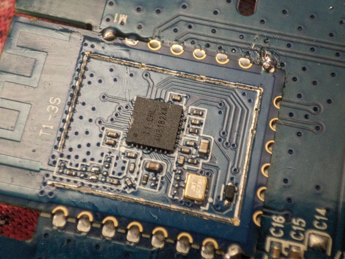

    UPDATE: Mission accomplished with BK7231GUIFlashTool
    Chip: CB3S v.1.3 -> BK7238
    I'm running Linux (Debian 13) and I don't have a Windows PC or VM, so I used mono to run this .NET tool.
    I successfully performed both read and flash operations using a CP2102 adapter, connecting only RX, TX, and GND (no 3.3V), with a baud rate of 230400.
    Steps performed:
    Dumped the original firmware along with the OBK settings (to preserve the correct pinout configuration).
    Flashed the device using the OpenBK7238_QIO_1.18.261.bin firmware.

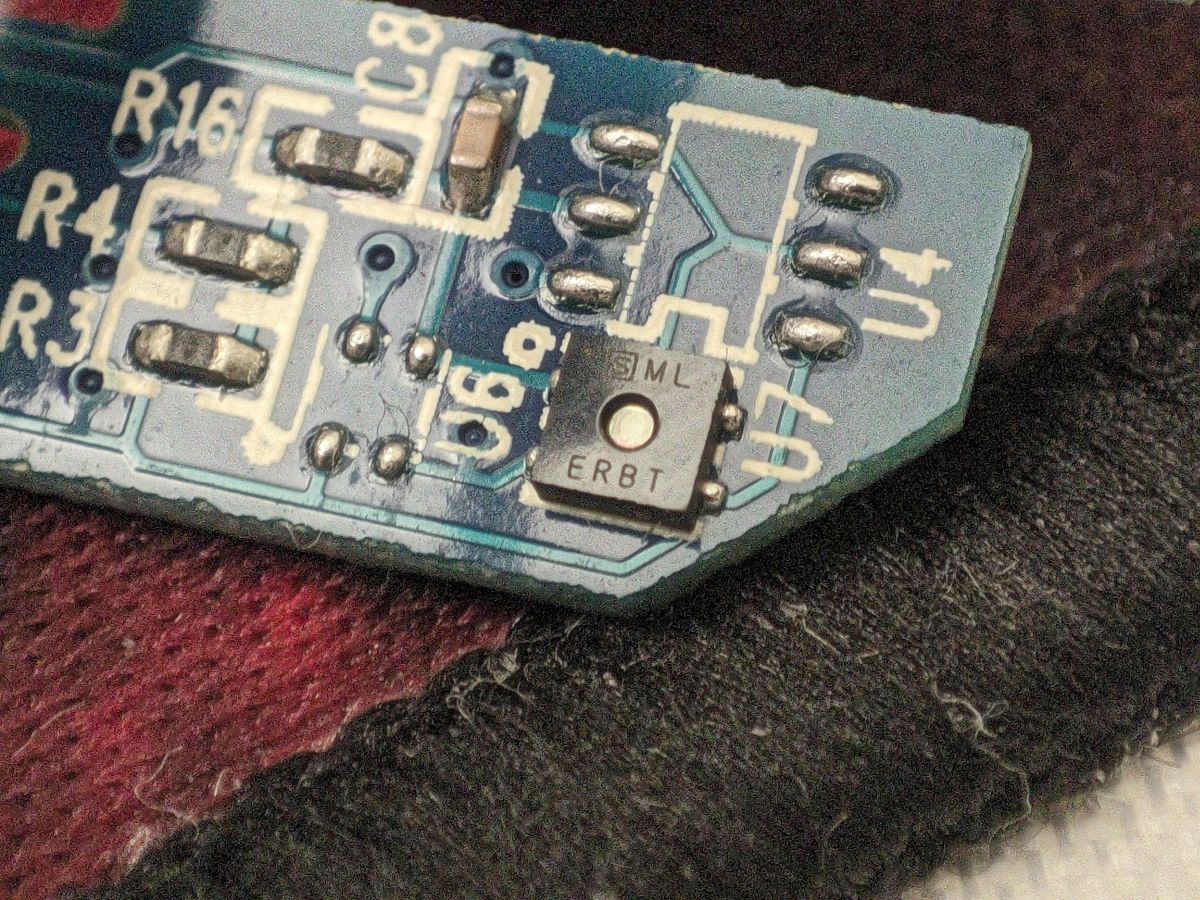

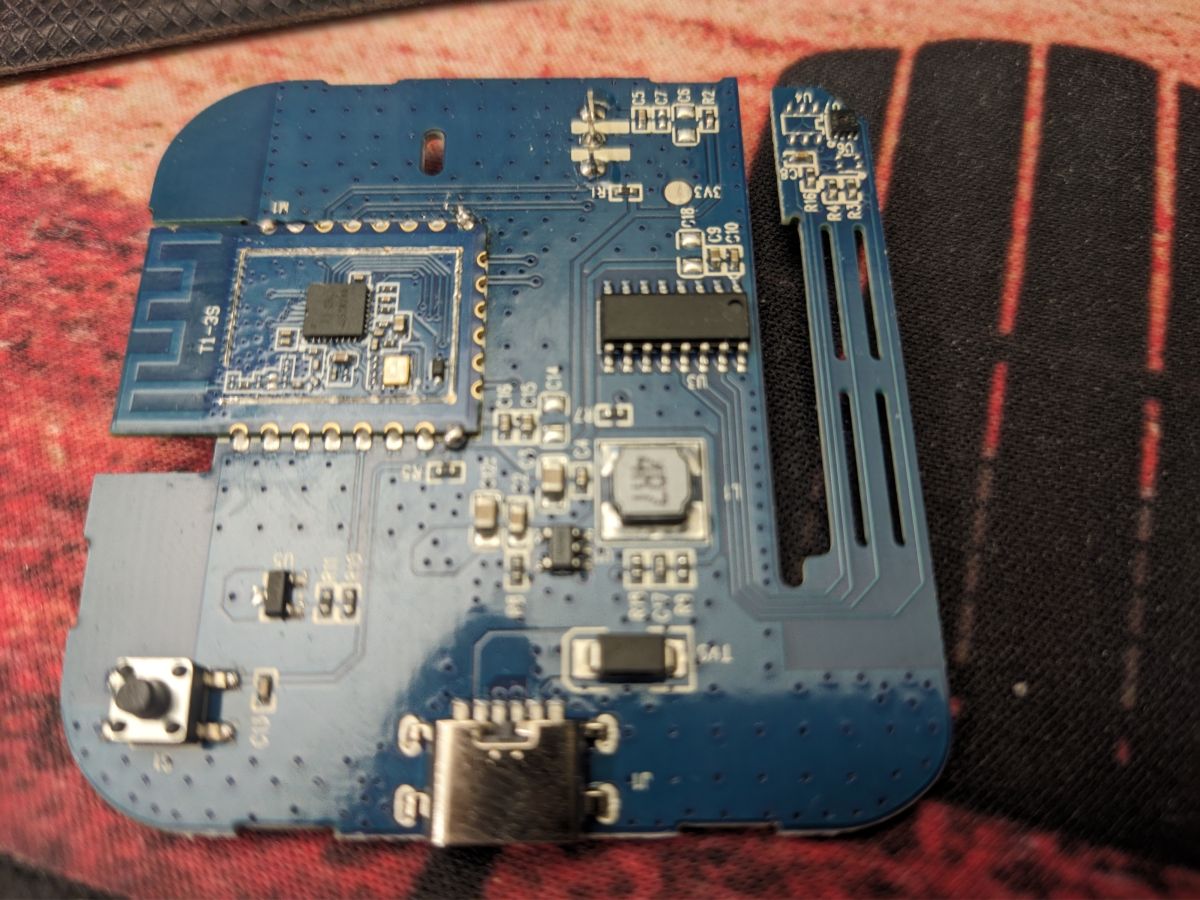

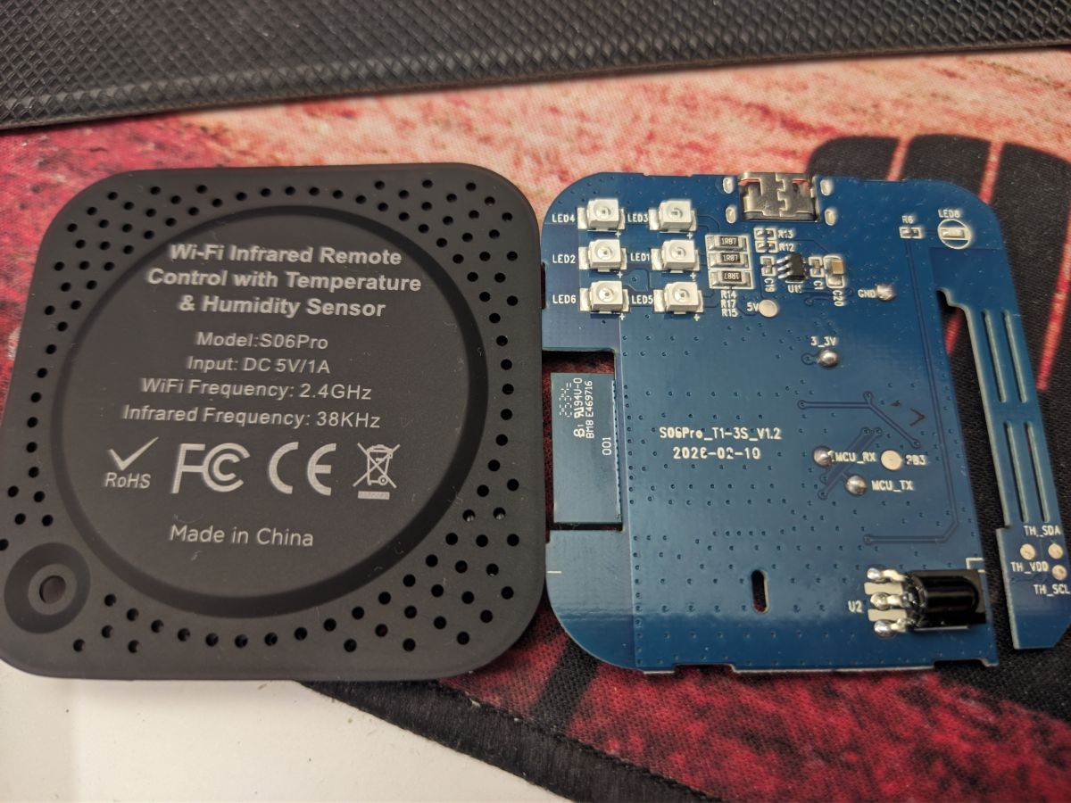

    LordArrin
    S06Pro_T1-3S_V1.2
    Tuya IR remote with temp/humi sensor
    Teardown, flashing and configuration for Smart Tuya IR Blaster S06 [CB3S] Teardown, flashing and configuration for Smart Tuya IR Blaster S06 [CB3S] Blue PCB with a Bluetooth module and USB‑C port on a red-and-black surface Close-up of a PCB with a black integrated circuit and surrounding SMD components inside a rectangular area
    works with this:
    S06Pro_T1-3S_V1.2
    | **5** | P6 (GPIO_06) |
    IRSend
    | **14** | P26 (GPIO_26) |
    IRRecv
    | **7** | P9 (GPIO_09) |
    Btn
    dInput
    | **13** | P24 (GPIO_24) |
    WifiLED
    startDriver TuyaMCU
    tuyaMcu_defWiFiState 4
    startDriver NTP
    startDriver IR
    setChannelType 1 temperature_div10
    linkTuyaMCUOutputToChannel 101 val 1
    setChannelType 2 Humidity
    linkTuyaMCUOutputToChannel 102 val 2
