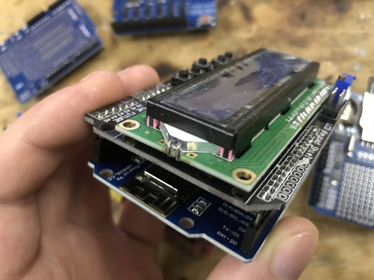

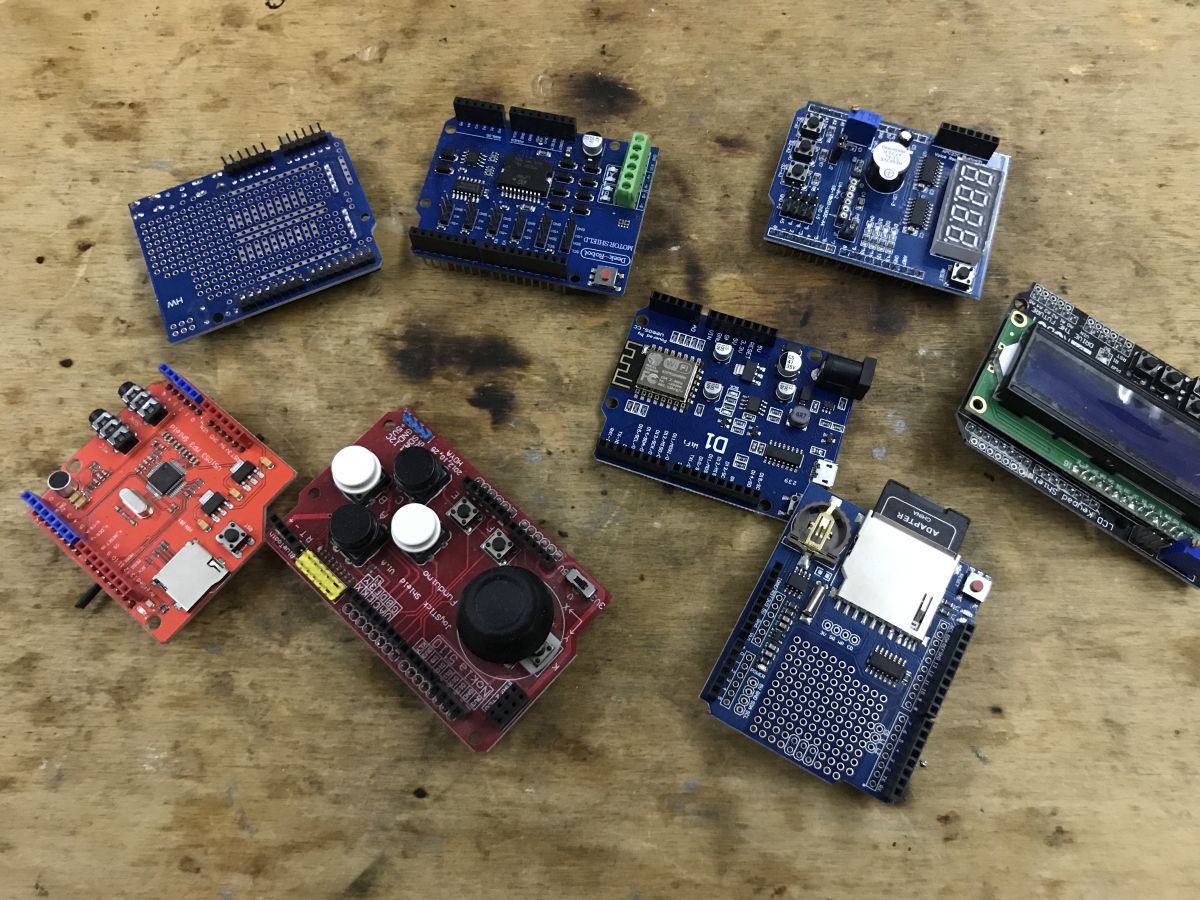

    Here are mine:
    Various prototype boards and electronic modules on a wooden surface. A hand holding an electronic device with an LCD display module.
    I am thinking about using them with Wemos D1 converted to BK7231

    ah i see. shields are hats, extensions, add-ons. of course :)

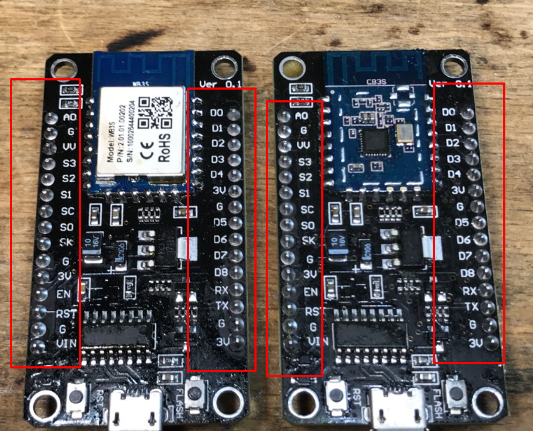

    Those markings are so misleading:
    Two NodeMCU modules with pin labels visible on a dark background.
    I wonder how hard would it be to make a custom build (or a skin, or a script?) of OBK that will have NodeMCU-style pin names next to classic pin names...

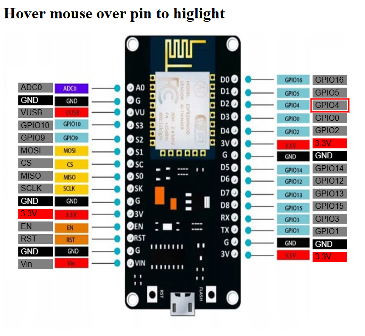

    Ok, so here is initial draft:
    https://openbekeniot.github.io/webapp/test1.html
    Open link and hover mouse cursor over pin name to higlight it.
    That's how it looks like:
    NodeMCU board diagram with highlighted GPIO pins.
    Next step would be to integrate it into pins chooser and GPIO doctor, I guess?

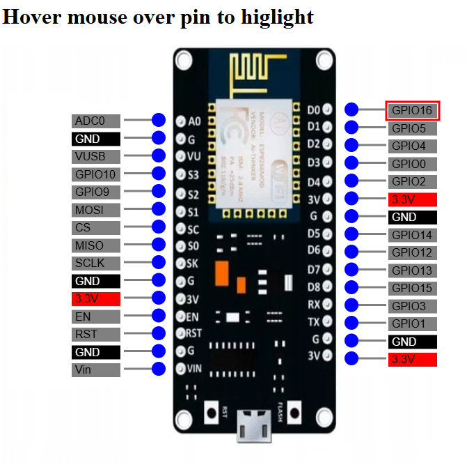

    I added drawing handles:
    NodeMCU board pin diagram with highlighted pins.
    Added after 49 [minutes]:
    something like this, maybe?

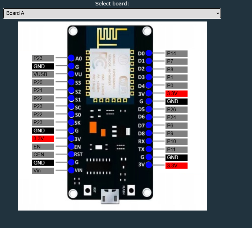

    I think I may get initial version working soon, but we will need to create our own "boards.json":
    ESP32 board pin diagram with a dropdown list for board selection.
    And there is also question where would we store board information, but since it's not a critical piece of information, I may just decid to store it in Cookie so it's a developer only feature remembered by current browser? Idk.... or add a command for that
