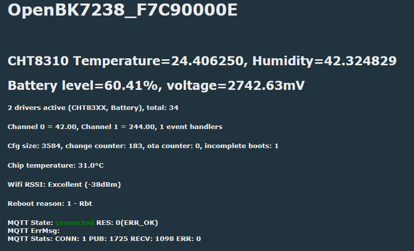

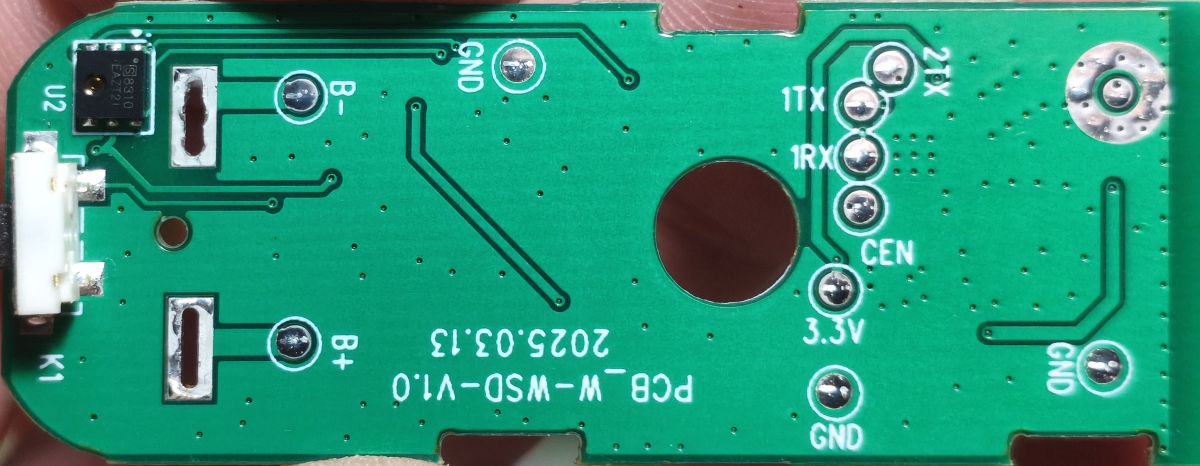

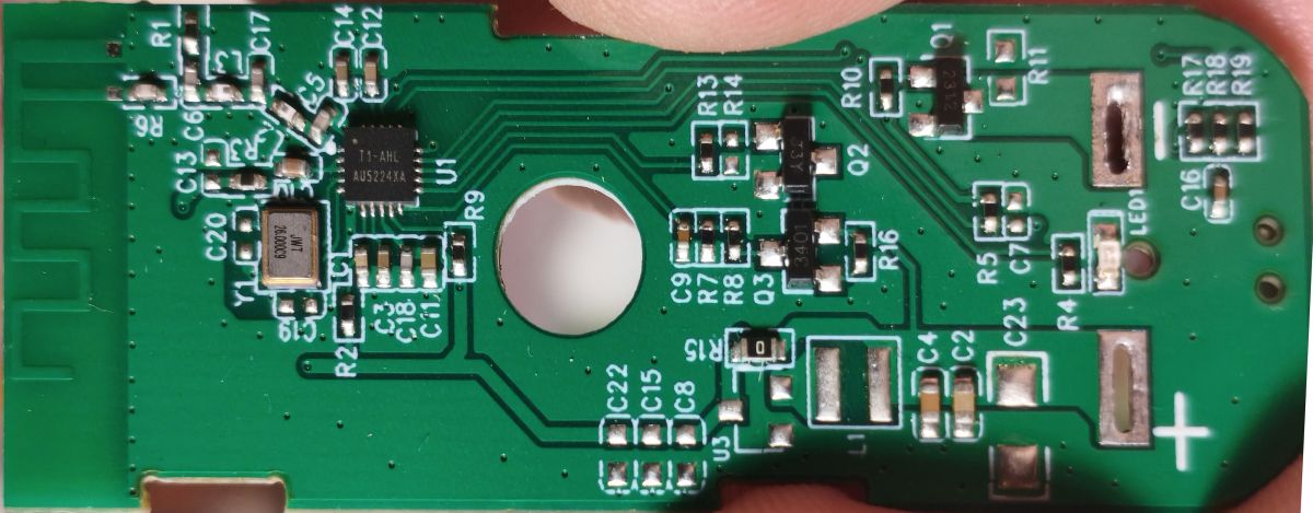

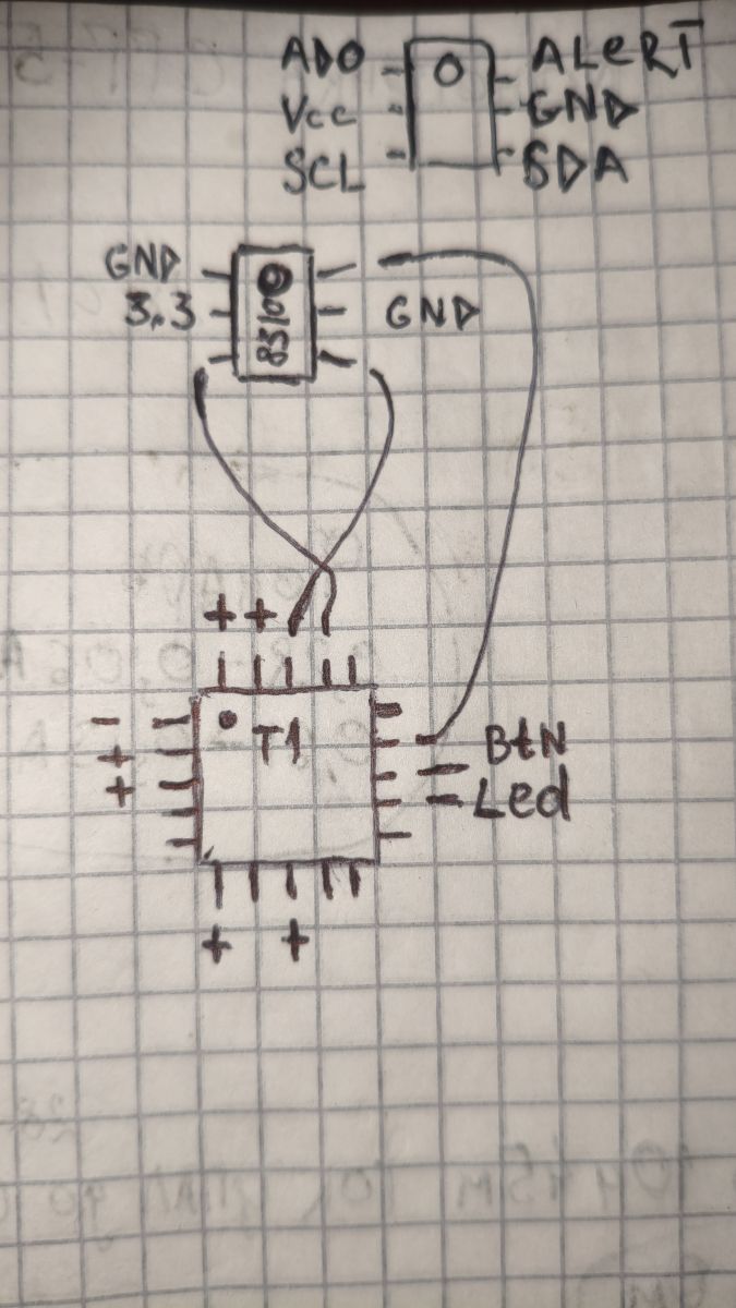

    Sorry for posting in this thread, but I couldn't find a thread with a similar device. I'm new, and this is the first device I'm trying to flash on OpenBeken.
    I flashed OpenBK7238_QIO_1.18.287.bin. I even tried configuring the pins. The temperature and humidity readings seem to be correct. However, the battery pins seem to be incorrect. I don't remember why I assigned them exactly, and I don't have a better option. The battery is overstated by 0.3-0.4 V. I also doubt I assigned the other pins correctly! Please help me configure them correctly.

    [BK7231N/CBU] Tuya TH01? Generic Wi-Fi Temperature & Humidity Sensor [CHT8310] Close-up of a green PCB with SMD components, a mounting hole, and a plus sign marking Hand-drawn wiring diagram of a BME280 sensor connected to a microcontroller, with labeled I2C pins
    Screenshot of sensor status: temperature, humidity, battery level/voltage, Wi‑Fi RSSI, and MQTT connection.

    Hey, the first step we usually recommend is Tuya Config Extraction. It's a nice feature of OBK, that can be done entire in OBK Web App! Please give it a try and let us know, what was extracted for you:
    Note that sometimes there is no configuration in Tuya partition, so we may resort to other methods, but it's good to check it first anyway .

    Unfortunately, I was out of luck.
    Sorry, no meaningful pins data found. This device may be TuyaMCU or a custom one with no Tuya config data.
    No module information found.
    Device internal platform - T1, equals BK7238.
    And the Tuya section starts at an UNCOMMON POSITION 28672 (0x7000)
    "0": "CHT83XX_SDA;1;0",
    "1": "CHT83XX_SCK;0;0",
    "6": "WifiLED_n;0;0",
    "8": "Btn;0;0",
    "9": "dInput;0;0",
    "26": "BAT_Relay;0;1",
    "28": "BAT_ADC;0"
    Can I assume the pins are configured?
    My thoughts:
    1. The temperature and humidity are correct. Does this mean CHT83XX_SDA and CHT83XX_SCK are correct?
    2. The LED blinks during boot. Does this mean WifiLED_n is correct?
    3. If I execute PinDeepSleep 90 in the command line and press the button during sleep, the device wakes up. Does this mean Btn and dInput are correct?
    4. I adjusted BAT_ADC and BAT_Relay (Battery_Setup 2200 3000 1.92 2400 4096). I apply 2 volts and see 2.05 on the device, but at 3 volts, I see 2.94 volts. The error is almost 0.1 volt. Is this normal for such devices?
    Regarding autoexec.bat. Do I need to add startDriver CHT83XX, startDriver battery? It seems to work without these lines too! Or is it better to add them?
    Can you tell me how to boot without running autoexec.bat? To adjust the settings? I tried five reboots and Safe Mode. But then Launch Web Application is unavailable, and it's unclear how to edit autoexec.bat, and it takes a long time. Is there a simpler solution?
