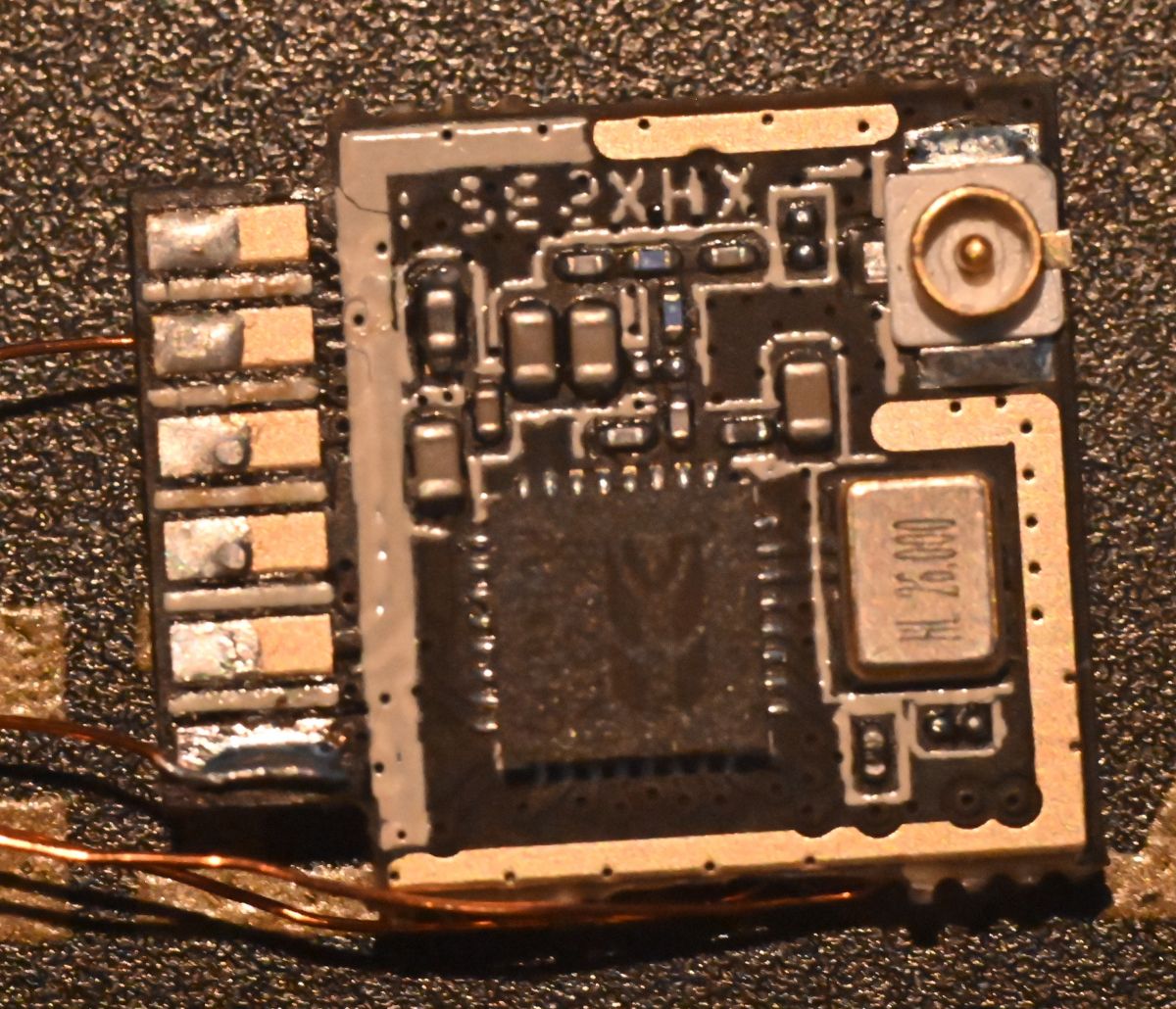

    #245 20928892
    uchristo
    Posts: 13
    Hi there!
    I got a bunch of new GoSund EP2 Sockets with Power Measurement. They incorporate a Board CUCO-Z06-N consisting of a Beken 7231N and a BL0942 connected to TX1/RX1
    While programming, the Header with the GPIO-Infos wasn't readable (see attached BIN-File) so I had to roll the dice myself.
    P6 (PWM0): Relais 1
    P7 (PWM1): Button 1
    P8 (PWM2): Green LED
    P9 (PWM3): Blue LED
    But I'm unable to readout BL0942. I already typed StartDriver BL0942 into Startup and used
    Voltageset 240
    CurrentSet 0.1
    PowerSet 7
    but the device still shows nothing useful:
    OpenBekenX user interface with power measurement information, toggle buttons, and BL0942 error.
    What am I doing wrong??? It's definitely connected to the same UART I used for Flashing-

  • #246 20929217
    Posts: 14805
    Rate: 12972
    @uchristo can you remove the wires used to flash firmware before testing BL0942? They are using the same port
  • #247 20929220
    uchristo
    Posts: 13
    I did that already. To be honest: I had no device handy from which I definitely knew the power consumption so dialed in some fantasy Digits for power and current…
    240Volts*0.1Ampere will never be 7Watts… is this a problem? Should I dial in some sane values in the correct relation for testing?

  • Check BL0942SPI driver and wiring with multimeter
    #250 20929341
    Posts: 14805
    Rate: 12972
    Well, at least the voltage value should be non zero, unless you entered some random values to calibration...
    Alternatively, it's possible that your device is using BL0942 in SPI mode, and if that's the case, you need to use BL0942SPI driver.
    https://www.elektroda.com/rtvforum/find.php?q=BL0942SPI
    BL0942 is always using UART1 (or SPI) and we haven't encountered yet any devices with config different than that, but if you are unsure, you can check with a multimeter how BL0924 is connected.
  • #251 20929391
    uchristo
    Posts: 13
    That did the trick!
    The Board uses SPI. I traced back the tx/rx Pins of BL0942 to tx/rx on bk7231N.

    #254 20936011
    uchristo
    Posts: 13
    Back home, but unfortunately with bad news.....
    BL0942SPI is loading somehow and showing weird digits. Tried to calibrate like linked in Tasmota-documentation, but with no success. Then had a look in Web Application -> Logs and this is what I see:
    Warn:EnergyMeter:Failed to read reg 03: bad checksum FF wanted A7
    Warn:EnergyMeter:Failed to read reg 04: bad checksum FF wanted A6
    Warn:EnergyMeter:Failed to read reg 06: bad checksum FF wanted A4
    Warn:EnergyMeter:Failed to read reg 07: bad checksum FF wanted A3
    Warn:EnergyMeter:Failed to read reg 08: bad checksum FF wanted A2
    Using UART, there's no data at all. How can I do further debugging?
    I'll trace PIN 7 of BL0942 to determine if it's really using SPI ( http://m.huazhoucn.com/downloads/belling/pdf/370-BL0942_V1.06_en.pdf )
    Added after 1 [hours] 40 [minutes]:
    PIN 7 of BL0942 is not connected to 3,3V (VDD) and not connected to GND. According to Datasheet, it's internally pulled down, so UART will be the correct method. TX and RX are connected to BK7231 with ~18 Ohms each

  • BL0942 uses UART protocol on SEL low
    #258 20937974
    uchristo
    Posts: 13
    Did some further testing. I took the next plug with stock firmware, soldered cables to TX from BK7231N and BL0942 and SEL/SCLK_BPS from BL0942.
    I measured 0,03Volts for SEL, this means UART is the chosen protocol.
    On SCLK_BPS there were 2,877Volts
    I then captured on
    stty -F /dev/ttyUSB0 4800 raw
    (stty raw; cat > received_from_OpenBK.txt) < /dev/ttyUSB0
    Requests from BK7231N with stock Firmware:

  • BL0942 UART protocol mismatch with original firmware
    #259 20939210
    uchristo
    Posts: 13
    Used RealTerm for Testing now. Here's what the original Firmware is doing on UART (Device is NOT connected to mains, just to 3,3V on LM1337 and USBtoUART:
    Initialization
    E0
    78 08 43 2B 08
    Frequent Polling after the Initialization:
    0E
    This is what the BL0942 answers:
    E0
    08 78 09 FA 08 08 08 08 0D 18
    18 08 F8 85 F7 08 08 08 A8 08
    00 08 38 08 EE 08 08 08 08 0D
    18 E8 08 48 08 00 08 08 08 0D
    18 58 08 E8 84 01 08 08 08 A8
    08 00 08 D8 08 DB 08 08 08 08
    0D 18 18 00 F8 00
    With OpenBeken and Startup-Text "backlog startDriver NTP; StartDriver BL0942; PowerSave 1; SetupEnergyStats 1 60 60 "
    The Request from BK7231N will always be:
    58 AA
    and there will be no anwer. I saw that it's possible to enable "Flag 31 - [UART] Enable UART command line". How to use it in Order to send the correct Request for Testing?
    EDIT:
    The Code below shows that it will contact BL0942 with 0x58 0xAA, so that's works as designed in openBeken. But why does original Firmware just sends 0x0E and will get an Answer from BL0942?
    #define BL0942_BAUD_RATE 4800
    #define BL0942_READ_COMMAND 0x58
    void BL0942_SendRequest() {
    UART_InitUART(BL0942_BAUD_RATE);
    UART_SendByte(BL0942_READ_COMMAND);
    UART_SendByte(0xAA);
  • #260 20957896
    Wimmi
    Level 4  
    Hi all,
    the solution for the BL0942 (board CUCO-6Z) in Godsund EP2 is quite easy:
    take baudrate = 9600 for the uart. Then it's running.
    Screenshot of a user interface displaying information about the BL0942 energy device.
    You can check it with small changes in file drv_bl0942.c. Compilation is easiest with the Docker container.

    Close-up of CUCO-Z6-N circuit board with BL0942 integrated circuit. Close-up of an electronic module with components on a circuit board.

    Hi
    I`m back after a few months with a working clone socket that started acting weird in terms of energy measurements read with the relay turned on:
    1. With a 40W bulb connected and calibrated, it shows well, but of course the results jump a bit, although I think the jumps are a bit too big
    2. Without load connected, it mostly shows 0 everywhere
    2. When connecting a switching power supply from a battery charger (consumption per wattmeter), it shows a voltage of 30-45V and a power of about 12W and all results jump
    User interface screen showing electric energy measurements. Control panel of an outlet showing energy parameters. User interface of a socket displaying voltage and energy consumption statistics.
    I tried to solder the contacts from the measuring system and the Bekens module, but it didn`t help.
