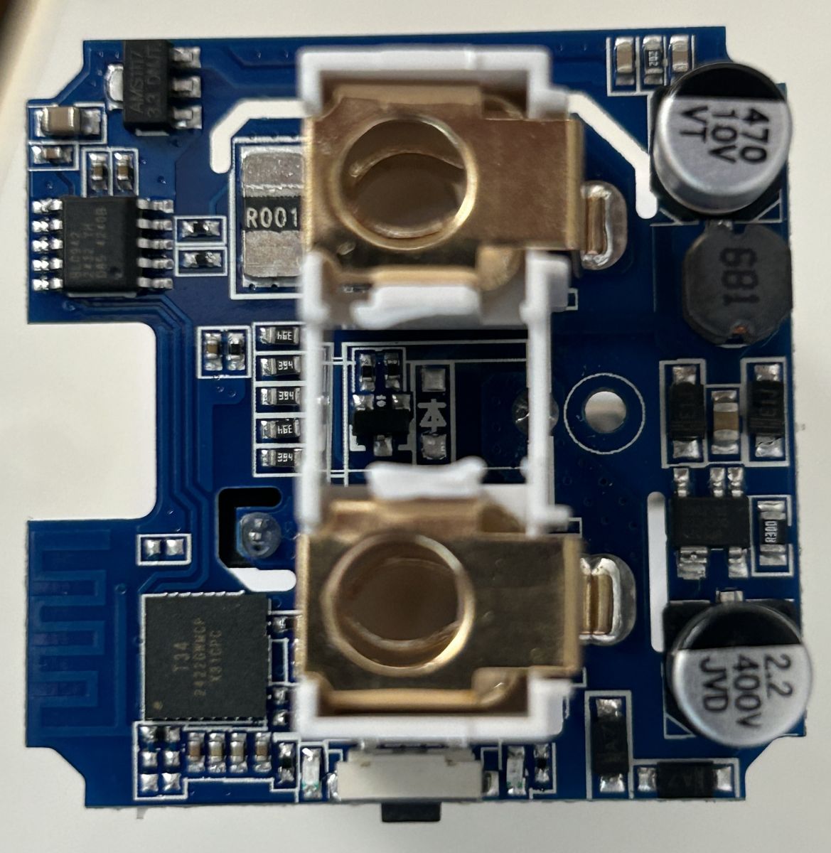

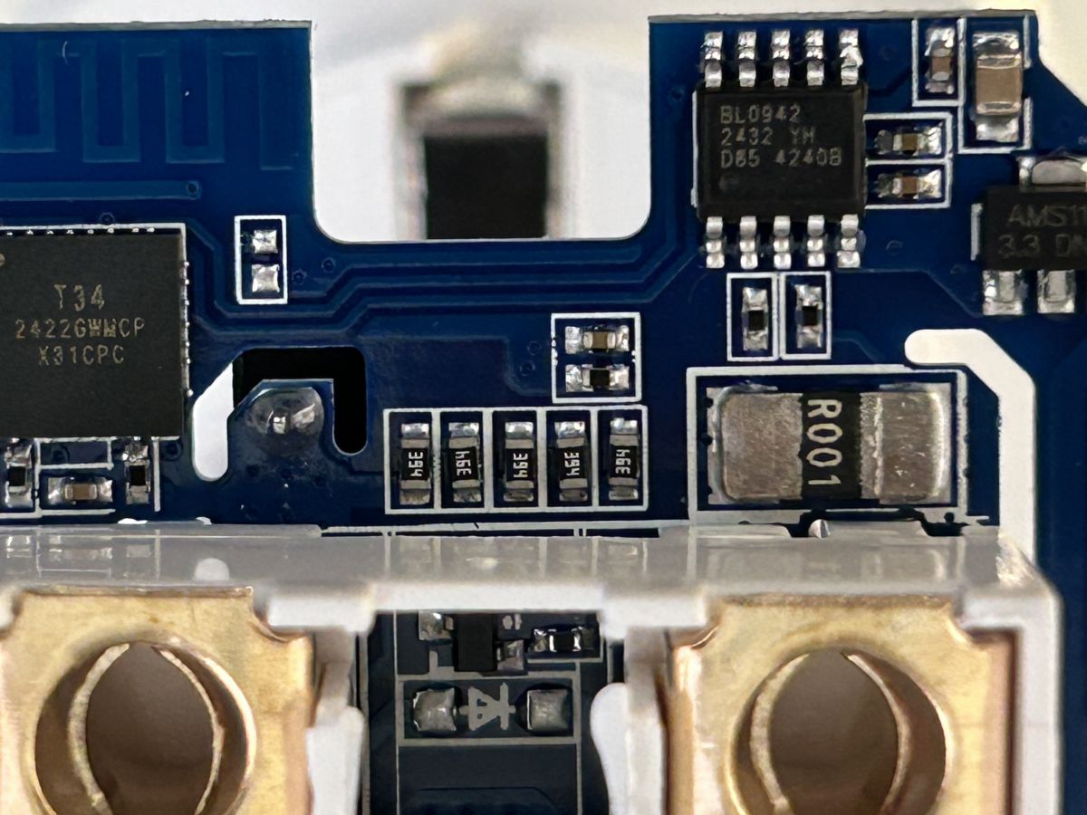

[T34/BL0937] Teardown Generic Wifi Smart Plug with Energy Measurement
Raufaser 38928 143

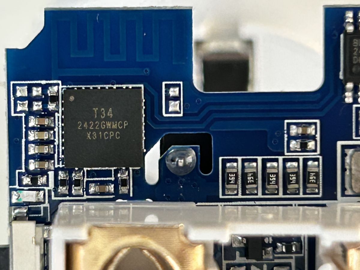

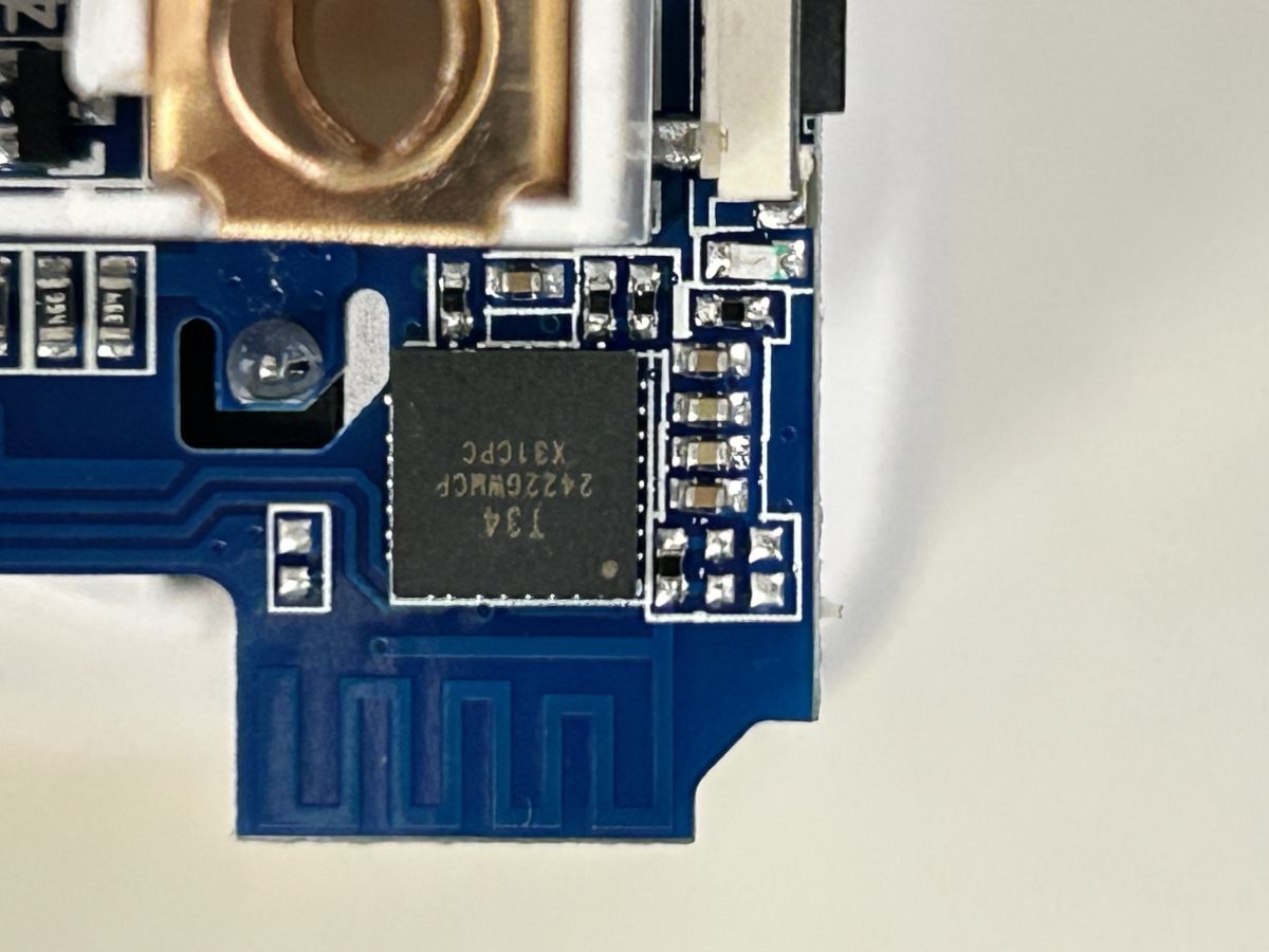

How can I flash a T34/BL0937 smart plug when the UART pads are hard to access?
Use a very fine-wire or needle method instead of trying to solder thick leads directly to the T34. The most practical setup in the thread is to leave the T34 on the PCB, solder 3.3V and GND to the AMS1117 pins, take TX from the exposed pad/resistor point, and touch RX with a sewing needle or thin enameled wire on pin 25; several users also needed an external 3.3V supply and a few power cycles before the flasher connected [#21044837] [#21373301] [#21334978] One reply notes that only one UART line is actually broken out on some boards, so flux and very precise soldering are needed, and if all else fails you can desolder the T34 and flash it off-board, though that is risky [#21005230] If your revision uses a BL0942/BL0492 energy meter instead of BL0937, flashing can be easier by connecting to the meter chip’s UART pins 9/10 plus VCC and GND, without modifying the T34 itself [#21364027] [#21420827]
  • #31 21055729
    donotos
    Only the T34 chip is directly soldered 3.3v on pin 8 and GND on pin 32 for this first attempt.

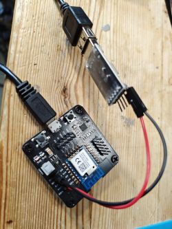

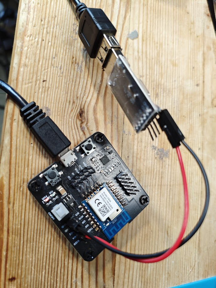

    I UART flashed it because it was the easiest way right now.
    However I took a backup from the original Tuya FW. I try to attach it here in case it's useful for you or anybody.
    • T34_Tuya_bup_2024-24-9-00-22-37.bin (2 MB) You must be logged in to download this attachment.
  • Boot log for BK7231N firmware 1.3.16

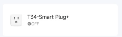

    Added after 11 [minutes]:
    The image shows an icon of a T34 Smart Plug with the label OFF.

    >>21238842 alas, no. there is no emulator to run Beken binaries
    I just flash to my little dev board and grab/pair with that
    Developer board with an inserted module and a connected USB cable.

  • Different board revision with smaller T34 chip
    #56 21324532
    rmoriz
    Greetings,
    I just received two Smart Plugs within the same packaging as OP, however the board looks different and the T34 seems to be smaller, around 6x6mm, see photos.
    Thanks
    Roland
    Close-up image of a circuit board with visible electronic components, including integrated circuits and capacitors. Close-up of a circuit board with an integrated circuit labeled T34. Close-up of a circuit board with electronic components, including a T34 chip. Close-up of a circuit board with a T34 2422GWMCP X31CPC microchip. White Smart Plug with a power button on the front.
    Printed circuit board with electronic components, including capacitors and connectors.
  • T34-based LSPA9 and flashing question
    #57 21324546
    Posts: 14677
    Help: 656
    Rate: 12705
    Another LSPA9 with T34.... well, it seems they are really using it more often now. I still remember ESP8266 LSPA9 times:
    https://www.youtube.com/watch?v=bnr3DADYcgU
    Then I saw WB2S LSPA9 (not documented by myself).
    and later I of course played with CB2S LSPA9 as well:
    https://www.elektroda.com/rtvforum/topic3887748.html
    And now they are T34-based, hm...
    Anyway, did you attempt to flash it already?
  • #58 21324552
    rmoriz
    >>21324546
    My eyes and my hands are too bad to solder anything on that 0,2mm that is left. This looks like a hot air job which is currently not feasible for me. (hot air station is in storage, no space left)
  • Needle trick for flashing tiny chip pins
    #59 21324829
    Tilator
    Posts: 137
    Rate: 13
    rmoriz wrote:
    >>21324546
    I had the same trouble twice before even though they were not exactly same devices.
    I used a normal sewing needle. Connected it to the TTL adapter wire. It just should be sharp enough to hold still on the leg of the chip.
    I only needed one needle because it was possible to solder a wire to the other serial line.
    Once I got it flashed and up, I updated FW using normal WebUI. Just in case not all flashing was well enoug made by the "needle trick".
  • #60 21325178
    rmoriz
    >>21324829
    thanks for the tip!
