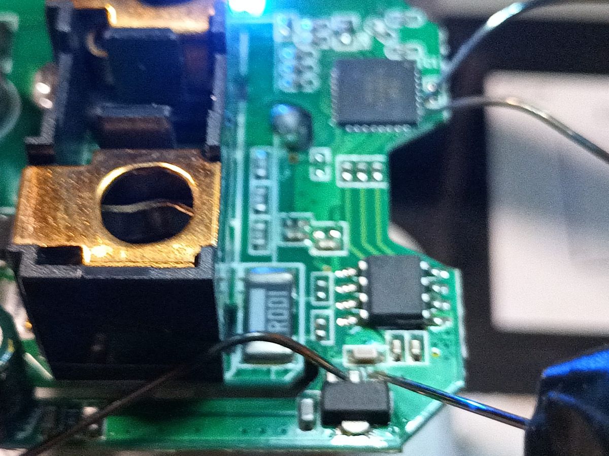

How can I flash a T34/BL0937 smart plug when the UART pads are hard to access?
Use a very fine-wire or needle method instead of trying to solder thick leads directly to the T34. The most practical setup in the thread is to leave the T34 on the PCB, solder 3.3V and GND to the AMS1117 pins, take TX from the exposed pad/resistor point, and touch RX with a sewing needle or thin enameled wire on pin 25; several users also needed an external 3.3V supply and a few power cycles before the flasher connected [#21044837] [#21373301] [#21334978] One reply notes that only one UART line is actually broken out on some boards, so flux and very precise soldering are needed, and if all else fails you can desolder the T34 and flash it off-board, though that is risky [#21005230] If your revision uses a BL0942/BL0492 energy meter instead of BL0937, flashing can be easier by connecting to the meter chip’s UART pins 9/10 plus VCC and GND, without modifying the T34 itself [#21364027] [#21420827]

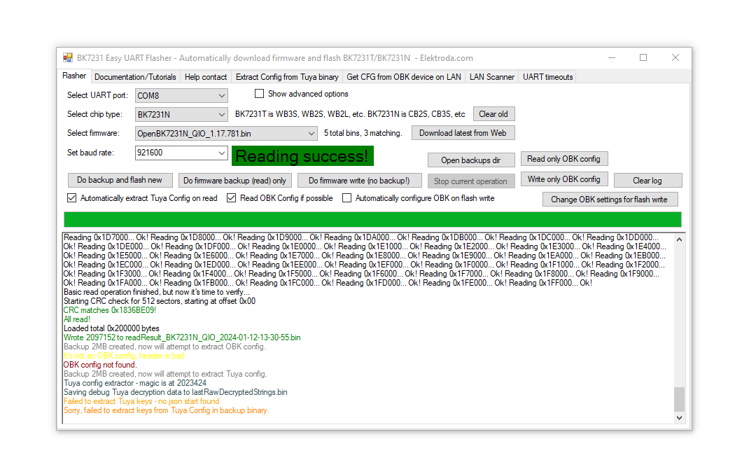

    Thanks for the quick reply, unfortunately I get the following error: "Failed to extract keys"
    Screenshot of a software tool for extracting keys from firmware files.
    I tried both, the tuya config and a complete dump. Any ideas?
    Edit:
    I did flash ESPHome to it and reverted to OpenBeken, not sure if this might cause issues.
    I'll flash OpenBeken to another one I've laying around and will extract the config again and report back.

    Only did a firmware backup (read) only this time, error seems to be the same:
    Screenshot of Easy UART Flasher with the message Reading success! and error Failed to extract keys.
    I attached the firmware backup and this is the complete console log:
    Tuya config extractor - magic is at 2023424
    Saving debug Tuya decryption data to lastRawDecryptedStrings.bin
    Failed to extract Tuya keys - no json start found
    Tuya config extractor - magic is at 0

    Backup 2MB created, now will attempt to extract OBK config.
    It's not an OBK config, header is bad
    OBK config not found.
    Backup 2MB created, now will attempt to extract Tuya config.
    Sorry, failed to extract keys from Tuya Config in backup binary.

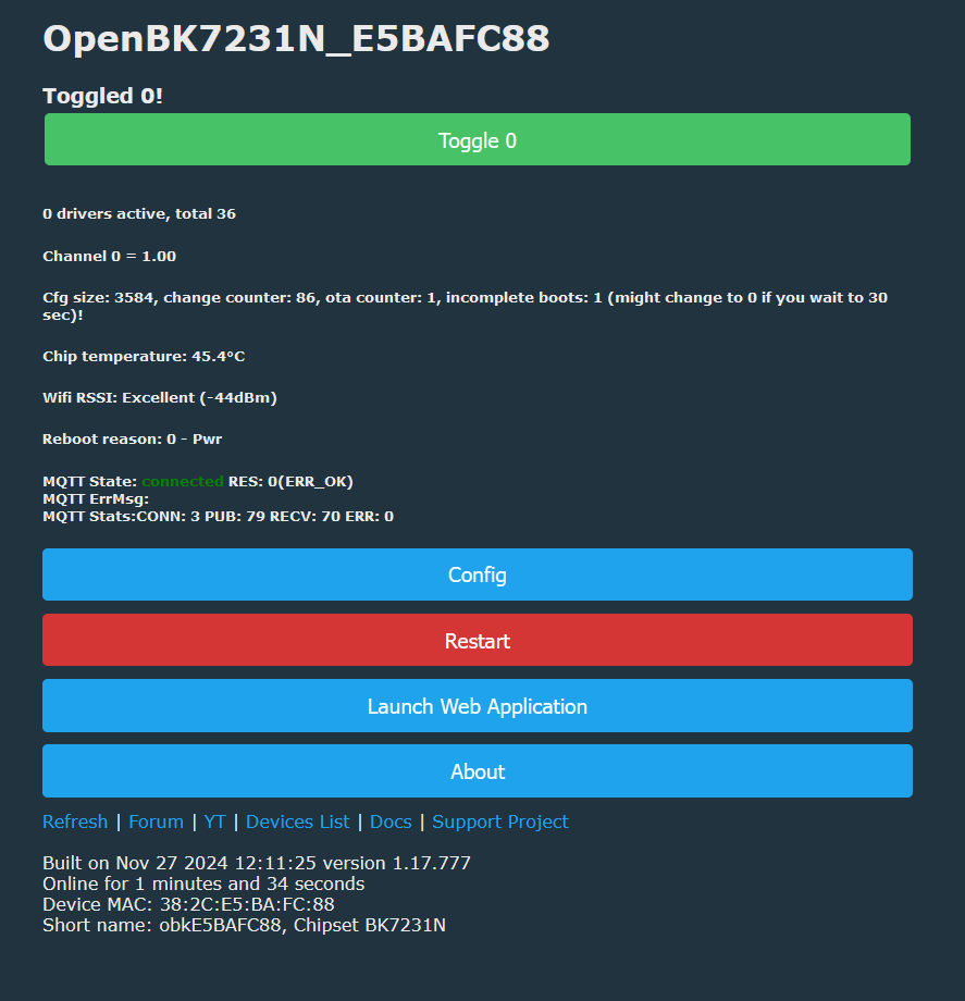

    I'm using the template from this thread (this post in particular: >>21052214 ):
    Screenshot of the user interface of the OpenBK7231N_E5BAFC88 application.
    I was under the impression that power metering has not been figured out yet for the T34, that's what I was asking to begin with. 😅
    Are there any other power metering templates for a T34?
  • Add T34 smart plug with BL0937 pinout
    #66 21327657
    Posts: 14677
    Help: 656
    Rate: 12705
    This template has BL0937 pins, maybe you didn't reboot? I can see you have no BL0937 driver running at all, so either you didn't set pins, or didn't reboot.

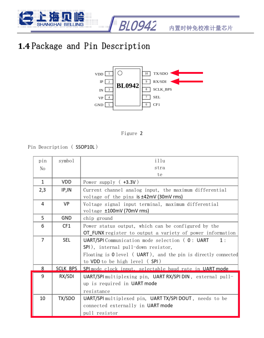

    the plag has a BL0942 connected to the T34 over UART1.
    Other pin configuration is:
    "pins": {
    "14": "Rel;1",
    "24": "WifiLED;0",
    "26": "Btn;1"
    (found via GPIO finder)
    Any idea how to read the powermeter via uart?

  • Looking for UART1 TX/RX pins on T34 LGA package
    #73 21333496

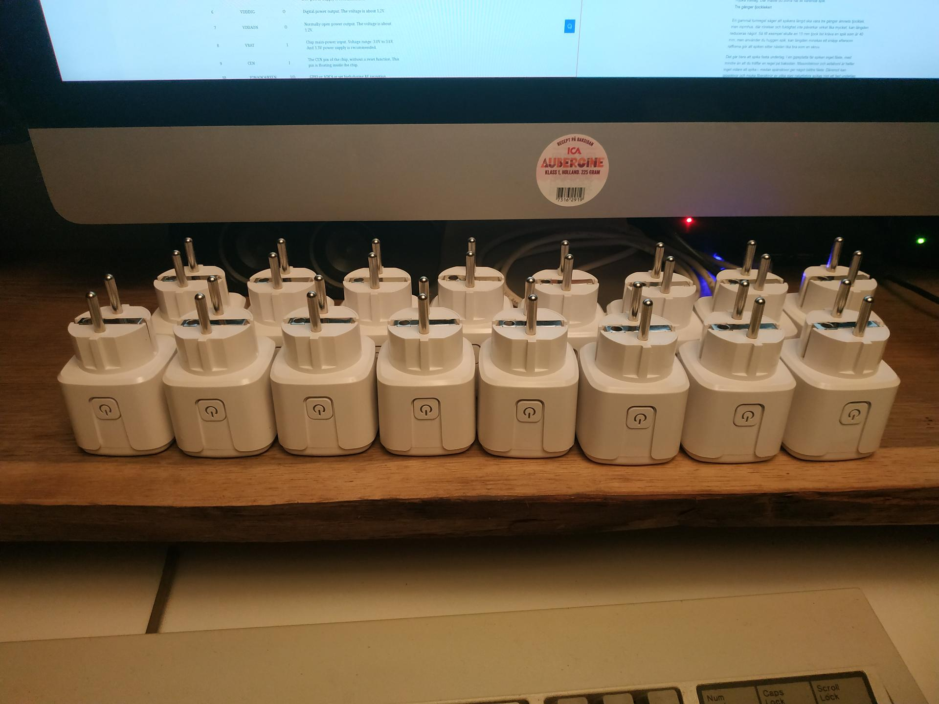

    Yetanfou
    Posts: 7
    >>21324532 Got the same device in a batch of 16, now looking for any possible connections to pin 25/26. Sewing needles etc. are of little help with this version since there isn't anything to point them at on this LGA package:
    Close-up of pins on an electronic device in an LGA package with visible solder connections.
    Those are pin 25-27 on the T34.
    I'll probably end up desoldering one of the T34's to see whether there is anything interesting under it which can be followed out - unless anyone here has a hint on where to point RX/TX at?
    In 20936155 p.kaczmarek2 mentions the BL0942 (which this thing comes with) always being on UART1 - is it? If so that would be a good place to start since it is UART1 TX/RX which are needed to flash?
    Pinout diagram for the BL0942 chip with pin descriptions.

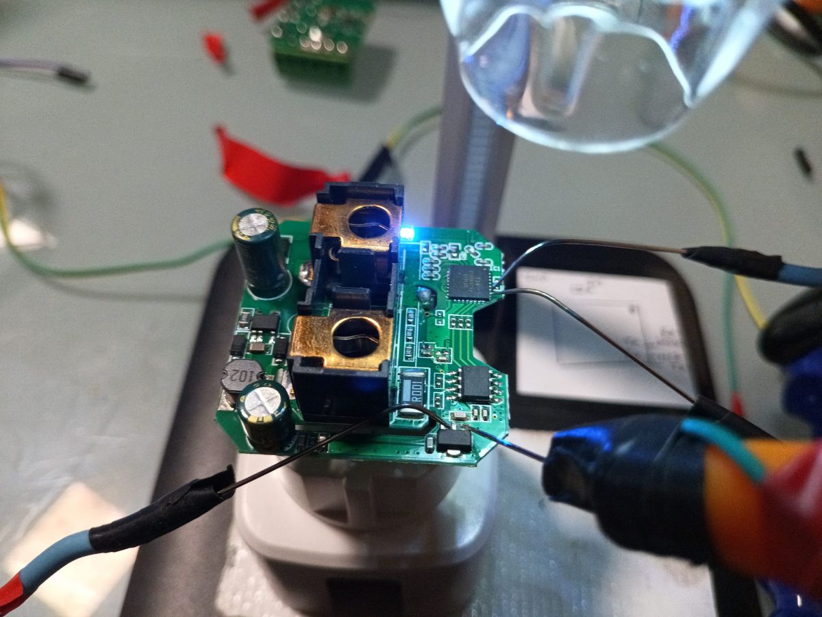

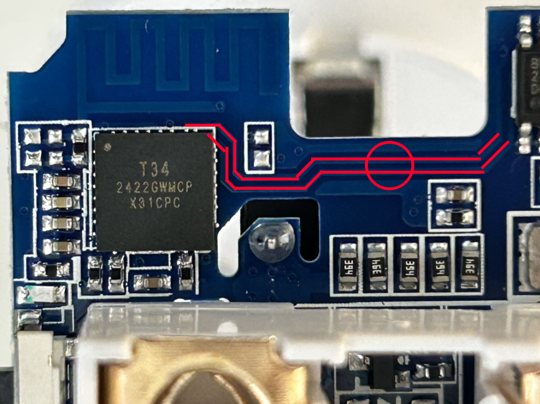

  • BL0942 can be flashed without board modifications
    #75 21334444
    Yetanfou
    Posts: 7
    >>21334298 I wonder if desoldering the BL0492 is necessary, I'll try it first without - if the BL0942 does not get initialized by the T34 I assume its RX/TX to either float or otherwise be pulled down inside the chip. Otherwise it may be easier to see if the two tracks leading from the T34 UART1 ports to the BL0492 can be temporarily cut somewhere around the circle in the image (verified: these are the correct tracks):
    Close-up of a circuit board with a T34 chip and red lines marking paths leading to a circle.

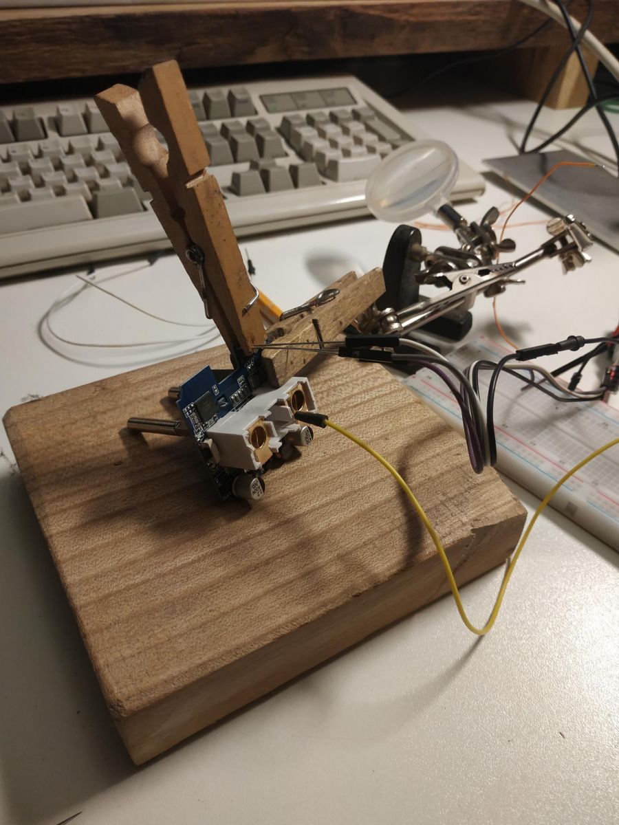

    ... then reprogram the thing, then bridge the tracks again. I'm going to flash at least 16 of these so the less desoldering, the better.
    I'll first try on an unaltered board.
    (edit)
    These devices can be flashed without any alteration to the board, all that is needed is a connection to ping 9 (RX) and 10 (TX) on the BL0942, a connection to VCC (3.3v, the 'tab' on the voltage regulator is a good spot to use for a pogo pin/sewing needle connection) and GND (use the copper plug receptable above/below the 1 mOhm (R001) resistor.
  • #76 21334772
    kubanekjiri
    Level 4  
    Posts: 8
    I tried it with BL0492 connected and it works!!!
    Close-up of a circuit board with connected wires.
  • #77 21334813
    Posts: 14677
    Help: 656
    Rate: 12705
    I think I can confirm it. In the past I've tried with LSPA9 and I managed to flash it with BL0942 on the board:
    https://www.elektroda.com/rtvforum/topic3887748.html
    It's actually very good that this T34 device has BL0942, it makes access to UART 1 easier.

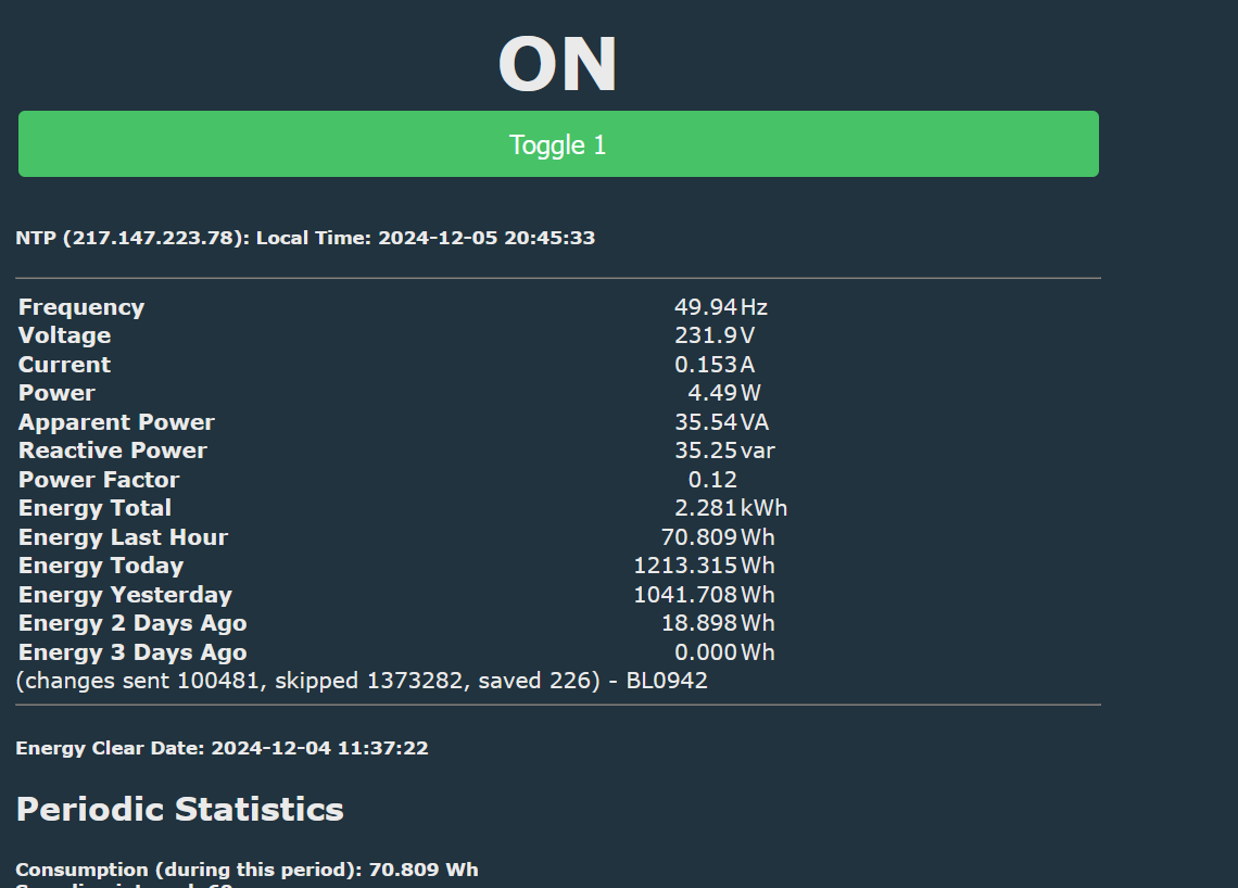

  • Configure pins, start NTP and BL0942 drivers
    #78 21334834
    kubanekjiri
    Level 4  
    Posts: 8
    after that
    set pins:
    "pins": {
    "14": "Rel;1",
    "24": "WifiLED;0",
    "26": "Btn;1"
    go to filesystem -> create file autoexec.bat
    add
    startDriver NTP
    startDriver BL0942
    calibrate minimal the power in section Tools, because without calibration they do not display power in Watt (the other variables corresponded with tuya original meter)
    and enjoy it ;)
    Screenshot of an energy consumption monitoring user interface.
    absolutely great work absolutely great work OpenBK7231T_App !!!!!!!!!!!!!!!!!!!!!!!!!!!!!!!!!!!!!!!!!!!!!!!!!!!!!!!!
    Edit:
    and click to: enable and setup some basic energy continuing
    for display one hour energy

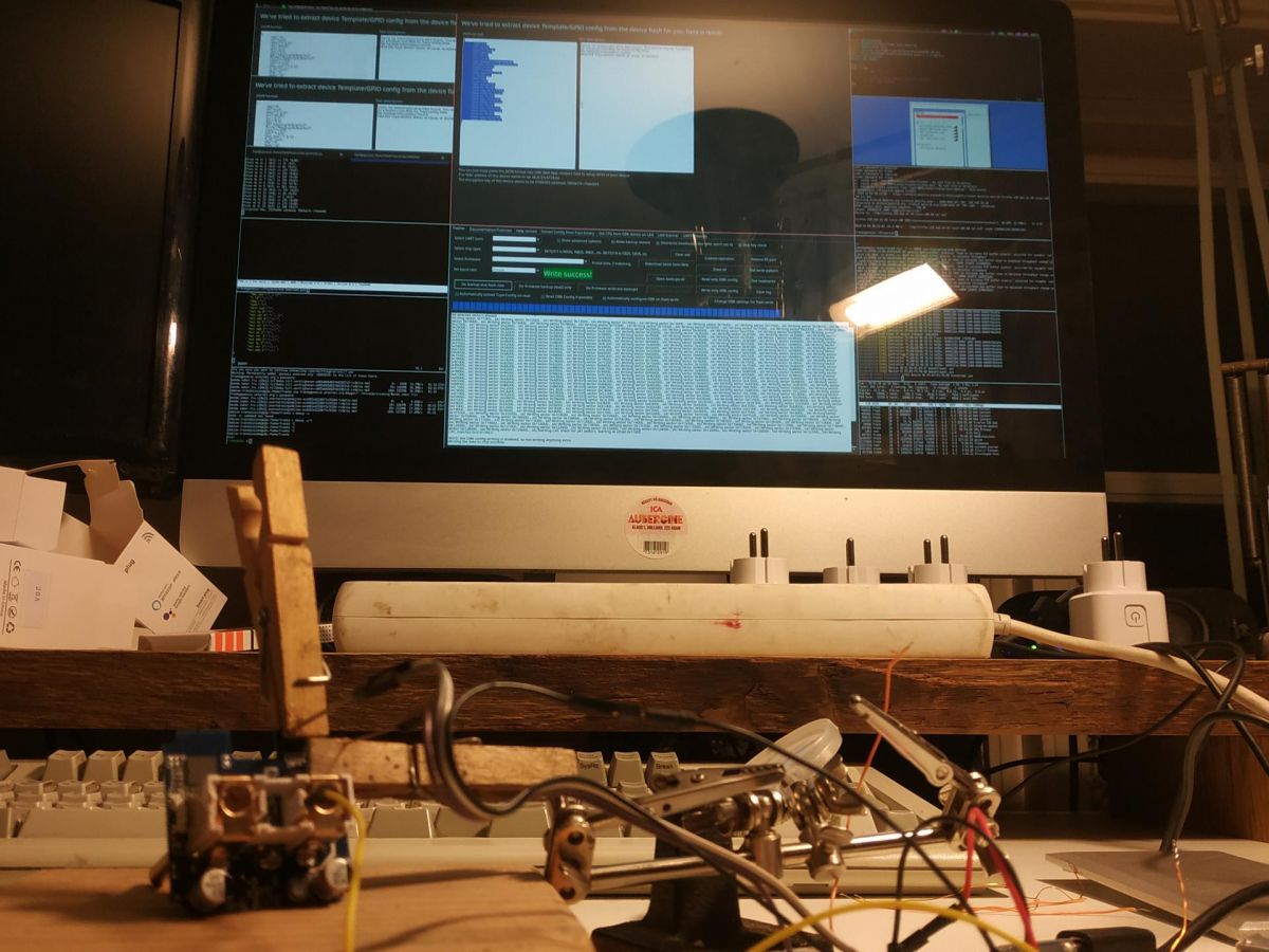

  • Asking about virgin plug and bus speed
    #79 21334867
    Yetanfou
    Posts: 7
    >>21334772 Good, here it has not thus far - the T34 boots to its normal routine and the bus does not become available. Did you do this on a 'virgin' plug? Mine is straight from China, running whatever Tuya-version is on the thing. What communication speed are you using?
    I'm using Linux, I got the flasher to compile and run with a few hiccups - some fonts are invisible etc - so there is a chance that my problems are related to that instead of the device itself.
  • #80 21334878

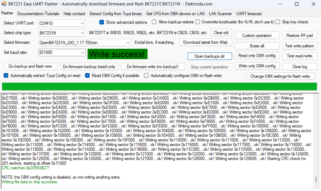

    UART timeouts increased to 15/15/5 fixed flashing
    #85 21334978
    Yetanfou
    Posts: 7

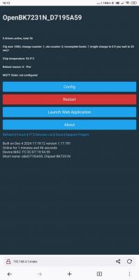

    Tried it with the older python-based uart program, same result - 'Cannot get bus'. I'm restarting the T34 by interrupting the 3.3v power supply to the board, as soon as the thing is powered up the led starts blinking fast (if it is in 'easy setup mode' or slow (when in AP mode - these modes keep across reboots. How do yours react when you provide power?
    (next day)

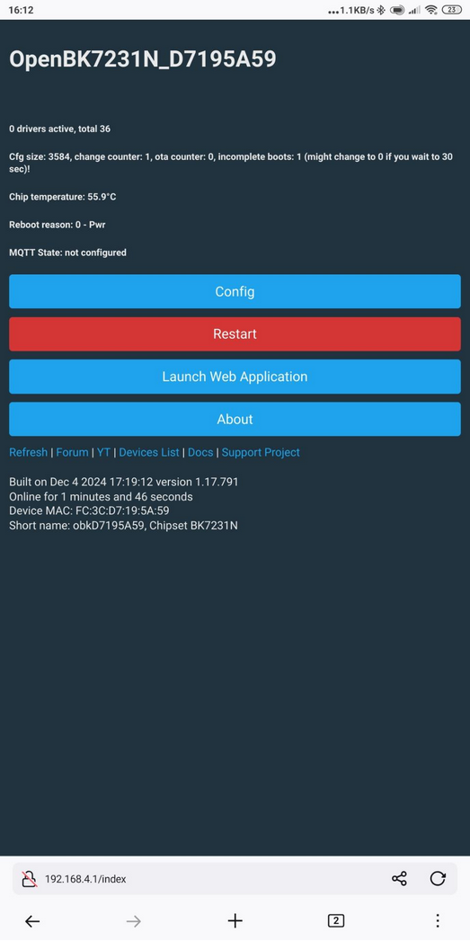

    Tried with another TTL/USB adapter which eventually - after increasing the UART timeouts to 15/15/5 - made it work. Write success! message on software screen
    OpenBK7231N application interface on a device screen.
    FYI, you only need to solder three wires - VCC/RX/TX - since GND is directly connected to the socket pin directly above/below the 1 mOhm (R001) resistor. Just sticking a wire between the copper and the casing is enough.
    Something like this:
    Set of 10 universal IC clamps for programming devices on sale.
    ...would make soldering unnecessary so I'll try to get hold of a set if I don´t create a pogo-pin-equipped mould first.
    (a bit later)
    Improvised kit for solderless flashing of an electronic circuit.
    Desk with electronics and a computer displaying data on the screen.
    Solder-free flashing with three sewing needles, two clothes pegs and a patch wire.
    (a few hours later)
    Row of 16 white electrical plugs arranged in front of a monitor.
    Done, 16 plugs reprogrammed.

  • Use BL0492 pins 9 and 10 for UART access
    #88 21364027
    Yetanfou
    Posts: 7
    >>21352386 Assuming the power measurement chip is a BL0492 I'd suggest using pin 9 and 10 of that chip to get at RX and TX, respectively instead of attempting to connect to the T34. There is no need to desolder anything, just connect to those two pins as well as the VCC and GND connections you already have and things should work.
    If you're having problems in resetting the chip - symptoms like 'cannot get bus' - you can try to reset the device by disconnecting GND instead of VCC (3.3v). This seems to be more reliable than the latter, probably due to some backfeed from the TTL/USB interface through the RX connection.
  • New OBK firmware breaks PowerSave 1 on T34 plugs
    #89 21365285
    rufus4
    Posts: 65
    Rate: 9
    I did buy some more plugs with T34 and flashed them with openBK and the newest BK7231Flasher.exe.
    There are two things changed for me:
    1. Backup of the original FW was not possible. Did try many times, but got always a CRC error.
    2. With new OBK Firmware "PowerSave 1" is not working anymore! Tried as startcommand and as autoexe.bat, but no success.
    I don't know since when it's not working anymore, but for ex. "OpenBK7231N_1.17.656.rbl" still works with "powerSave 1".
    Was there a change to activate PowerSave? @p.kaczmarek2
