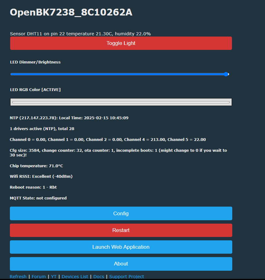

    Chip temperature: 58 °C. Is this the normal temperature of the socket standby chip?
    Thanks for your help.

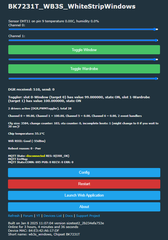

  • PowerSave 1 may reduce temperature
    #123 21440305
    Posts: 14677
    Help: 656
    Rate: 12705
    This is a tiny temperature and in addition it is only shown for reference, it is not a precise measurement. For comparison, my dev board:
    OpenBK7238 user interface with temperature and humidity readings. .
    My LEDs above the window:
    Screenshot of a user interface displaying BK7231T system parameters. .
    If you want to try to reduce the temperature and you are not using BL0937, you can try to autoexec.bat or to the startup command line add PowerSave 1 .

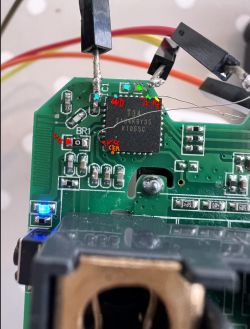

    Hi everyone,
    I've been following this thread because I'm interested in flashing a smart plug that uses these chips. However, I'm quite new to this topic and would really appreciate some guidance.
    1. Which schematic should I follow to perform the flash? Should I connect to the T34 chip, or are the flashing pins also available on the BL0937?
    2. Is the 3V supply from the TTL-USB adapter sufficient, or do I need an external power source?
    3. Which specific firmware should I flash?
    Thanks in advance for any help!

    welcome,
    1. Go the way that suits you. If it does not work, choose another.
    2. This depends on the adapter. If it has a big capacitor, it could work. If not, better use an external power supply.
    3. Go with the newest, maybe visit the changelog to be informed about bigger changes.

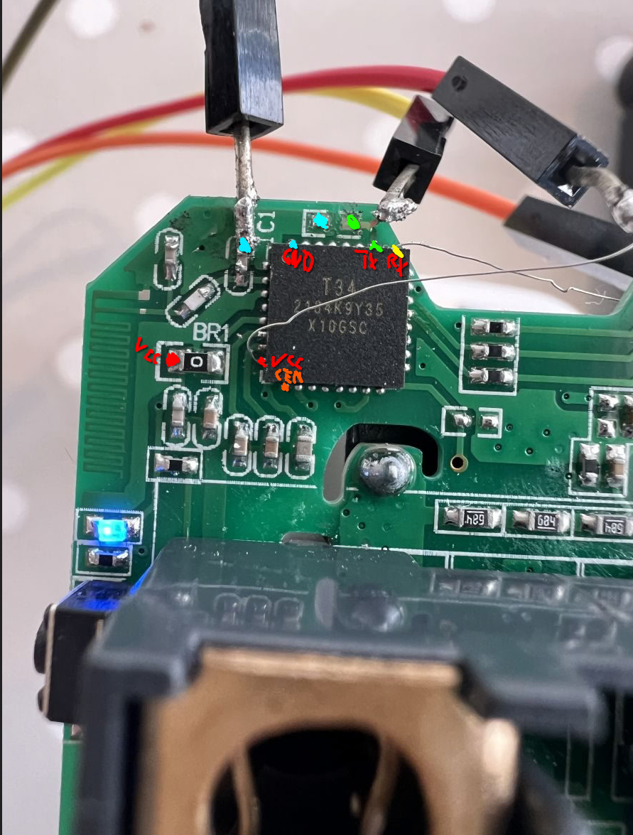

    Trying to answer your questions:
    If the layout of your T34 chip allows to access the pins with needles, you may try to adopt the solutions shown in this thread:
    https://www.elektroda.com/rtvforum/topic4051203.html
    The pins are not connected to the BL0937.
    Usually it's impossible to tell if a specific adapter works, but they usually do. I would advise to use a separate power supply in every case, but it might be sufficient to power the pins of the plug with a power supply, sometimes 12 to 15V is enough to start the plug without connecting to high voltage.
    T34 is the "BK7231N" chip.

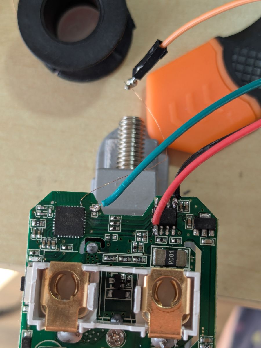

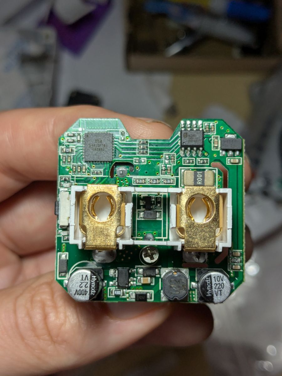

    I wish I had found this thread before doing everything - this is my working attempt, I held the 3v3 with my hand which came handy when I was resetting power.

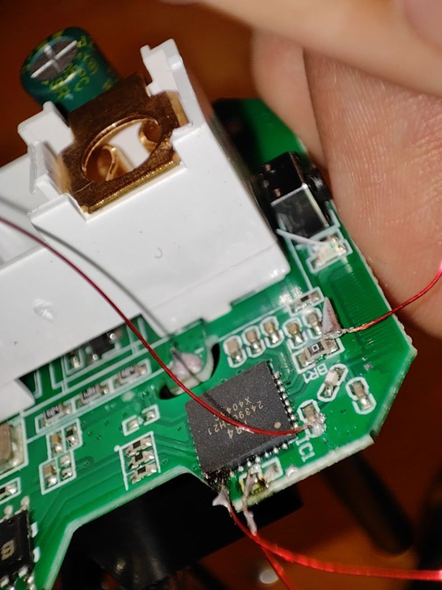

    I have a variant of this board (bought from https://nl.aliexpress.com/item/1005008591175083.html), which at first I thought was the board from https://www.elektroda.com/rtvforum/topic4099021.html but in green as the antenna layout is the same, but it comes with a BL0937 instead of a BL0942.
    Smart plug PCB with visible power terminals and microchips, close-up view
    The T34 has a different serial 244TGF187 but the pinout is the same, I confirmed 3.3v and GND with the pins on BL0937, and TX is also broken out to an unpopulated pad, which leaves RX being the hardest pin to tap into. I don't think that pin is used anywhere so I'll have to use the needle method or push my luck with trying to solder some enameled wire to a 0.2mm exposed area (I have never micro soldered before).
    Edit:
    To my own surprise I managed to solder the wires
    Close-up of a PCB with thin wires soldered to microcontroller pins
    And was able to dump the firmware
    Edit2:
    Flashed succesfully and the config for the pins is working (https://www.elektroda.com/rtvforum/topic4042412.html#21030449). The wifi is really bad though, worse RSSI than other smart plugs on the same location.

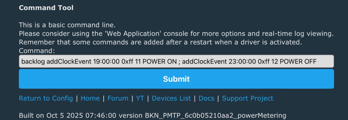

    I didn’t get any replies last time, so I’ll try again:
    Is it possible to set up a routine (for example, turning on at time X and off at time Y) that will still work even if the device is not connected to a network? If yes, how?
    Thanks.

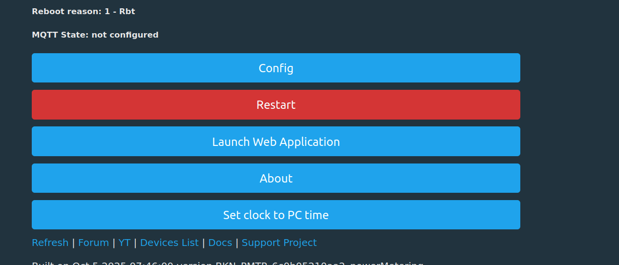

  • Clock automations need NTP and reboot loss handling
    #137 21705865
    Posts: 14677
    Help: 656
    Rate: 12705
    Maybe addClockEvent?
    As long as NTP gets time and device won't reboot, it will work.
    If your device will get a reboot (power off and on), then time will be lost - it's not possible to maintain time due to the power loss. You'd have to use battery backup like CR2032 etc
    EDIT: I don't know about ESP stuff, they have used some strange OTA format that is not easily generated by our SDK. But I can help you with getting clock automations running.

    I would think this is a good case for my extension to the clock in PR#1729.
    I will later add one for your device which will provide a simple method to set the clock to your devices time in the GUI (ENABLE_CLOCK_PMNTP - I christened it "poor man's NTP"). No need for a network, you can leave it even in AP mode as long as no one will misuse the open AP.
    Then a simplified version of the above is sufficient: only add two repeated events every day to switch the relay on and off.

    Set clock with GUI:

    If you don't want it in startup command, but use in "Execute User Command" you can insert two commands with "backlog" like
    backlog addClockEvent 19:00:00 0xff 11 POWER ON ; addClockEvent 23:00:00 0xff 12 POWER OFF
    Command Tool interface with entered command scheduling power on/off times
  • Backlog commands must be launched one at a time
    #142 21718107

    >>21710799 Ok, thanks. Quick update: I successfully flashed your firmware, and setting up the time works perfectly. However, I tried configuring the two commands both through “Execute User Command” and as Startup commands, but nothing happens when the scheduled time is reached. Any idea what might be wrong?
    EDIT. The issue was backlog. Launching one command at a time fixed the issue and now it's working correctly.
