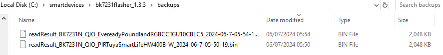

    The backup procedure varies depending on the platform, but the easiest and most common (regarding OpenBeken) is with openshwprojects's Easy UART Flasher for Beken BK7321N/BK7231M/BK7231T/T34/BL2028N IoT ICs
    Both highlighted buttons in Easy Flasher will create a backup file in the \backups subdirectory of the Easy Flasher root folder.

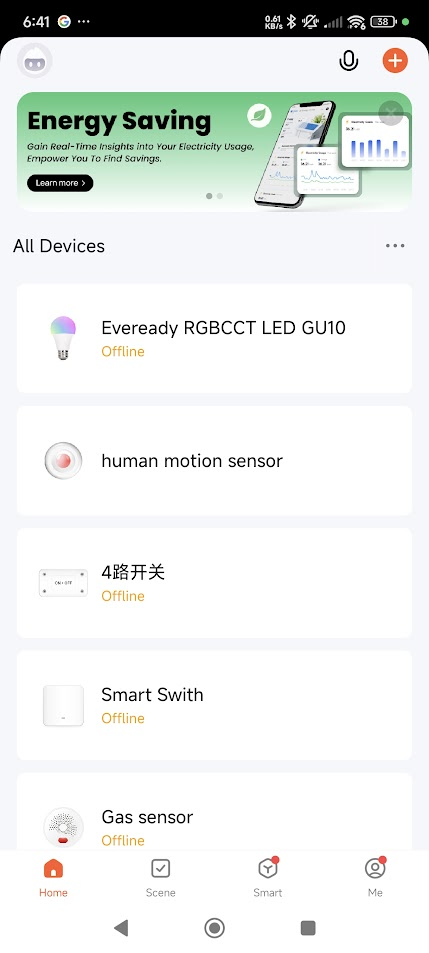

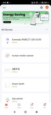

    If the device has already connected to your wifi with an official app, Magic Home, Cozylife, Tuya, Blitzwolf, eWelink etc, then it'll have saved your SSID and wireless password in its memory in order to achieve this. Potentially this data can be read by others if they have access to your firmware backup file.
    Protecting Your Privacy: Scan IoT Firmware Backups for Sensitive Information

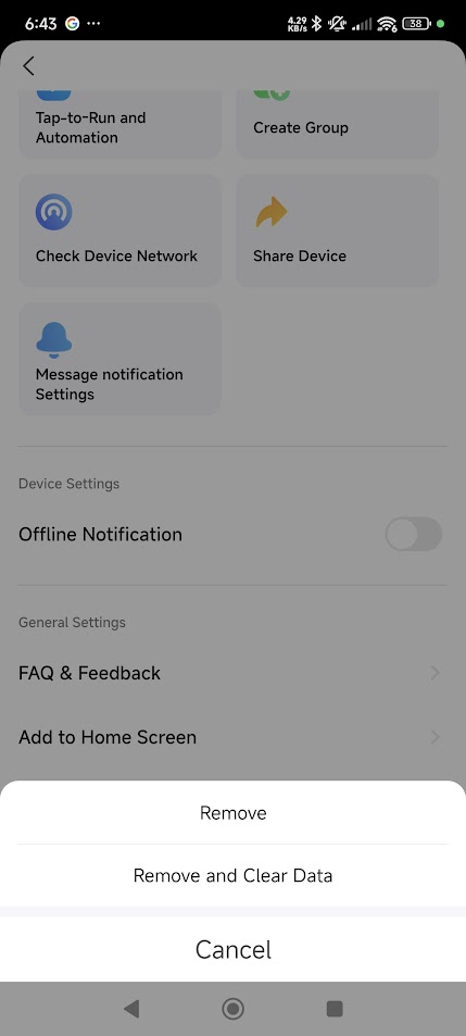

    It is sometimes the case that even after factory resetting the device using the Remove Device -> Remove and Clear Data options in the app and/or resetting using the push button reset procedure, that a subsequent firmware backup will contain some identifiable information. I have seen this on a number of occasions. eg https://www.elektroda.com/rtvforum/topic4063490.html

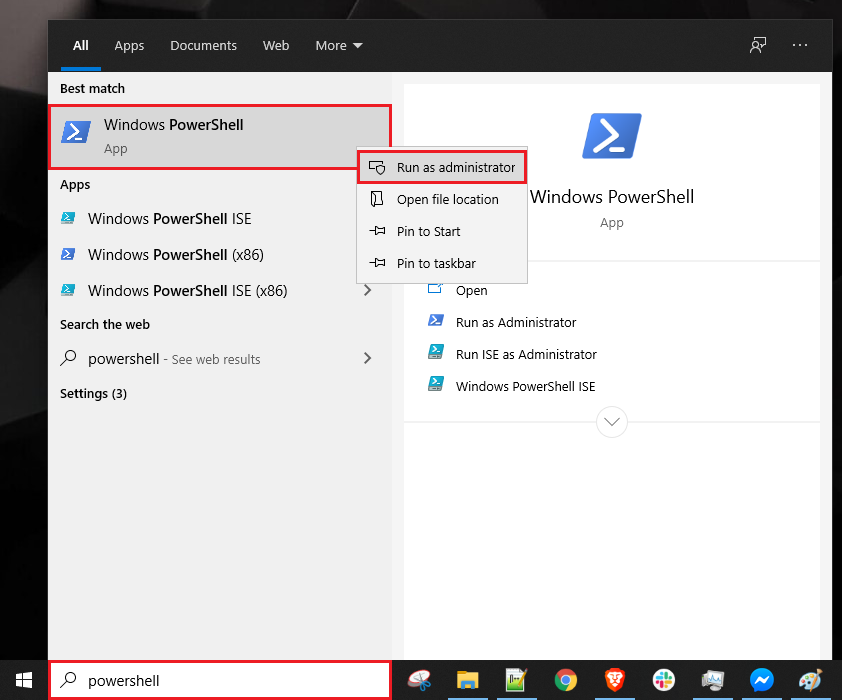

    Unzip the PowerShell script to a preferred location, eg c:\scripts. Elevate PowerShell (run as administrator)

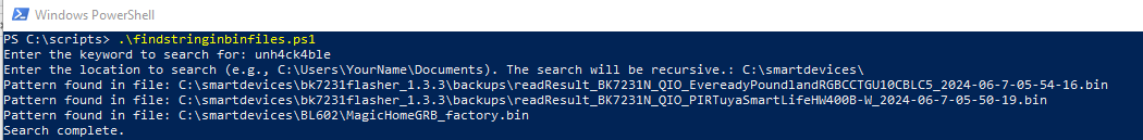

    Run the script with command .\findstringinbinfiles.ps1 (or whatever you renamed script to)
    Enter part or whole of SSID or your wifi password used to pair device originally and enter the root folder of your backups when prompted. My test backups are in C:\smartdevices. The search is case-sensitive so enter the exact partial or whole match.
    The script will recursively look for all files with extension .bin and return any that contain a match to the keyword entered. My examples:

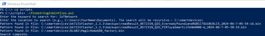

    and now the same with a part-password search

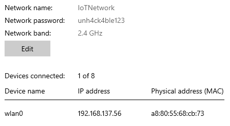

    These devices were joined to this test Windows hotspot with the Tuya/MagicHome app before I took a backup
