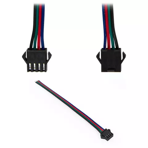

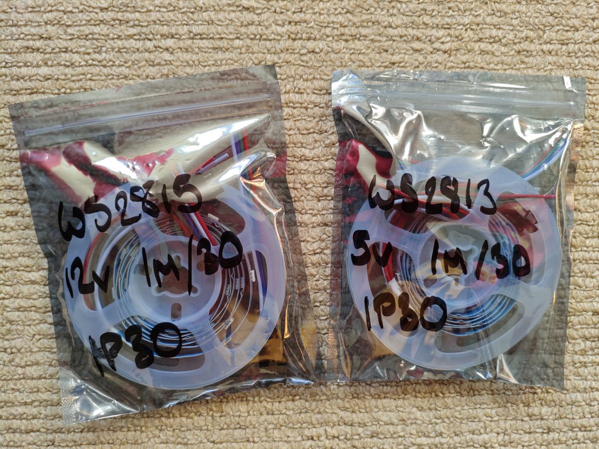

    OK so the WS2813 and WS2815 LED strips have backup data lines, but does the backup data line have to be used? can you connect it up to a WS2812B (with correct voltage appropriate for the strip type) controller with one data line and expect it work? Will it work but just be dimmer because of the difference in operating frequencies?
    4-pin connector cable with black, green, blue, and red wires
    Two LED strips in ziplock bags labeled with marker, lying on beige carpet.

    Initial assessment
    You’re comparing WS2812B vs WS2813/WS2815 strips and asking:
    - Do WS2813/WS2815 require the backup data line (BI)?
    - Can you drive them from a “WS2812B” one-wire controller?
    - Will they be dimmer due to different operating frequencies?
    Direct answer
    - No, the backup line is not required. You can leave BI unconnected.
    - Yes, you can drive WS2813 and WS2815 from a single-data-line WS2812B-style controller, provided voltages and timings are correct.
    - No, they won’t be dimmer because of protocol/data frequency. Brightness is set by current and PWM duty, not by whether BI is used or by the 800 kHz data rate.
    Detailed technical analysis
    - Protocol compatibility
    - WS2812B, WS2813 and WS2815 all accept the same 1‑wire NRZ protocol at ~800 kbit/s. Libraries/drivers that work for WS2812B typically work unchanged for WS2813/WS2815.
    - One caveat: WS2813/WS2815 specify a longer reset (latch) time after a frame (≈280–300 µs) than WS2812B (≈50 µs). Most modern drivers already use a long-enough reset; if yours hard-codes 50 µs you may see occasional glitches on WS2813/15.
    - Backup line (BI) function
    - BI is a redundancy path (“break‑continue”) so downstream pixels can keep receiving data if a single LED’s main DI/DO path fails.
    - Leaving BI floating at the strip input is fine; the strip will operate normally via DI.
    - If you want first‑pixel redundancy, you may feed the controller’s data to both DI and BI at the strip input (often just tie them together near the connector, optionally via 100–330 Ω). That way, if pixel 1 dies, pixel 2 can still receive data on its BI line.
    - Brightness vs “frequency”
    - Data rate (800 kHz) only determines how fast you can refresh the pixels; it does not change per‑pixel brightness.
    - Perceived brightness is determined by each IC’s constant current and PWM duty for R/G/B. Different families may have slightly different per‑channel current and gamma, so absolute max brightness can vary a bit between WS2812B vs WS2815, but that difference is not caused by data frequency and not by using or ignoring BI.
    - Voltage and signal‑level points
    - WS2813: 5 V strip. Data input is 5 V‑logic compatible; many runs work with 3.3 V data over short distances, but a 5 V level shifter is safer.
    - WS2815: 12 V strip (three LEDs in series per color). Data input is 5 V‑logic compatible. 3.3 V data sometimes works but is marginal; prefer a 5 V data level (use a 74AHCT125/74HCT14 or a MOSFET level shifter) especially with longer leads.
    - Always share ground between controller and strip. Add a 220–470 Ω series resistor in the data line at the strip end and a bulk capacitor (e.g., 470–1000 µF) across V+ and GND at the strip input.
    Current information and practical notes (OBK context)
    - In OpenBeken, the “SM16703P/WS2812” backend drives WS281x‑type strips. Typical steps:
    - startDriver SM16703P
    - SM16703P_Init <pixelCount> [colorOrder] (color order often GRB)
    - Optional: Anim/AnimSpeed for built‑in effects.
    - If you switch between WS2812B (5 V) and WS2815 (12 V) hardware, only power wiring changes; data/control commands are the same. Ensure your power supply and injection plan match the strip voltage and length.
    Practical guidelines
    - Short runs, hobby setups: connect DI only; leave BI unconnected; it will work like WS2812B.
    - Reliability-sensitive installs: tie controller data to both DI and BI at the head of the strip to gain “first‑pixel” redundancy.
    - Long cables or 3.3 V MCUs: use a 5 V level shifter; keep signal ground solid; add the series data resistor and bulk cap; consider data re‑buffering every few meters.
    Possible disclaimers
    - Vendor “WS2815/WS2815B” variants and clones can differ slightly in timing and max current. If you see odd behavior, increase reset time and verify color order and timing in your driver.
    Summary
    - Backup line: optional.
    - WS2813/WS2815 work from a WS2812B‑style one‑wire controller.
    - No dimming due to data frequency; any brightness differences come from LED/driver current characteristics and power distribution, not from using/ignoring BI.
    Questions for you
    - What MCU/controller and data voltage (3.3 V or 5 V) are you using?
    - Approximate strip length and cable length from controller to strip?
    - Do you want first‑pixel redundancy, or is basic operation sufficient?

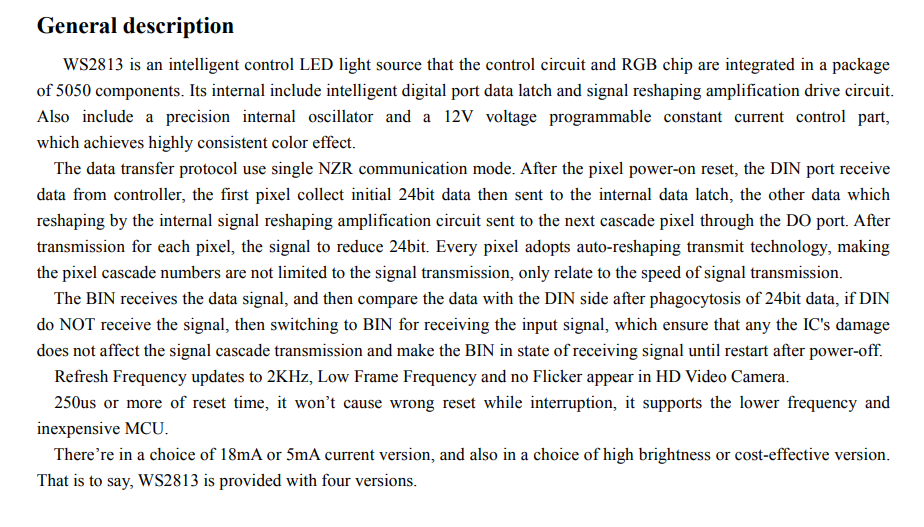

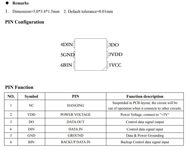

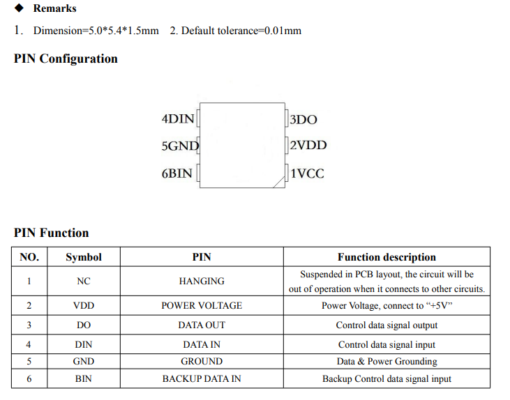

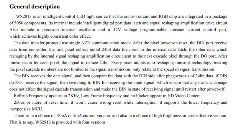

    Considering how long are those AI-generated replies, maybe it is easier to just check datasheet:
    Pin configuration diagram with table of pin functions for a 6-pin chip
    Technical description of WS2813 intelligent LED source with RGB control functions

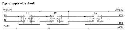

    It seems that BIN (Backup In) is just an optional shortcut around the previous LED, which is used when previous LED is broken, so the signal can continue. A very clever solution, I must admit...
    Typical application circuit with chained logic ICs
    So, let's consider two scenarios:
    1. L2 on my schematic is working - then it gets signal from DI and uses one pixel and forwards rest of the data on DO - ok, everything works. Then Ln on my picture receives that signal and continues
    2. L2 on my schematic is broken - then signal on DI gets ignored and output on DO is dead - the strip would usually break at this point, but Ln (next LED) has BI connected to DI (the input) of L2, and Ln detects that L2 didn't send anything on DO, so it switches to DI, and gets signal from before L2. So, one pixel is skipped (L2 is dead), but strip works
    Added after 9 [minutes]:
    My conclusion: when connecting two strips together, connect DO to DI and BO to BI.
    When connecting strip to OBK/WLED/ESP/any controller, connect both DI and BI to signal output.
    Otherwise , if you don't connect BI to signal output, and first LED breaks, then you won't get any other LEDs to work (backup lane not connected)

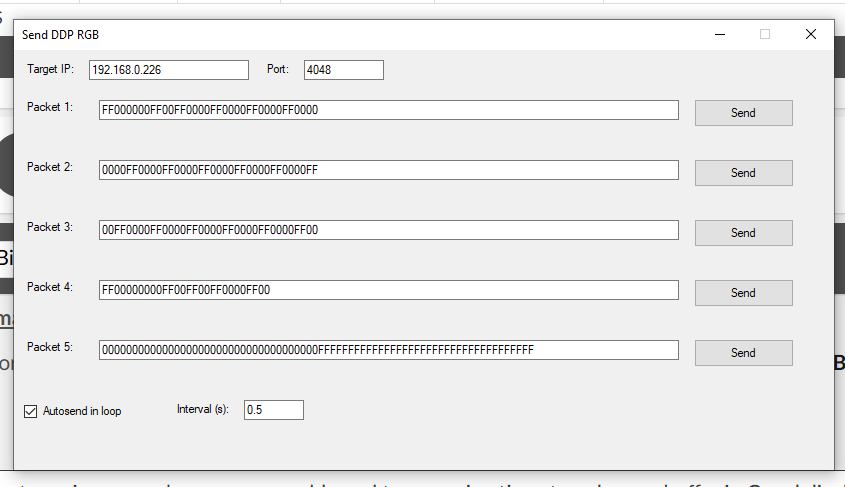

    I'm not sure about preview on web page, we would need to run animations to a dummy buffer in C and display it.
    Still, you can easily preview animations in Simulator, I think.
    I am also creating DDP tool (with LLM - these days they are already good enough for it) for testing:

When wiring WS2813 or WS2815 strips, how should DI, BI, DO, and BO be connected for first-pixel backup and controller compatibility?
Connect DO to DI and BO to BI between strips. At the controller end, connect the controller signal to both DI and BI if you want first-pixel backup. The thread’s conclusion says leaving BI unconnected at the first pixel removes the backup path if that first LED fails. This wiring preserves the bypass behavior that keeps the rest of the strip working when one pixel dies. [#21653933]
