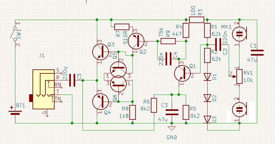

    What if I had two regular microphones and one inside the case, this one should pick up mainly surface noise and crackle, something that would need to be subtracted from the signal from the microphone that is in contact with the air outside the case?
  • Poor noise subtraction from dual microphone setup
    #32 21133436
    yego666
    Posts: 2175
    Help: 239
    Rate: 564
    TechEkspert wrote:
    And if you had two regular microphones and one inside the enclosure, this one should pick up mostly surface noise and crackle, something that would need to be subtracted from the signal from the microphone that is in contact with the air outside the enclosure?
    This is what I did, but the effect was poor. Maybe I was isolating the other microphone too poorly? But I've done trials with several different insulations, although the felt was not tried.

  • DC volume control enables speech-band equalization
    #37 21133970
    bratHanki
    Posts: 5776
    Help: 457

  • Anti-local circuit to reduce mum’s voice
    #50 21144260
    Janusz_kk
    Posts: 5872
    Help: 228
    Rate: 1480
    yego666 wrote:
    Now I think I'm going to have to make a few more copies of the amplifier for everyone in the house so they can all hear each other properly
    No, you need to make an anti-local circuit, meaning an extra microphone on top of the box that will catch what Mum is saying and a differential amp that will subtract this from the microphone at the front, then she won't be heard as much and will speak louder.
  • #51 21144282

  • LM4871 or 8002 suggested for mic amplifier
    #52 21144450
    bratHanki
    Posts: 5776
    Help: 457
    Rate: 1414
    Janusz_kk wrote:
    No, you need to make an anti-local arrangement, that is, on top of the box an extra microphone which will catch what Mum is saying and a differential amp which will subtract this from the microphone at the front, then she won't be heard as much and will speak louder.
    Wouldn't it be better to add the simplest dynamics compressor? Take the output signal, rectify it and control it with an input signal divider composed of a resistor and a transistor? You could also vary the voltage supplying the electret microphone.
    Instead of transistors, I suggest using an LM4871 or 8002 .
  • Dual microphone setup for separate ambient and voice pickup
    #53 21144479
    yego666
    Posts: 2175
    Help: 239
    Rate: 564
    Maybe I'll change something in a while if persuasion doesn't work.
    Just as a quick aside, I'm wondering if in an arrangement like the one below it would work if one ( top ) microphone listened to the environment and the other ( bottom ) to my Mom.
    I might still give some resistance to adjust somewhere, but the idea is rather clear I think.
    Electrical circuit diagram featuring two microphones, various components, and connections. .
  • Headband microphone may reduce occlusion effect
    #54 21144552
    bratHanki
    Posts: 5776
    Help: 457
    Rate: 1414
    I don't know if this will do anything because the two microphones will be close to each other so they will practically pick up identical sounds. The anti-local system works well when two different transmissions reach the device, but one of them goes over the wire. In this case, the effect of hearing oneself could be weakened if the microphone was placed on the headband of the headphones, in an additionally attenuated tunnel a few cm long, and not on the neck under the chin.

  • Microphones placed on different walls at 90°
    #55 21144614
    Janusz_kk
    Posts: 5872
    Help: 228
    Rate: 1480
    bratHanki wrote:
    I don't know if this will do anything because both microphones will be close to each other so they will practically pick up identical sounds.
    After all, I wrote that they have to be on different walls, one on top of the other at the front, meaning they will be at 90st angles to each other. In addition, putting them in foam will isolate them a bit from the case.
    Added after 1 [minute]:
    yego666 wrote:
    Maybe I'll still give some resistance to adjust somewhere, but the idea is rather clear I think.
    I'm not sure if such a connection wouldn't work as a combiner. Need to check.

Key insight: The most useful improvement was not extra complexity. It was matching the circuit to one user: lower noise, low standby drain, and mechanics that the user could actually wear and switch on easily.
  • Measured quiescent current was about 3.2 mA, and the author reported useful sound pickup from about 5 m without audible-band distortion. [#21129428]
  • The finished unit used an about 800 mAh Li-Ion cell under the PCB, giving roughly about a week of runtime if left on continuously. [#21130913]
  • Charging was done from an old Nokia charger at about 100 mA through a 20 Ω resistor for 10 hours, which worked in practice but was explicitly described as not recommended for Li-Ion cells. [#21129428]
  • Headphones of 16 Ω, 32 Ω, and 64 Ω were all reported as workable, with the author using 32 Ω earphones in series and cable-mounted volume control. [#21129428]
  • Replacing 1N4148 bias diodes with transistor-connected Q5/Q6 removed visible output-stage switching artifacts identified later as crossover distortion. [#21130748]
How was this homemade hearing amplifier circuit improved over the original Talking Electronics design to reduce noise and cut quiescent current below 3 mA?
It was improved by simulating the borrowed Talking Electronics circuit in LTSpice and then reworking it for lower idle drain and less noise. The author states the original had very high resting current and much noise, while the revised version achieved a flat gain response from about 80 Hz to the limit of audibility, around 10 kHz, with under 3 mA intended idle current and about 3.2 mA measured. That makes the redesign a practical optimization, not just a copy. [#21129428]
Why did replacing the BC109C input transistor with a 2SC9014 noticeably reduce noise in this hearing amplifier?
Replacing the BC109C with a 2SC9014 reduced input-stage hiss in this specific build. The author tested both parts and reported that BC109C made the noise too high, while the 2SC9014 dropped noise well below the expected level, so it stayed in the final version. The thread does not provide lab noise figures, but it clearly records a before-and-after hardware change on the microphone input stage. [#21129428]
What is crossover distortion in a class-AB transistor output stage, and why did using transistors Q5 and Q6 instead of 1N4148 diodes help eliminate it?
"Crossover distortion" is output-stage distortion that appears when complementary transistors hand over conduction near zero crossing, creating a notch or gap if bias is too low. Using Q5 and Q6 as diode-connected transistors raised the effective bias above what 1N4148 diodes provided, so the output pair no longer showed the visible "saddle" on the oscilloscope. A later reply explicitly named the fault as crossover distortion and tied it to insufficient resting current with plain diodes. [#21130756]
