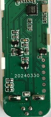

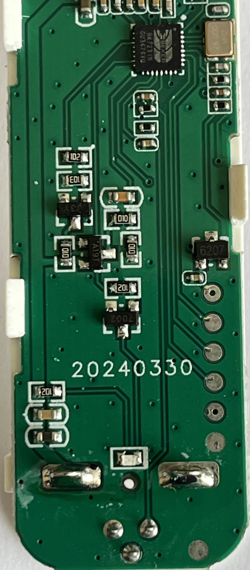

    I have another, Tuya clone, Wifi door sensor powered 2xAAA, based on BK7231N chip. https://vi.aliexpress.com/item/1005006699671958.html
    When I opened it, components are so small that I can hardly see descriptions when I use magnifying tool from my phone. No chance I can use any electronics way approach to hack this device.
    I am newbie in the IoT devices hacking and I just bought 2 of these devices some time ago to do some tests, and didn't know the reality of compatibility issues, etc.
    For my life scenario I wanted this device to report opening door events to external web application, not the HomeAssistant nor MQTT.
    >>21212130
    Close-up of a circuit board with BK7231N chip and electronic components.

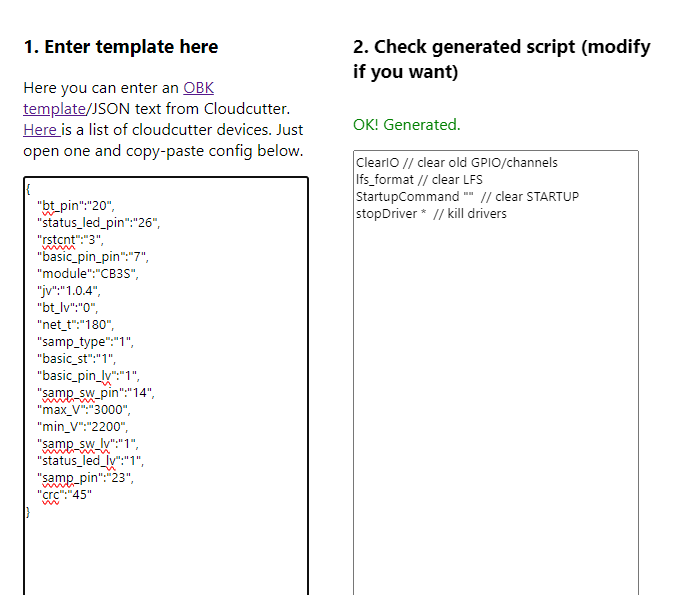

    >>21212130
    I found how to extract the settings from original Tuya software (via BK7231Flasher.exe), but after extraction it is not converted properly into the script in the import tab :-(
       "bt_pin":"20",
       "status_led_pin":"26",
       "rstcnt":"3",
       "basic_pin_pin":"7",
       "module":"CB3S",
       "jv":"1.0.4",
       "bt_lv":"0",
       "net_t":"180",
       "samp_type":"1",
       "basic_st":"1",
       "basic_pin_lv":"1",
       "samp_sw_pin":"14",
       "max_V":"3000",
       "min_V":"2200",
       "samp_sw_lv":"1",
       "status_led_lv":"1",
       "samp_pin":"23",
       "crc":"45"
    View of an interface for converting JSON settings to a script.
  • GPIOFinder and Bat_Relay setup guidance

    You have chosen one of the hardest devices for your first flashing attempts. Battery-powered stuff is hard to configure, but we will try to help.
    1. GPIOFinder is a debug tool, it changes channel internally. You are supposed to first use GPIOFinder, and then change channel again for your final configuration
    2. LittleFS tutorial:
    3. Maybe Bat_Relay is not set or is set on wrong pin. I think this key: samp_sw_pin indicates which pin should be used for Bat_Relay.
    Battery tutorial:
    https://www.elektroda.com/rtvforum/topic3959103.html

Why does GPIOFinder change my channel number?
GPIOFinder is a debugging aid that remaps channels internally while probing. Use it to locate working pins, then restore your intended channel numbering and roles in the final configuration. This is normal during discovery. [Elektroda, p.kaczmarek2, post #21212839]
How can I read Tuya firmware parameters to identify pins like the button?
Extract the Tuya config using BK7231Flasher to get JSON keys such as bt_pin, status_led_pin, samp_pin, and samp_sw_pin. Map these to OpenBeken roles and verify with GPIOFinder before finalizing. This speeds up pin identification. [Elektroda, norbi771, post #21212130]
