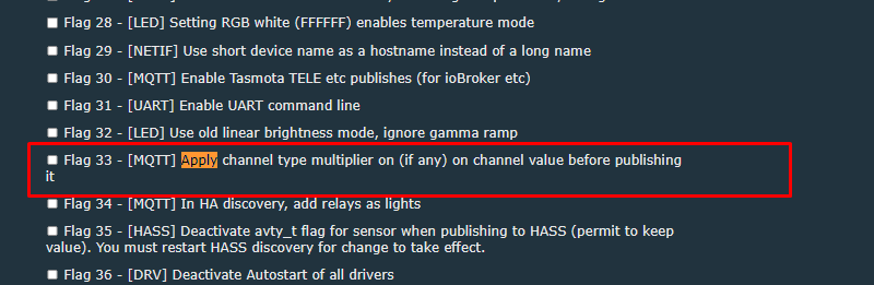

    I'm using DeDaMrAz setup, pins and autoexec.bat script, the device came to life each 900 seconds and post some values on the MQTT server, but none of them looks like the temperature, and the one that looks like humidity (57) I am getting that as the obk55C3556B/battery/get, I also get 2577 as the obk55C3556B/voltage/get
    offline
    247
    2577
    57
    192.168.1.138
    MY_WIFI_SSID
    2
    -49
    8
    72072
    61
    0
    I see there are three sensors posting to the mqtt 0, 2 and 4, with values 61, 247, 0
    Any clue on how I can read the temperature on the MQTT server? Thanks
  • #186 20689295
    Posts: 14767
    Rate: 12909
    Maybe SHT GPIOs has changed. Please attach 2MB firmware backup of your device. If you don't have one , you can also attach just Tuya config partition:
    https://www.youtube.com/watch?v=WunlqIMAdgw&ab_channel=Elektrodacom
    Or... maybe that value 247 is temperature and you are just missing the prescale values flag?
    Screenshot showing a list of software flag settings with a highlighted line about channel type multiplier in MQTT.

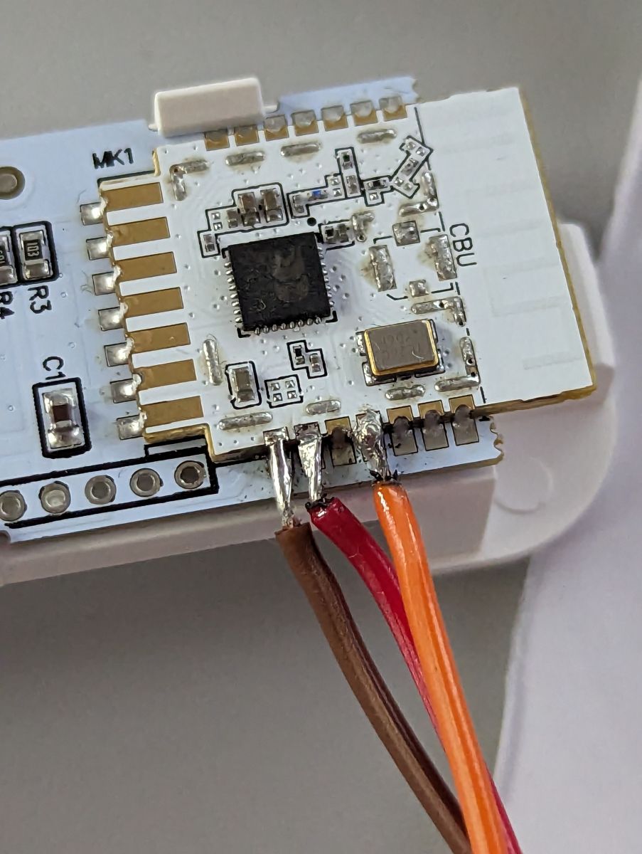

    #187 20689498
    bbenalmadena
    I did as in the video and extracted this (I removed the psk/auth values)
    I did it twice because there are some values on the json that are borked, but I got the same. I think I have a backup firmware but not sure, I need to check that in the other computer

    I enabled the flag 33, and changed the pins to
    7 : SHT3X_SCX,0
    8: SHT3X_SDA,2,3
    But I still get some values, that don't match the temperature, now I'm getting
    192.168.1.138
    0.000000
    262.000000
    60.000000
    60 can be the humidity, but 262 is not the almost high 28º or 29º we have here. I'll let ut running for some time to see if it adjust.

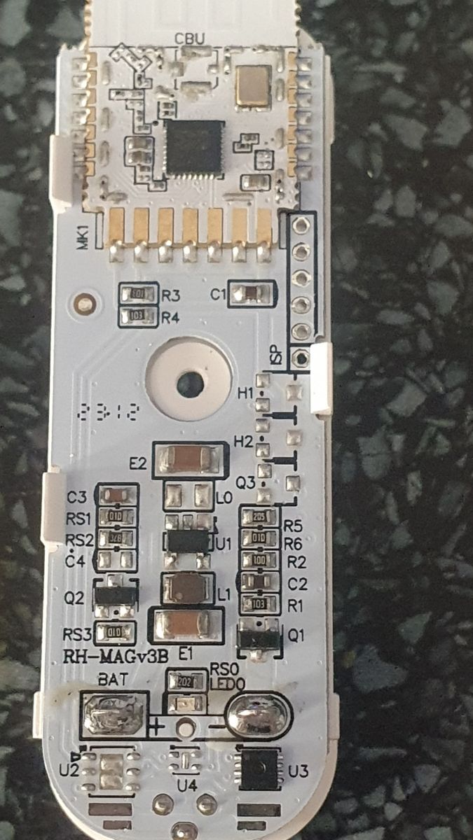

    I'll attach the picture of the model
    Close-up of a circuit board with various electronic components.
    EDIT: Is there any way to get out of DeepSleep mode, each time I have to do any setup I have to enter safe mode use the wifi to enter the device. Can I send a command via MQTT or something so next time it gets up, It get out of the deep sleep mode?
  • #188 20689541
    Posts: 14767
    Rate: 12909
    The script you are using is forcing deep sleep mode. Maybe just try to edit it in AP mode and comment out the "DeepSleep" command?
    Then, while the deep sleep is not working, check what HTTP panel says. Is it reading really 26 degrees?
    Maybe you need to calibrate? I think there was a function for that.

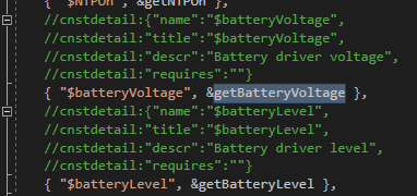

    - unfortunately, I can't deal with the battery voltage variable, I always have a value of 0, could you tell me how to configure it?
  • Safe mode hold time patch and battery variables
    #192 20693248
    Posts: 14767
    Rate: 12909
    Most devices don't need autoexec.bat, but you're generally right. We are trying to build such a database of examples here:
    We will also add your code there when we improve it.
    The problem with some devices is that I just don't have them, so scripts aren't always ready for them.
    //hold button for 3 seconds to get into safe mode
    addEventHandler OnHold 20 SafeMode 3
    These 3 here are not holding time. I'm not sure where it came from, but these 3 are doing nothing at the moment, I'm about to post a patch that takes these 3 as the time in seconds to reboot into safe mode.
    As for the battery, I don't think the author of this driver has derived it into variables. It's not a problem, I can upload an update soon which will make two new variables available:
    Screenshot of a code snippet related to battery variables.

    Thanks, I uploaded the new version and the voltage measurement works ok.

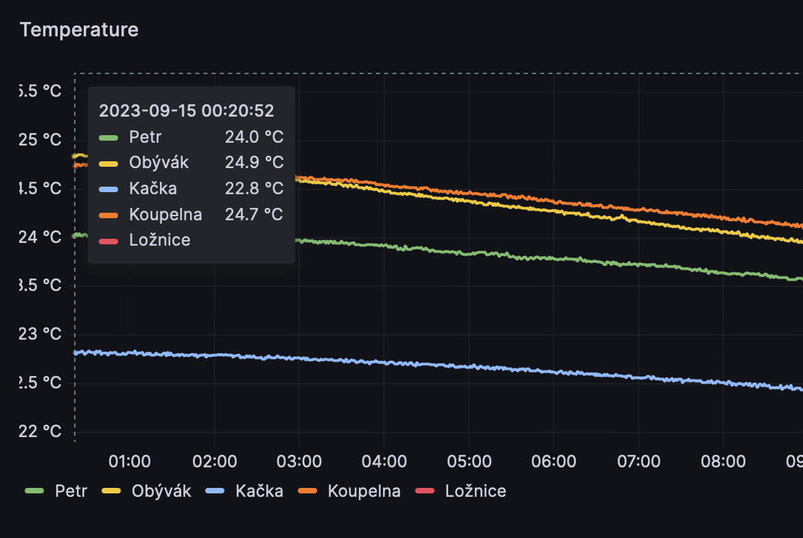

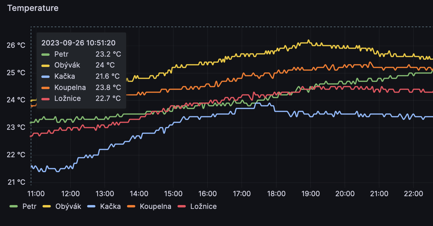

    #207 20749018
    zdenekphilipp
    Level 4  
    Posts: 8
    @p.kaczmarek2
    Hi all, I just finished my home project "migrate temperature sensor" to the Tuya.
    The main reason for the migration was the hardware. Hardware I made myself and I don't know why, but sometimes the I2c sensor stuck the only one that helped was switch off, switch on. I fought with it for months. Right now everything works fine I thank you for the OpenBK project. It is really good job!!!
    At present, I using OpenBK and this "China Generic sensor". Everything works fine and I have a comparison in the chart.
    As you can see in the attachment, my old measurements seem to be more stable. The main reason is, the oscillation of measurement, because during measurement, I used for loop and measured 10 times (https://github.com/karotka/smart.home/blob/main/temp.sensor.mqtt/temp.sensor.old.ino#L66) and calculated the average.
    My question is is possible to call this method (https://github.com/openshwprojects/OpenBK7231T_App/blob/7fae04a9e3f95569b23fbc38564ff8fc5eeb3631/src/driver/drv_sht3x.c#L203C17-L203C30) in for cycle and calculate average?
    Temperature graph showing measurements from different home locations throughout the day. Temperature graph with labels for different locations: Petr, Obývák, Kačka, Koupelna, and Ložnice.

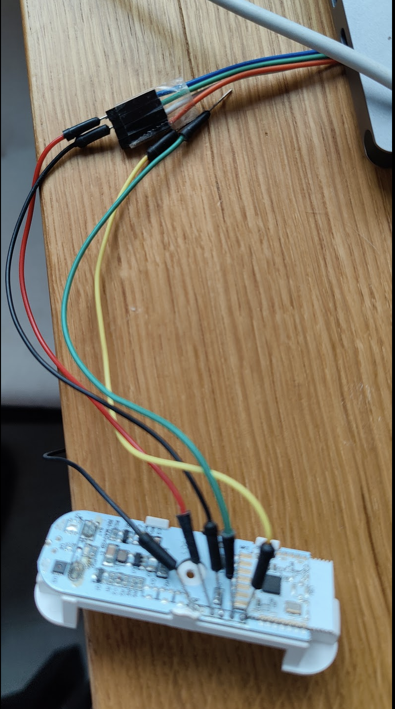

    tino83627
    Hi,
    how you have powered the device during flash?
    I have soldered RX and TX but i cant flash device with BK7231 Gui Flashtool with batteries 😕
  • #209 20751450

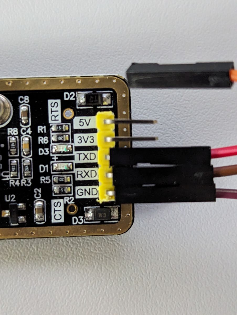

    zdenekphilipp
    Level 4  
    Posts: 8
    It is hard to flash this device with battery power. You need to connect to an external power source 3.3V.
    I using something like this https://www.aliexpress.com/item/1005004155106235.html
    You need to connect Vcc, GND, RX, TX and Reset.
    After that you run flash software a pull down the Reset to the ground for a while
    Close-up of a PCB board with connected wires for programming.
  • Clarifying RX, TX, and reset wire colors
    #210 20751465
    tino83627
    Hi,
    Thanks for your reply.
    I have soldered RX TX RST
    Close-up of a circuit board with three soldered wires.
    Brown tx, red rx, oragnge rst
    Seems i did not need to solder
    Can u explain your colors?
    I would use my USB dongle for powering
    Close-up of a connector on a PCB with connected wires.
    Edit:
    I got it flashed with power and my soldered cables 😃
    What are your green and yellow cables and this black left side?
    @zdenekphilipp
