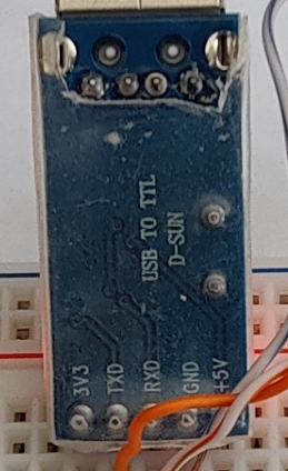

    But with my USB to TTL I can do DUMP
    USB to TTL adapter on a breadboard with wire connections.
    Do you think you can't write in the same way?

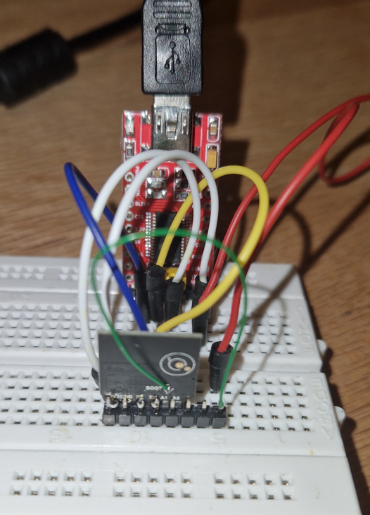

    C:\Users\xxxxx\Downloads\LN882H_CMD_TOOL>LN882H_CMD_Tool.exe COM10 download flash 2000000 0x0 OpenLN882H_1.17.457.bin
    Fail. Error downloading file.
    I use the 3,3V of the USB-to-Serial as power supply for the LN822H Module
    Connections on a breadboard with FTDI USB-to-Serial module and LN882H chip.

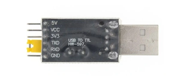

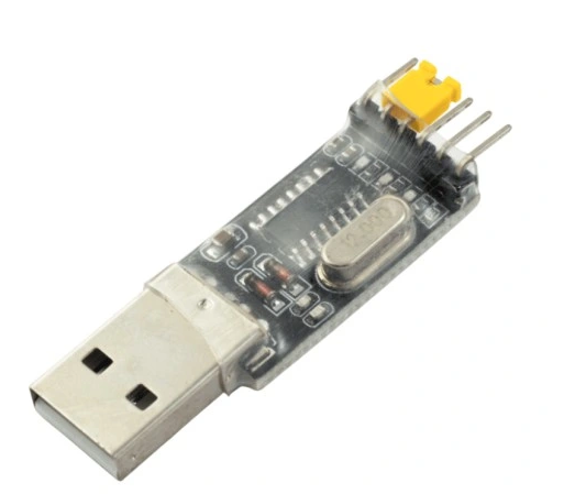

    Both of you seem to have a different USB to UART converter than I have.
    USB to UART adapter with a yellow jumper for selecting 3.3V voltage.
    USB to UART converter with visible pins and labels.
    On this converter, I always use a jumper to connect VDD to 3.3V, because on this converter it is required to select 3.3V voltage levels.

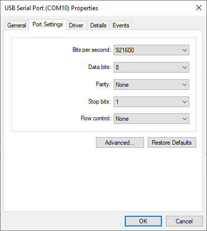

  • #40 20957739

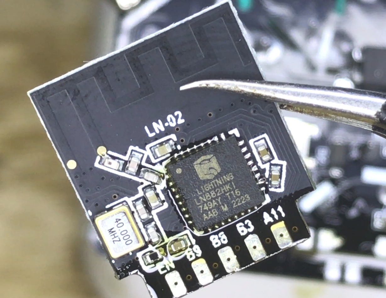

    That is the one I have flashed for upcoming YT video:
    Close-up of a modified integrated circuit with LN02 marking on a printed circuit board.

    this is my USB to TTL
    https://mauser.pt/catalog/product_info.php?products_id=096-7520
    Google Translate description
    "The USB-Serial TTL Converter PL2303 is an adapter that uses the Prolific PL2303HX chip to convert USB signals into TTL RS232 signals, which makes it extremely useful when you want to communicate between the computer and microcontrollers in general. The USB-Serial TTL Converter PL2303 is a board with reduced dimensions that has at one end a USB connector to be connected directly to the computer and at the other end a pin bar for easy connection with the board whose communication will be established, has voltages 3.3 and 5V, which allows you to work with a greater number of microcontrollers regardless of their power supply.
    For correct operation, the USB-Serial TTL PL2303 driver must be installed.

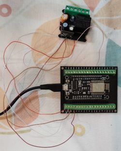

    I can confirm that LN882H can be flashed with NODE-MCU (esp8266) with CH340. Electronic board with long wires connected, lying on a colorful background.
    Having such a long wires is bad practice, you should really shorten them. I already have seen many cases where just the length of the wires were breaking up the flashing. The first rule of good flashing setup is to keep wires short.

    dullu
    Yes, you are 100% right!!
    Yesterday, I flashed it and it was working everything fine.
    and almost all function was working...only thing I noticed is ..... when I assign static IP and reboot, it will again come up with DHCP only.
    tried many times (assigned all like IP, Mask, GW, DNS) but it is not saved.
    Also, while applying with template for smart switch, it says Bad command ? "lfs_format" comand not found!!
    Anyways, I burned the LN822H last night because of loose long boot wire was by mistakenly touched somewhere in ESP baseboard connectors
    and I got some bad smell from the board and now no WiFi, no activities at all. :(
    Soooo... even I have flashed with long wires successfully, it is bad practice for other things too (like frying your chip).
    Now I am waiting for another from aliexpress.
    Thank you all for such a wonderful guidance.

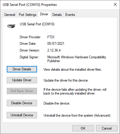

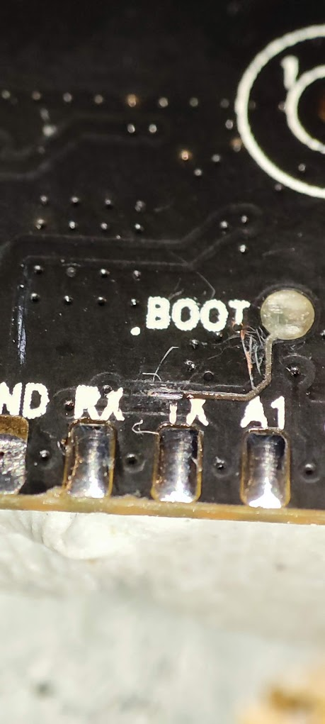

    divadiow wrote:
    I ripped the pad off boot on my first LN-02 mini switch not moving it around delicately enough 😳
    ive gone back to this. desoldered from PCB and examined trace from where boot pad was. Scratched off the ink along the T in TX text to reveal the copper trace. Fluxed and tinned a little, then used pogo pins to ground boot. LN-02 now flashed to OpenBK.
    Also. I used fake FTDI USB adaptor, so didn't have to use CH340 as previously thought. Flashed without setting baud in cmd
    LN882H_CMD_Tool.exe COM10 download flash 2000000 0x0 OpenLN882H_1.17.432.bin
    USB Serial Port properties on COM10 settings. USB Serial Port (COM10) properties with FTDI driver information.

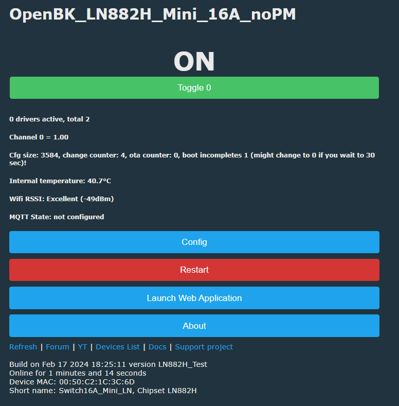

    Close-up of a PCB with exposed copper trace near the .BOOT label. Screenshot of OpenBK interface displayed in a browser.
