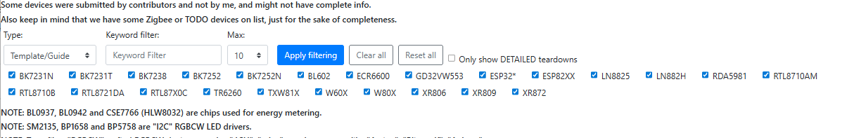

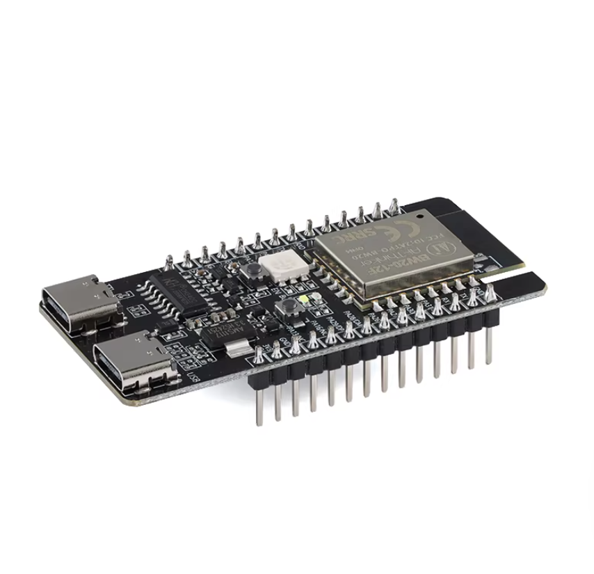

  • Adds DA support and a BW20-12F-Kit board entry
    #394 21918395
    Posts: 5213
    Help: 446
    Rate: 914
    divadiow wrote:
    Cool. Just in time. BW20-12F-Kit should arrive tomorrow
    how's it been a year almost since purchase already?!
    there should probably be more dev boards on the device list. it would give the platform search boxes something to show for the rarer types.
    add DA https://github.com/OpenBekenIOT/webapp/pull/2...nges/25c6f48021899875c61aca88e46c251bd5ed3ce3
    Screenshot of a webpage with filters and a list of chip/device names with checked boxes
    add board: https://github.com/OpenBekenIOT/webapp/pull/283
    Development board with two USB‑C ports and an ESP32 module on a white background
