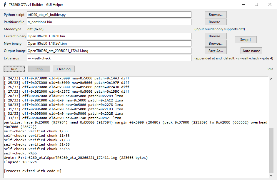

    #61 21845141
    Posts: 5220
    Help: 449
    Rate: 918
    this may be the end, for me anyway :)
    with this Python I am jumping between PRs, general releases old and new, seemingly without issue. As before, Python is slower and generated images are always a little larger than ota_tool_trdiff_v1.
    Added parallelism with "--jobs x" argument. Zip includes a GUI helper
    4 jobs
    Screenshot of TR6260 OTA v1 Builder GUI with file fields and a log showing a completed run
    1 job
    Screenshot of TR6260 OTA v1 Builder GUI with file fields and a log showing OTA image build steps
    • tr6260_ota_v1_builder.zip (685.68 KB) You must be logged in to download this attachment.

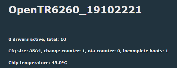

    Posts: 5220
    Help: 449
    Rate: 918
    morgan_flint wrote:
    I understand that the temperature is "unknown" because the sensor must be missing in this chip. If I remember well, it appeared before on the main OBK page but has already been removed
    got side-tracked playing with TR6260 chip temperature https://github.com/divadiow/OpenBK7231T_App/tree/tr6260_temp
    Screenshot showing “OpenTR6260__19102221” with driver status and chip temperature 45.0°C
