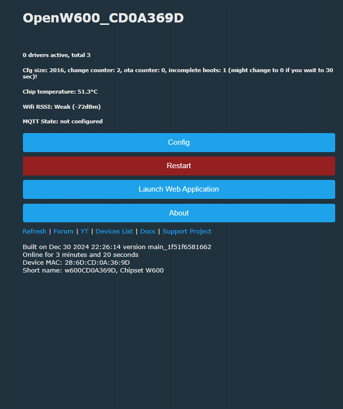

    great job @max4elektroda
    OpenW600 user interface with configuration buttons and device information.
    lmk if you want to see others in action

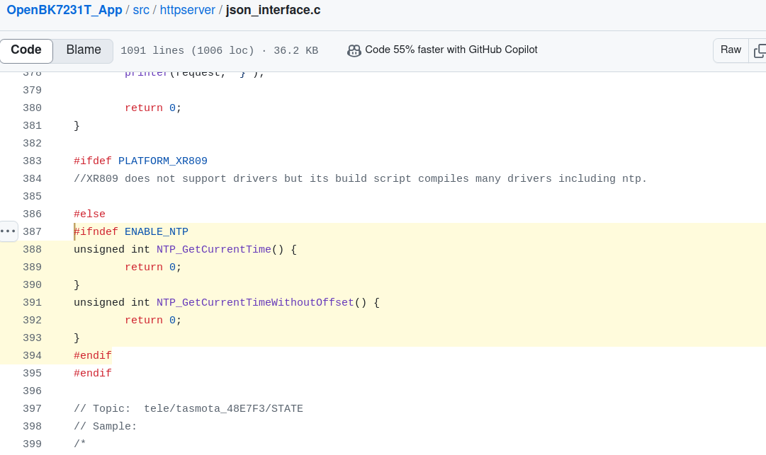

    maybe @divadiow I can ask for your support again to do some testing on my new try to separate NTP and clock as a requirement to use other clock sources.
    Its https://github.com/openshwprojects/OpenBK7231T_App/pull/1483
    Since it involves changes to many files, it's getting merge conflicts very fast meaning I have to do the PR again ans again...
    This PR should only relocate and rename functions and only do one simple change to the system: The "clock" is present even if it's not synced or ntp driver not started.
    This allows to drop the special handling, e.g. in json_interface.c implementing a "fake" NTP returning 0 in case NTP is not present.
    Code snippet from OpenBK7231T_App repository with NTP functions.
    This implementation (e.g. "Clock_GetCurrentTime()") will always report time 0 as time in this case, so we can drop this code.
    I also fixed code which I believe was in wrong "#ifdef"s in cmd_if.c: there was a mix up of bl0937 and ntp code, no problem if both is defined but not working, if only ntp is active.
    Prominent example: $yesterday and $today - they sound like ntp functions and where in NTP section, but they will return the energy consumption for yesterday/today, so they belong to the BL0397 section...
    So if you could do some tests if all time related functions still work as expected?
    Especially the advanced features like sunrise/sunset and events?
    Thanks to @p.kaczmarek2 we have some basic tests already done be selftests, so it's not totally wrong ;-)
