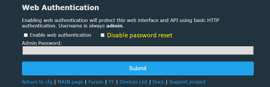

    max4elektroda wrote:
    I would vote for the reset be possible in default (so on/off depends on if it's "enable possible config reset" or "disable possible config reset").
    My proposal was:
    Web authentication interface with options to enable authentication and disable password reset.
    so you can disable recovery when you enable password (normally recovery is possible)

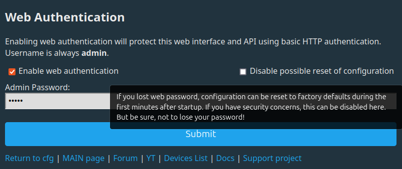

    I implemented a flag to disable the new feature:
    Screenshot of a configuration interface with network authentication options and admin password field.
    @p.kaczmarek2: I hope, I made no mistake regarding the flags.
    While at it, I fixed a minor "bug" in the code (every time you saved the WiFi page with password enabled it would state "Web password has been changed.", regardless, if you actually changed it)
  • #244 21086972

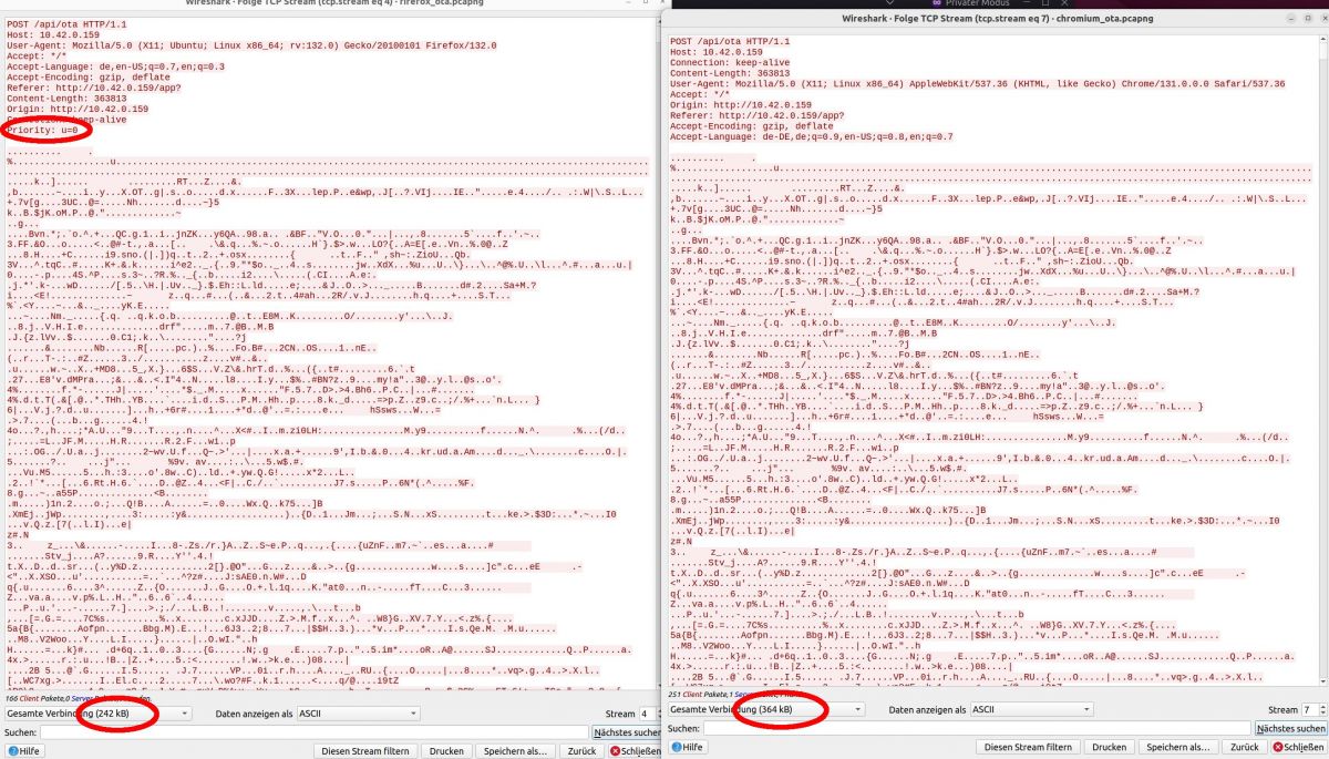

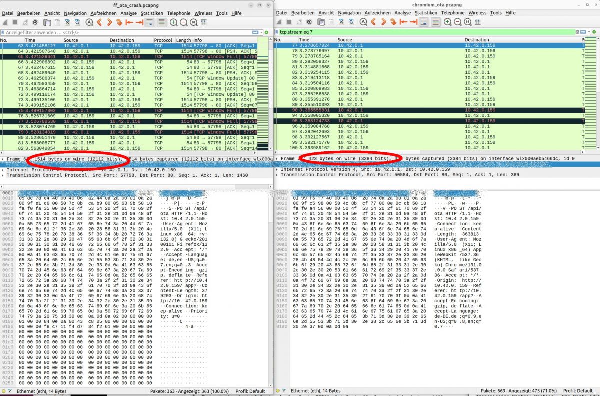

    But I didn't find a reason yet, for the POST seems to be almost identically:
    Comparative screenshot of TCP traffic from Firefox and Chrome in Wireshark.
    You can see the "broken" download with Firefox, the data is transferred is less than the full data seen in right window.
    Content-Length is equal, only Firefox has one additional header element "Priority". But since Openbeken will probably not use it, I can't see why reading data in HTTP-Client seems to fail with Firefox...
    Maybe someone else can see a possible reason?
    For now I would suggest a warning that OTA might fail if done with Firefox browser.

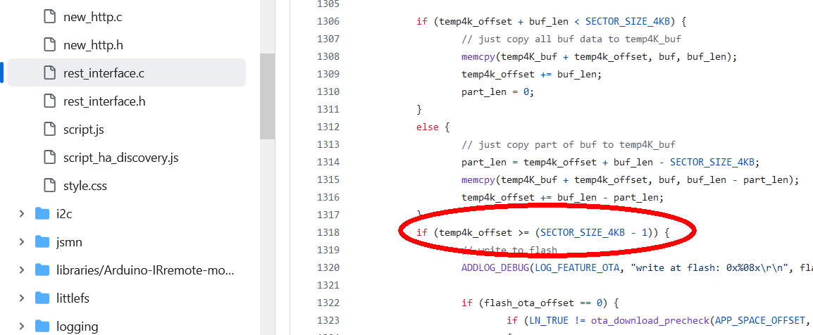

  • LN882H crash likely caused by SDK or lwIP bug
    #261 21315281
    max4elektroda
    Posts: 758
    Help: 49
    Rate: 189
    There aren't any extensions in the browser.
    And, to be honest, I would think there's something in LN882H code causing this. A problem in SDK, especially in LWIP, a memory issue in the receiving code only firing in rare cases...
    You should not be able to crash the device when sending data a regular way. Maybe if data is interpreted, but here the packets should be simply stored, so even POST-ing wrong or corrupted data could only make problems later, e.g. if the device can't boot any more.

    The POST data sent by Firefox is identical to the firmware file.
    Same on a "regular" FF window (header is shorter here):
    max@max:~/LN882H/OTA_issues$ cat -n  temp.out | head -n 14

    So my conclusion is, that I'm pretty sure the issue is somewhere in the LN882Hs code.
    I can see one difference in the Wireshark packets:
    Firefox sends the POST header together with the start of the payload in the first packet.
    Chromium sends the header in a separate TCP packet.
    Both is totally valid TCP, but maybe somewhere the packet containing the header is "processed" differently?
    Comparison of TCP packet captures in Wireshark for Firefox and Chromium.
    But I don't yet fully understand the OTA mechanism. Especially, I don't see, how "HTTP Client" (the tread failing) gets involved ???

    So my actual guess now is: an HTTP POST fails very often on LN882H if the header is not in a separate TCP packet.
  • OTA buffer overflow breaks LN882H updates
    #265 21319958
    max4elektroda
    Posts: 758
    Help: 49
    Rate: 189
    I think I finally found it - see https://github.com/openshwprojects/OpenBK7231T_App/pull/1441
    OTA code is "collecting" data until a 4k buffer is filled.
    But it doesn't check, if the data provided will fill the 4k buffer twice.
    So its writing data outside the allocated memory in some cases.
    Checking the size should fix this, I could now update the firmware with Firefox and also simply writing the POST via "nc" works for me.
    The firmware would need some more testing - but just in case you should be prepared that OTA is broken and you need UART to recover...

    @p.kaczmarek2 could you please take a look at my PR?
    I need someone to proof, there really are two "bugs" in the OTA procedure, taken 1:1 from SDK examples.
    The issues I found are in the function "static int ota_persistent_write(const char *buf, const int32_t buf_len)" in rest_interface.c.
    But I think you can understand my corrections by simply trying to follow the function with an example:
    For simplification let's assume "SECTOR_SIZE_4KB=10;"
    First case: function is called e.g. with buffers of length 9
    Call will fill buffer up to 9 elements and setting temp4k_offset=9
    - this will trigger first error: because now temp4k_offset == (SECTOR_SIZE_4KB - 1)
    --> so buffer will be written, but it's missing the last (10th) entry
        --> my conclusion is, that line 1318 should read: if (temp4k_offset >= SECTOR_SIZE_4KB) {
          (in fact, it could be ==, for the offset should not be > SECTOR_SIZE_4KB, meaning we wrote outside allocated memory)
    Screenshot of code in rest_interface.c with a highlighted line of code.
    Second case (causing the issue seen with Firefox): function is called twice with buffers of length 8 and 14
    First call will fill buffer up to 8 elements and setting temp4k_offset=8
    Second call:
    - part_len now is: temp4k_offset + buf_len - SECTOR_SIZE_4KB --> 8 + 14 -10 = 12
    --> note: part_len now is > 10 !
    - will fill buffer up to 10th element, setting temp4k_offset=10 (that's o.k.)
    - temp4k_offset >= (SECTOR_SIZE_4KB - 1) and buffer will be written (that's o.k.)
    - since part_len > 0, this code is called:
    memcpy(temp4K_buf + temp4k_offset, buf + (buf_len - part_len), part_len);
    --> will try to copy 12 elements to a 10 element buffer (that's not o.k.)
    temp4k_offset += part_len;
    --> since memcpy will probably fail, it doesn't matter so much that temp4k_offset will be 12 (that's not o.k.)
        --> my conclusion: we need to do the loop repeatedly, until buf_len is < SECTOR_SIZE_4KB
  • Flash routine overflows when buf_len exceeds 4 KB
    #267 21320571
    XJ_
    Posts: 141
    Help: 13
    Rate: 39
    Written is always just delta, there is no oveflow
                    part_len = temp4k_offset + buf_len - SECTOR_SIZE_4KB;
          memcpy(temp4K_buf + temp4k_offset, buf, buf_len - part_len);
    And to the flash is writeen always SECTOR_SIZE_4KB, there is not overflow too
    hal_flash_program(flash_ota_start_addr + flash_ota_offset, SECTOR_SIZE_4KB, (uint8_t *)temp4K_buf);
    I agree, the "-1" sholud not be there
    Added after 6 [minutes]:
    >>21320553
    There can be overflow, if buf_len > SECTOR_SIZE_4KB or if last part "buf_len" is bigger than rest of buffer
    Edit: but only if the buf_len twice bigger than SECTOR_SIZE_4KB
    Added after 16 [minutes]:
    this routine should not be called with buf_len > SECTOR_SIZE_4KB (as in your example, 14>10)
    Added after 27 [minutes]:
    I wrote test program, and overflow happen always, if the buf_len is bigger than SECTOR_SIZE_4KB.
    It is happen after SECTOR_SIZE_4KB / (buf_len-SECTOR_SIZE_4KB) calls
    The procedure itself is not designed to receive more than SECTOR_SIZE_4KB bytes in one call.
  • OTA write routine overflows with 4380-byte chunks
    #268 21320645
    max4elektroda
    Posts: 758
    Help: 49
    Rate: 189
    Not in this code, but here (line 1340 in the original code) after writing to flash, this code is called:
       if (part_len > 0) {
    And it can be that "part_len > SECTOR_SIZE_4KB" as pointed out.
    Maybe it should not (and probably is not in the original OTA code with an HTTP GET) but it did happen in the actual code.
    See this part from the log above:
    Debug:OTA:write at flash: 0x00135000
    Debug:OTA:Writelen 4380 at 9819
    Debug:OTA:Writelen 1460 at 14199
    Debug:OTA:write at flash: 0x00136000
    Debug:OTA:Writelen 4380 at 15659
    Debug:OTA:write at flash: 0x00137000
    And 4380 is bigger than 4096, so buffer is filled e.g. to 4000, the original code will write one 4k slice to flash and later try to copy the remaining 4284 bytes to the 4096 byte memory.
    So I made it work in this case, too (at least I tried).
  • Fixing OTA writes by splitting oversized flash chunks
    #269 21320666
    XJ_
    Posts: 141
    Help: 13
    Rate: 39
    >>21320645
    call 1
    input : len=12
    memcpy buf: 0 0 10 <<first call memcpy @ line 1308
    memcpy buf: 0 10 2 <<second call memcpy @ line 1341
    call 2
    input : len=12
    memcpy buf: 2 0 8
    memcpy buf: 0 8 4
    call 3
    input : len=12
    memcpy buf: 4 0 6
    memcpy buf: 0 6 6
    call 4
    input : len=12
    memcpy buf: 6 0 4
    memcpy buf: 0 4 8
    call 5
    input : len=12
    memcpy buf: 8 0 2
    memcpy buf: 0 2 10
    call 6
    input : len=12
    memcpy buf: 10 0 0
    memcpy buf: 0 0 12 <<<error
    error
    Then it must be splitted to smaler parts before calling ota_persistent_write
  • #270 21320676
    max4elektroda
    Posts: 758
    Help: 49
    Rate: 189
    I think it doesn't matter if we split the data before calling ota_persistent_write or "simply" change ota_persistent_write to handle input of bigger buffers, too.
    It was all there, just test in a loop, if the write-buffer can be filled completely, then write it to flash, and test again, until the write-buffer is not completely filled.
