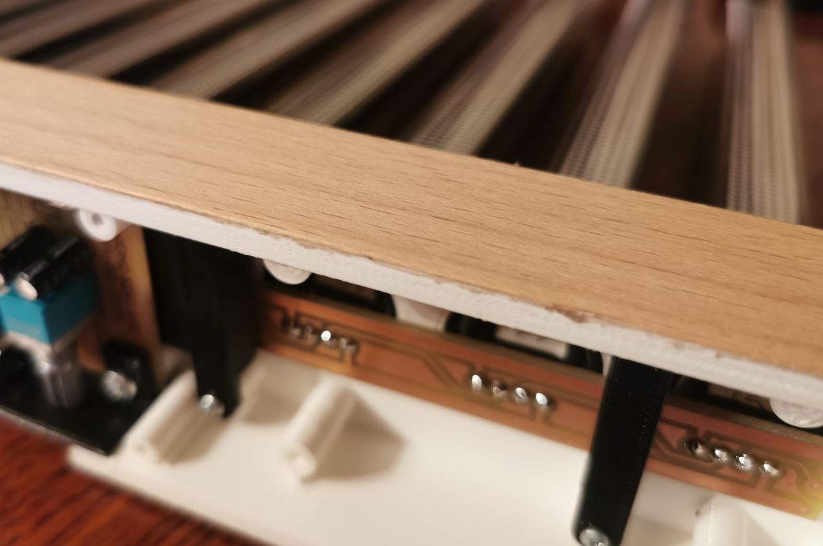

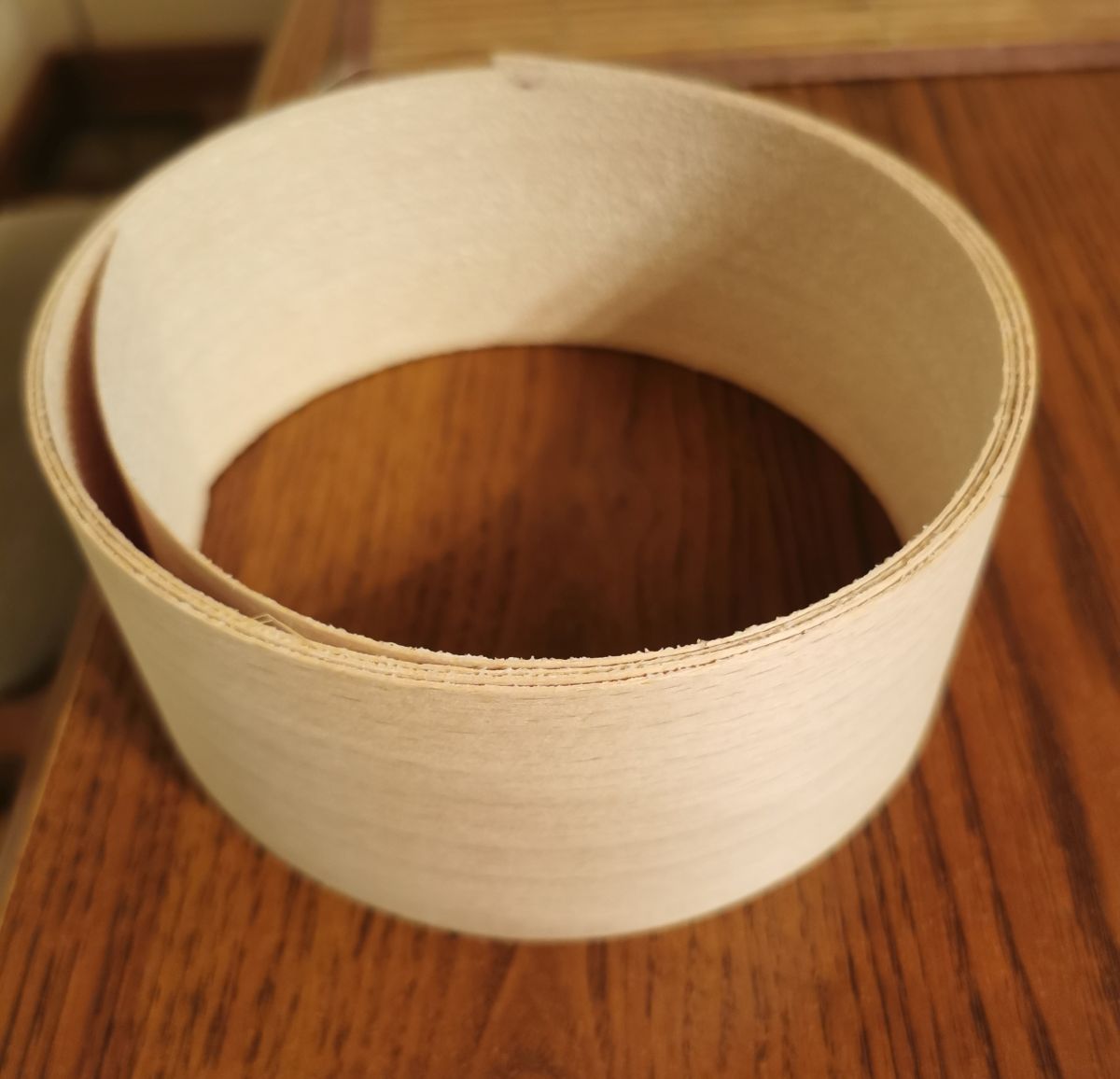

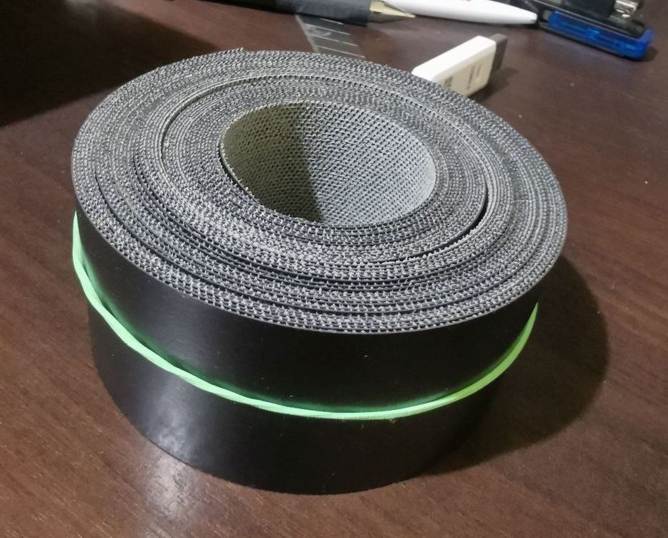

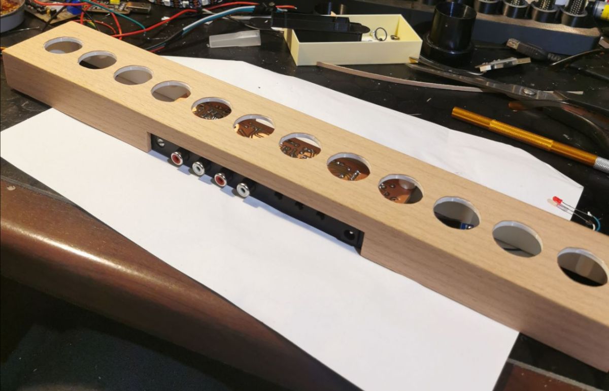

    It depends on what you mean by 'smoothing'. I simply sand on sandpaper. Silicone to restore the colour after sanding (it can evaporate after a long time). There can also be a thin layer of matt clear varnish. It depends on what effect you want to achieve. PLA is quite hard to work with. A lot also depends on the shape of the solid.
    Instead of "stroking" a solid, you can also use different veneers for simple solids. Be careful with iron-on veneers, as the melting point of the glue is similar to that of PLA. But it is possible :) . Complex solids are certainly more difficult to process. Sometimes I prefer to print something from smaller pieces and after machining them together. I print on glass, so one wall is like a mirror. Worse with vertical ones.
    Examples of veneer: here it is thicker on filament (0.6mm), but there are also thin furniture veneers with glue in sheets.
    Rolled thick furniture veneer on a wooden surface
    Roll of thick black thermal adhesive veneer with textured underside
    Enclosure with veneer finish and circular cutouts, showing RCA connectors and internal PCB
    Digital display embedded in black PLA case with multicolor wires on the left
    Close-up of corner with wood veneer applied to 3D-printed PLA enclosure

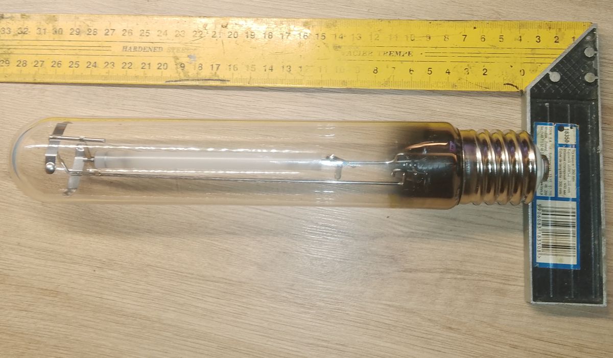

    @efi222 I got one brand new in a 400w carton yesterday;
    400W discharge lamp measured using a square ruler and a folding meter
    I don't have a caliper at home and the measured "vinyl" diameter is ~ 45mm. I am waiting for a response about the larger ones.

    It looks inconspicuous in the picture. Only the scale of the angle iron gives an idea :D
    And how do you see the construction on similar bubbles? :)

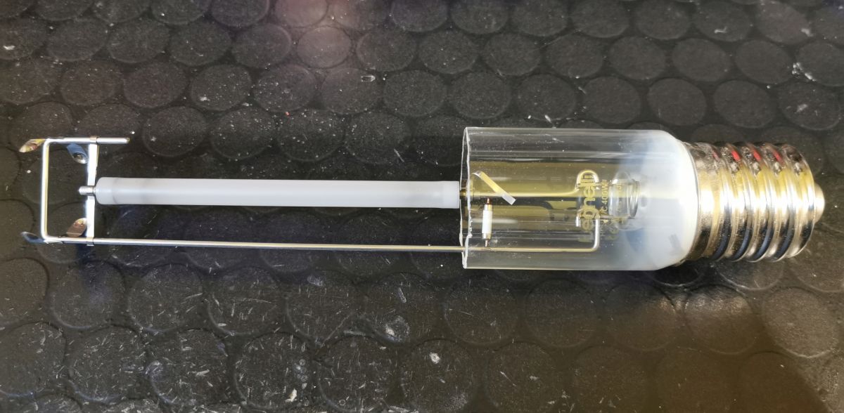

    I cut the 30mm bulbs first at the thread to get rid of the vacuum. Then a mini diamond cut to size. I wonder how thick the glass is in these big incandescent bulbs.

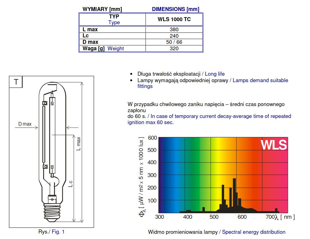

    Sodium 1000W have a diameter of ~67 mm.
    Edit;
    @efi222 I had a look at the website of the national manufacturer, Polamp Ozarow Mazowiecki (POLAMP-Warsaw). For the WLS 1000W;
    Datasheet of WLS 1000W sodium lamp with schematic, technical specs, and spectral chart

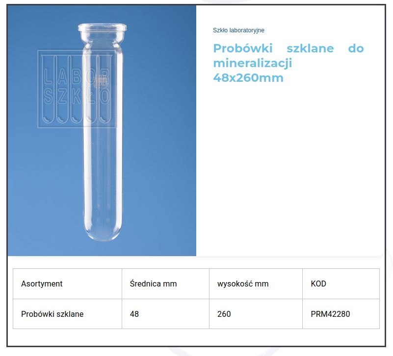

    I tried to call the sales department. To no avail. The bubbles themselves should be affordable. Then it actually could;
    gulson wrote:
    An idea from tradition, with a modern twist.
    Do you know that you have just stumbled into a good business?
    Animated character holding money with text Shut up and take my money!
    https://www.polamp.pl/kontakt
    How about.
    Glass mineralization test tube 48x260 mm against a blue background

    Thank you for your commitment to the topic. I have been rolling out the subject of glass thickly on the internet. In general, glass costs a bit. Even at Chinese sellers. Maybe glass bulbs alone for the bulbs would get somewhere, but bulk quantities would probably be involved. Large diameter glass tubes are priced from space. So far I have found sodium tubes at a retail price of PLN17 each and in my opinion the price is quite attractive at 45mm diameter.
    I will soon introduce a lamp of this diameter here.

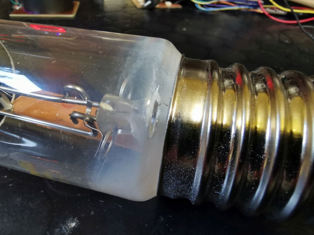

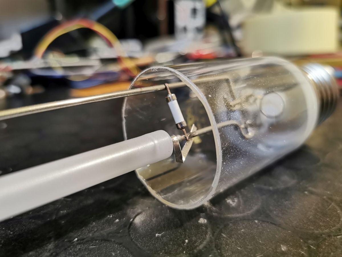

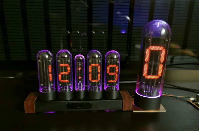

    ArturAVS wrote:
    Let's move on. Perhaps in the role of "test tubes" , use the bulbs from typical high-powered "sodium" lamps with E40 threads?
    So there I went... :)
    I received such a "soda" from @ArturAVS for testing.
    There was a bit of stress when cutting this slide. One - that the size scared me a bit. Two - only one piece... It will be sad if it falls apart.
    I first cut at the thread to get rid of the vacuum.
    Close-up of a screw base and interior of a large vacuum tube bulb
    Interesting phenomenon with the getter. I thought it would turn white immediately. Nothing of the sort. It slowly started to sort of go down towards the thread (I think it was fighting the oxygen :) ). The glass at this point was clear. It only turned white after a click of a dozen seconds. I wish I had had time to film this....
    Then cutting to the correct size. This took about two minutes. I must admit that I expected a thicker wall. It is about 1.2mm at the cut point.
    Glass bulb with E27 socket and internal components on black textured surface
    Close-up of a cut glass bulb showing internal parts of an electronic tube

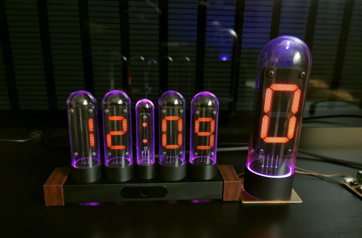

    I have constructed a prototype digital from this glass and in comparison with the original it looks like this:
    The photos, as usual, don't do the full justice. I will say that this size is really impressive :D . "The 'lamp' with plinth is 155mm high.
    Digital tube clock with purple backlight and large standalone digit “0”
    Finally, thanks to @ArturAVS for making this great glass available for testing. :)

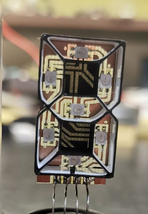

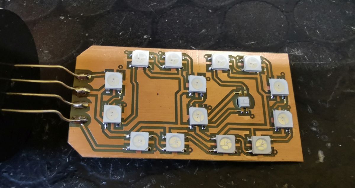

    ArturAVS wrote:
    And as if those 1000W would cut down...
    I don't think I can imagine it anymore.... :D
    Here I already had to give two LEDs under each segment and not any mini ones, but WS2812B (5050), because one LED no longer illuminated the entire segment.
    PCB with 15 WS2812B LEDs arranged in a seven-segment display pattern

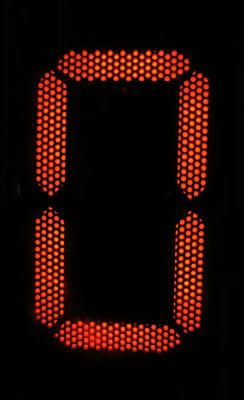

    Pole can do it! I have a few metres of redundant WS2812 SMD 5050 tape, I can send...
    Edit;
    Try filling the spaces above the diodes with glass beads;
    Close-up of custom LED display using WS2812 SMD 5050 modules in segmented pattern
    I used to fill with plain sugar and then a drop of epoxy resin. The effect exceeded my expectations.
    Edit2;
    What about using photo-etched elements as a grid? Precision of workmanship unattainable with other methods. https://www.precisionmicro.com/pl/odpowiednie...rawienie-wszechstronna-obrobka-prawie-metalu/ I have the necessary workshop equipment (I have been making tiles using this method for years). How do you source for this?

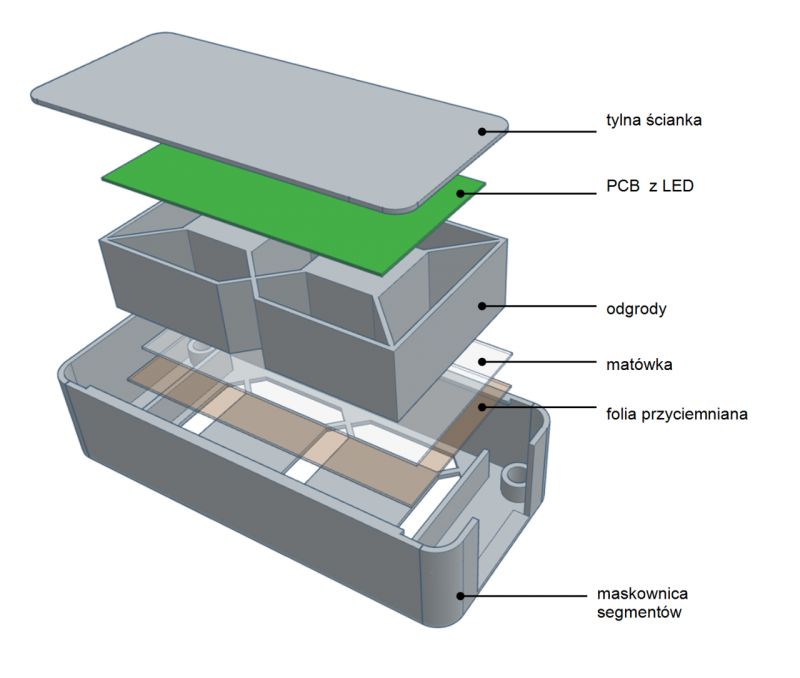

    With such a digital design it will be rather difficult. And this is where service will be difficult. All components are assembled in the position and order as shown in the picture below. No component is permanently connected to the adjacent one. The whole is enclosed by a "snap-on" rear panel. But I will experiment out of curiosity as to how these beads diffuse the light.
    Diagram of an LED display with layers and components.
    Regarding the masking grid, there is room for improvement here. This mesh gives the whole visual effect. In my opinion, a mesh with a hexagonal pattern would look best. I looked for such a mesh with a fine raster, but what I found has too big "meshes". I also tried 3D printing, but it doesn't look too good (at least printed with a 0.4 nozzle). And whether it's worth etching such a bezel, it's hard to say how it would look in the end.
    You can always experiment. The grid is screwed in place and its purpose is to create an optical effect. It has no structural connection to the other components.

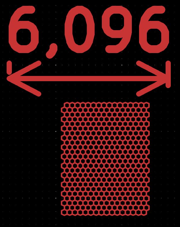

    I drew myself a sample of the film for photo etching;
    Red hexagonal mesh pattern with 6.096 mm width label on a black grid background.
    The width of the grid outline is 0.05 mm. I'm curious to see what comes out of this myself (the narrowest repeatable paths I could manage were 0.15 mm). I'll print a "test" film with different widths.

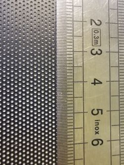

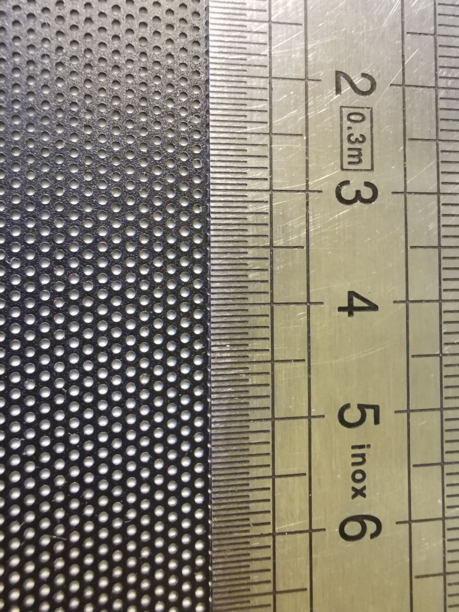

    Photo of the mesh I am assembling:
    It may be useful for comparison.
    Attached in higher resolution.

  • #77 21783731
    efi222
    Level 22  
    Posts: 763
    Help: 12
    Rate: 1199
    bsw wrote:
    Where can such a net be purchased?
    I buy it on Aliexpress. It is a dust net for fans. It's probably available in Poland too.
    https://pl.aliexpress.com/item/10050036481825...n.473.772c1c2444w3gA&gatewayAdapt=glo2pol

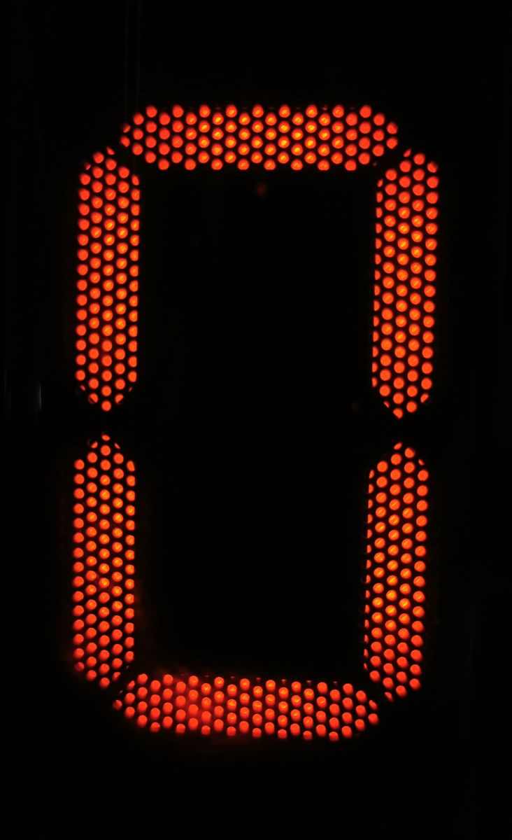

    Glass bubble digit 45mm.
    Height of digit 55mm.
    Red digit “0” formed by LED dots in a seven-segment display style
