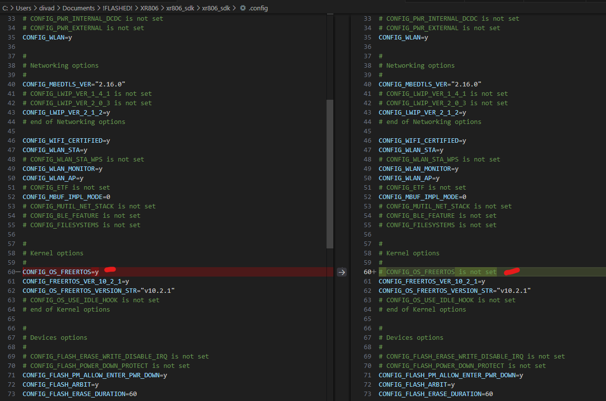

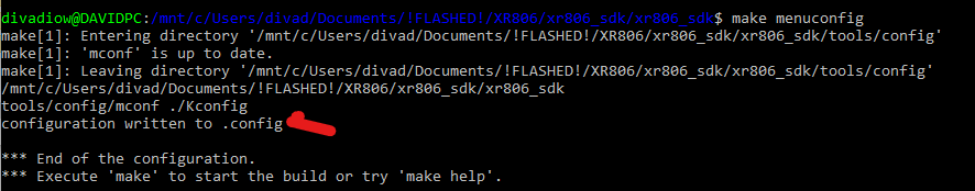

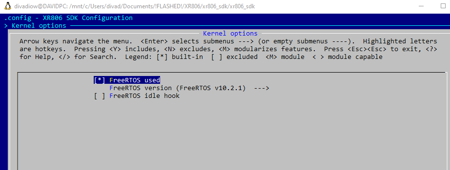

    anything to do with this in menuconfig?
    Tuya WXU XR806 from TRV Heater Device flashing, SDK, firmware change research
    Added after 5 [minutes]:
    toggling freertos used off/on changes this file xr806_sdk\xr806_sdk\.config
  • #63 21432580
    Posts: 14580
    Help: 654
    Rate: 12604
    How do you enter menuconfig for a given project?
  • #64 21432585
    Posts: 5026
    Help: 438
    Rate: 891
    hmm. dunno. that change doesn't seem to reference anything in the project:

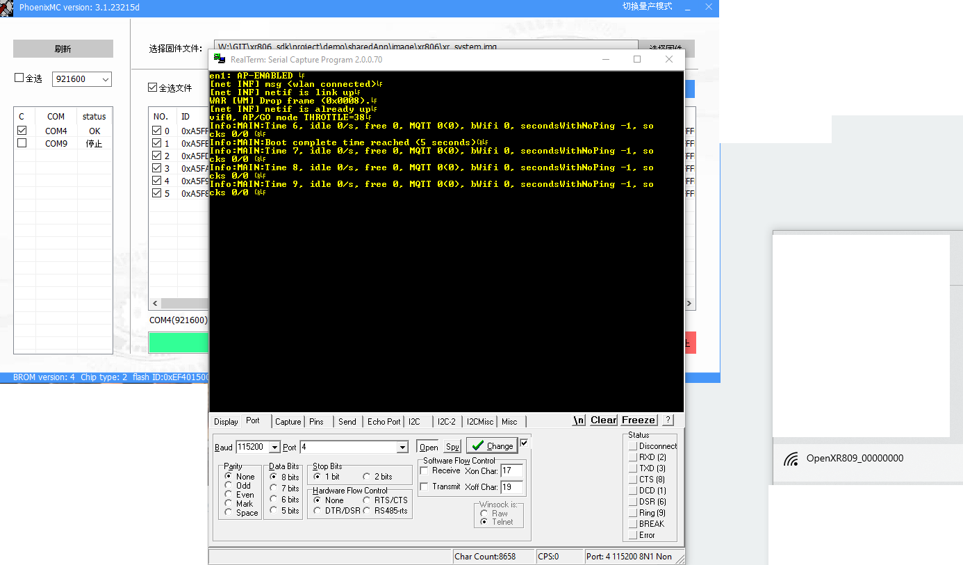

    Added after 1 [hours] 39 [minutes]:
    Finally!
    Added after 17 [minutes]:
    Still a lot of missing:
    use default flash chip mJedec 0x0
    [FD I]: mode: 0x10, freq: 96000000Hz, drv: 0
    [FD I]: jedec: 0x0, suspend_support: 1
    mode select:e

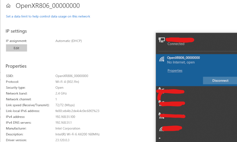

    en1: CTRL-EVENT-TERMINATING
    WAR join_status:0
    interface name: en1
    Using interface en1 with hwaddr 1c:01:6f:c0:e0:79 and ssid "AP-XRADIO"
    en1: interface state UNINITIALIZED->ENABLED
    en1: AP-ENABLED
    en1: AP-DISABLED
    [net INF] msg <wlan connected>
    [net INF] netif is link up
    [net INF] bring up netif
    [net INF] netif (IPv4) is up
    [net INF] address: 192.168.51.1
    [net INF] gateway: 192.168.51.1
    [net INF] netmask: 255.255.255.0
    [net INF] msg <network up>
    vif0, AP/GO mode THROTTLE=38
    en1: interface state ENABLED->DISABLED
    [net INF] msg <wlan disconnected>
    [net INF] netif is link down
    Using interface en1 with hwaddr 1c:01:6f:c0:e0:79 and ssid "OpenXR809_00000000"
    en1: interface state DISABLED->ENABLED
    en1: AP-ENABLED
    WAR [WM] Drop frame (0x0008).
    [net INF] netif is already up

    Info:MAIN:Time 16, idle 0/s, free 0, MQTT 0(0), bWifi 0, secondsWithNoPing -1, socks 0/0
    Info:MAIN:Time 17, idle 0/s, free 0, MQTT 0(0), bWifi 0, secondsWithNoPing -1, socks 0/0
    Info:MAIN:Time 18, idle 0/s, free 0, MQTT 0(0), bWifi 0, secondsWithNoPing -1, socks 0/0

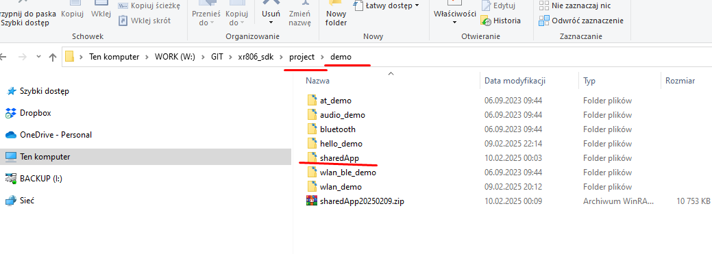

    Added after 13 [minutes]:
    Current wraper backup attached. Use it like shown:
    • sharedApp20250209.zip (10.5 MB) You must be logged in to download this attachment.

    For now, there is still a WiFi connection problem:
    socks 0/0
    Info:MAIN:Time 179, idle 0/s, free 0, MQTT 0(0), bWifi 0, secondsWithNoPing -1,
    socks 0/0
    Info:MAIN:Time 180, idle 0/s, free 0, MQTT 0(0), bWifi 0, secondsWithNoPing -1,
    socks 0/0
    xr_newassoc(): link_id:0 mac:e4:b3:18:f6:91:cc
    en1: STA e4:b3:18:f6:91:cc IEEE 802.11: associated
    en1: AP-STA-CONNECTED e4:b3:18:f6:91:cc

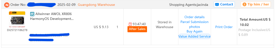

    I ordered some through Superbuy. But this will take years I believe....
    I went for one too as I've a collection of bits in the warehouse there waiting to come over. Still, it'll be 3 weeks at least before arriving in the UK I fear

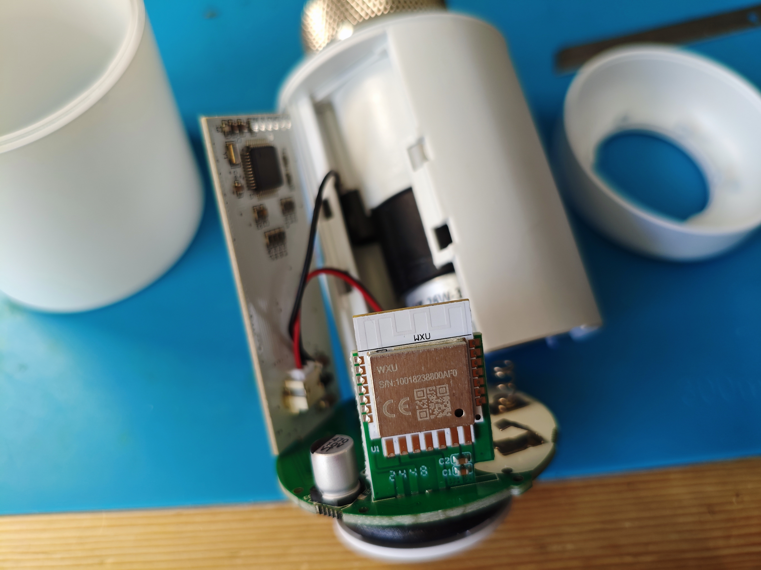

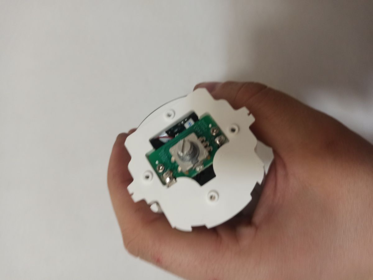

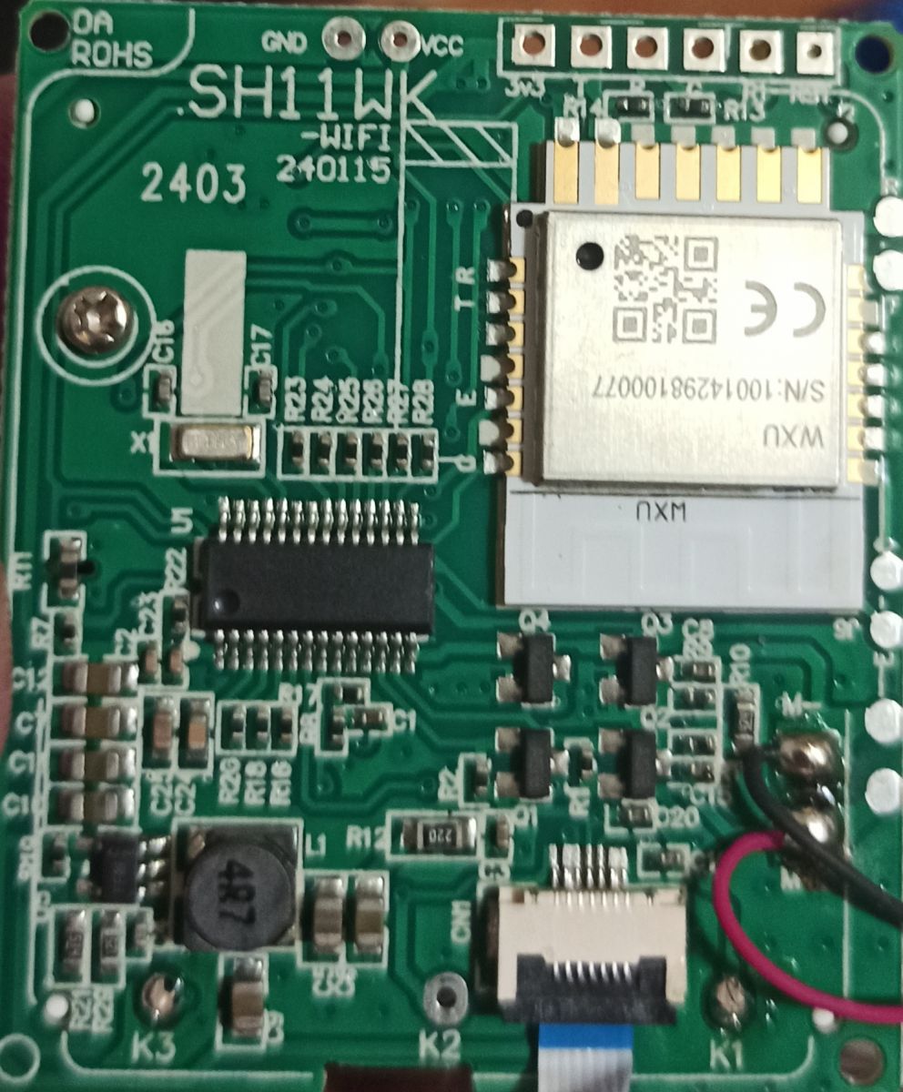

  • #73 21494477
    Majkyy98
    Posts: 36
    Help: 7
    Rate: 11

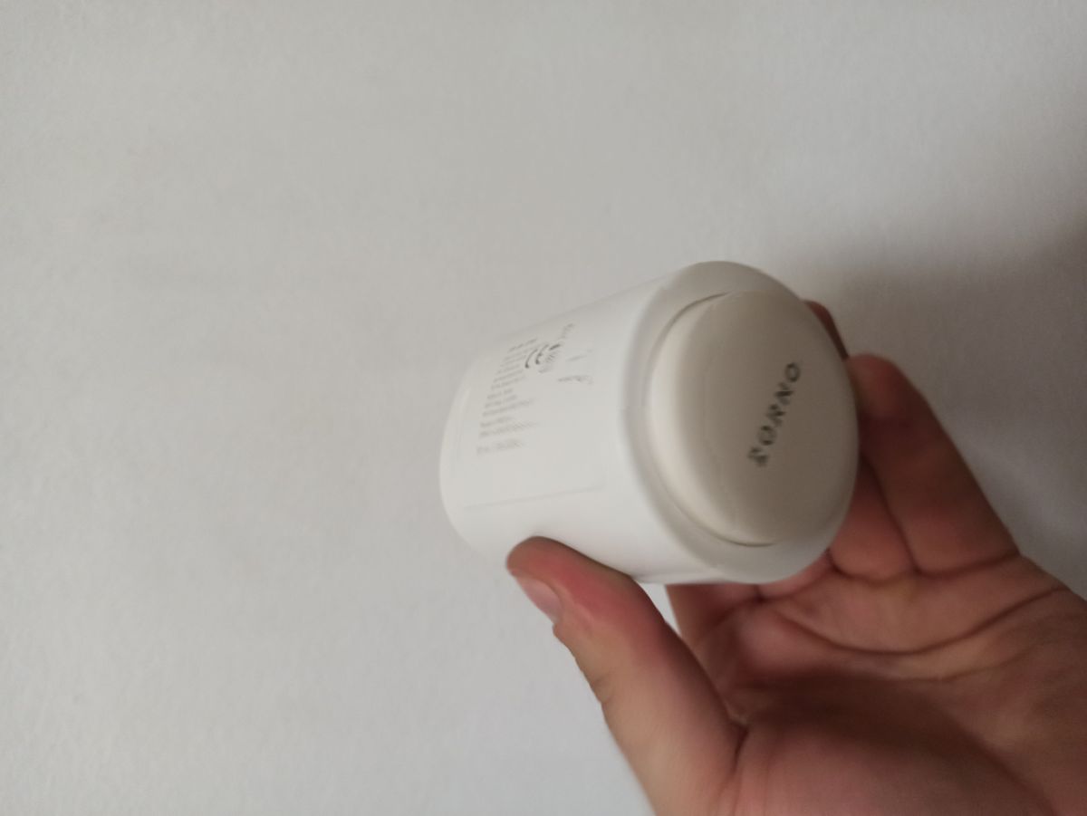

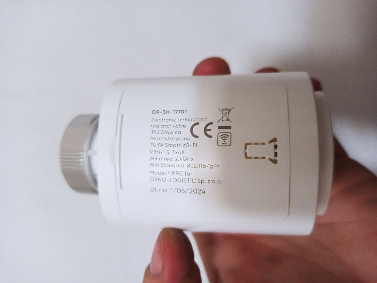

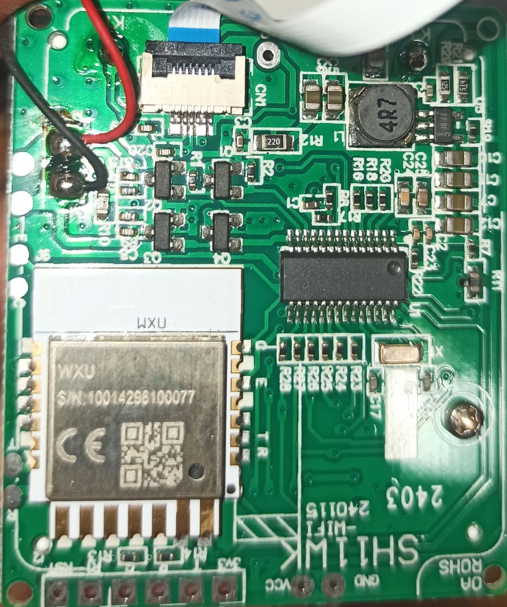

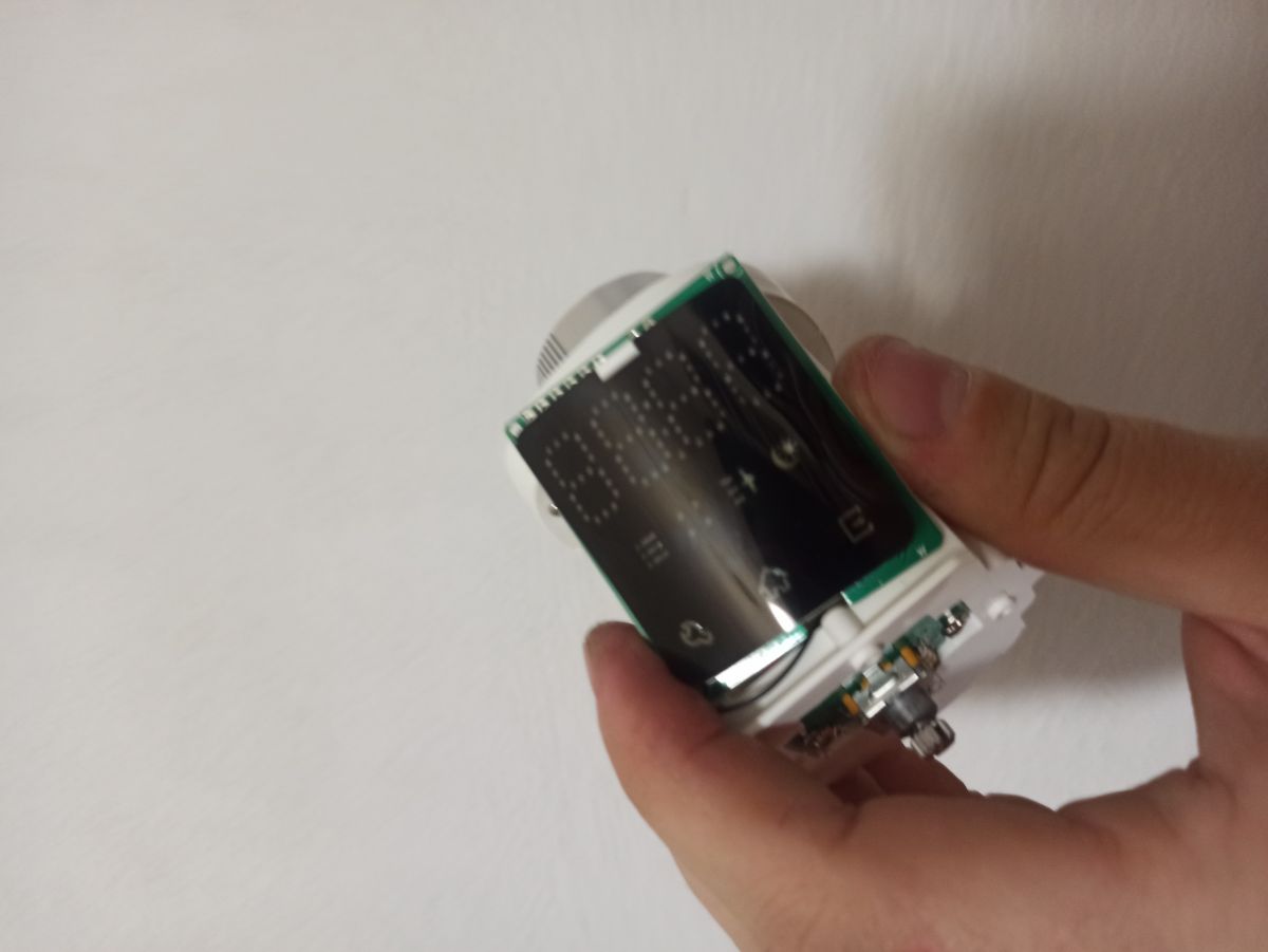

    And what would the situation be with a thermostat from Orno on a WXU module? After a private conversation with @p.kaczmarek2 I was directed here to the thread with the XR809.
    The manufacturer/distributor of the whole unit is Orno, with the Wi-Fi module board and other components inside. I am attaching pictures in the attachments of what this module looks like.
    After inserting the battery and setting the time, the device calibrates itself, then you can connect to the Tuya Smart app.
    I also found a complete datasheet of the module.
    https://developer.tuya.com/en/docs/iot/wxu-module-datasheet?id=Kc2xk9qlk04so

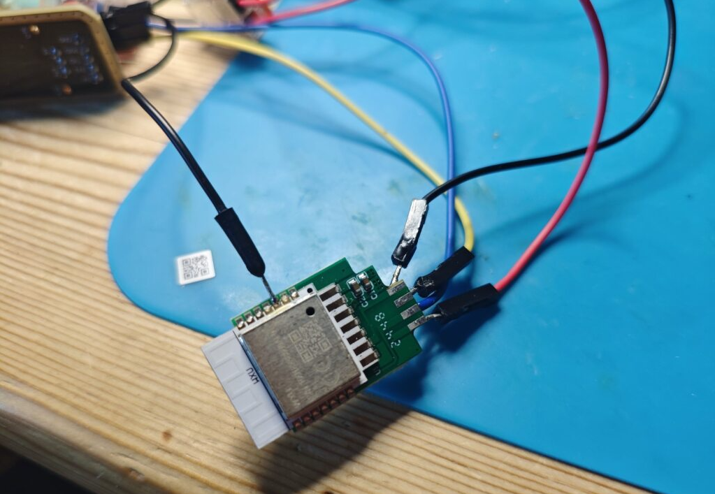

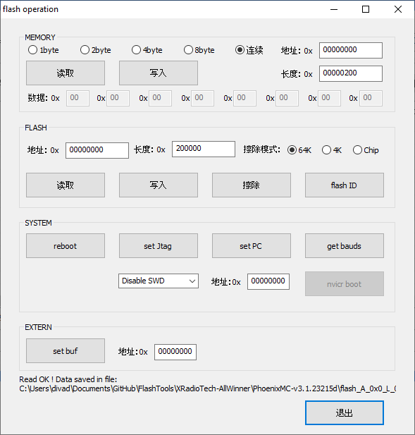

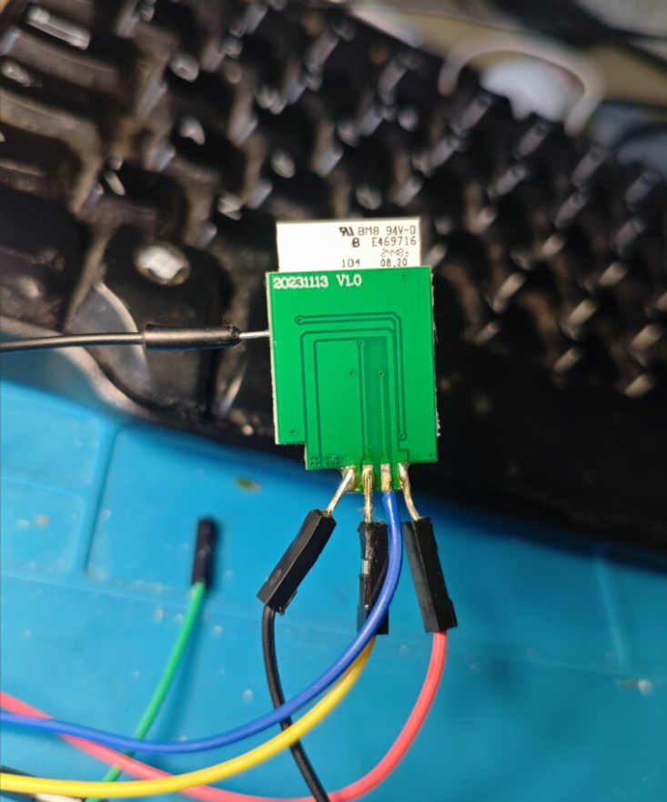

    Added after 1 [hours] 5 [minutes]:

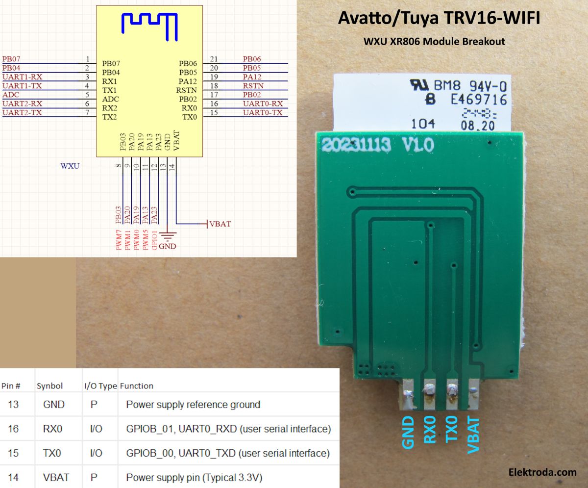

    >>21429278
    labelled these bits
    Tuya WXU XR806 from TRV Heater Device flashing, SDK, firmware change research Tuya WXU XR806 from TRV Heater Device flashing, SDK, firmware change research
    PB02 grounded and flash read success

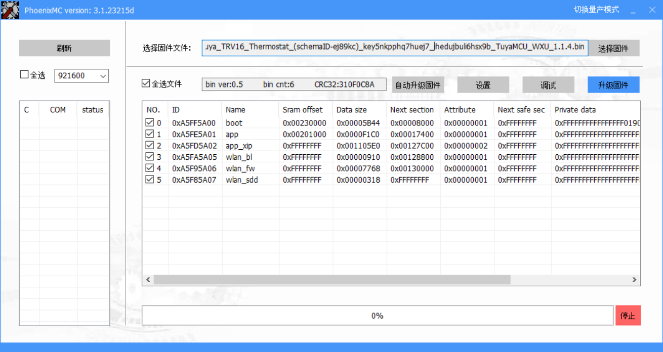

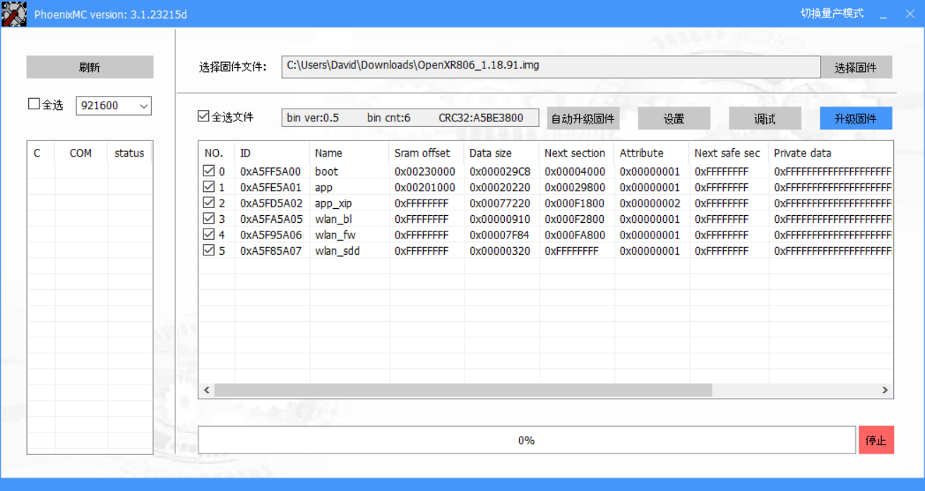

    Added after 1 [hours] 33 [minutes]:
    Tuya XR806 layout vs OpenXR806 for the record
    PhoenixMC program window version 3.1.23215d with a selected thermostat firmware file.
    Screenshot of the PhoenixMC program with an open firmware file and a list of sections to update.

    Posts: 5026
    Help: 438
    Rate: 891
    boots but no GUI for me. yes, 192.168.51.1.
    is this the cause
  • #88 21524436
    Posts: 14580
    Help: 654
    Rate: 12604
    Huh? I was sure the thread is created. Strange. It's XR806, are you sure? The one from @MrGenius thermostat?
  • #89 21524437
    Posts: 5026
    Help: 438
    Rate: 891
    yes. I've power-cycled a few times. will do more. Wifi is strong and stable
    Screenshot of Wi-Fi settings for the OpenXR806_00000000 network, displaying connection details and network properties.
    yes, WXU

How do I put an XR806 or Tuya WXU module into download mode, and which boot pins actually need to be grounded?
Ground PB02 to enter XR806 download mode. Early testing assumed PB02 and PB03 both had to be grounded, mirroring XR809 habits. Later notes in the same work said only PB02 needs to be pulled low on XR806, including successful flash reads from a WXU after grounding PB02. That makes XR806 easier to place in download mode than expected. [#21502313]

What is PhoenixMC, and how is it used with XR806 firmware images or upgrade commands during development?
PhoenixMC is the flashing utility used in this thread to parse, read, and write XR806 images. It successfully parsed SDK-built images, flashed stock and test binaries, and was later discussed as the possible path for an upgrade command that could avoid manual boot-pin grounding. In practice, it was the main tool for dumping firmware, restoring backups, and verifying whether new XR806 builds booted. [#21430654]
