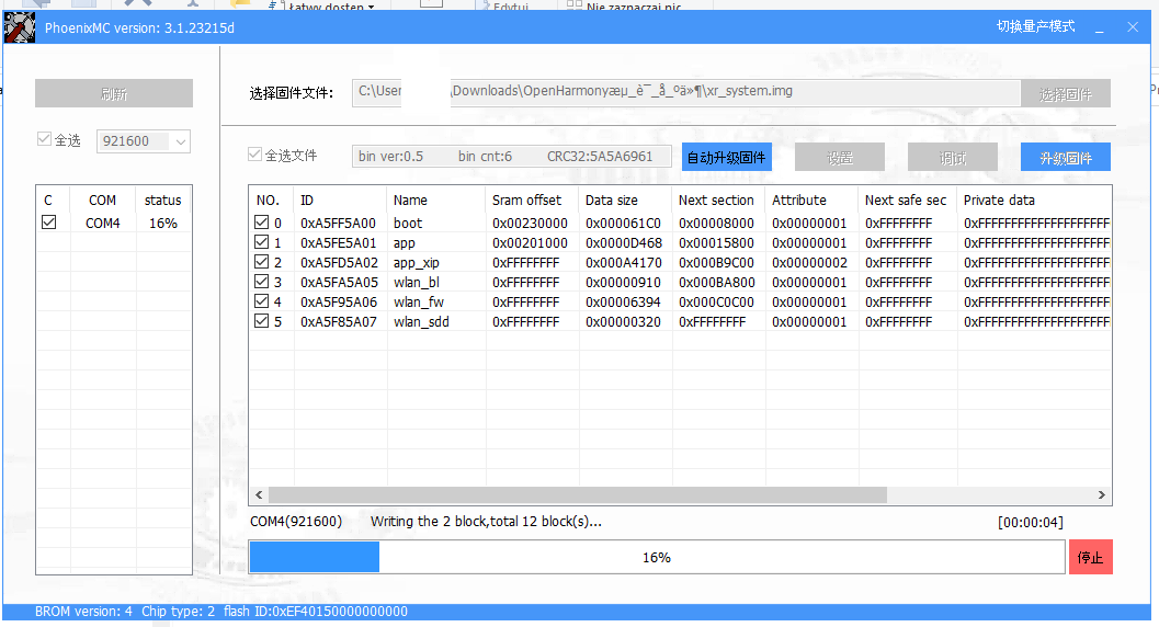

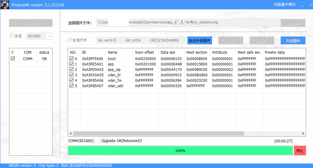

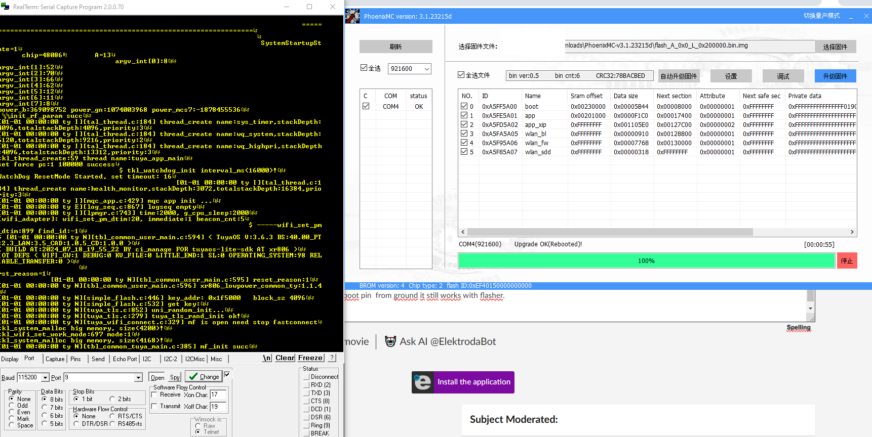

    I've tried to flash it:
    Tuya WXU XR806 from TRV Heater Device flashing, SDK, firmware change research
    Did it stuck?
    Ok, now there is no log output at all... and even after disconnecting boot pin from ground it still works with flasher.
    I flashed back backup"
    So no luck, it seems we need to try compiling samples from XR806 SDK

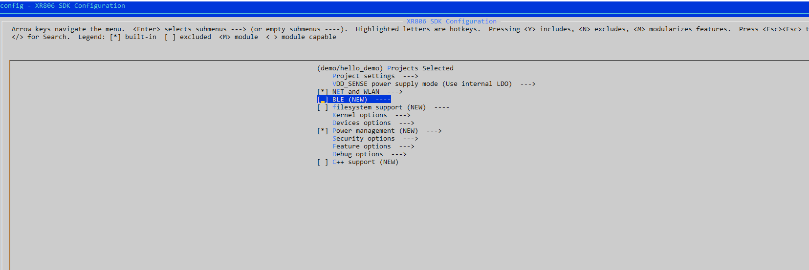

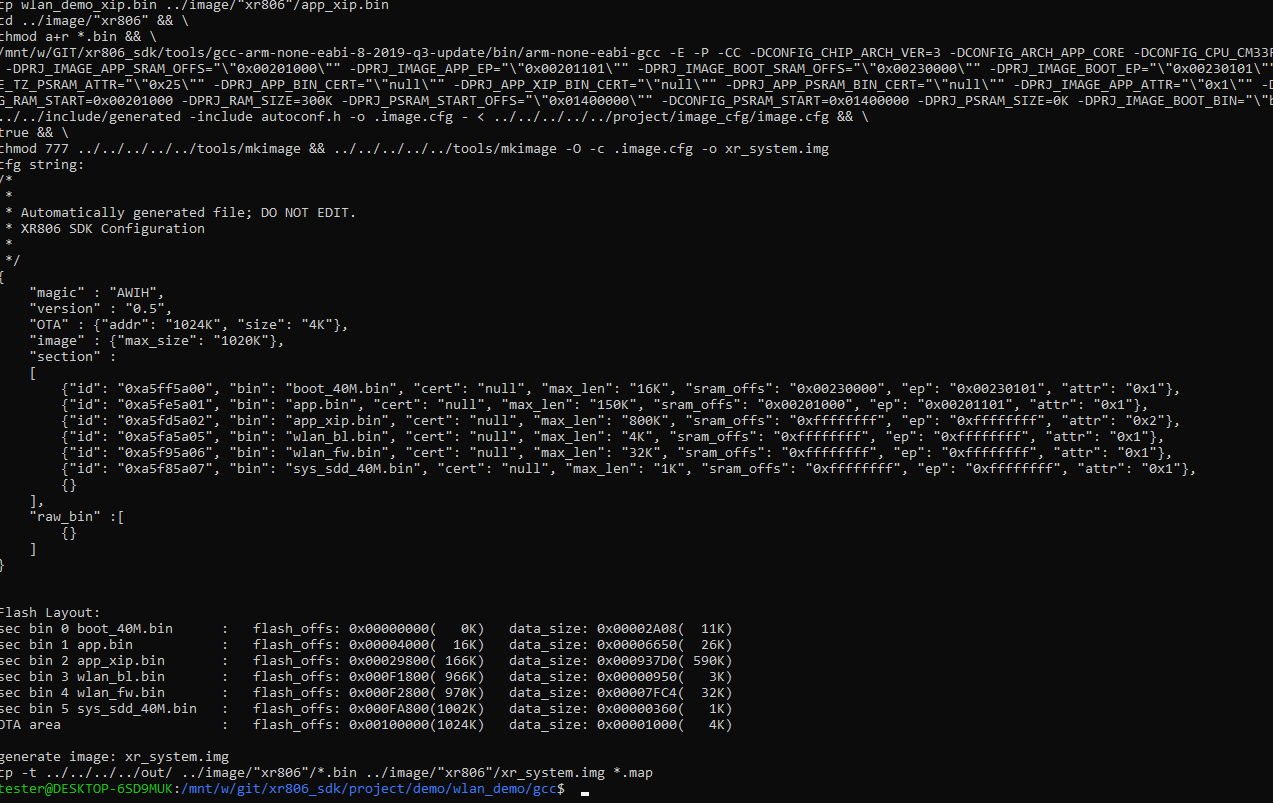

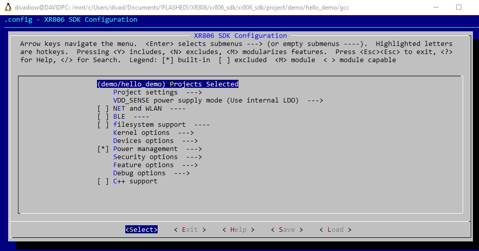

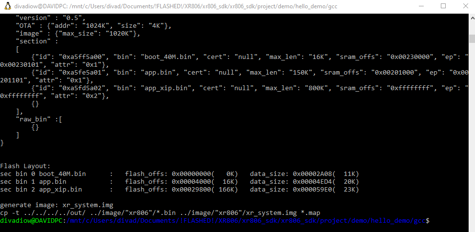

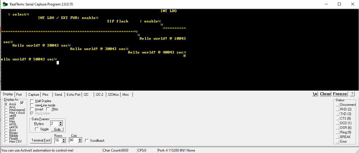

    I've built something. this is the hello_demo app
    make image
    but I didn't configure anything but the project path in make menuconfig
    • xr_system.zip (32.23 KB) You must be logged in to download this attachment.

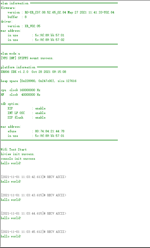

    I think this is the expected log output
    https://xr806.docs.aw-ol.com/study/soft_helloword/

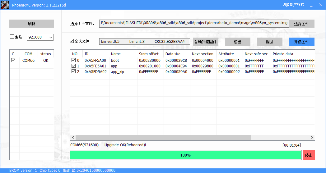

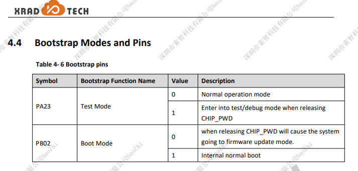

    Nothing on UART... maybe we should rather try this?
    https://xr806.docs.aw-ol.com/rtos/helloworld/
    Wait a second. It does work, but it prints on flashing UART, and not on the log one!
    I was checking wrong UART.

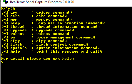

    Now you can try a WiFi sample or maybe AT commandline.

    wifi demo posted earlier. AT fails at the moment

    ha. menuconfig to the rescue
    building now it seems

    How does one use menuconfig? I haven't seen it in action for LWIP yet.
  • #43 21430800
    Posts: 5027
    Help: 438
    Rate: 891
    >>21430793
    https://github.com/divadiow/xr806_sdk/tree/master/project/demo/wlan_demo
    but I may not have had the lwip/wlan/ap settings check in menuconfig for that build, but it didnt fail...
    Added after 3 [minutes]:

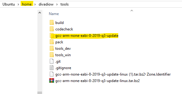

    im in wsl and at xr806_sdk root i run "make menuconfig" - I had some prereqs missing and maybe it complained about gcc location first too.
    prereqs were sorted with
    Code: Bash

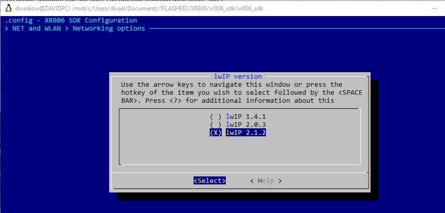

    Your WLAN demo is most likely missing crucial defines:
    - CONFIG_WLAN_AP
    - CONFIG_WLAN_STA
    - CONFIG_WLAN_MONITOR
    They are required to enable WiFi Commands:
    Code: C / C++
    You also need to define PRJCONF_NET_EN :
    Code: C / C++
    as it does not have yet net command...

    with lwip/ota/wlan whatever enabled still I am building wlan_demo again. it's taking longer too.
    I see mbedtls stuff at the moment

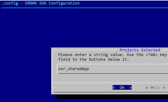

    I wonder if you can just point this menuconfig to the OBK project path and it'll build. just wild speculation

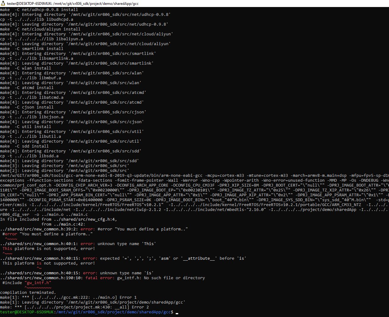

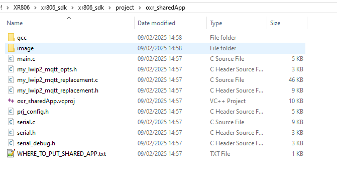

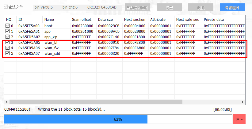

    This is the first time you've posted binary with wlan blobs:

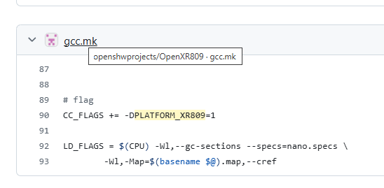

    In order to compile OBK, you must have this shared app:
    https://github.com/openshwprojects/OpenXR809/tree/master/project/oxr_sharedApp
    This is the OBK wrapper:
    https://github.com/openshwprojects/OpenXR809/blob/master/project/oxr_sharedApp/main.c
    Then you also need to make sure that platform define is set.
    https://github.com/search?q=repo%3Aopenshwprojects%2FOpenXR809%20PLATFORM_XR809&type=code
    It is fairly possible that you could just use XR806 SDK with PLATFORM_XR809 SDK define and that it will work.

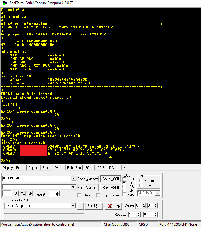

    Added after 10 [minutes]:
    With the previous wlan demo you've posted, the command line has changed. It's now AT command line. It takes standard AT commands, taken from ESP docs:
    AT+CWINIT: Initialize/Deinitialize Wi-Fi driver.
    AT+CWMODE: Set the Wi-Fi mode (Station/SoftAP/Station+SoftAP).
    AT+CWSTATE: Query the Wi-Fi state and Wi-Fi information.
    AT+CWJAP: Connect to an AP.
    AT+CWRECONNCFG: Query/Set the Wi-Fi reconnecting configuration.
    AT+CWLAPOPT: Set the configuration for the command AT+CWLAP.
    AT+CWLAP: List available APs.
    AT+CWQAP: Disconnect from an AP.
    AT+CWSAP: Query/Set the configuration of an ESP32 SoftAP.
    AT+CWLIF: Obtain IP address of the station that connects to an ESP32 SoftAP.
    AT+CWQIF: Disconnect stations from an ESP32 SoftAP.
    AT+CWDHCP: Enable/disable DHCP.
    AT+CWDHCPS: Query/Set the IPv4 addresses allocated by an ESP32 SoftAP DHCP server.
    AT+CWAUTOCONN: Connect to an AP automatically when powered on.
    AT+CWAPPROTO: Query/Set the 802.11 b/g/n protocol standard of SoftAP mode.
    AT+CWSTAPROTO: Query/Set the 802.11 b/g/n protocol standard of station mode.
    AT+CIPSTAMAC: Query/Set the MAC address of an ESP32 station.
    AT+CIPAPMAC: Query/Set the MAC address of an ESP32 SoftAP.
    AT+CIPSTA: Query/Set the IP address of an ESP32 station.
    AT+CIPAP: Query/Set the IP address of an ESP32 SoftAP.
    AT+CWSTARTSMART: Start SmartConfig.
    AT+CWSTOPSMART: Stop SmartConfig.
    AT+WPS: Enable the WPS function.
    AT+CWJEAP: Connect to a WPA2 Enterprise AP.
    AT+CWHOSTNAME: Query/Set the host name of an ESP32 station.
    AT+CWCOUNTRY: Query/Set the Wi-Fi Country Code.
    WiFi Scan works:
    With AT join command, I can join to WiFi:
    wlan scan success
    en1: Associated with 28:87:ba:a0:f5:6d
    en1: WPA: Key negotiation completed with 28:87:ba:a0:f5:6d [PTK=CCMP GTK=CCMP]
    en1: CTRL-EVENT-CONNECTED - Connection to 28:87:ba:a0:f5:6d completed [id=0 id_s
    tr=]
    [net INF] msg <wlan connected>
    [net INF] netif is link up
    [net INF] start DHCP...
    +EVT:2
    msg:0
    wlan connected
    WAR drop=1135, fctl=0x00d0.
    [net INF] netif (IPv4) is up
    [net INF] address: 192.168.0.155
    [net INF] gateway: 192.168.0.1
    [net INF] netmask: 255.255.255.0
    [net INF] msg <network up>
    +EVT:4
    msg:7
    network up
    OK

    looks like only PB02 needs to be pulled low to get XR806 into download mode, as opposed to PB02 and PB03 on XR809
    so, it seems I looked it up before for that Avatto SWT60

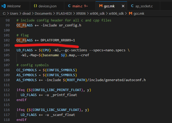

    Im failing my homework 😭
    am I linking up as if new - OpenXR806 or sticking to OpenXR809?
    this is set

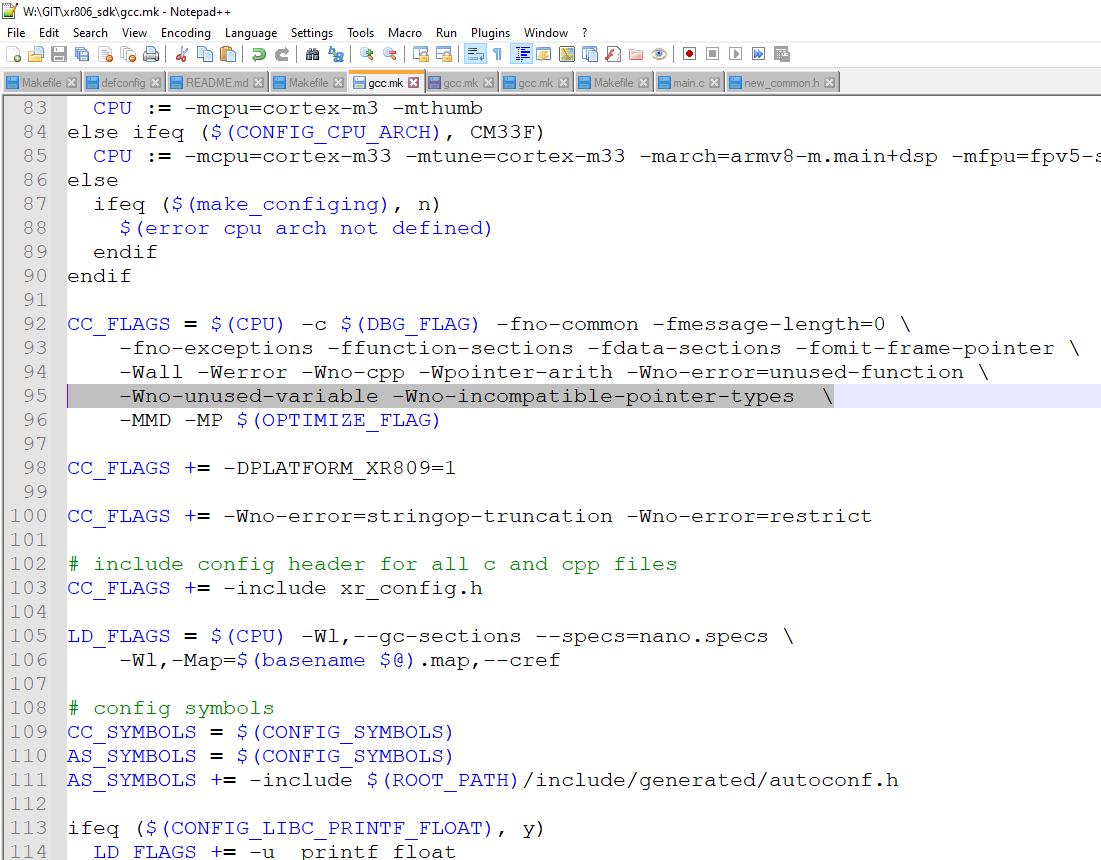

    Should I maybe start again with openshwprojects/OpenXR809 and openshwprojects/OpenBK7231T_App forks and replacing the content in OpenXR809 with the 806 sdk files? is that a clearer way round? hmm.

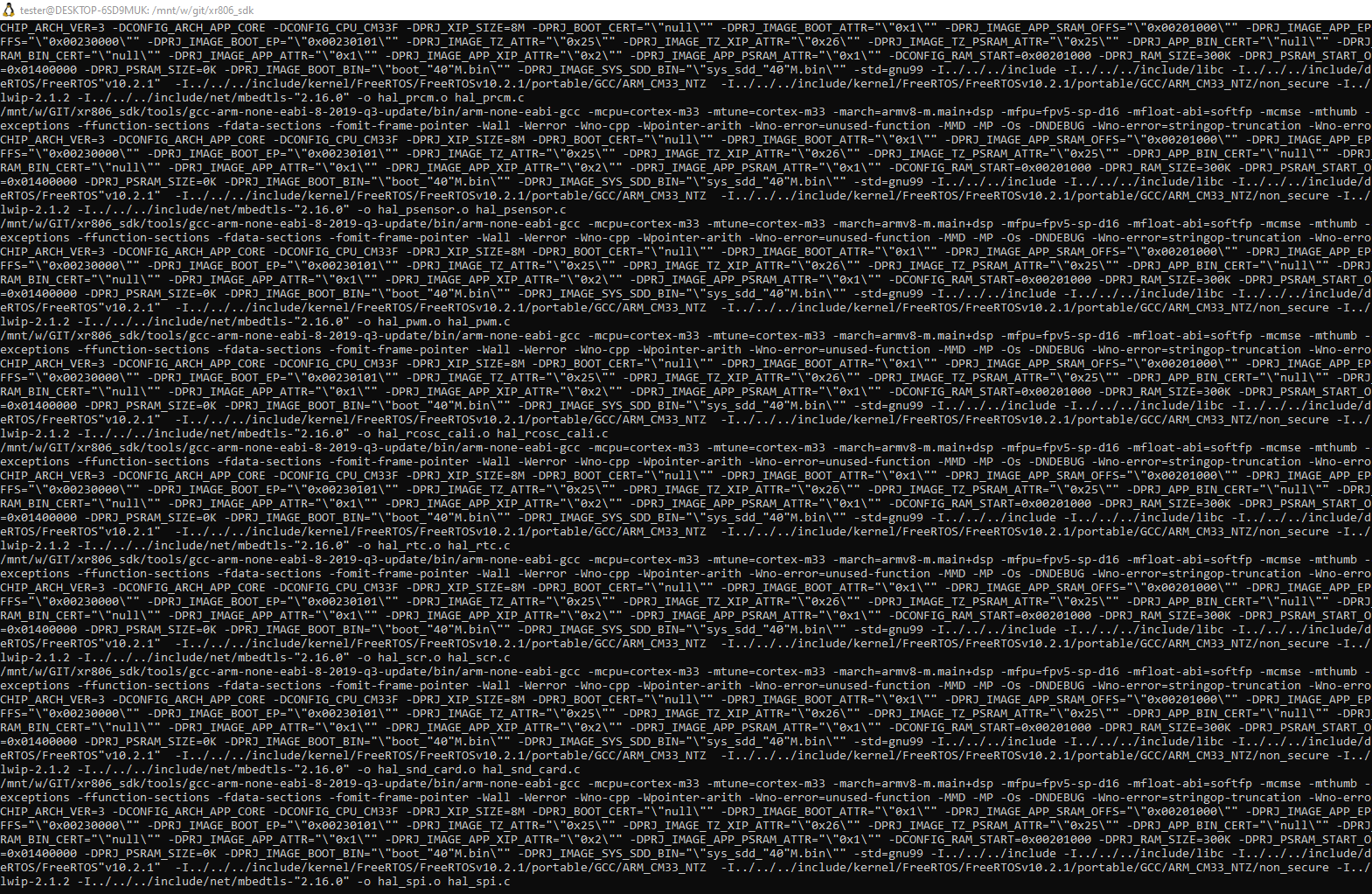

    I can help more if that's needed. Did you build menuconfig? So far I get:
    tester@DESKTOP-6SD9MUK:/mnt/w/GIT/OpenXR806$ make menuconfig
    make[1]: Entering directory '/mnt/w/GIT/OpenXR806/tools/config'
    HOSTLD build/mconf.o
    /usr/bin/ld: build/confdata.o:confdata.c:(.text+0x48): undefined reference to `___chkstk_ms'
    /usr/bin/ld: build/confdata.o:confdata.c:(.text+0x2e2): undefined reference to `__getreent'
    /usr/bin/ld: build/confdata.o:confdata.c:(.text+0x302): undefined reference to `__getreent'
    /usr/bin/ld: build/confdata.o:confdata.c:(.text+0x316): undefined reference to `__getreent'
    /usr/bin/ld: build/confdata.o:confdata.c:(.text+0x496): undefined reference to `__getreent'
    /usr/bin/ld: build/confdata.o:confdata.c:(.text+0x4fa): undefined reference to `___chkstk_ms'
    /usr/bin/ld: build/confdata.o:confdata.c:(.text+0x669): undefined reference to `__getreent'
    /usr/bin/ld: build/confdata.o:confdata.c:(.text+0xf8e): undefined reference to `__locale_ctype_ptr'
    /usr/bin/ld: build/confdata.o:confdata.c:(.text+0xfe2): undefined reference to `__errno'
    /usr/bin/ld: build/confdata.o:confdata.c:(.text+0x1382): undefined reference to `___chkstk_ms'

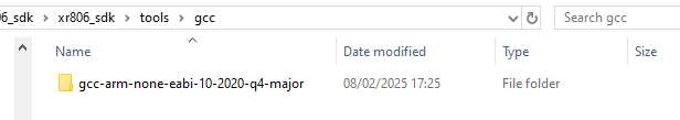

    I did not need to build menuconfig. straight into "make menuconfig" after sorting gcc and prereqs.
    I have this in linux home /tools
    and this under sdk/tools
    Code: Bash
  • #53 21432197

    menuconfig is build from source on the first run, so it can be used to generate required header:
    ../../../include/xr_config.h:33:10: fatal error: generated/autoconf.h: No such file or directory
     #include "generated/autoconf.h"
    but for now, I can't get menuconfig to build, neither or WSL, nor Cygwin, nor MSys... I'm not sure what's wrong, maybe it's an issue with C library.
    Which command line are you using? WSL?

    You can try zipping your sdk with build menuconfig and generated empty project. It seems that I have WSL1 and I can't install WSL2 due to Windows issue, I will most likely have to reinstall my OS.

    I am doing another attempt, from scratch:
    0. Introduction
    As mentioned in the previous article, building Unbuntu in Windows is not very user-friendly for novices. So I have been looking for a solution and found a very interesting solution. I hope it will be helpful to you.
    1. Environment Construction
    The core of the solution is Alibaba Cloud.
    The specific steps are as follows:
    step 1: Register. Log in to the development platform of Jishu Community .
    Setp2: Select a suitable cloud (free is the most important)
    Setp3: Configure the cloud server. Just follow the instructions, it doesn't cost money~~
    Pay attention to the system selection, choose Ubuntu 20 or 22
    and follow the instructions. Log in to the control interface through remote connection.
    Step 4: xr806 development configuration. When configuring, just follow the steps given by the boss:
    https://aijishu.com/a/1060000000432870
    SDK
    wget https://bbs.aw-ol.com/assets/uploads/files/1693988430633-xr806_sdk.tar.gz
    Unzip
    tar -zxvf 1693988430633-xr806_sdk.tar.gz
    Switch to tools and download toolchain
    cd xr806_sdk/tools
    wget https://armkeil.blob.core.windows.net/developer/Files/downloads/gnu-rm/8-2019q3/RC1.1/gcc-arm-none-eabi-8-2019-q3-update-linux.tar.bz2
    Unzip
    tar -xvf gcc-arm-none-eabi-8-2019-q3-update-linux.tar.bz2
    Modify gcc.mk
    View the file structure in the same way as the folder
    ##First copy the path of gcc
    ##Open gcc.mk and modify
    2. Testing
    Execute the following two commands in the xr806_sdk directory:
    cp project/demo/hello\_demo/gcc/defconfig .config
    make menuconfig
    As expected, there is a problem and a patch is needed.
    Install the plugin:
    sudo apt-get update
    sudo apt-get install libncurses5-dev
    Then, rerun:
    make menuconfig
    Great news! Finally succeeded!
    ##Click Save, then Exit. Then run:
    make build_clean
    make build -j$(nproc)
    3. Start enjoying XR806.
    Compiled results, can be downloaded and deleted.
    Got it futher?

    Looking better!
  • #57 21432362
    Posts: 14580
    Help: 654
    Rate: 12604

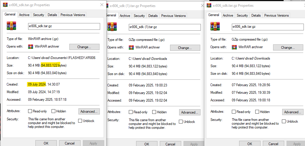

    Did you use the same SDK as me? Why the one downloaded via commandline worked and the one from Github didn't?
    Futher changed I did: gcc.mk , I changed path to toolchain from tools:
    # Common rules for GCC Makefile
    # cross compiler
    CC_DIR ?= /mnt/w/GIT/xr806_sdk/tools/gcc-arm-none-eabi-8-2019-q3-update/bin
    CC_PREFIX := $(CC_DIR)/arm-none-eabi-
    AS      := $(CC_PREFIX)as
    CC      := $(CC_PREFIX)gcc
    CPP     := $(CC_PREFIX)g++
    LD      := $(CC_PREFIX)ld
    NM      := $(CC_PREFIX)nm
    AR      := $(CC_PREFIX)ar
    Something is compiling:
    Added after 8 [minutes]:
    Maybe I was missing toolchain from tools dir

    The SDK on GitHub is a fresh extraction of xr806_sdk.tar.gz from https://aijishu.com/a/1060000000426976 which I had in July. The SDK folder I have been compiling from was extracted in July but I dont think anything was changed until yesterday, I only used it to get newer PhoenixMC.
    all the copies I have are identical. I did sort GCC first...
    have you flashed a successfully built OpenXR806??

    Trying to compile:
    Few errors:
    ject/common/board/xr806_dig_ver  -o ../main.o ../main.c
    In file included from ../shared/src/new_common.h:231,
                     from ../shared/src/new_cfg.h:4,
                     from ../main.c:42:
    ../../../../include/net/lwip-2.1.2/lwip/sockets.h:690: error: "close" redefined [-Werror]
     #define close(s)                                  lwip_close(s)
    In file included from ../shared/src/new_cfg.h:4,
                     from ../main.c:42:
    ../shared/src/new_common.h:120: note: this is the location of the previous definition
     #define close lwip_close
    ../main.c: In function 'rtos_create_thread':
    ../main.c:59:24: error: passing argument 1 of 'OS_ThreadCreate' from incompatible pointer type [-Werror=incompatible-pointer-types]
      err = OS_ThreadCreate(thread,
    In file included from ../../../../include/kernel/os/os.h:34,
                     from ../../../../project/common/framework/sys_ctrl/publisher.h:35,
                     from ../../../../project/common/framework/sys_ctrl/sys_ctrl.h:36,
                     from ../../../../project/common/framework/net_ctrl.h:39,
                     from ../main.c:40:
    ../../../../include/kernel/os/os_thread.h:92:40: note: expected 'OS_Thread_t *' {aka 'struct OS_Thread *'} but argument is of type 'void **'
     OS_Status OS_ThreadCreate(OS_Thread_t *thread, const char *name,
    ../main.c: In function 'rtos_delete_thread':
    ../main.c:70:29: error: passing argument 1 of 'OS_ThreadDelete' from incompatible pointer type [-Werror=incompatible-pointer-types]
         return OS_ThreadDelete( thread );
                     from ../main.c:40:
    ../../../../include/kernel/os/os_thread.h:108:40: note: expected 'OS_Thread_t *' {aka 'struct OS_Thread *'} but argument is of type 'void **'
     OS_Status OS_ThreadDelete(OS_Thread_t *thread);
    ../main.c: In function 'main':
    ../main.c:130:6: error: unused variable 'res' [-Werror=unused-variable]
      int res;
    At top level:
    ../main.c:74:20: error: 'g_helloworld_thread' defined but not used [-Werror=unused-variable]
     static OS_Thread_t g_helloworld_thread;
    cc1: all warnings being treated as errors
    make[1]: *** [../../../../gcc.mk:225: ../main.o] Error 1
    make[1]: Leaving directory '/mnt/w/git/xr806_sdk/project/demo/sharedApp/gcc'
    make: *** [../../../../project/project.mk:430: __all] Error 2
    Ok, silenced:
    Added after 7 [minutes]:
    What a restrictive compiler setup:
    ./shared/src/new_pins.c: In function 'PIN_SetPinRoleForPinIndex':
    ../shared/src/new_pins.c:977:8: error: variable 'channelValue' set but not used [-Werror=unused-but-set-variable]
        int channelValue;
    I will just disable it
    Added after 13 [minutes]:
    Ok stuck for now:
    red/src/logging/logging.c
    ../shared/src/logging/logging.c:124:2: error: unknown type name 'SemaphoreHandle_t'
      SemaphoreHandle_t mutex;
    ../shared/src/logging/logging.c: In function 'addLogAdv':
    ../shared/src/logging/logging.c:282:2: error: unknown type name 'BaseType_t'; did you mean 'logType_t'?
      BaseType_t taken;
      logType_t
    ../shared/src/logging/logging.c:365:16: error: 'pdTRUE' undeclared (first use in this function)
       if (taken == pdTRUE) {
    ../shared/src/logging/logging.c:365:16: note: each undeclared identifier is reported only once for each function it appears in
    ../shared/src/logging/logging.c:413:23: error: 'portTICK_RATE_MS' undeclared (first use in this function)
        timems = (((1000 / portTICK_RATE_MS) * len) / cps) + 2;
    ../shared/src/logging/logging.c: In function 'getData':
    ../shared/src/logging/logging.c:423:2: error: unknown type name 'BaseType_t'; did you mean 'logType_t'?
      BaseType_t taken;
      logType_t
    ../shared/src/logging/logging.c:448:15: error: 'pdTRUE' undeclared (first use in this function)
    I need to check if we have SemaphoreHandle_t in the SDK

  • Tuya WXU was discussed as XR806-class hardware because logs showed XR806 SDK v1.2.1/v1.2.2, 160 MHz CPU, 40 MHz HF clock, Wi‑Fi, and BLE on real thermostat hardware. [#21429243]
  • The thread compared memory claims directly: Tuya WXU listed 320 KB SRAM, while one XR806 spec mentioned 288 KB SRAM, which caused early confusion about whether WXU was a Tuya-specific variant. [#21429143]
  • A real TuyaOS boot log on WXU showed TuyaOS V3.6.3 built on 2024-07-18, with xr806_lowpower_common_ty 1.1.4 and a product AP named SmartLife-4649. [#21429243]
  • XR806 flashing and logging used different serial paths in practice: successful tests showed firmware output on the flashing UART, while boot logs from stock firmware were often captured on a different UART. [#21430698]
  • OpenBeken config saving started working after moving XR806 sysinfo to 0x1FC000, leaving about 12 KB free before the end of a 2 MB flash. [#21533999]

How do I put an XR806 or Tuya WXU module into download mode, and which boot pins actually need to be grounded?
Ground PB02 to enter XR806 download mode. Early testing assumed PB02 and PB03 both had to be grounded, mirroring XR809 habits. Later notes in the same work said only PB02 needs to be pulled low on XR806, including successful flash reads from a WXU after grounding PB02. That makes XR806 easier to place in download mode than expected. [#21502313]
Why do I get a sync or 'synchron waiting' error when trying to read or flash an XR806, and how should TX/RX be wired?
Sync errors usually came from using the wrong UART pair or wiring TX/RX the wrong way. One tester fixed an XR-series sync issue after realizing the correct lines were UART0, not UART1. Another note added that for one XR case, RX had to go to RX and TX to TX for boot-log capture. If you see "synchron waiting," verify UART0 pins first and avoid assuming classic cross-over wiring. [#21429353]
Which UART on the XR806/WXU is used for flashing and which one outputs the boot log?
They are not always the same UART in practice. A key test showed an XR806 sample did work, but its output appeared on the flashing UART rather than the log UART the tester first monitored. Earlier stock-firmware work also captured boot text from RXD0. The safe rule is to probe both serial paths before assuming the board is dead. [#21430698]
How do I build XR806 SDK examples like hello_demo, wlan_demo, or at_demo with make menuconfig under WSL?
Build them from WSL with the SDK root as your working directory. 1. Install prerequisites such as build-essential and ncurses development packages. 2. Set the ARM GCC path in gcc.mk to the toolchain under sdk/tools. 3. Copy a demo defconfig, run make menuconfig, then make build or make image. This flow worked under WSL2 after GCC and ncurses were fixed. [#21432260]
What causes the lwip/netif.h missing error or OTA-related build failures in the XR806 SDK demos, and which menuconfig options fix them?
Those errors came from disabled network components in menuconfig, not from broken demo code alone. The lwip/netif.h failure appeared while building at_demo, and enabling lwIP, WLAN, AP/STA options, and OTA made the build progress. The thread also called out CONFIG_WLAN_AP, CONFIG_WLAN_STA, CONFIG_WLAN_MONITOR, and PRJCONF_NET_EN as required for full WLAN command support. [#21430812]
