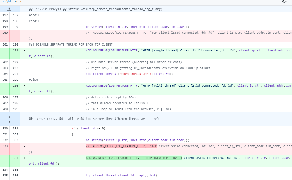

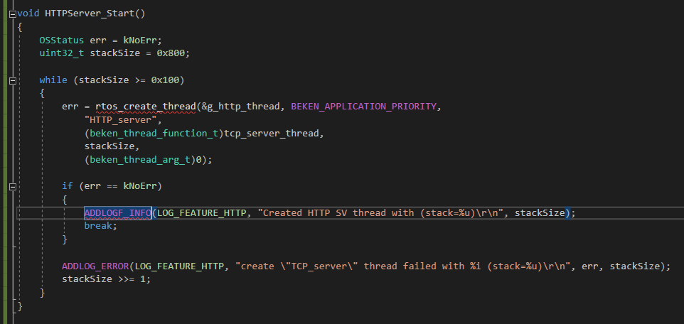

    EDIT: you confirmed, it creates HTTP thread.
    Error:HTTP:Created HTTP SV thread with (stack=2048)
    A code snippet in C/C++ showing a function to start an HTTP server, with a highlighted log info line.
    Added after 3 [minutes]:

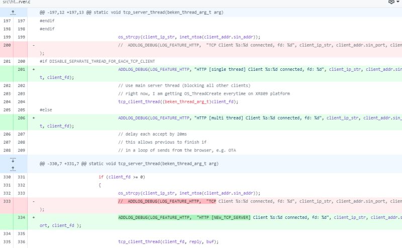

    I will push this:
    Screenshot of a C source code file diff with colored highlighting for added (green) and removed (red) code lines.
    If it builds, can you check whether you get this connection prints, and if so, do you get them once and then it locks forever, or do you get with each connection to HTTP attempt?

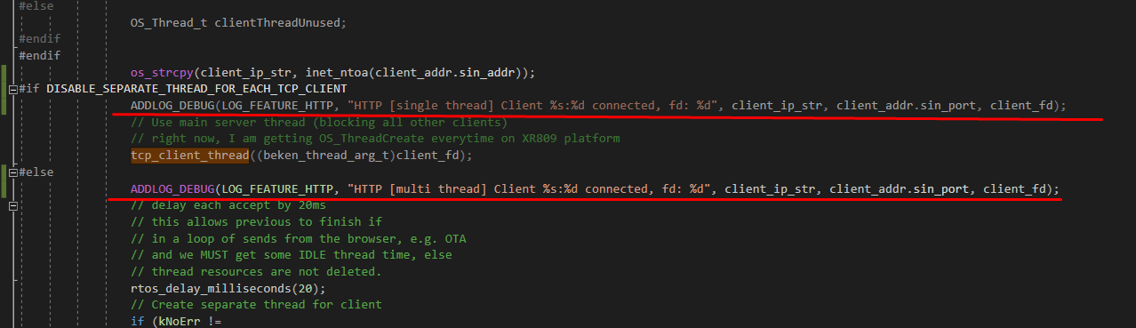

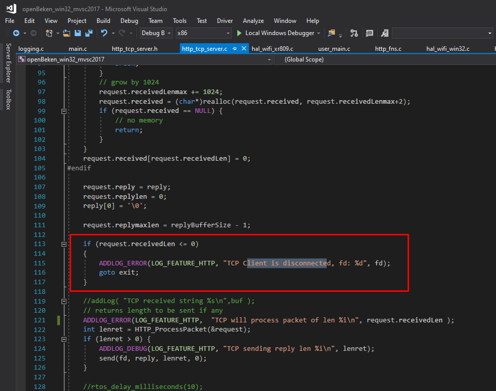

    Wait, it may be my fault. The message is only in debug mode, and without HTTP panel, you have no way to enable it... let's recompile with error mode.
    I also added:
    	ADDLOG_ERROR(LOG_FEATURE_HTTP,  "TCP will process packet of len %i\n", request.receivedLen );
    Your message comes from here:
    Screenshot of Visual Studio showing C code with an error handling block highlighted in red.
    It suggests that recv did not receive anything after the TCP connection was accepted.

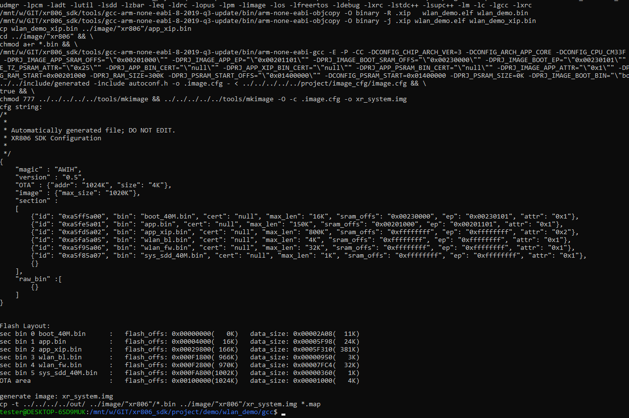

    Extra questions - do you know how to use at_demo or wlan_demo of XR806 SDK?
    Terminal screen showing XR806 system image build and configuration, including code sections and flash layout.
    • at_demo.zip (814.55 KB) You must be logged in to download this attachment.
    • wlan_demo.zip (631.3 KB) You must be logged in to download this attachment.
  • #99 21524551
    Posts: 5026
    Help: 438
    Rate: 891
    not tried either, or much AT, but what are you thinking?

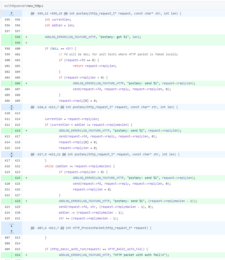

    Wait, so it actually receives packets? Then why no reply?
    Error:HTTP:TCP will process packet of len 479
    Let me enable this:
    ADDLOG_ERROR(LOG_FEATURE_HTTP, "TCP sending reply len %i\n", lenret);
    I changed my mind currently. We don't need to try AT demo. We need to check if it tries to send back any data with:

    If that's the case, then last option is here:
    Code: C / C++
    Screenshot of a version control diff showing changes in new_http.c, with added debugging log lines using ADDLOG_ERROR.

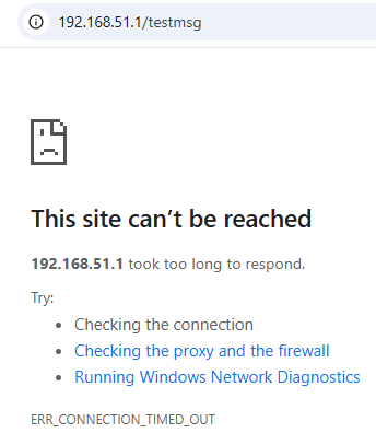

    Btw, you didn't specify what exactly the browser says... it says empty reply? Or timed out? When opening device page...
  • #103 21524592
    Posts: 5026
    Help: 438
    Rate: 891
    edge
    chrome
  • #104 21524594
    Posts: 14580
    Help: 654
    Rate: 12604

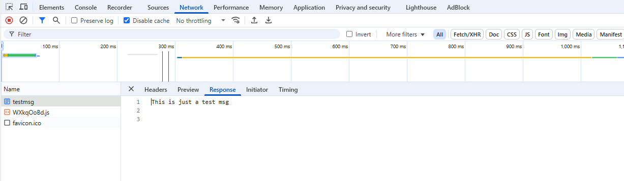

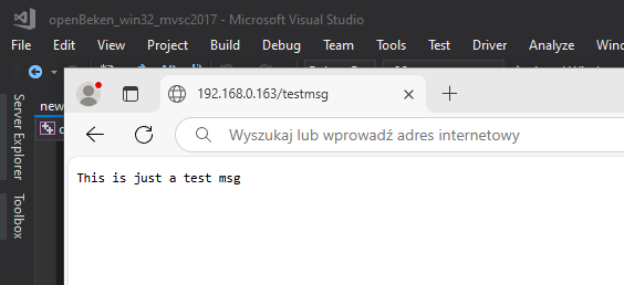

    Btw what if you try to open:
    http://192.168.0.163/testmsg
    Insert your IP. It's a message without HTTP header. Just few bytes.
    Browser window at 192.168.0.163/testmsg displaying the text: This is just a test msg.
    Screenshot of the Network tab in Chrome DevTools with selected testmsg response.
    It's present in all builds.

    So the next step is to see whether we get anything in postany. If we do, then send function of LWIP is somehow not working with us...

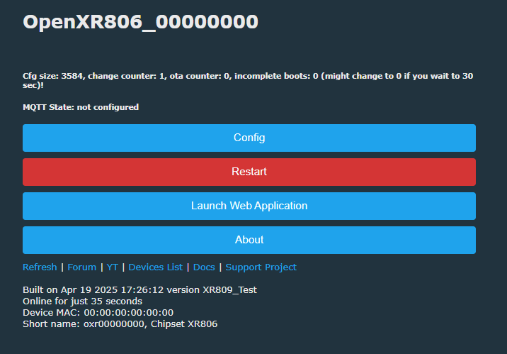

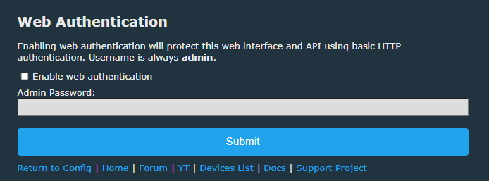

    WHAT? Omg.
    So auth code is blocking HTTP on XR806 and only on XR806?
    I am not even the author of auth code. The main problem is solved, but HOW?
    I would never suspect that!
    How is it possible that AUTH is enabled on XR806 by default... and webPassword is set?
    Code: C / C++
    It looks like config has some garbage it, but it should not be possible, with CRC check...

    And now, what kind of password do you have in in Web Password setting? And how did it even got there...
    Added after 31 [seconds]:
    So you are the first person in the world to run custom http page (custom firmware) on XR806. Call @MrGenius
  • #111 21524641
    Posts: 5026
    Help: 438
    Rate: 891
    empty
    Web authentication setup panel with admin password field and blue Submit button.

    Ah, I see... there was a stub for this function. I can give better fix now.
    Added after 46 [minutes]:
    Ok, I merged this fix. What do we enable for XR806 next?

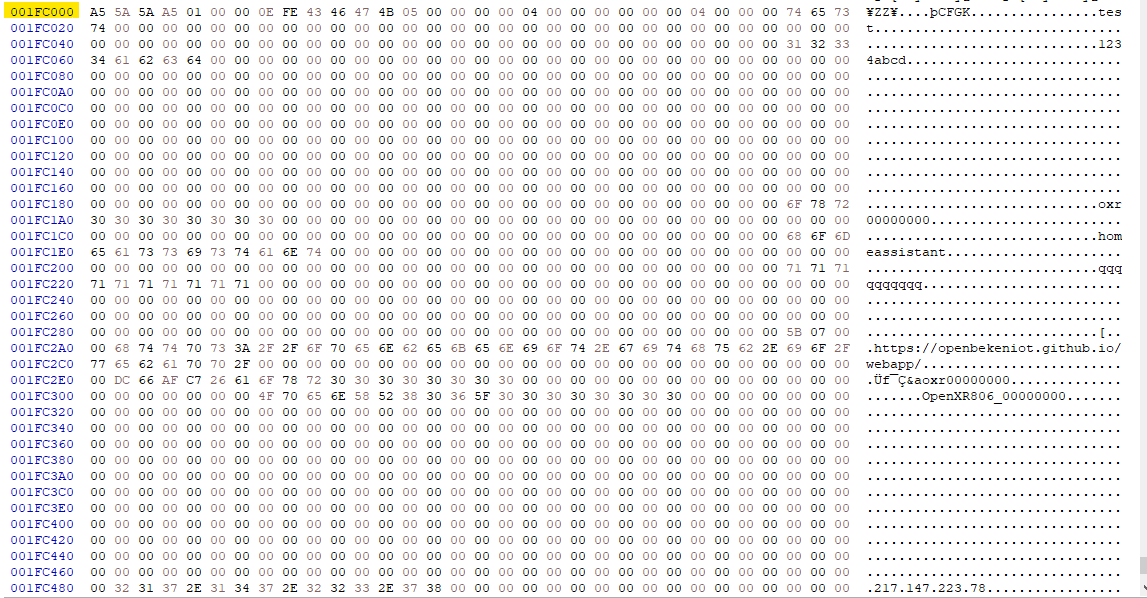

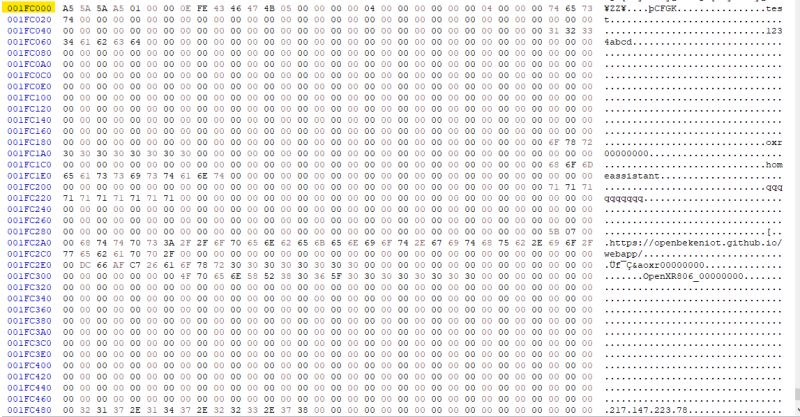

    @divadiow I think the flash write/read (config) can be fixed just by choosing a free flash offset here:
    https://github.com/openshwprojects/FlashDumps/commit/b52dbd6579eec97b94533ce9b0094b130fa082be
    #define OUR_CUSTOM_SYSINFO_ADR PRJCONF_SYSINFO_ADDR
    you can change it globally for now in PR, but then make sure your change is in #if PLATFORM_XR806 so we dont break other XRs, there are now 3 of them (XR809, XR806, XR872)
  • #117 21529856
    Posts: 14580
    Help: 654
    Rate: 12604
    Yes, sorry.
    Check what I did for XR872 to fix flash config save:
    https://github.com/openshwprojects/OpenXR872/commit/ecb41f9d122983acb1743715d32f389eee15e07d
    Maybe the same could be done for XR806, but one would have to check. To speed up testing, you can try adding offsets directly in hal_flashConfig_xr809.c
