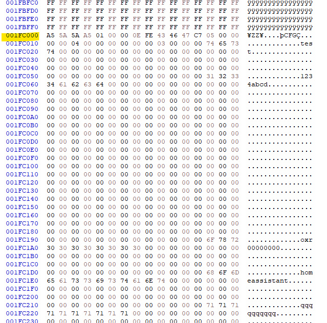

  • OpenBeken config saving started working after moving XR806 sysinfo to 0x1FC000, leaving about 12 KB free before the end of a 2 MB flash. [#21533999]

Where should the sysinfo/config flash offset be placed on XR806 so OpenBeken settings are saved correctly without breaking XR809 or XR872?
Place XR806 sysinfo at 0x1FC000 and gate it with an XR806-specific platform check. Direct testing showed OpenBeken started saving config correctly at 0x1FC000, with about 12 KB left before the 2 MB flash end at 0x200000. The thread explicitly warned not to hardcode that address globally, because XR809 and XR872 use different layouts and need separate handling. [#21533999]
