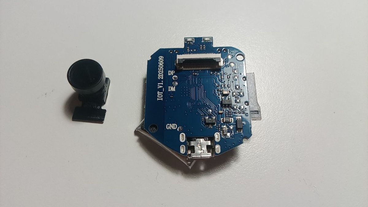

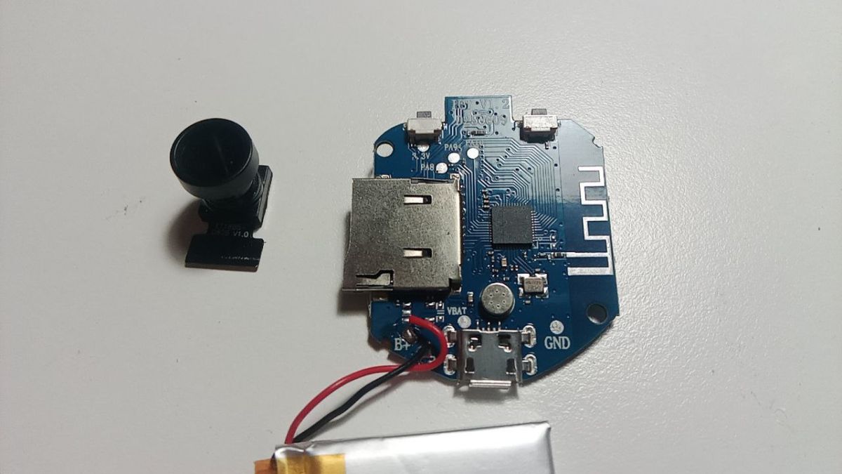

    Hi all, I got a variation of the A9 camera
    Camera module and circuit board with electronic components
    Electronics PCB with camera module, micro USB, and microSD slot
    with a TXW817 (TXW817-810 CWCN4A G2523)
    I come here from a GitHub issue [ @divadiow ] on cam-reverse, as I'd like to destroy experiment with my camera and open firmwares

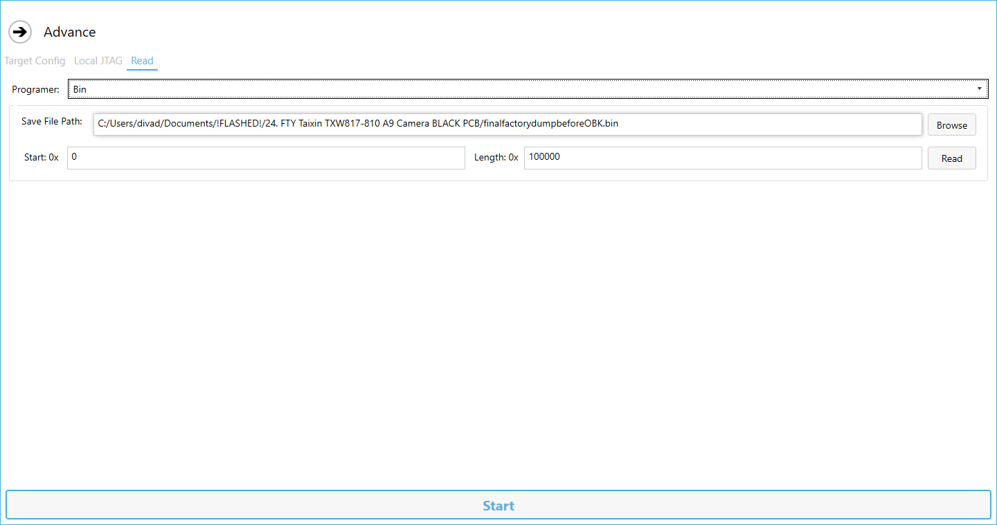

    just taking a final backup of that black PCB A9 before trying OpenTXW817 on it
    Software interface for reading BIN file data from device memory
    Electronic boards connected with wires on a wooden table
    this bit in that guide
    divadiow wrote:
    Under "Local JTAG" tab set ICE Clk to 1200Khz
    appears to suggest it has to be that frequency. It doesn't. I've had to go lower to achieve write success before. I'll adjust wording.

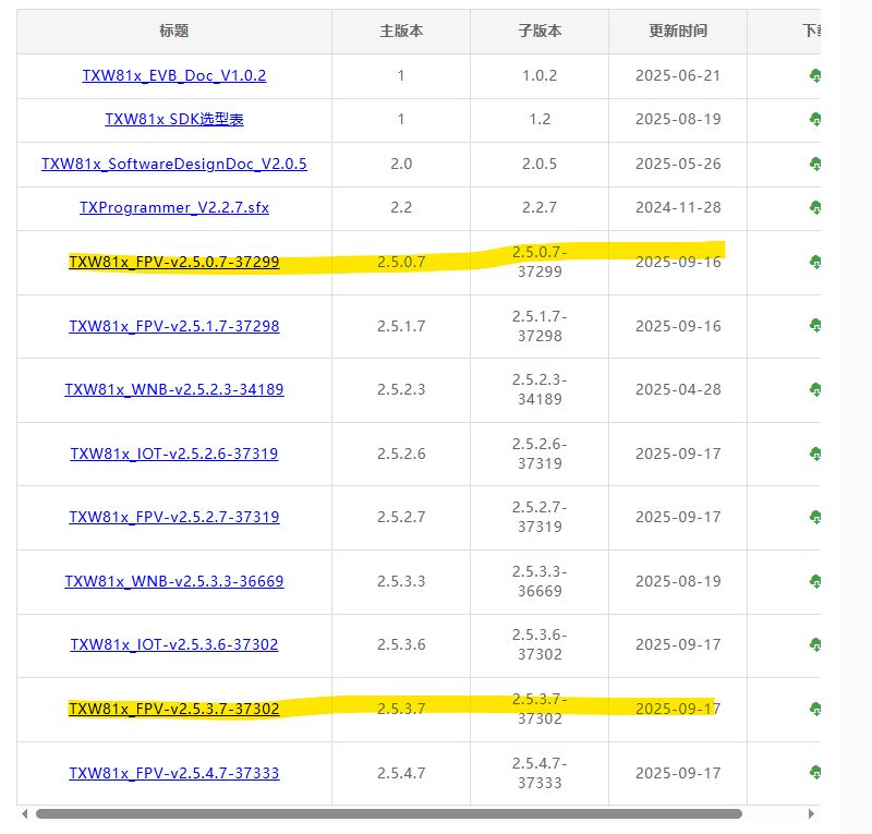

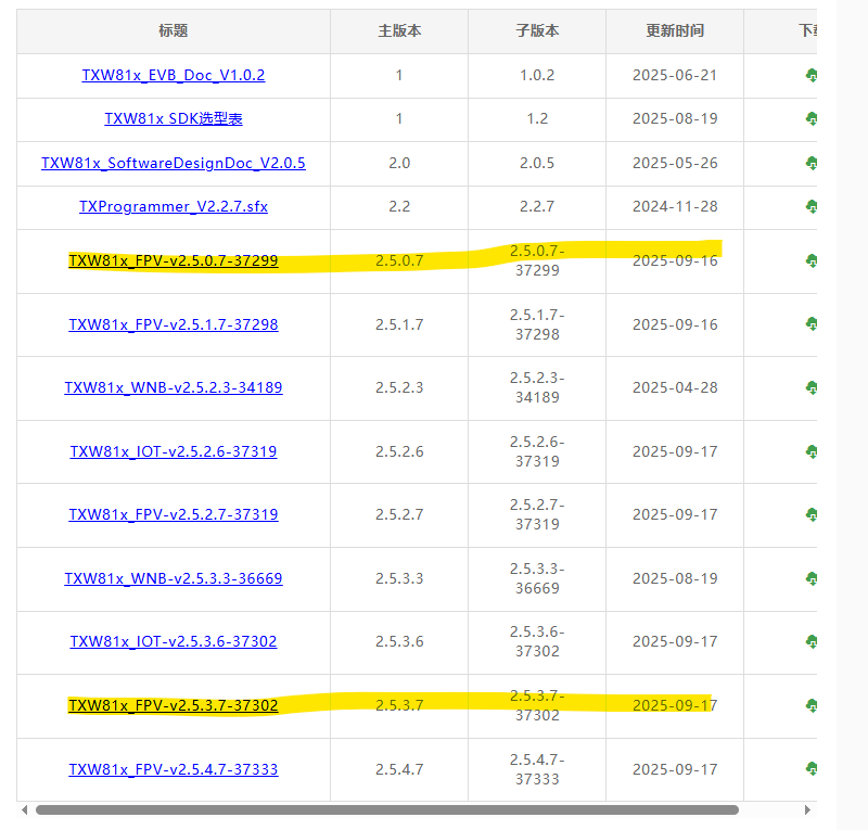

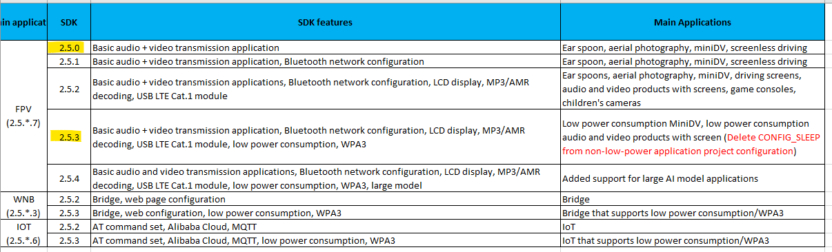

    New TXW81x_FPV-v2.5.3.7-37302 SDK updates
    #130 21692388
    Posts: 5208
    Help: 446
    Rate: 914
    >>21644977 >>21644977

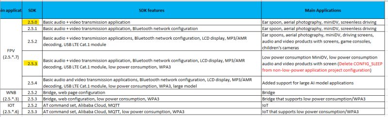

    new SDKs
    Mini 1080p wifi camera from Aliexpress, how to use without app (FtyCamPro)?
    I wonder if 2.5.0 would have been a better, slimmer choice? Or maybe it just means undefining less vs 2.5.3
    • TXW81x_FPV-v2.5.3.7-37302_20250917120347.zip (21.07 MB) You must be logged in to download this attachment.
    • TXW81x_FPV-v2.5.0.7-37299_20250916095820.zip (15.24 MB) You must be logged in to download this attachment.

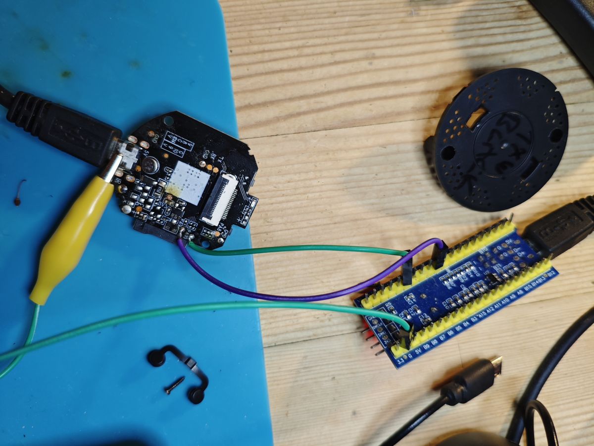

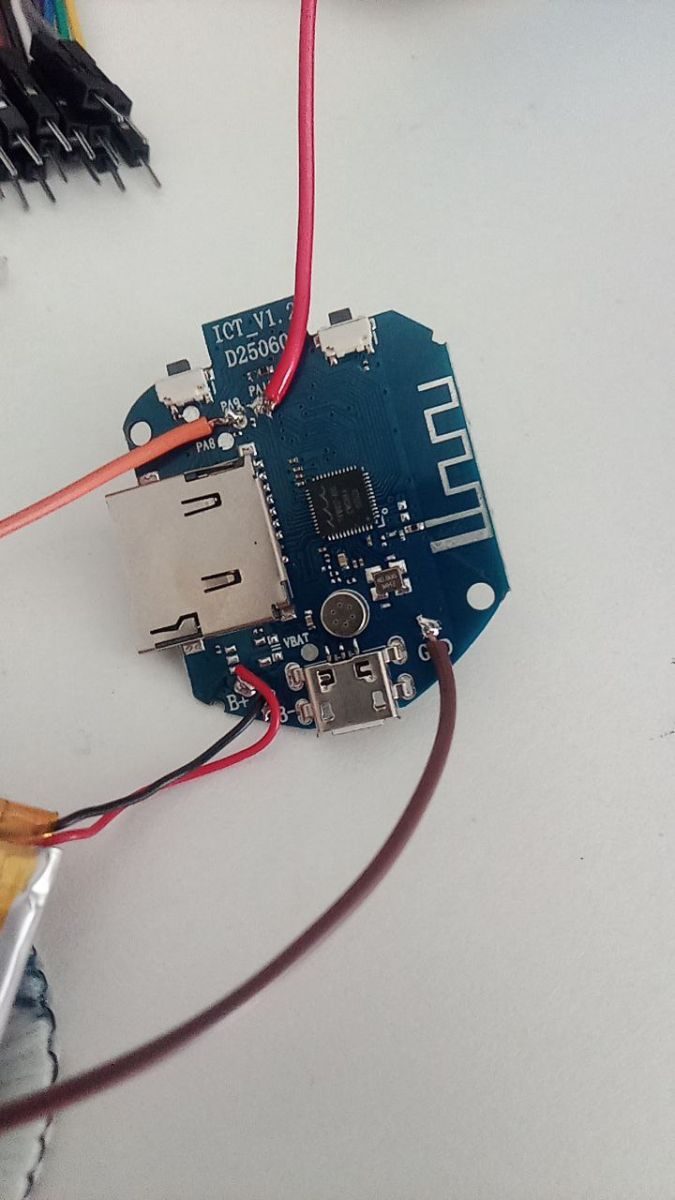

    Hi, I got all the necessary - the STM32 is flashed and now shows as CKLink-Lite in device management, but when I try to run the flash programmer I get "Error - DebugServer Start error, can't connect to target"
    Maybe is the pinout wrong? I connected (A9/STM32) GND/GND, PA9/A5 and PA10/A1; both powered through USB
  • Wrong pad labeling and shared LED pad on black PCB
    #132 21694605
    Posts: 5208
    Help: 446
    Rate: 914

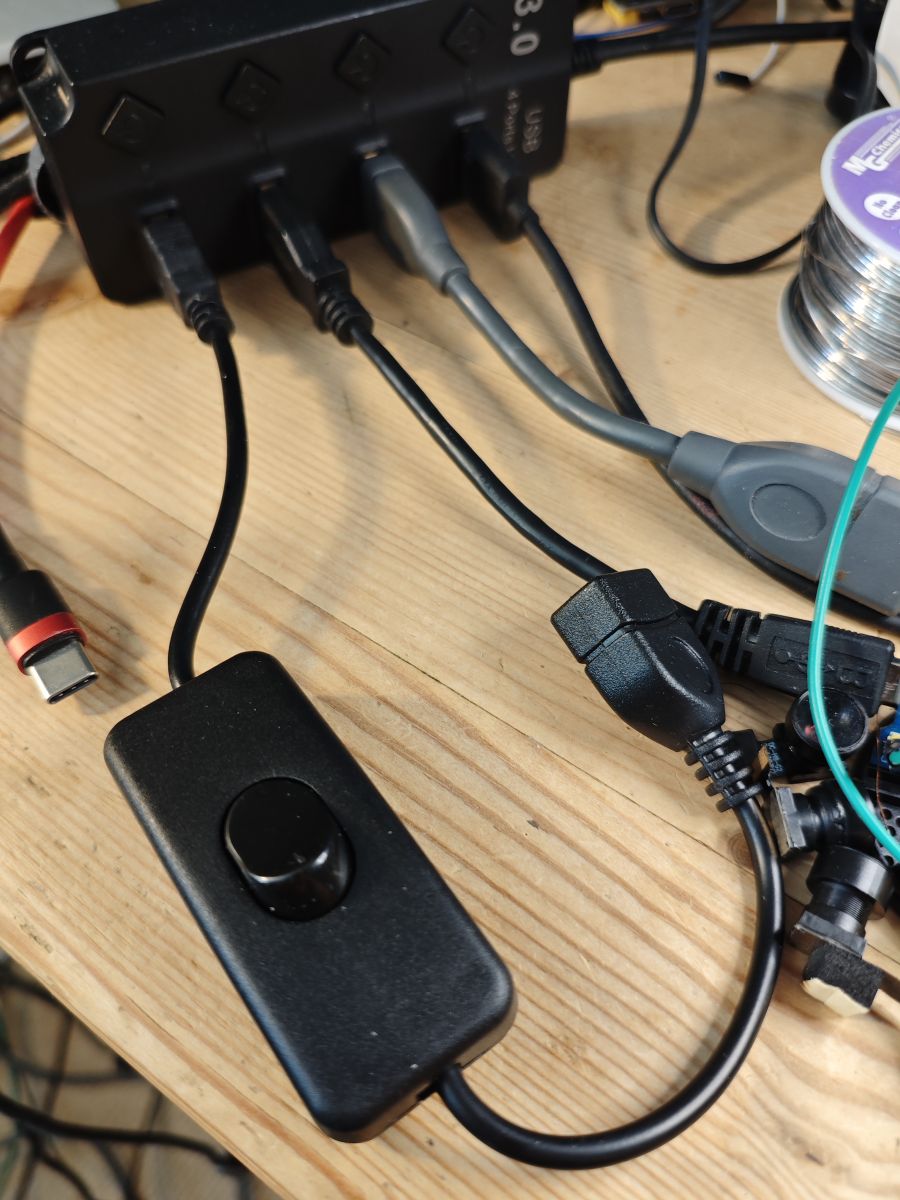

    sounds right. cables too long? could try lower ICE Clk?
    A couple of things I've had with these - pads have been labelled wrong (discovered with multi-meter from test pad to IC leg) and with the black PCB A9 above one of the pads was shared with an LED so I had a split second to catch the connection before the LED started flashing. It took a few goes and the ability to switch USB power on and off with a button was a great help.
    USB hub with multiple connected cables and a rotary switch on a wooden desk
    or something else..

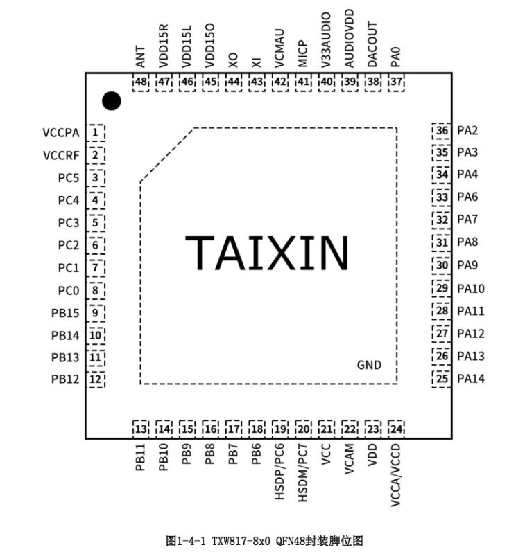

  • Identifying PA9, PA10 and GND pad connections
    #133 21694718
    d1nuc0m
    Posts: 10
    >>21694605

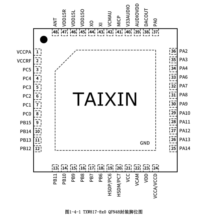

    Cables are less than 10 cm soldered to the pads (soldered badly in photo as a removed/resoldered multiple times, last time didn't turn out well); which value could I use for ICE?
    Maybe the pads are labelled wrong, on my board orange cable is PA9, red cable is PA10 and brown cable is GND - are they in the same position as yours?
    Also, if I want to check, to which IC leg should these lead?
    all my TXW817s are different to this, so not really comparable.
    • TXW817 数据手册 V1.6_20241115165936.pdf (3.75 MB) You must be logged in to download this attachment.
  • #135 21694727
    Posts: 5208
    Help: 446
    Rate: 914
    with a decent enough pic it looks like you could easily trace to which pin the pads go visually without multi-meter

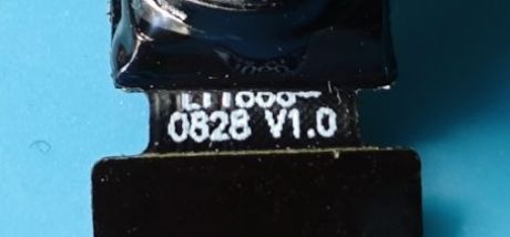

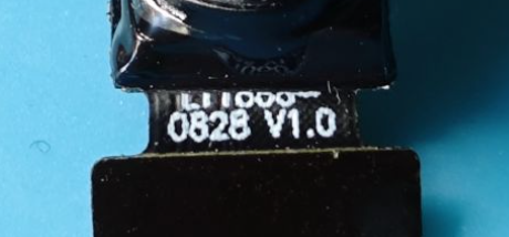

    Leds do not turn on because they need to be configured first

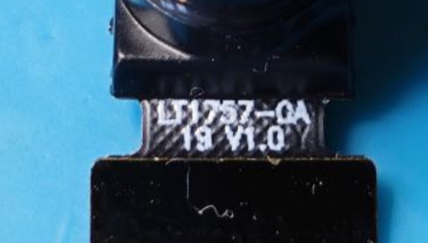

  • Checking whether the camera uses SDK default I2C pins
    #138 21694939
    Posts: 5208
    Help: 446
    Rate: 914
    d1nuc0m wrote:
    Bad news - forgot to do a backup
    :( oh well
    I just noticed you left battery soldered up too.
    I wonder if your board uses SDK default PC2/PC3 for SDA/SCL. Soon find out I guess
    Added after 13 [minutes]:
    is your cam ribbon marked like either of these? I can't quite make out half of it
    Close-up of a camera ribbon marked LT1757-QA 19 V1.0 on a blue background
    Close-up of a camera ribbon labeled “0828 V1.0” on a black surface
  • AP at 192.168.4.1 for initial camera setup

    d1nuc0m
    Posts: 10
    Just desoldered the battery, now powering the device through USB and with adapter DX on camera DM I got a serial output (just part of it):
    OpenTXW81X, version 1.18.176
    Entering initLog()...Commands registered!initLog() done!EasyFlash V4.1.0 is initialize succuser_eloop_run:312::run
    ess.
    You can get the latest version on https://github.com/armink/EasyFlash .
    I see an OpenTXW81X_9D772F14 network too and I can connect the phone to it, any suggestion on which app can I use for initial config? (Or if there is a browser interface)
    EDIT: never mind, 192.168.4.1 when connected to the WiFi
    And my camera ribbon is LT1888 / 0828 V1.0, so I guess the same as the second image

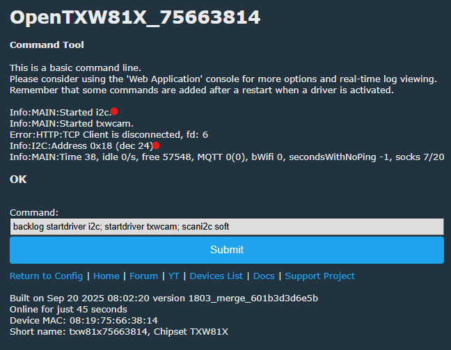

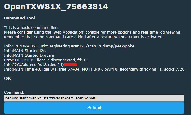

  • Use OpenBK7231T to scan default camera I2C pins
    #143 21695166
    Posts: 5208
    Help: 446
    Rate: 914
    I think I would have expected an RTSP audio stream if the mic was the default pin, even if video won't work at the moment (no driver).
    I get audio but no video often.
    Maybe a start would be to establish which pins your cam is using.
    If you flash this build: https://github.com/openshwprojects/OpenBK7231...actions/runs/17838457506/artifacts/4049109736 (log in to github first)
    then run this in custom command in web gui
    it should come back with the i2c address if your device uses these default pins
    Screenshot of OpenTXW81X interface showing command log and connection status

    Posts: 1432
    Help: 168
    Rate: 455
    >>21695166
    I2C is not enabled in this build
    So UART log is needed.
  • #145 21695195
    Posts: 5208
    Help: 446
    Rate: 914
    darn, yes
    Added after 1 [hours] 4 [minutes]:
    with i2c https://github.com/divadiow/OpenBK7231T_App/actions/runs/17877285235/artifacts/4062310290
