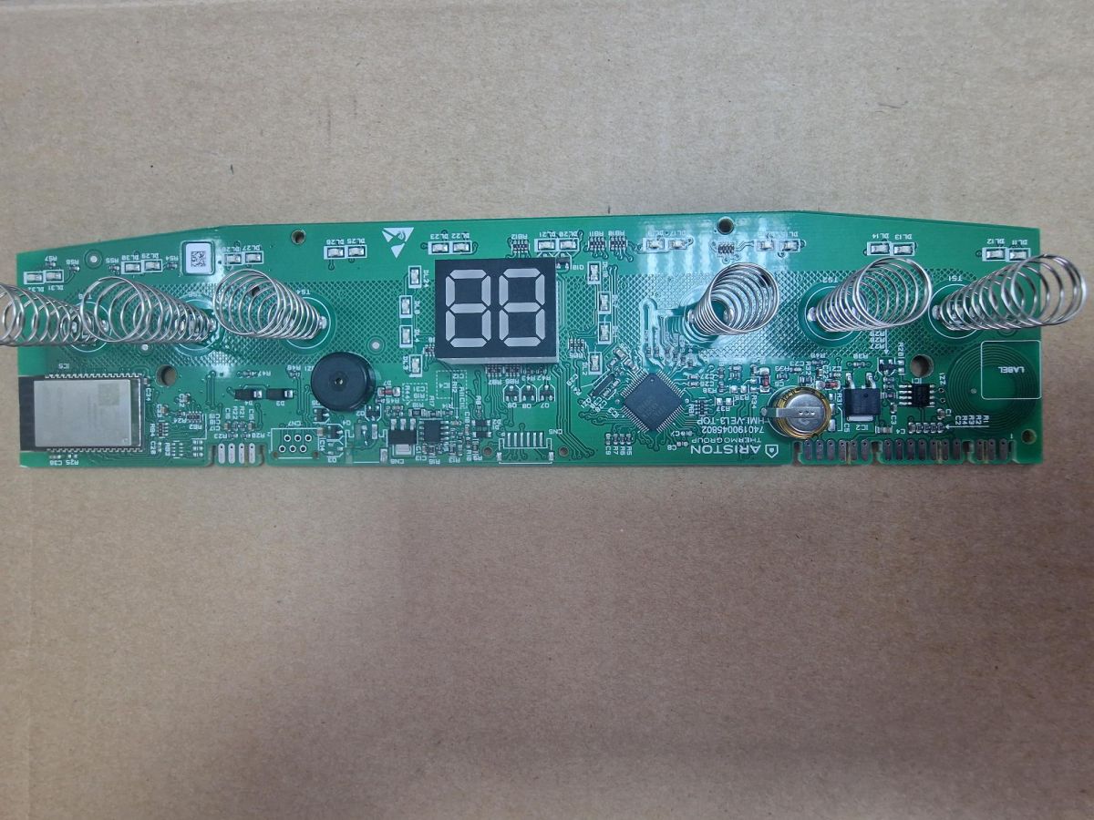

  • The Ariston Velis 80 Wi‑Fi electric water heater uses an ESP32-WATG-32D module, an extra microcontroller, and the Ariston NET app for scheduling, ECO mode, antifreeze, and anti-legionella functions.
  • Inside, the main panel contains a 7-segment display, a power supply based on LNK623DG, and FM25Q64A13 SPI flash with 64M-BIT capacity.
  • The 80 version cost €322, and the manual lists 27 kg weight, 65 litres capacity, 15 dB noise, and about 27 kWh/week in smart mode.

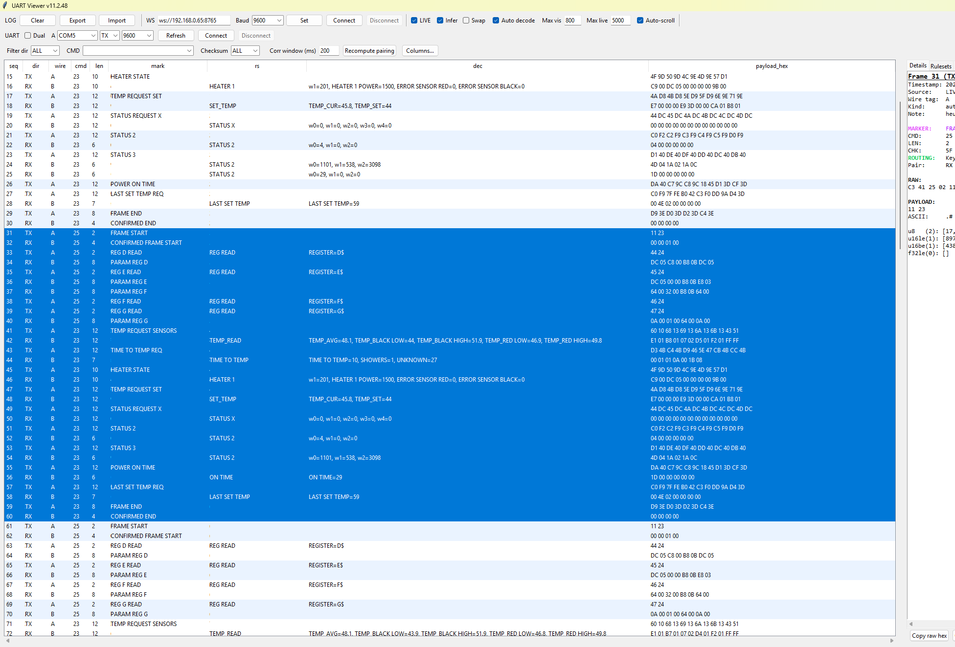

  • UART capture at 115200 baud exposed frames with a repeating C3 41 header, a length byte, and a checksum that appears to be a simple sum modulo 256.
  • Protocol decoding is unfinished, some packets needed byte-offset correction, and the next step is comparing app traffic to boiler control for custom firmware and Home Assistant integration.

    I am in a process of simulating that on a dry workbench (more convenient 😁) it is stable, and working, all the controls are up and running now so more test will follow. Right now no HA implementation (discovery) and index is still rough + log is debug heavy for testing purposes. Once the tests are done I'll post more findings and document everything for future reference.
    I think I posted this already but worth repeating
    ### CMD 0x33 — Control Write (ESP → Boiler, on demand)
    To change boiler settings, the ESP sends a CMD 0x33 with a 2-byte register ID and value:
    | Register | Value        | Description                         |
    | `05 21`  | `01` / `00`  | App/UI power state ON / OFF         |
    | `06 21`  | `01` / `00`  | Mode selector (manual/eco, TBD map) |
    | `DD 27`  | `01`         | Power ON                            |
    | `DD 27`  | `05`         | Standby                             |
    | `DD 27`  | `09`         | Boost ON                            |
    | `79 2D`  | `XX XX` (LE) | Target temperature x 10             |
    | `0A 21`  | `01` / `00`  | Anti-legionella ON/OFF              |
    | `CC 4B`  | `08`         | WiFi STA connected                  |
    | `CC 4B`  | `06`         | WiFi connecting                     |
    | `CC 4B`  | `04`         | WiFi AP mode                        |
    | `CC 4B`  | `00`         | WiFi OFF                            |
    This is just the WiFi control command set, there is a telemetry set (cmd 0x23), system init/report (cmd 0x52) and generic (0x25) command set that I am in a process of fully understanding.
    ## Byte-Level Frame Maps (working decode)
    Conventions:
    - Offsets below are payload offsets (start at payload byte 0, not frame start).
    - `u16le@N` means little-endian 16-bit value using payload bytes `[N]` and `[N+1]`.
    - `?` means not yet fully decoded/confirmed.
    ### CMD23 response maps
    1) Water tuple response (len=12), query: `60 10 68 13 69 13 6A 13 6B 13 43 51`
    - `u16le@0`  : water/avg temp candidate #1 (x10 C)
    - `u16le@2`  : water/avg temp candidate #2 (x10 C)
    - `u16le@4`  : water/avg temp candidate #3 (x10 C)
    - `u16le@6`  : water/avg temp candidate #4 (x10 C)
    - `u16le@8`  : water/avg temp candidate #5 (x10 C)
    - `u16le@10` : often `0xFFFF` sentinel
    2) Current/target response (len=12), query: `4A D8 ... 71 9E`
    - bytes `0..7`   : status/unknown block (`?`)
    - `u16le@8`      : `TEMP_CUR` (x10 C)
    - `u16le@10`     : `TEMP_SET` (x10 C)
    3) Heater response (len=10), query: `4F 9D ... 57 D1`
    - bytes `0..1`   : status word (`?`) commonly `C9 00`
    - `u16le@2`      : heater power (W), observed `0` or `1500`
    - bytes `4..7`   : error/status reserved (`?`)
    - bytes `8..9`   : status tail (`?`) commonly `9B 00`
    4) Time-to-temp/showers response (len=7), query: `D3 4B ... CC 4B`
    - byte `0`       : status/flags (`?`) usually `00`
    - byte `1`       : status/flags (`?`) often `04`/`4E`
    - byte `2`       : showers candidate
    - byte `3`       : time-to-temp candidate
    - byte `4`       : status (`?`) often `00`
    - byte `5`       : constant-like `0x1B` in many captures (`?`)
    - byte `6`       : mode/state nibble-like (`?`) often `08/06/05/00`
    5) On-time response (len=6), query: `DA 40 ... CF 3D`
    - `u16le@0`      : uptime-like counter (minutes in current interpretation)
    - bytes `2..5`   : reserved/flags (`?`) usually zeros in baseline
    - Note: this is not heater-active runtime.
    6) Status block A response (len=12), query: `44 DC ... 4D DC`
    - payload often all zeros in idle/heating runs
    - field semantics unknown (`?`)
    7) Status block B response (len=6), query: `C0 F2 ... D0 F9`
    - `u16le@0`      : small state code (often `4`)
    - `u16le@2`      : usually `0`
    - `u16le@4`      : usually `0`
    8) Status block C response (len=7), query: `C0 F9 ... D4 3D`
    - `u16le@0`      : usually `0`
    - `u16le@2`      : often `0x024E` (=590, may correlate with target 59.0 C in some runs)
    - remaining bytes : flags/status (`?`)
    9) Status block D response (len=6), query: `D1 40 ... DB 40`
    - `u16le@0`, `u16le@2`, `u16le@4` are non-zero status words (`?`)
    - seen values drift with runtime/heating; semantics pending
    10) Status block E response (len=4), query: `D9 3E D0 3D D2 3D C4 3E`
    - often all zeros in current captures
    - semantics pending
    ### CMD25 response maps
    For registers where response len=8 (`44..47 24`, `79 2D`, `7A 2D`, etc.), payload is usually 4 little-endian words:
    - `u16le@0`, `u16le@2`, `u16le@4`, `u16le@6`
    Known high-confidence examples:
    - `44 24` -> `1500, 200, 3000, 1500`
    - `45 24` -> `1500, 0,   3000, 1000`
    - `46 24` -> `100,  50,  3000, 100`
    - `47 24` -> `10,   1,   100,  10`
    `CMD25` 4-byte responses are often:
    - word-like status pairs (`u16le@0`, `u16le@2`) or
    - byte flags in `[0..3]` depending on register.
    ### CMD52 payload maps (identity/init)
    `CMD52` is used for module identity and boot/session initialization.
    Frame format reminder: `C3 41 52 [LEN] [PAYLOAD...] [CHK]`
    1) MAC announcement (`LEN=9`)
    - Example payload: `03 0F 01 78 42 1C 14 3E 18`
    - byte `0`        : group/type (`03`)
    - byte `1`        : field id (`0F`)
    - byte `2`        : sub-id/version (`01`)
    - bytes `3..8`    : MAC address bytes (`78 42 1C 14 3E 18`)
    2) Serial announcement (`LEN=15`)
    - Example payload: `03 10 01 31 37 32 35 32 32 46 4B 30 37 30 30`
    - byte `1`        : field id (`10`)
    - bytes `3..14`   : ASCII serial (e.g. `172522FK0700`)
    3) Combined/session info (`LEN=18`)
    - Example payload: `03 29 00 0E 73 19 31 37 32 35 32 32 46 4B 30 37 30 30`
    - byte `1`        : field id (`29`)
    - byte `2`        : mode/subtype (`00`)
    - bytes `3..5`    : session/config triplet (`0E 73 19`) (`?`)
    - bytes `6..17`   : ASCII serial echo (`172522FK0700`)
    4) Init request A (`LEN=3`)
    - Payload: `02 2C 00`
    - byte `0`        : init class (`02`)
    - byte `1`        : init opcode (`2C`) (`?`)
    - byte `2`        : arg/status (`00`)
    - Sent in retries during early startup.
    5) Init request B (`LEN=3`)
    - Payload: `03 21 00`
    - byte `0`        : init class (`03`)
    - byte `1`        : init opcode (`21`) (`?`)
    6) Init request C (`LEN=3`)
    - Payload: `02 0B 00`
    - byte `1`        : init opcode (`0B`) (`?`)
    7) Boiler ACK to CMD52 (`RX`, len=4)
    - Example payload: `1D FE 00 13`
    - bytes `0..3`    : ACK/status block (`?`) used as handshake success marker.

    Oh no I thought about that but the original module is super chatty - it will send something like 100+ frames a minute with this being one full frame
    Screenshot of UART Viewer showing TX/RX frame log table with hex payloads, heater state, and temperature readings

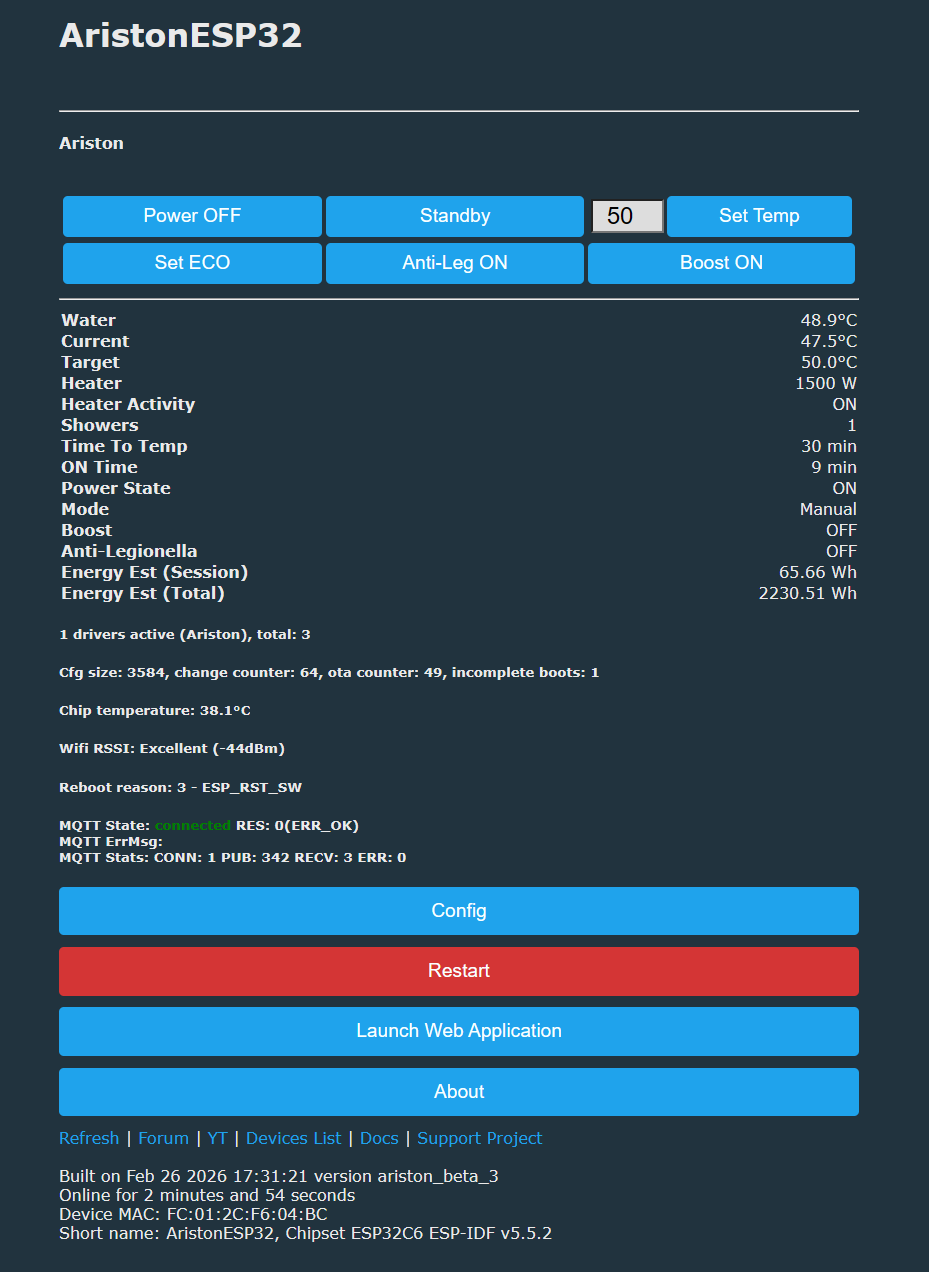

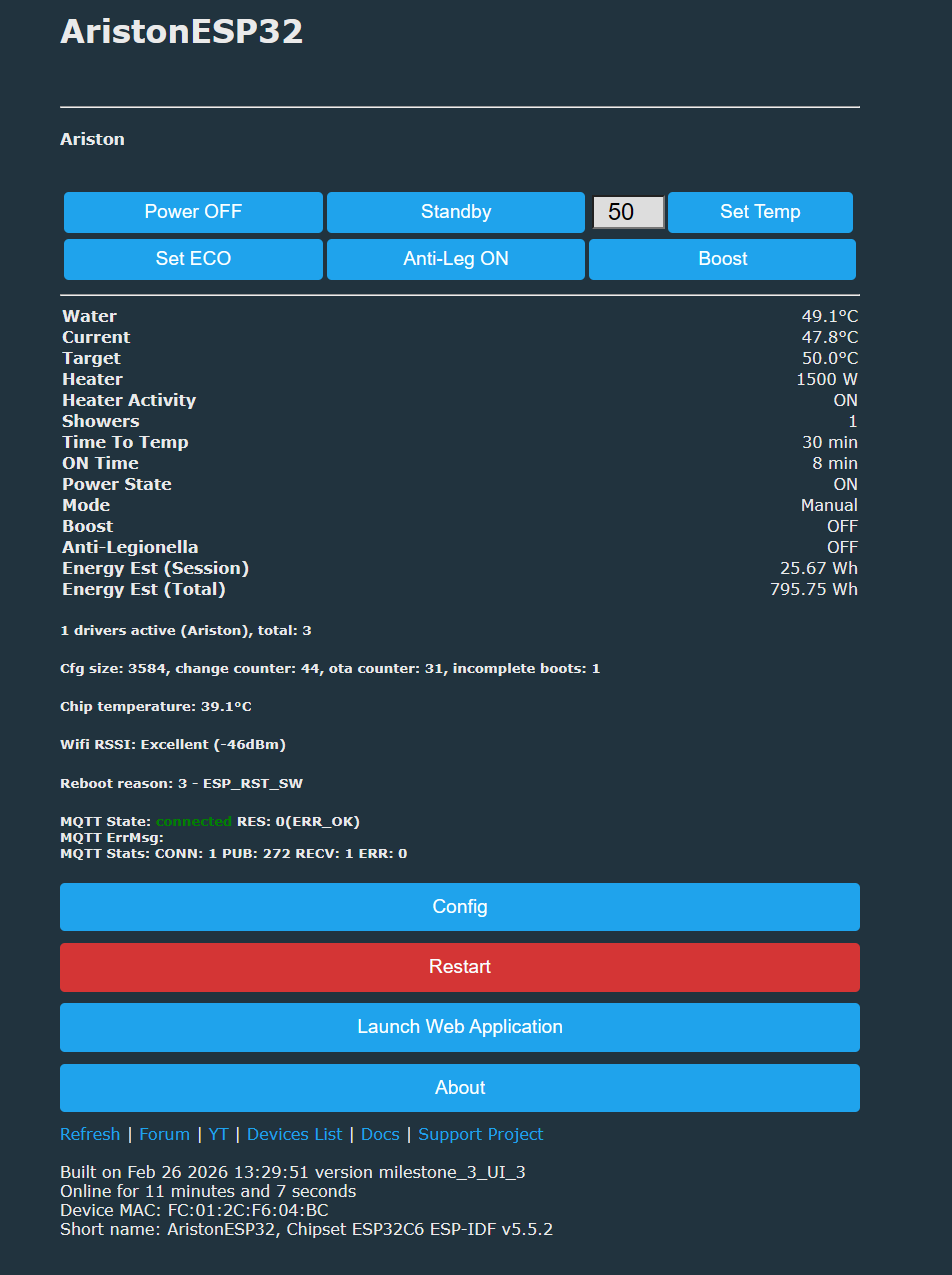

    Added after 2 [hours] 1 [minutes]:

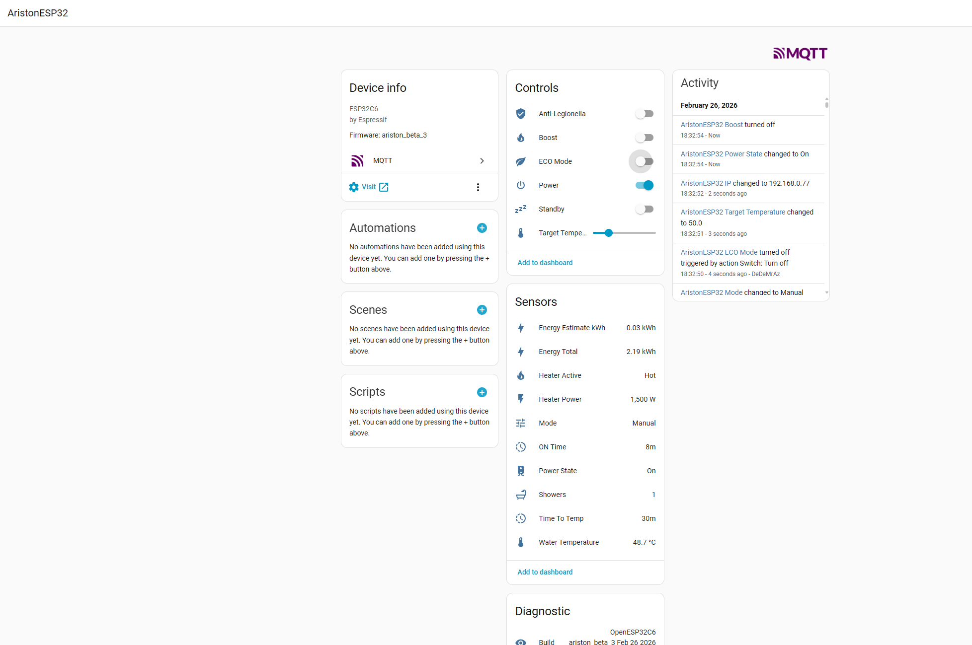

    Screenshot of AristonESP32 dashboard with control buttons and water temperature status
    HA integration next.....
    Screenshot of AristonESP32 dashboard with Controls, Sensors, and Activity panels and MQTT logo.

    Nice! Why some controls are toggles, and some are presses?
  • Driver nearly ready for long-term water heater testing
    #65 21849434
    DeDaMrAz
    Posts: 621
    Help: 34
    Rate: 130

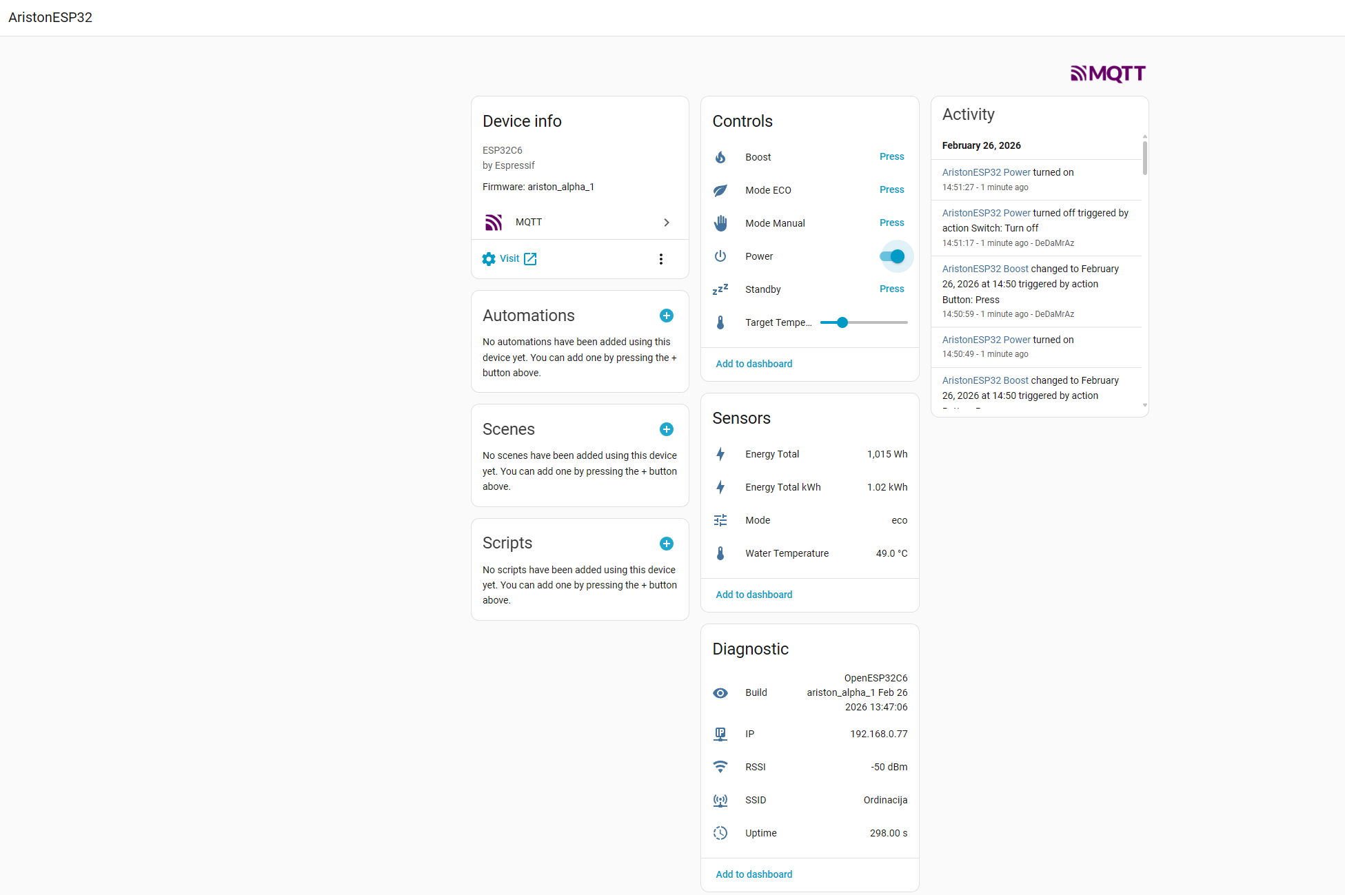

    because this 😁
    Screenshot text showing “by Espressif” and “Firmware: ariston_alpha_1”.
    Added after 2 [hours] 36 [minutes]:
    Screenshot of AristonESP32 dashboard with controls, sensor readings, and MQTT activity log
    Screenshot of the AristonESP32 dashboard with control buttons and status readings for temperature and connectivity
    That is it for now..... driver needs polishing and some tweaks but it is finally ready to be put in operation and get some water in it and test long term before verifying driver and publishing it.
    I have to trace back the changes I made and get some data back from the real world test and I'll push this into a clean PR.

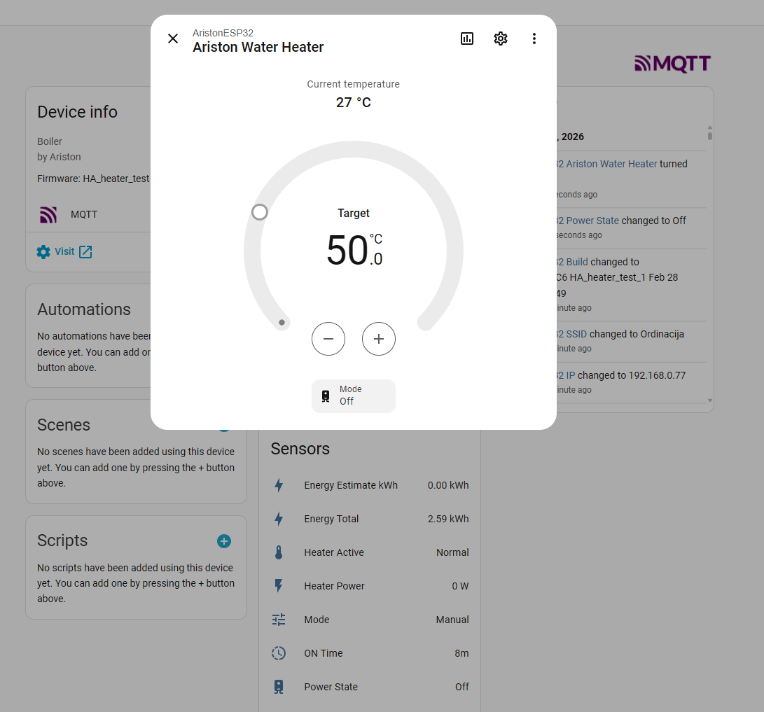

    Ariston Water Heater control pop-up showing 27°C current temperature and 50°C target with +/- buttons
    It is working on the workbench, still waiting for DOWD chips to appear to replace the one in the original module and pack it up.
    Driver is in the alpha stage still and will require some real life testing time before I can push it into a PR.

    did you solve ESP32 flash protection?
    No, I decided to skip that part as e-fuses are all burned and I figured it was too much work to replace the chip. So I opted out to replace the module entirely.
    Also since we didn't have UART exposed on ESP32 I changed the default routing in the SDK for convenience (pins are closer together) in the PR.

    How did you get module for replacement?
