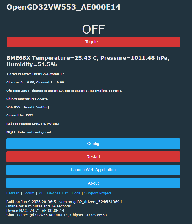

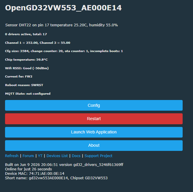

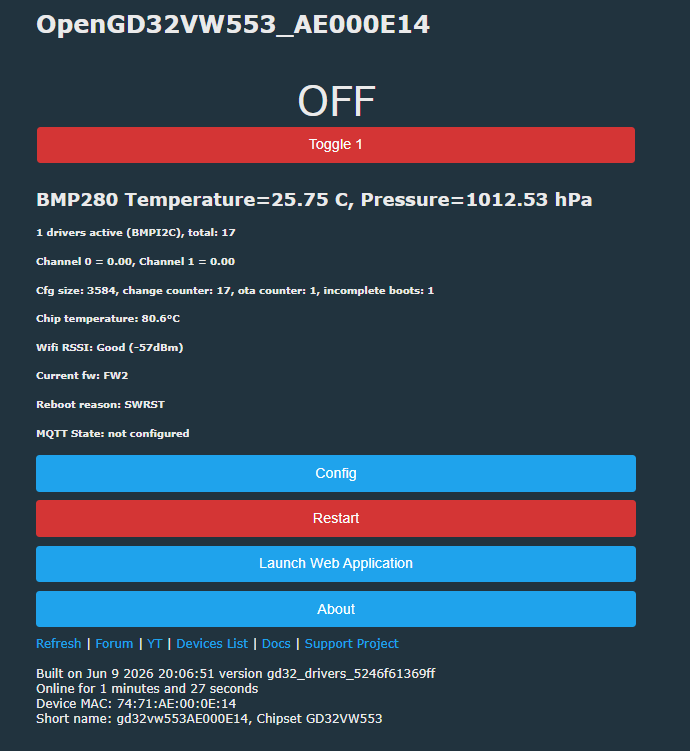

    Actually those sensors does not use main I2C hardware driver. They are using bit-bang I2C, which should work on any platform.
    The only ones that may be problematic are ENABLE_DRIVER_DS1820, because it requires precise timing, and ENABLE_DRIVER_DHT, for the same reason, altough I think DHT is more tolerant to timing errors.

    hmm ok. I didn't go to the ends of the earth troubleshooting but with BME680 I was getting an ID OK with SoftI2C but
    startdriver bmpi2c x x x x x
    just didn't seem to want to detect anything.
    more tests required

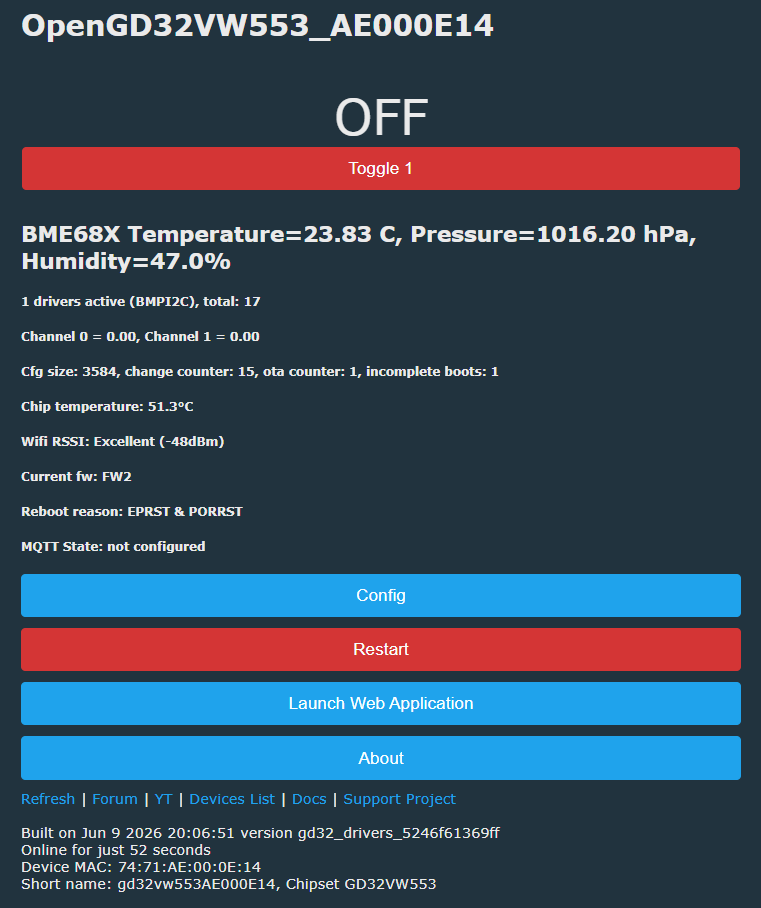

    Screenshot of OpenGD32VW553 status page showing OFF toggle and BME68X sensor readings.
    reboot and BME goes weird tho
    Screenshot readout: temperature 200.93°C, pressure 1961.23 hPa, humidity 0.0%.
    Screen strip showing BME68X readings: 34.41°C, 564.36 hPa, and 100.0% humidity

    Why would it break? There is nothing persistent between reboots.... or at least nothing that I expect could affect the sensor.
    Pin mode bug?
  • #36 21919554
    Posts: 5195
    Help: 446
    Rate: 913
    meh. maybe it's fine
