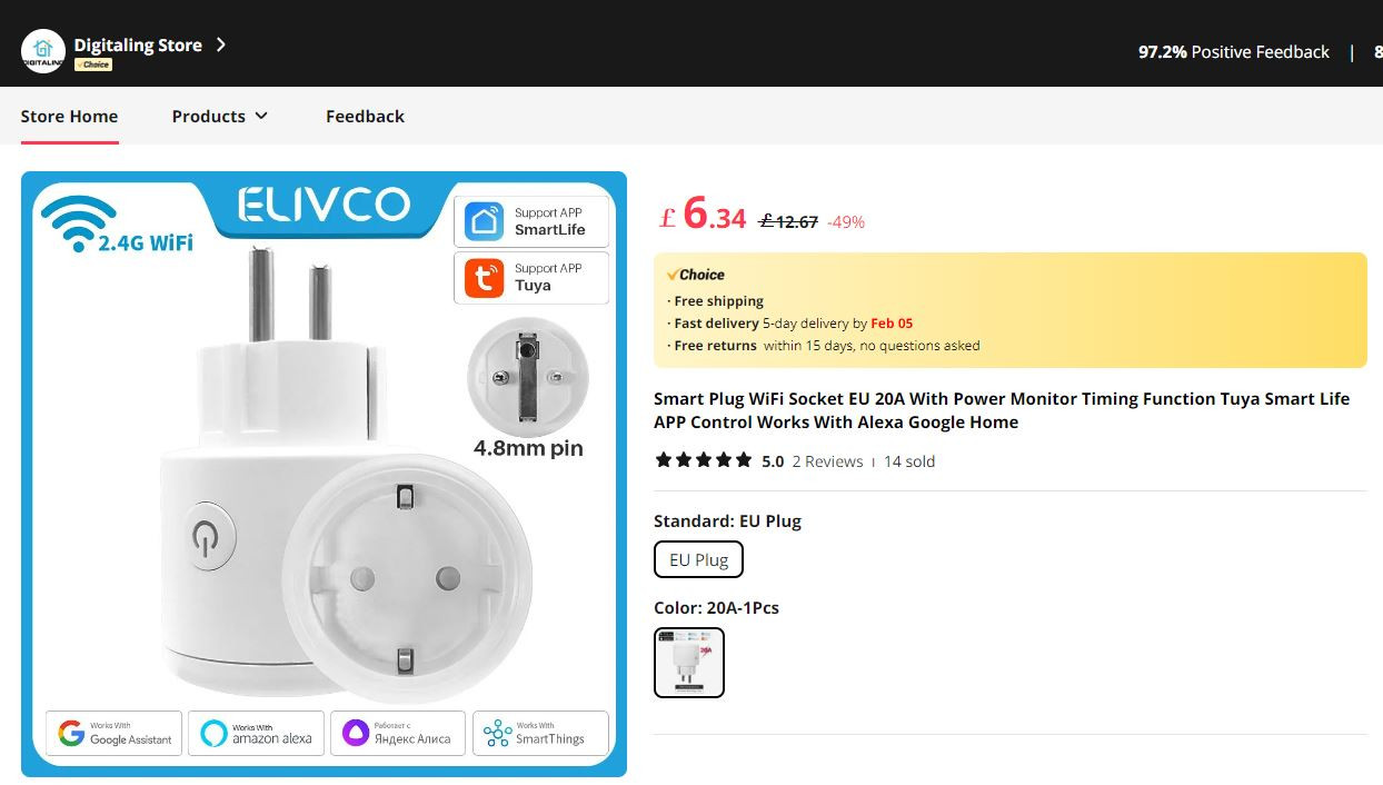

As with most of my toys, this was purchased from Ali Express, specifically from the Digitaling store.
Screenshot from an online store showing the Elivco EU 20A smart plug with power monitoring capability.
I live in the UK, so have no immediate use for an EU plug, but I was intrigued to get my own WL2S to open and flash with OpenBK.
