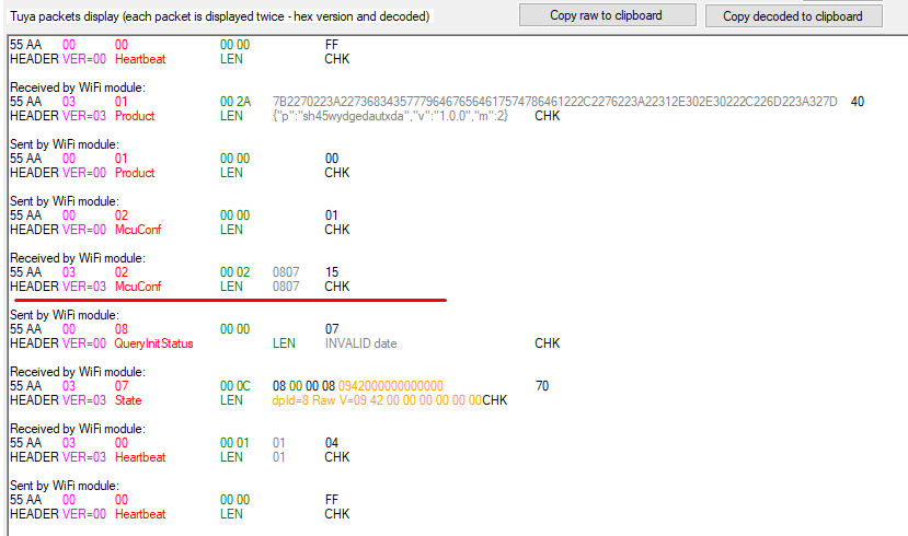

Initial communication capture
At first I've decided to use my TuyaMCU analyzer to take a basic communication capture between MCU and the WiFi module:
Screenshot of communication analysis between WiFi module and MCU.
The first interesting thing here is that the WiFi state packet is not sent at all! This is because this device is using something called Processing by the Wi-Fi module, as indicated by the presence of payload of 0x02 packet (MCUConf).
Processing by the Wi-Fi module - the GPIO pins of the Wi-Fi module change status of the Wi-Fi indicator (LED indicator). The Wi-Fi module is reset based on the GPIO inputs.
In processing by the Wi-Fi module mode, the Wi-Fi module triggers a reset when it detects that the GPIO input is at a low level for more than 5s. GPIO pins used by the Wi-Fi indicator and Wi-Fi reset button are configured by using command word 0x02.
The command payload is 0807, which means that P08 is a WiFi LED and also WiFi state output for the MCU, and 07 is the pairing button...
Note: if the 0x02 packet (MCUConf) has no payload, then processing is done by the MCU, and everything works out of the box, no extra pins are required.

Everything was failing so far, until I decided to try setting the WiFi LED pin...
Simple solution to the problem
It turned out that the already mentioned P08 is not just used for WiFi LED - it has a LED connected, but it also enables sending of more dpIDs. I've tested it with GPIODoctor:
Screenshot of a settings interface for outputs P7 and P8 on a TuyaMCU device.
This means that MCU is physically to connected to this pin as well and it's reading this pin state...
So once I've set it's state to AlwaysHigh (or AlwaysLow, depending on the device):
Now, it looks like we have a full set of data! That's what we needed for the futher processing.

Very good question! As you can see on the mentioned capture, there is no WiFi state packet at all in WiFi-processing exchange: https://obrazki.elektroda.pl/7508915600_1732736910_bigthumb.jpg Please... [Read more]

So it seems that there are at least 3 methods used by TuyaMCU (non-battery powered version) to check for correct connectivity: - WiFi state packet (0x04 means connected to cloud and paired) - GPIO output... [Read more]
