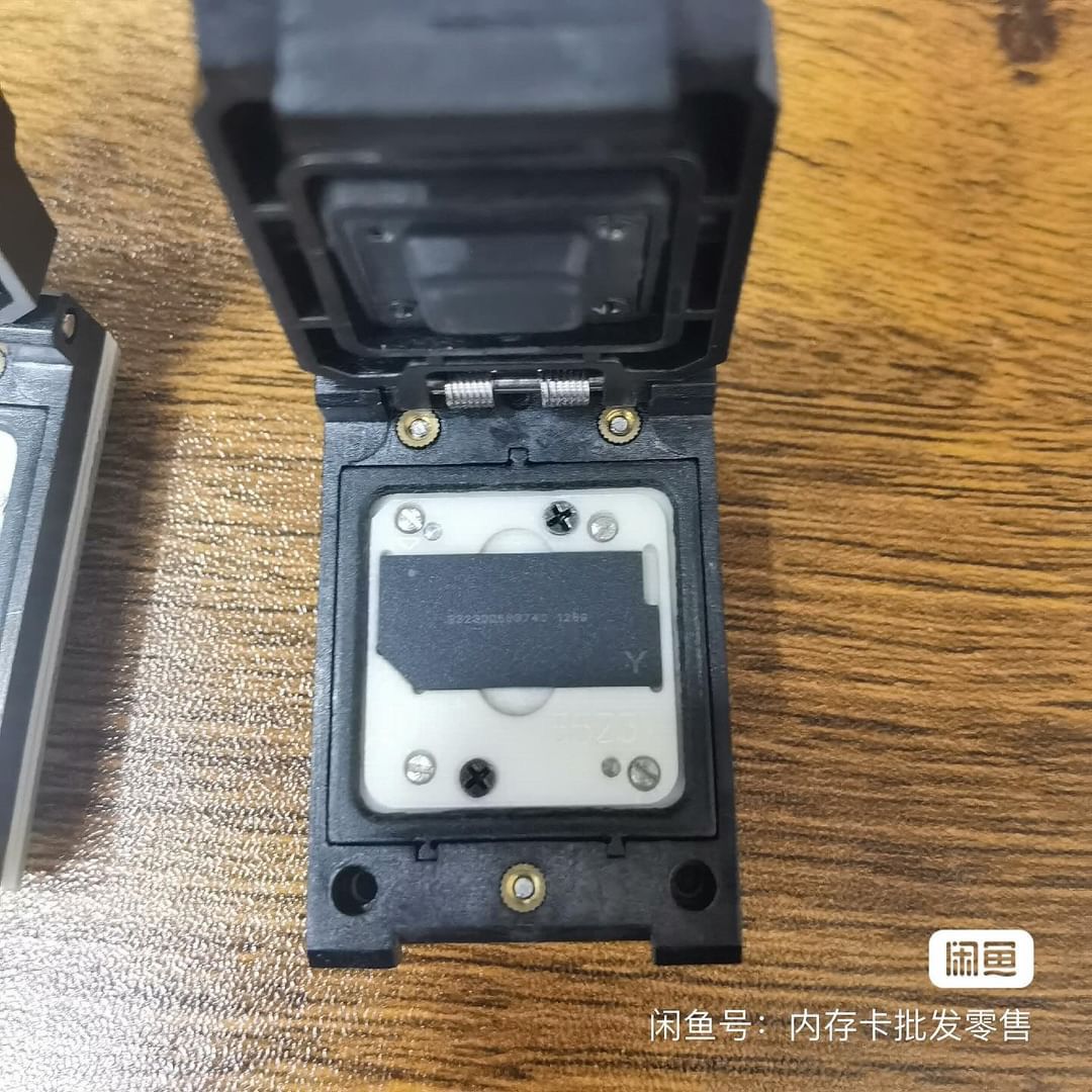

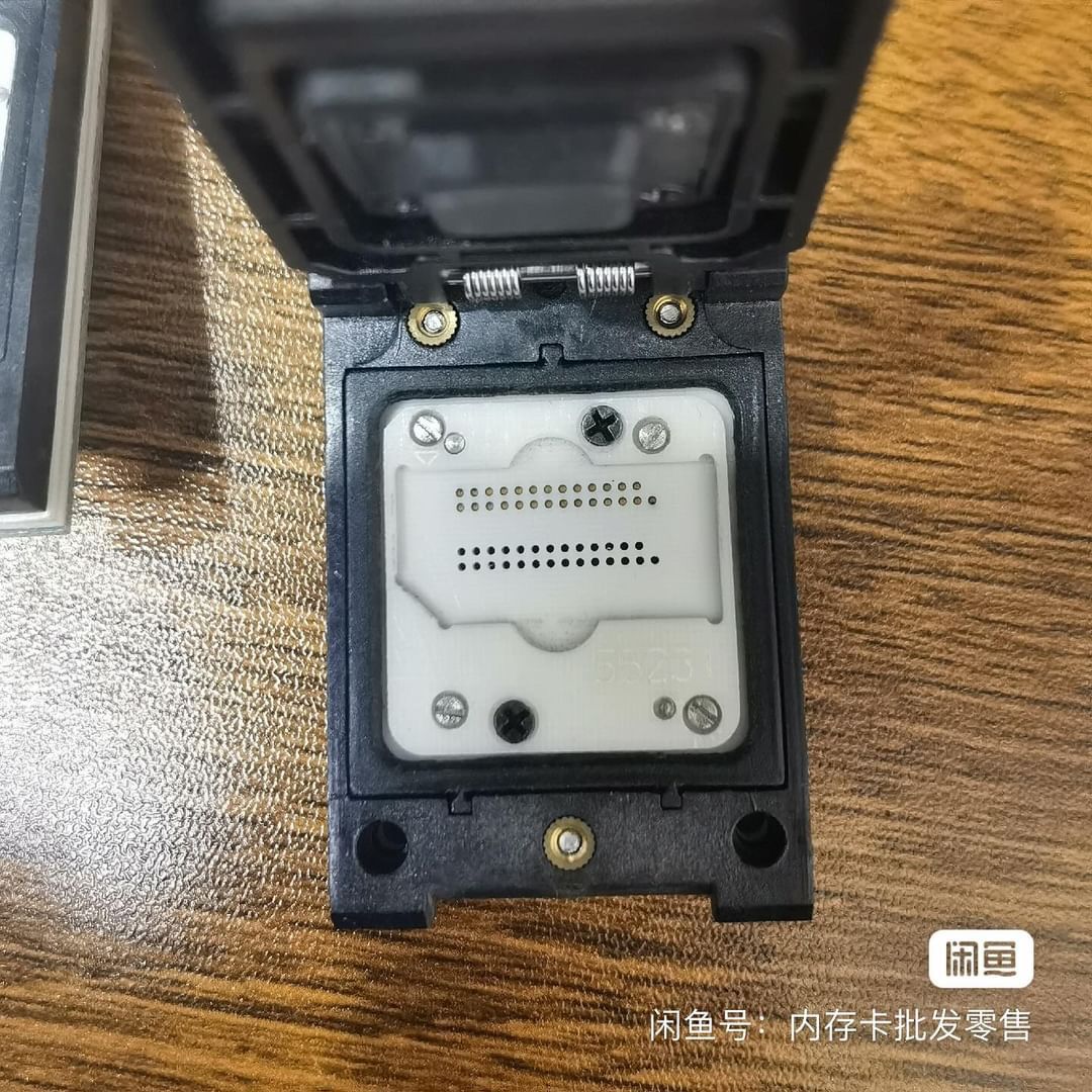

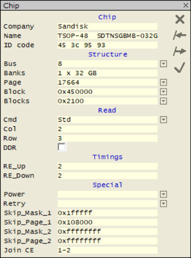

  • #498 21190391
    hanaloginstruments
    @funak Can i use NANDLite to read from Sandisk SD like Flash Extractor?
    Screenshot of a window displaying information about a Sandisk chip.
  • #499 21190538
    funak
    Posts: 1082
    Help: 101
    Rate: 461
    Technically it can be read, but it will be a RAW reading together with correction data.
    We have already made such an attempt to send the read-out data by file to the data recovery lab and there it was successfully read out.

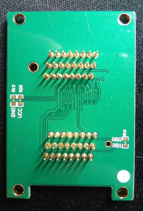

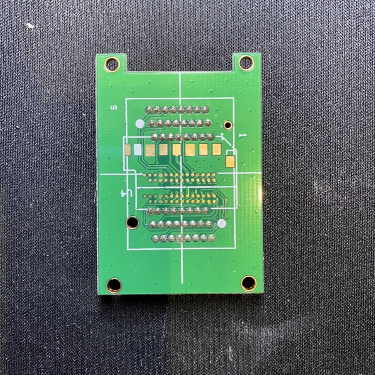

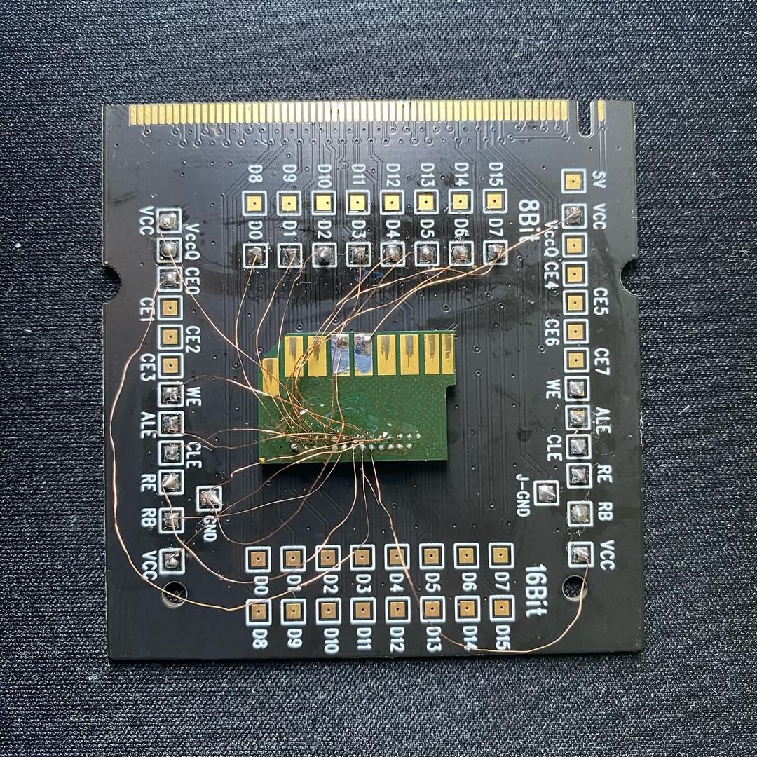

  • #500 21190605
    hanaloginstruments
    Yes i have flash extractor and vnr for recovery, i wanna try read nand by other reader, from that config can you give the parameter in pages and blocks and lun of nandlite software?
    My idea is made a socket for tsop48 pinout:
    TSOP48 socket for reading NAND memory. Adapter for reading NAND with TSOP48 chip. Circuit board with a microchip and soldered wires on a black background.
    Green printed circuit board with connection layout for TSOP48 socket. PCB with pins for TSOP48 socket.
