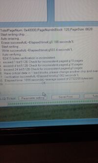

    It is the first success!
    Thanks to the courtesy of the service technician who performed a series of tests of the latest software in version 1.0b1014.84 for me, it was possible to run the first TV on a different memory using the NANDLite software.
    He programmed the K9GAG08U0E memory with the previously modified batch by NANDLite. After soldering, the TV came to life, it only required a Smart reset to get everything back to normal.
    A batch read from another programmed K9GAG08U0E memory purchased on Allegro was used as a donor - interestingly, it contained only one BBT table.
    After reviewing the LOGs that come to me, I conclude that a few more minor modifications will need to be made. Especially when the batch - the donor has two BBT tables.
    So I invite you to continue testing and reporting problems to me, and I will make changes to the algorithm based on the information provided.

    Language switching will be done soon. I just need to modify the entire application and replace each text with the appropriate entry from the string list, it will take a while.
    Yes, BB (Bad Block) are marked appropriately in the BBT table.
    After deleting the target memory K9GAG08U0E, a new list of damaged blocks is created and entered in the appropriate place during the batch processing stage.
    Importantly, a NEW table is created, and the existing damaged blocks are returned to their place.
    However, not all variants of BBT tables are programmed yet. This is due to the constant small amount of various batches in order to be able to deduce what is going on with them.

    When deleting the K9GAG08U0E memory, please pay attention to the specific numbers of damaged blocks.
    Block 2073 in each memory is corrupted, and this block should not be worried about.
    And if at least one block in the range 2044-2046 is damaged, then the algorithm Prepare file D5500 currently it does not cope with bypassing bad blocks, so it does not make sense to write this memory.
    And in the case of write verification, type verification errors appear Count bit 1 mean that the memory is properly written and verified. The number of erroneous bits for this memory can be up to 24 and you will still be fine due to the additional correction bits that are located in the SpareArea area of each memory page.

    Flash NAND Lite Memory Programmer! TSOP48
    The photo shows that 62,415 bytes do not match the file.
    Don't trust RT809H 100% for NAND memory,
    if you have incompatible bytes, i.e. you have bad sectors, although RT809H shows that there are no such sectors, they are, I had a beautiful bone according to RT809H, after programming XXXX bytes mismatch, and bad sectors are missing, surprisingly TL86 showed 11 bad sectors of this system but I don't think he's the best either.
