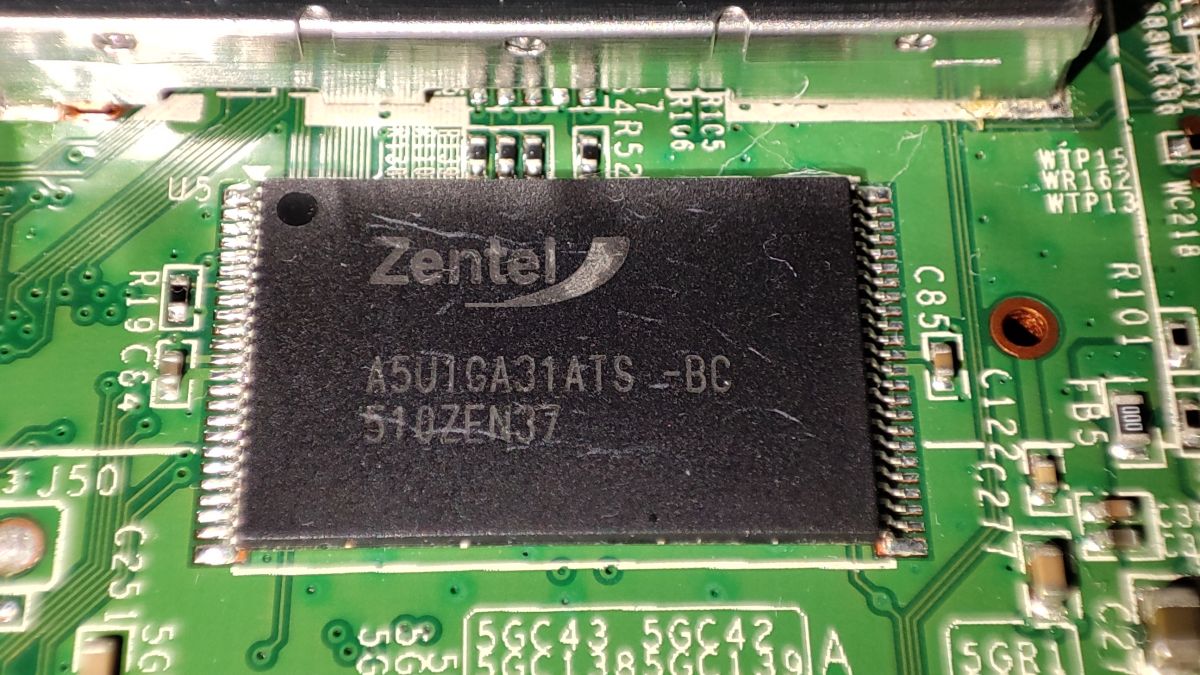

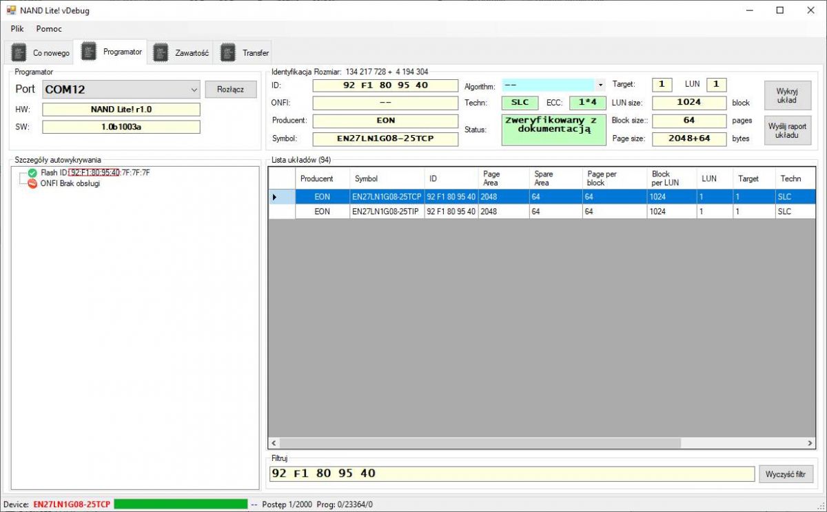

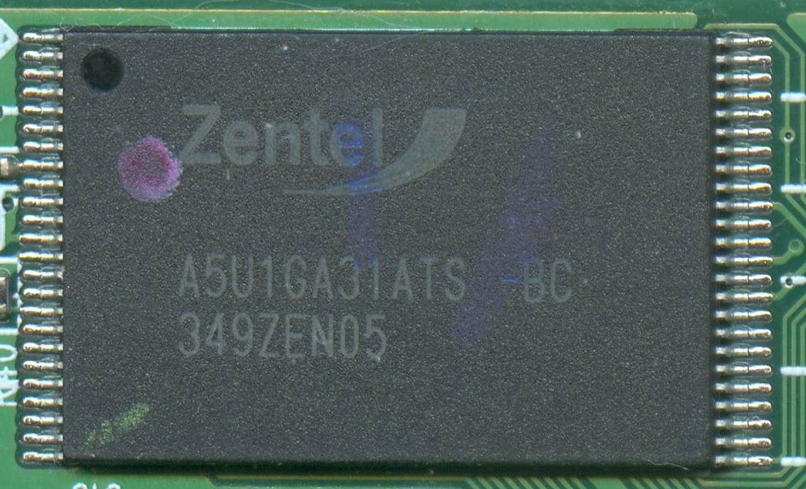

    On what settings can I read the ZENTEL A5U1GA31ATS-BC memory
    Flash NAND Lite Memory Programmer! TSOP48
    Spoiler:
    NAND: Special Nand id table Version 1.35
    Nand ID: 0x92 0xF1 0x80 0x95 0x40 0x7F 0x7F 0x7F
    Nand (Hardware): Block: 128KB Page: 2KB Chip: 128MB * 1 OOB: 64B ECC: 1bit / 512Byte
    128 MiB
    Similar ID has the EON chip, if I choose this memory, I will read this ZENTEL correctly? Do I have to change anything?
    • A5U1GA341ATS(BF)_v1.4_Zentel.pdf (1.27 MB) You must be logged in to download this attachment.

    funak
    Posts: 1074
    Help: 98
    Rate: 455
    Board Language: polish
    Yes, these will be good settings.

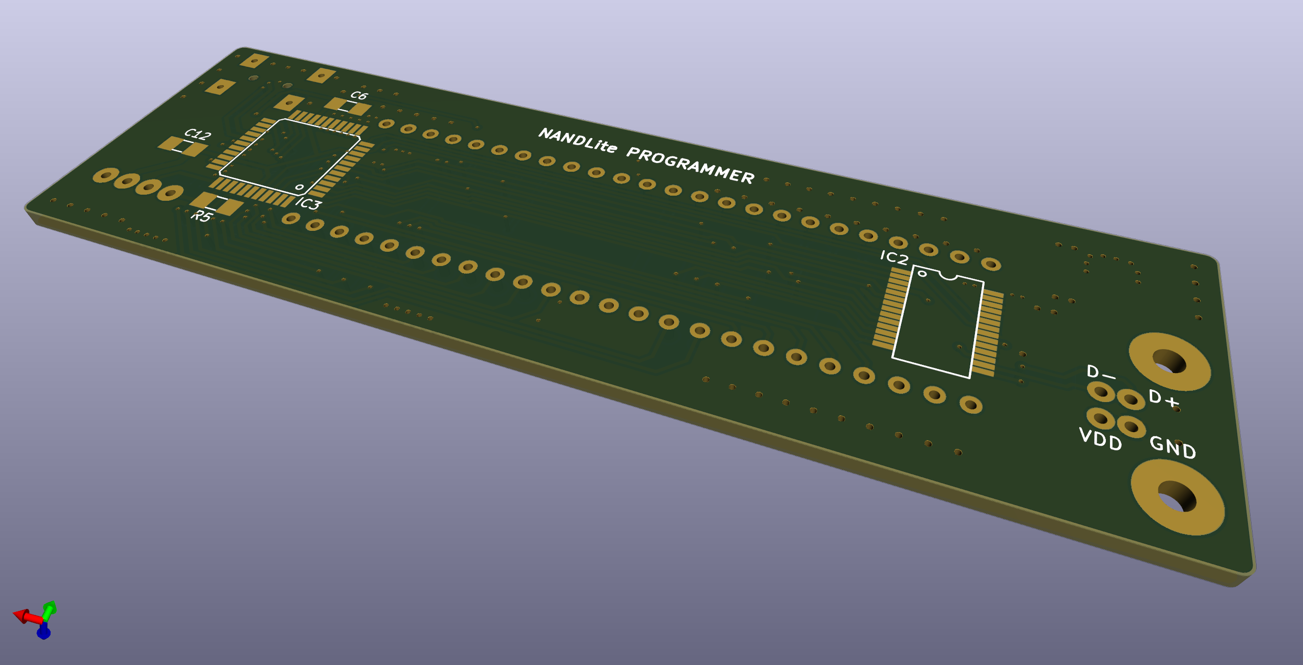

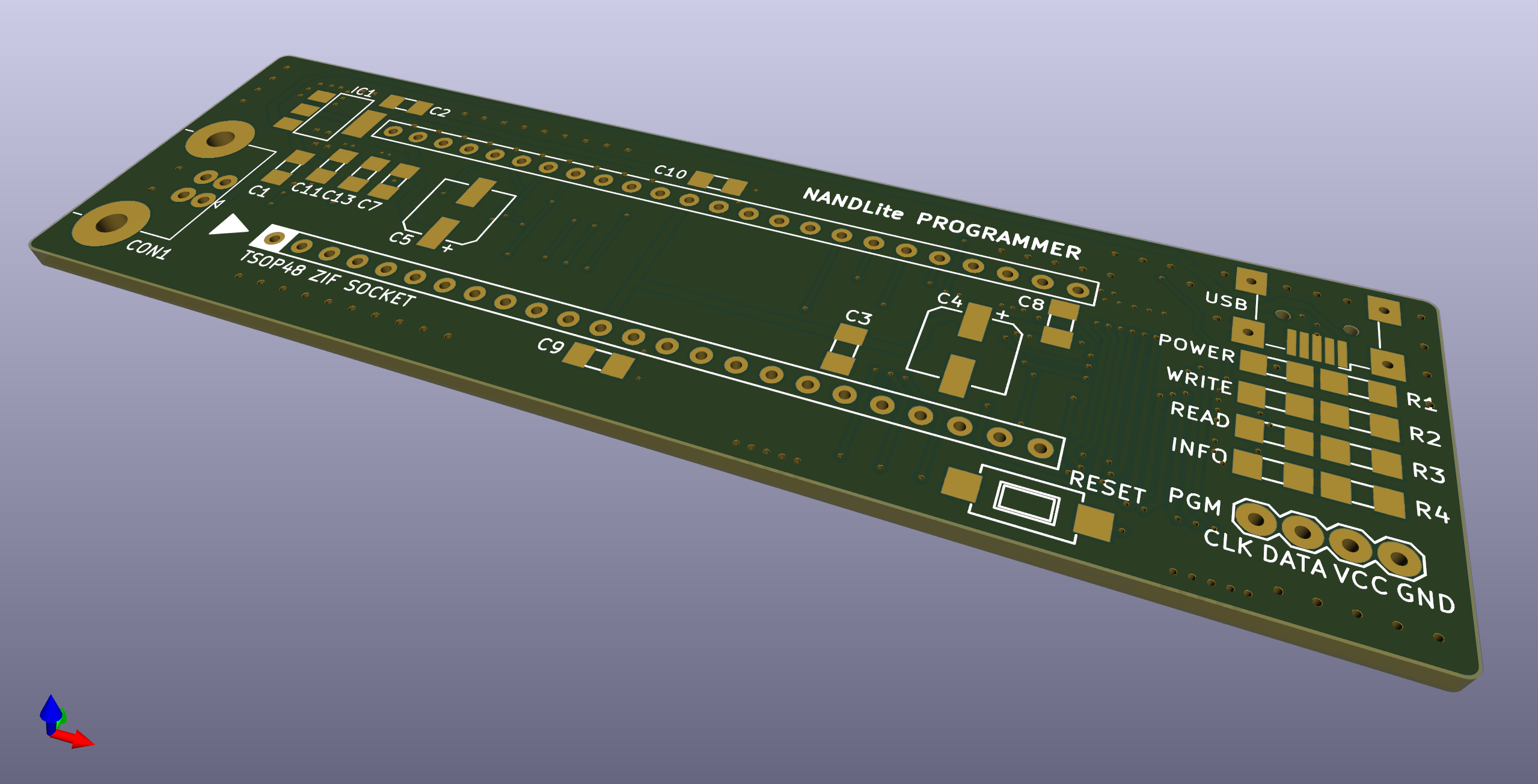

  • #445 20183549
    x.name
    Dear funak,
    as the chip ATxmega128A4 is practically unavailable worldwide, and I guess the design is not using USB of ATxmega directly, is there any possibility to get source files for compile code for another type of processor (i.e. ATmega1284P, ...), please?
    I designed PCB (see 3D model below) for NANDLite. For this PCB design, I am using this type of adapter for TSOP48 package:
    https://www.aliexpress.com/item/32950085237.html?spm=a2g0o.order_list.0.0.46341802zoM3kI
    In case of your approval / interest (and thank you very much for this programmer, as well as advices), I can post gerber files here, but they are still not tested, as the processor is impossible to get at the moment.
    Thank you very much for response.
    Kind regards, XN

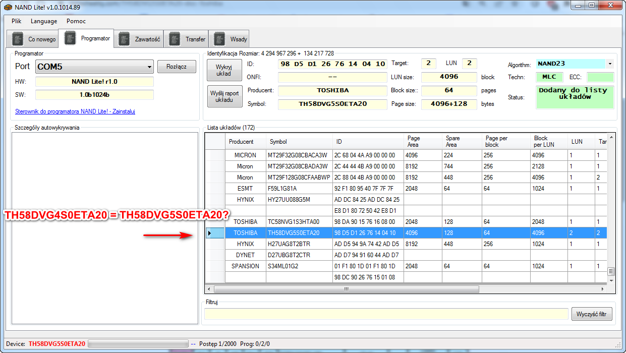

    Dock37
    Hello those who know please tell me can I flash TH58DVG4S0ETA20 memory with NAND_FLASH_lite programmer? It's just not on the support list, but it's very close to the TH58DVG5S0ETA20. Thank you in advance. Flash NAND Lite Memory Programmer! TSOP48
  • #448 20412049
