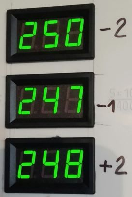

    Temporary overvoltage to the worst phase will also do something, and then other combinations.
    In the worst phase (248-250V) I plugged in all washing machines, dishwashers and everything was hot and there was some effect.

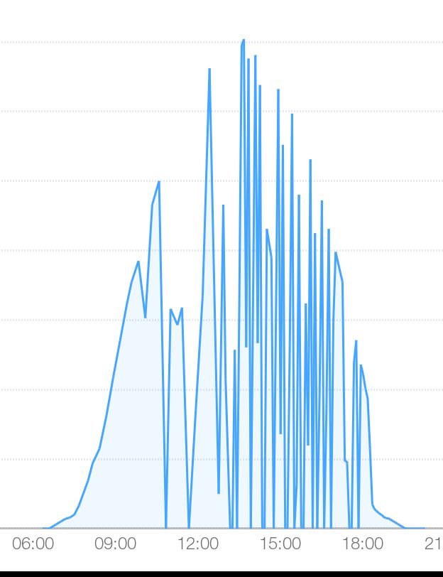

    If you ask, I will answer from the autopsy.
    After exceeding 253 by 1V, the inverter works, but already 254 or 255 causes switching off after a while (about 10 seconds),
    but not for 3 seconds, but for more than a minute, because it stops first, then it tries 60 seconds and how it is OK with the voltage
    it also starts in about a minute, i.e. this is how long it takes for him to reach the maximum (at a given moment) power.
    Growth is slow, no spikes.
    It is easy to calculate what losses it gives, because when it is chewed with voltage, it "works" for about 10% of the possibilities, and the effect it gives can be seen below.
    We are talking about version 8.8KTL-X, version SF4ES008, with soft 2.2 set to code 12, i.e. Poland.

    Ok, this explains a bit why mine with the momentary peak at 255 did not cut off. Before and after the jump, the voltages were below 250, and the inverter is asking every 30s.

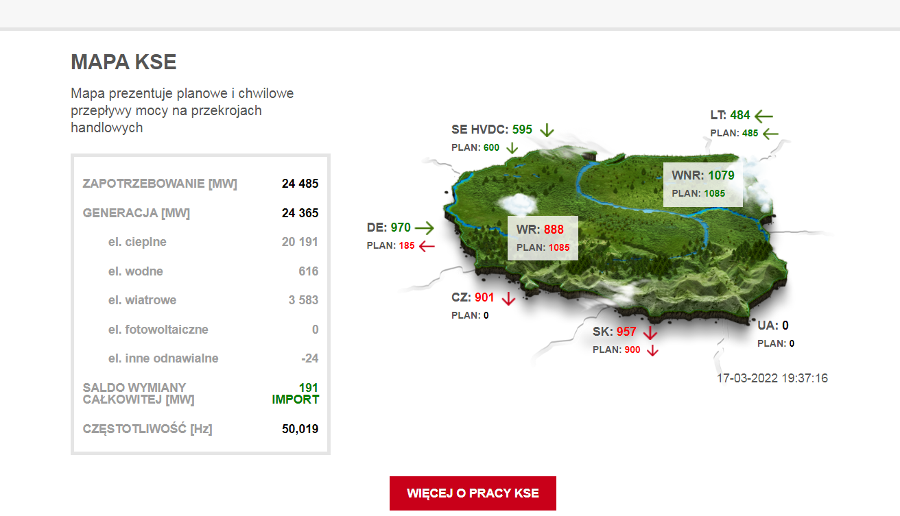

    Krzychooo wrote:
    However, as long as we do not go into sophistry, I will insist that (if the buffer allows it) it is always better to heat / accumulate and give work to the (own) equipment,
    As long as you do not forget to turn it off when the light is gone :) I am writing this in the context of what pse shows
    SOFAR 8kW PV Installation: Opinions, Durability, Failures & Experiences with Inverters
    and it shows on renewable -24MW !!!
