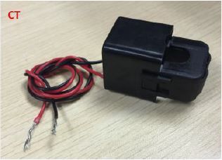

    Hello everyone, I just bought a 3300tl-g3 sofar without CT clamps, which allows me not to pour the surplus into the network until I legalize the installation. I saw that they are ten times cheaper on Aliexpress than the dealer sells them. Does anyone know its specs to know which from Aliexpress is Sofar compatible? Thank you in advance
    SOFAR 8kW PV Installation: Opinions, Durability, Failures & Experiences with Inverters
  • #220 18851356
    Coll22
    In the end it was easier than expected, I emailed sofar support and they sent me the CT specs with no problem. Please find attached pdf specifications.
