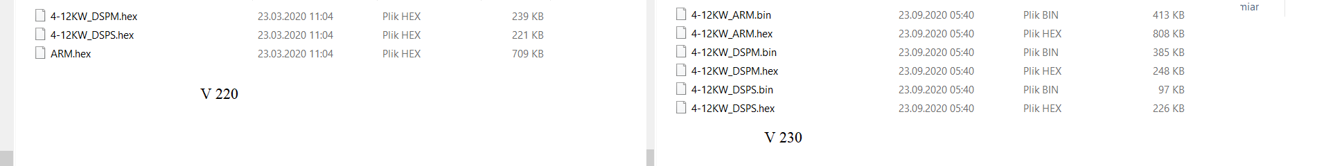

  • #845 19486338
    ja_pizgam
    Posts: 100
    Rate: 7
    I checked 4-12KW_GD_ARM.bin without this file, even the DSP triggered an error and after restart the inverter lost all data and the message "communication error" is displayed. Would you be so kind as to drop this version 2.30 or 2.20 if no one has a newer one?
  • #846 19486363
    3301
    Posts: 2100
    Help: 224
    Rate: 868
    I'm tossing it again.
    • ARM.hex (708.69 KB) You must be logged in to download this attachment.
    • 4-12KW_DSPS.hex (220.21 KB) You must be logged in to download this attachment.
    • 4-12KW_DSPM.hex (238.68 KB) You must be logged in to download this attachment.

    Unfortunately the problem with the update is the same, DSP1 and 2 updated to 2.20 and ARM crashed the same bug and still shows as version 2.50 so the inverter still doesn't work, but thanks a lot for the files.
  • #848 19486400
    3301
    Posts: 2100
    Help: 224
    Rate: 868
    What I threw up has already been used 3 times and without problems, so probably something more serious either with the card or in the inverter, or maybe when you updated earlier, there was no interruption with DC power?

  • #855 19488291
    ja_pizgam
    Posts: 100
    Rate: 7
    As it turned out the problem was the file name, I changed it like amigo71 wrote and the inverter updated without any problem.
