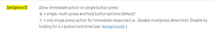

  • #40 20279466
    Posts: 14607
    Help: 654
    Rate: 12622
    I still use SetOption13 1 on my switches - this turns on the immediate response to touch of the touch button (rather than after 'unclicking').
    SetOption13 - Allow immediate action on single button press

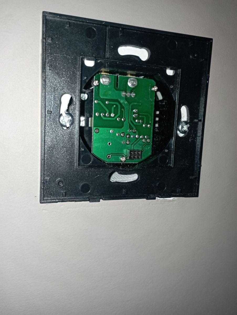

  • #43 20546123
    powalar200
    Good afternoon, I am a complete layman in electrics I have searched the forums and found nothing.
    I have purchased the exact switch given in the description and tried to connect to the remote, however the switch does not respond to anything. It does not make a "sound". Connected by an electrician who knows his stuff. Does anyone have an idea what could be the reason why the switch does not respond to anything else and does not give any sign for pairing ?
    The touch generally works but I can't connect to the remote ?
  • #44 20546150
    Posts: 14607
    Help: 654
    Rate: 12622
    A long press of the touch does not result in a loud "beep" sound?
    Maybe there is a version without a buzzer. Try pairing "in the dark", press the button longer and then press the button on the remote control. Then check that the remote control works.
    If the control still doesn't work, it's possible that you got the version with WiFi only, without RF433 support. This happened to me once before. I got something different from what I bought. Someone who knows could take the front end off (before networking) and show pictures of the PCB here.
    Also worth checking if there is a battery in the RF433 remote. But in general the first "beep" of pairing should be after a long press of the touch anyway.

    powalar200
    Yes, I have the instructions from the box. Myself and girlfriend have tried pairing with the remote and wifi but we are failing so I decided to get advice here.
    https://obrazki.elektroda.pl/5690922300_1681849611.jpg
    The only thing I managed to get, I don't have the tiny screwdrivers to unscrew further.
  • #48 20546211
    Posts: 14607
    Help: 654
    Rate: 12622
    We are interested in the plate that is together with the front. The other one. The one you had to take off. A glance at it will tell you if there is a wifi module, if there is a buzzer, if there is RF.

    mbak89 wrote:
    However, I have another problem: sometimes the touch does not respond. I have to press/tap the button several times for it to catch.
    Do you have instant touch response enabled, SetOption13?
    See:
    https://tasmota.github.io/docs/Commands/
    Configuration options SetOption13 for immediate button press reaction.
