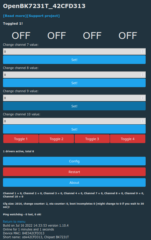

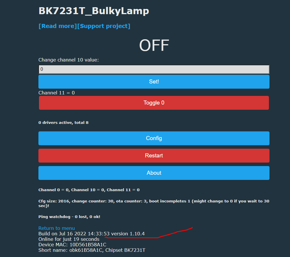

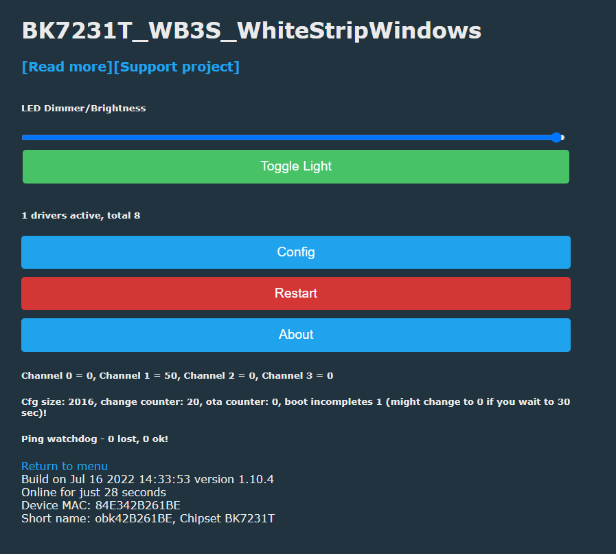

    xostia wrote:
    For your information, I updated with OTA from 1.10.2 to 1.10.4 ... and the device is dead.
    I tried to switch off many times before the 30 seconds but ... no device wifi appears for recovery.
    I understand that I need to open again and flash with USB-TTL again, true?
    The 1.10.4 works for me:
    Did you confuse the OTA file for N version with T version? This would block the device.
    Futhermore.... 1.10.2 was 45d47d2 commit...
    The only things added were:
    https://github.com/openshwprojects/OpenBK7231...mmit/84b982a7177f40fd60c90bd1f310c90b764c24a9
    https://github.com/openshwprojects/OpenBK7231...mmit/279c61a26382be5808fc9b46ba1b73f6ba7e671f
    I don't think these changes could cause such a fatal behaviour, especially with all the safety checks and precautions in place. Rebooting device 5 times with failure should start it without any drivers.

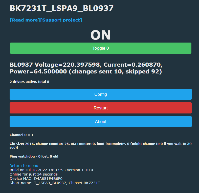

    EDIT: second check, LSPA9 BL0937:
    EDIT2: Third test (ignore extra channel fields, I'm testing:
  • #782 20104098
    marioalmeida
    Posts: 47
    Rate: 24
    @xostia , @p.kaczmarek2
    I update mine from 1.10.2 to 1.10.4, device is working.

    #783 20104277
    xostia
    Posts: 14
    Thank you @p.kaczmarek2 and @marioalmeida...
    It is possible that I flashed the N version... sometimes this is a mess with the soldering, the cables, the computer... arggg, probably my mistake.
    I flashed the second LSPA9 unit and reflashed this one... both are working with 1.10.4.
    Ah! including:
    P6 Wifi_n 0
    The blue led flashes during connection and stays on if the wifi connection is established.
    ... all is in a good point to create a "quick profile". All seems to work well...

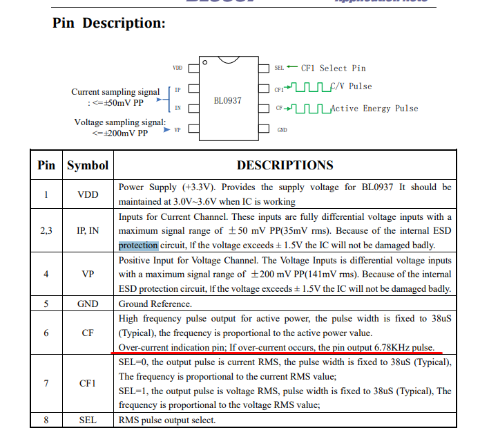

    When you have time, tell me samething about this:
    1) How can I perform a individual time configuration (I did not see in the web of the device that, set date or NTP config).
    2) Is there any way to program on/off periods and save the configuration in the device itself? (to work even when there is no connection to wifi or the home-assistant).
    3) How can I know that the BL0937 CF is in the right GPIO (I understand, reading the datasheet, that is related to the protection when there is a high current). Is the protection took in account in your firmware? (switch off in a certain limit).
    Thank you for your quick asnswer and updates. This works perfect!

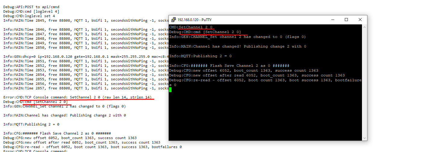

  • TCP console with short get commands and socket closing
    #785 20105046
    Posts: 14724
    Rate: 12807

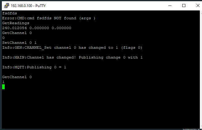

    @marioalmeida there is a certain very rare case where doing a lot of MQTT publish can disconnect device, but I already added multiple stability improvements and the final fix is also coming soon.
    Maybe retain YAML setting would help?
    @xostia for now, I am doing a simple TCP console with a certain set of commands that return only the requested value
    Examples of short commands:
    The final form of console is not determined yet. Right now "Short get" commands return single string value so you can easily parse it, but set commands return full output.
    NOTE: remember to close the socket after you execute the command, currently commandline handles one client at time, altough it would be relatively easy to change it fully to use non-blocking berkeley sockets IO and use multiple sockets at time.
    The console is not released yet as I am testing stability.

    Can you tell me more about your desired use case for the pre-implementation analysis?
    I am not sure what are you asking for. For the first part of the question, I'd say that you open device and check the tracks with multimeter (you know pinout of BL0937. Regarding the second part...
    Do you mean over-current scenario?
    That's not present right now, I think. Is there a practical use case for that?

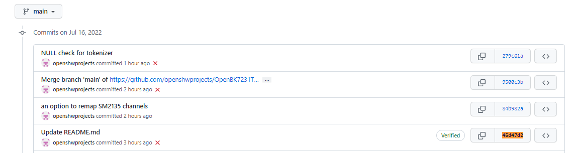

    #786 20105878
    Tych0
    Posts: 15
    Rate: 20
    Ah ok, that's very simple, @Tych0 . It's just that the order of outputs from SM2135 is not standarized and the manufacturers do whatever they please.
    I have added a command to remap it. Can you check?
    Usage:
    SM2135_Map 2 1 0 4 3
    this is the default order, you might try SM2135_Map 0 1 2 4 3
    Remember that setting is not saved, so add the command call to the "short startup command"
    PS: SM2135 is started automatically now if you have set the pins, no need for StartDriver SM2135. If you need multiple commands, use "backlog yyy; zzzz; xxxxx; " etc
    Nice, works as you designed it!

  • Suggesting overcurrent protection and YAML unique_id fix
    #789 20106817
    xostia
    Posts: 14
    Hi @p.kaczmarek2 ...
    Thank your for your answers. The console idea, for me, is great! ... date/time management and programming will be perfect. Thank you for hearing us.
    I will try to check if the BL0937 CF pin is in the right GPIO... but I am pretty sure that yes... I used the same that you indicated in this threat forother device and SEL and CF1 seems to work ok, probably CF is also right.
    It could be interesting, in the software, detect that overcurrent pulse of 6.78KHz (BL0937 CF)... and switch off the plug. Probably is not so easy and I am missing something. Using Smart Life App with the original firmware there was an option to "enable over-current protection". I suppose that It behaves like that.
    One detail, the code to include in YAML configuration for Home Assistant (provided in the web interface of the device) misses an "unique_id" (and for my LSPA9 WB2S the 1/0 enable/disable for the switch are inverted ... but I suppose that quickconfig modifies that and probably I was playing with that and that is the reason in my case).
    P.S. My use case is quite generic ... probably I will end installing something like home assistant after some time... but I will install 2 or 3 of this devices in my parent's home with a simple access to enable/disable with simple shell scripting. If the sheduling on/off is implemented... It is easier (I do not need to use cron to launch scripts). Thank you for your effort.

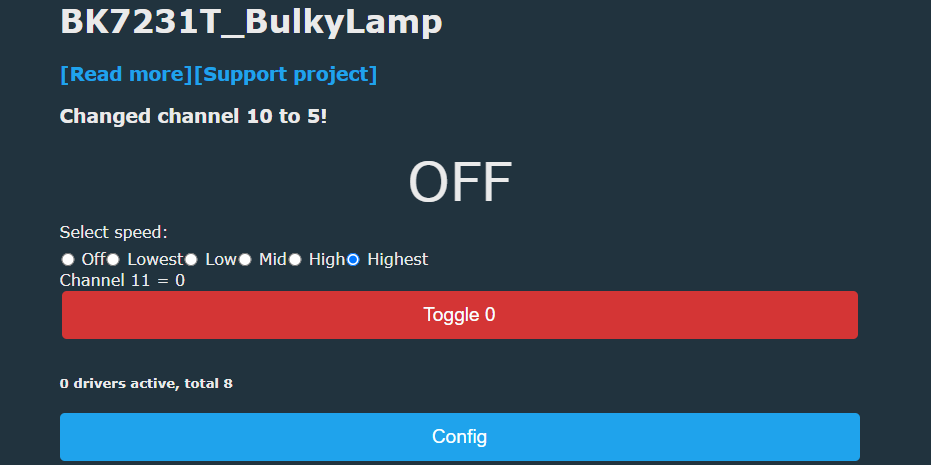

  • Request for 5-speed Tuya fan channel support
    #796 20111630
    marioalmeida
    Posts: 47
    Rate: 24
    @p.kaczmarek2
    Is it possible to add support for tuya fan with 5 speed? as I have a tuya fan controller with 5 speed option
    Info:TuyaMCU:TUYAMCU received: 55 AA 03 07 00 08 03 02 00 04 00 00 00 02 1C
    Info:TuyaMCU:TuyaMCU_ProcessIncoming: processing command 7 (State) with 15 bytes
    Info:TuyaMCU:TuyaMCU_ParseStateMessage: processing dpId 3, dataType 2-DP_TYPE_VALUE and 4 data bytes
    Info:TuyaMCU:TuyaMCU_ParseStateMessage: raw data 4 int: 2
    Info:TuyaMCU:TUYAMCU received: 55 AA 03 07 00 08 03 02 00 04 00 00 00 03 1D
    Info:TuyaMCU:TuyaMCU_ParseStateMessage: raw data 4 int: 3
    Info:TuyaMCU:TUYAMCU received: 55 AA 03 07 00 08 03 02 00 04 00 00 00 04 1E
    Info:TuyaMCU:TuyaMCU_ParseStateMessage: raw data 4 int: 4
    Info:TuyaMCU:TUYAMCU received: 55 AA 03 07 00 08 03 02 00 04 00 00 00 05 1F
    Info:TuyaMCU:TuyaMCU_ParseStateMessage: raw data 4 int: 5
    //fan speed channel
    setChannelType 3 OffLowMidHigh
    // link output 3 with data type 2 to channel 3
    linkTuyaMCUOutputToChannel 3 2 3
    With above config I get only 3 fan speed, appreciate if you can add 4th and 5th speed option.

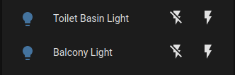

  • Request for web commands, relay status, and measurements
    #798 20111876
    xostia
    Posts: 14
    Hi @p.kaczmarek2
    I installed the last version of Home Assistant and the YAML check shows that message, it is mandatory a unique id (I wrote the same name and it works).
    I was checking the information in github but I did not find this... wich commands can a launch from web interface? I am preparing a console menu to use it with a simple ssh to my internet router. For example, the toggle button executes http://the.name.or.ip/index?tgl=1 but I tried http://openbk1./index?on=1 and it also works.
    I would like to know if there are commands about the status of the relay and to get the current or voltage... to include in my openbk.sh bash script. Do you have the list of the implemented right now?. I was testing with the commands documented in Tasmota... but are not the same. The truth is that they should be the same (if possible).
    If in a near future you implement a simple scheduler for the on-off switches... it will be a great advance.
    Thank you for your time.

    Hi again @p.kaczmarek2. I tried to edit two times my previous post but it never shows edited...
    I updated one of the LSPA9 (BL0937 version) with 1.10.9 but I did it with OpenBK7231T_UA_1.10.9.bin (the bin ... and not the rbl).
    ... It is solved except the MAC address. Now, the MAC C8478C000000 and if I try to change I obtain a "MAC change error?" and it stays the same (probably some corrupt data someware in the flash). Any solution?. If I reopen the device, flash the original firmware and flash again your OpenBK will it be solved?
    Thanks.

    @xostia I am aware about this issue. You have erased some memory region related to MAC. The temporary fix would be to reflash with original 2MB if you have a backup. Otherwise, you'll have to wait.
    @xostia I will ask again as my previous post most likely was lost due to the forum issue, which exactly Tasmota commands do you want? I can try to provide them for you, as I already have planned support for eg. Tasmota Control mobile Android app, etc.
    It's just that I do the project in my free time so sometimes you'll have to wait for an update longer.

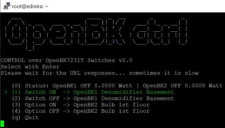

    Hi @p.kaczmarek2... no stress, all this is really nice. I am enjoying to play with this and your work is amazing.
    I was testing some commands from here: https://tasmota.github.io/docs/Commands/#control but the URL commands for on/off are different, in general all are different. It would be nice to make them compatible Tasmota. I did not find in Tasmota any web command to get Current, Amp ... In the script that I prepared, I parsed the output of the main page of your firmware to extract this info. In Tasmota there is also the Power command to know the status (I had to do it in my script also parsing the web output provided by your firmware).
    About the "recovery MAC" address that I have now... I can live with this "C8478C000000". If in a future, if there is a way to write the original one, perfect... probably it will be easier to achieve no error trying to modify the MAC in the web interface.
    In any case... I prepared a bash script that runs a menu to enable and disable two switches and shows the status of them (Current in Watt and ON/OFF state). It is not perfect but really easy to use from a SSH connection to my router with DD-WRT (From Windows I use Putty and from Android ConnectBot... I discovered this last week, it can even provice tunnels to connect to IPs inside my home network). Here is the script if anybody wants to use it (http://openbk1. and http://openbk2. are my two LSPA9 BL0937 version, but this should work with any other device with your firmware OpenBK7231, replacing these names with your own names or IPs):
    Code: Bash
    You can download it directly from here:
    https://www.dropbox.com/s/e244ty8fet746df/openbk_v2.0.sh?dl=0
    It looks like this:
    If you want to include it or some part as an example from your wiki... no problem at all.
    Thank you again

    You have a very nice script here, short and self-contained, but can you add it here just with a < syntax = bash > block? It's better than using external links that may expire someday.
    Also, have you looked into new TCP command line? It also provides short commands that return only requested value. You just need enable it in options and then connect TCP on port 100 (should be configurable in the future). I will provide more information soon.
