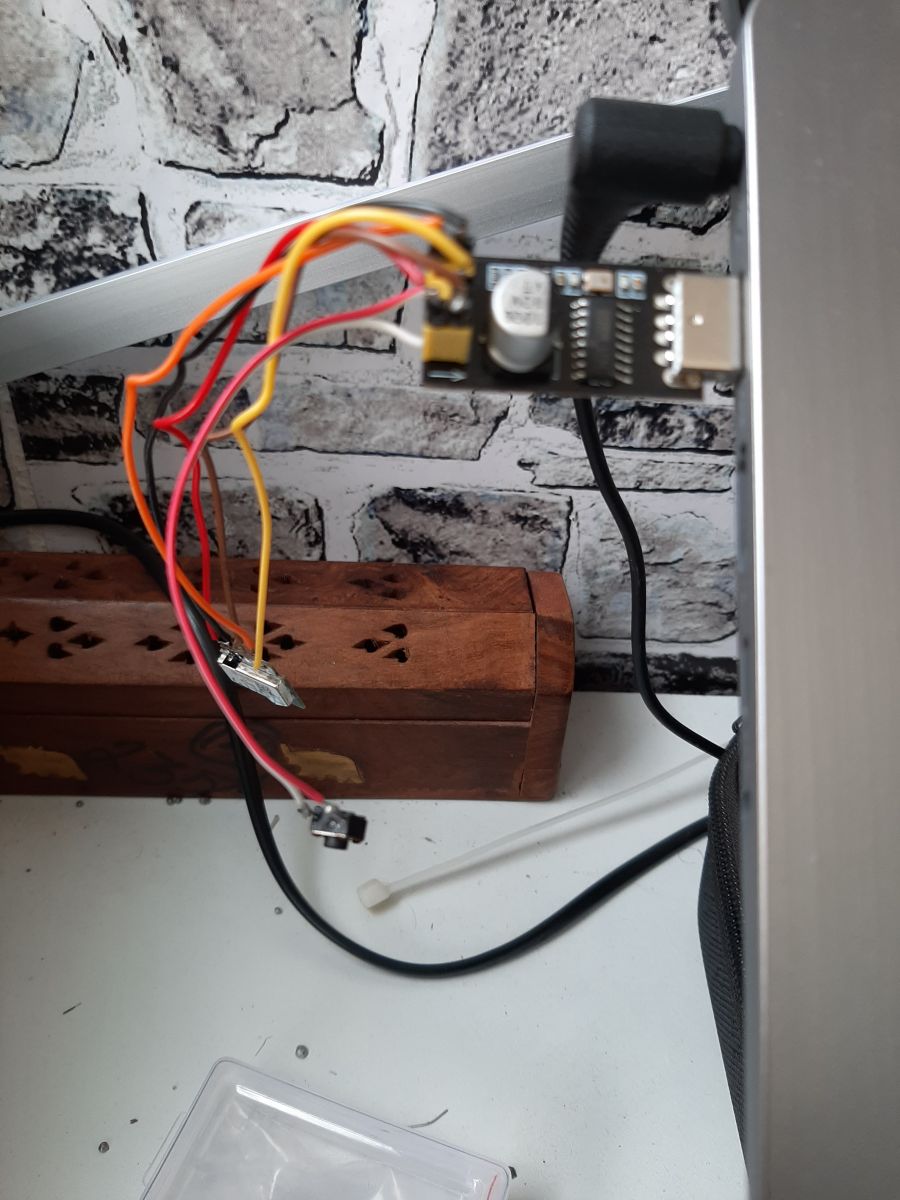

    @p.kaczmarek2
    @leecher1337 why not just connect external UART to USB converter and capture the the communication data? That way we will know if it's a TuyaMCU or something
    Oh, so this may be a TuayMCU, thanks for the hint!
    Sorry for stupid question, but is there a way to tell OpenBK that it has to use RXD1/PWM2 as serial protocol interface ports instead of TXD1/RXD1 to even have a chance that the TuyaMCU driver is working or did I miss something?

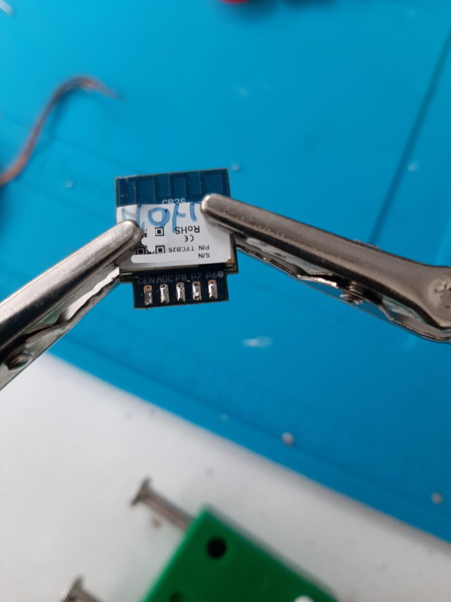

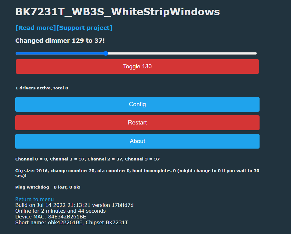

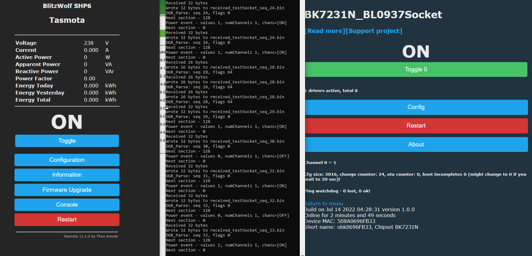

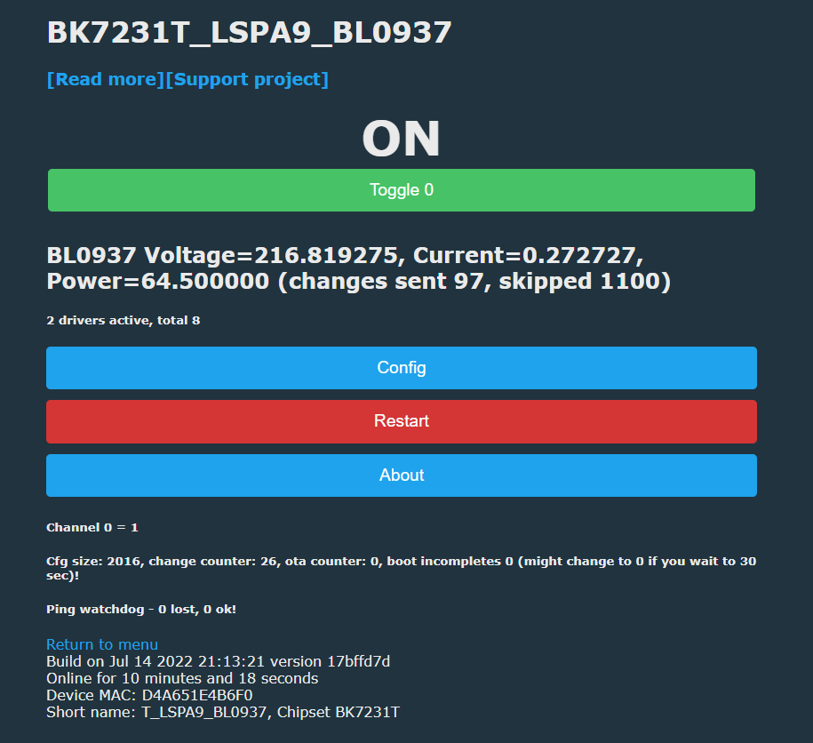

  • #753 20098377

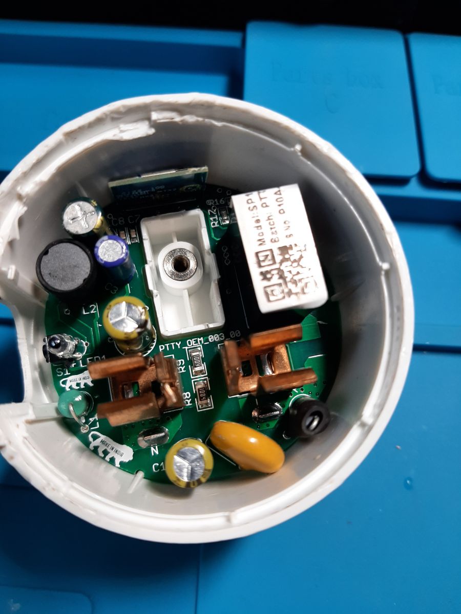

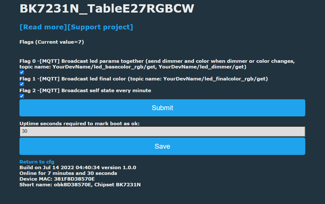

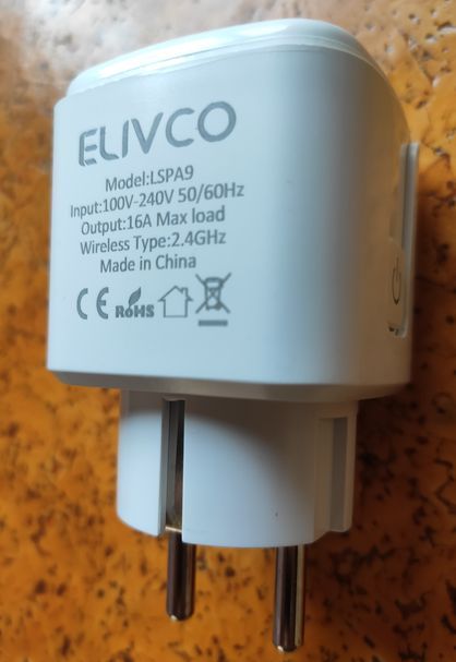

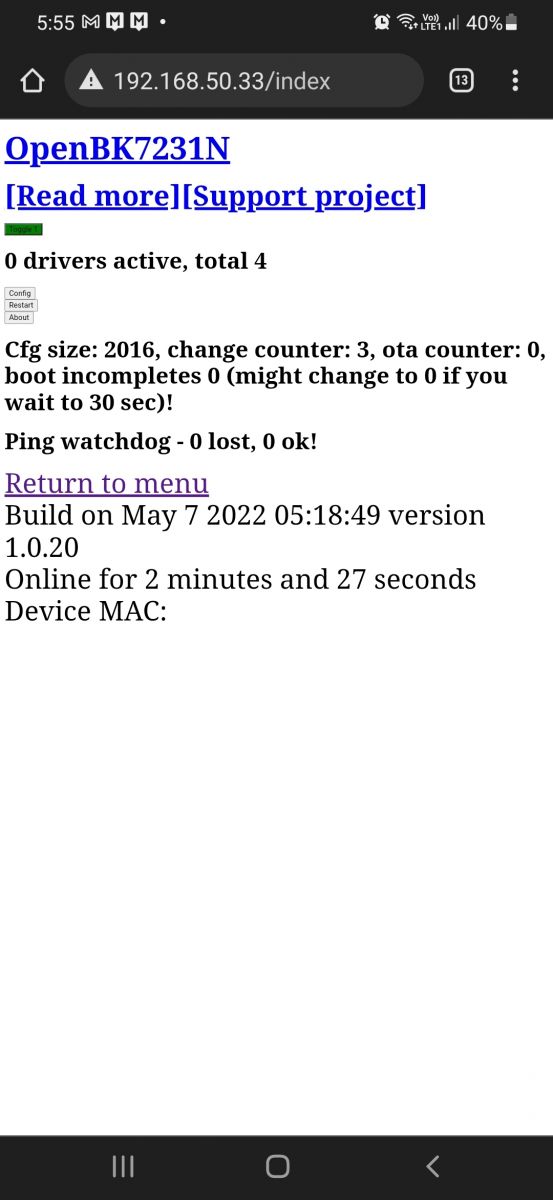

    brijin
    thank you for this wonderful project, I appreciate the effort behind this. I thought I'll share my setup on this main thread since I have bunch of devices running on this project. they all run solid, connected to HA and works fine.
    attaching some pictures. sorry if I am hijacking this thread. [BK7231T] My HTTP server, configurator, MQTT support from Home Assistant [BK7231T] My HTTP server, configurator, MQTT support from Home Assistant [BK7231T] My HTTP server, configurator, MQTT support from Home Assistant [BK7231T] My HTTP server, configurator, MQTT support from Home Assistant [BK7231T] My HTTP server, configurator, MQTT support from Home Assistant [BK7231T] My HTTP server, configurator, MQTT support from Home Assistant [BK7231T] My HTTP server, configurator, MQTT support from Home Assistant [BK7231T] My HTTP server, configurator, MQTT support from Home Assistant [BK7231T] My HTTP server, configurator, MQTT support from Home Assistant

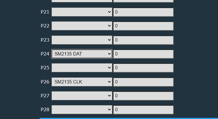

    rawilson wrote:
    @ p.kaczmarek2 it looks like the GU10 bulbs available in Poland woj14415 are based on WBLC5 + SM2135Eh - I2C communication. After dismantling, it turned out that the CLK line is connected to pin 26, date to pin24. Would you provide information on how to configure this bulb?
    Are you still here?
    SM2135 driver will be ready tonight.
    It's not possible to change the location of hardware UART ports on Beken chips. Are you sure about that PWM2? Maybe it's not a TuyaMCU after all. Please try to sniff the packets with external USB to UART converter.

    @brijin this is very useful, would you like to provide us more details, the exact product names (and wwhere to buy them) and ready pinout configurations?
    You could also post them here: https://www.elektroda.com/rtvforum/forum507.html

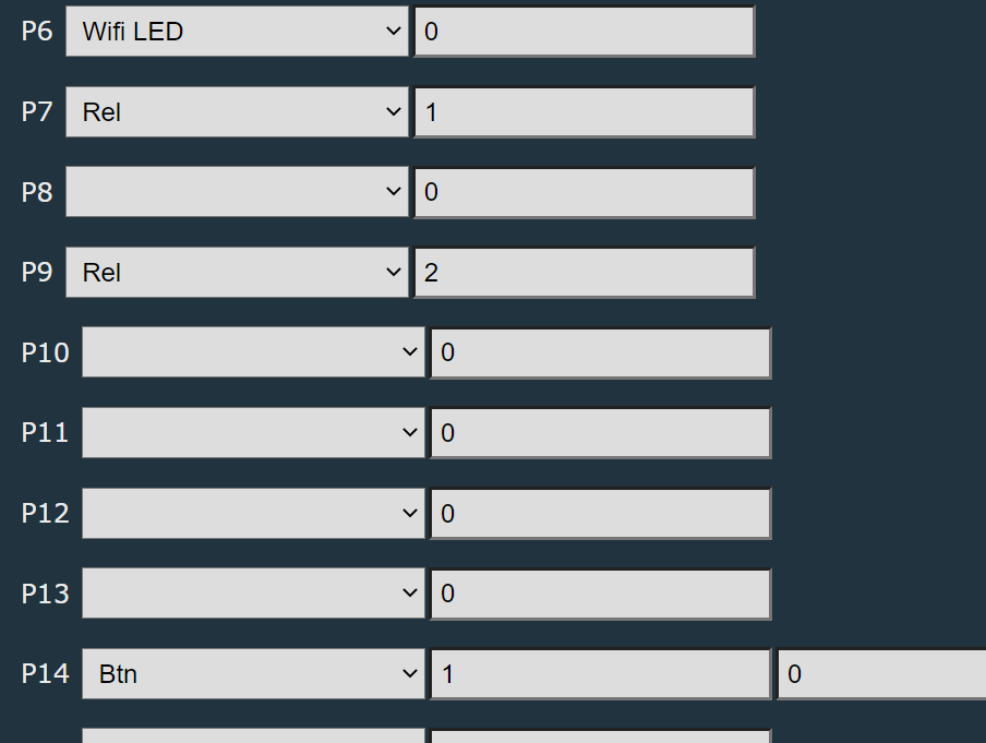

  • Event handler setup for button clicks and relay separation

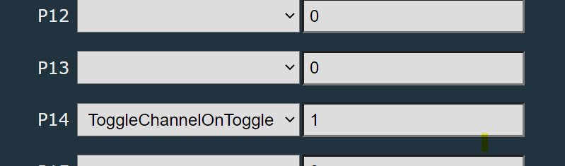

    #755 20100486
    ferbulous
    Posts: 419
    Help: 8
    Rate: 56

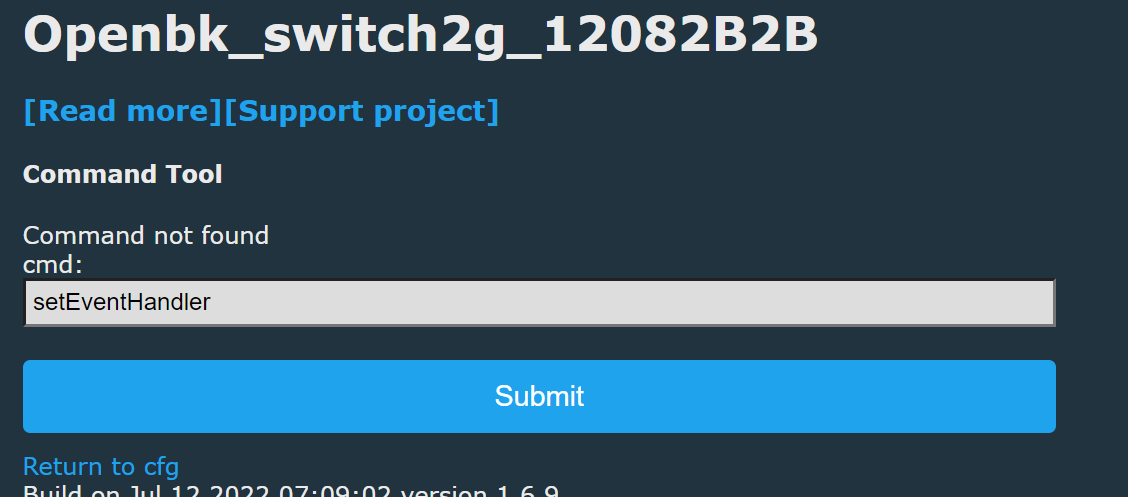

    Hi @p.kaczmarek2 , sorry been away for work
    Just tested the tasmota group feature, i've added openbk 2 gang wall switch into an existing tasmota group (nightlamp -> 4 lights bulbs, + button 3 from a 3gang switch)
    By toggling either tasmota bulbs or switch, it would toggle the openbk switch as well. But toggling openbk switch would not control the other tasmota devices so I'm guessing this is where I should use eventhandler script?
    For the evenhandler, how do i enable that in the command line and see the ouput? And how could I get single, double, hold clicks working without toggling the openbk switch relay?
    For example, wifi bulb is connected the openbk switch relay 1, so I intend to have the relay 1 always on while using button 1 clicks for custom bulb action.
    By the way, Is it also possible to separate switch for the group? similar to devgrouptie
    EDIT
    Ok, i think i almost got it
    I changed button 1 for pin 14 to togglechannel
    Then I added this in custom cummond
    addEventHandler OnClick 14 SendGet http://192.168.1.198/cm?cmnd=Power0%20Toggle
    Pushed button 1, but doesn't seem to do anything, the web request is correct when I tried it on browser

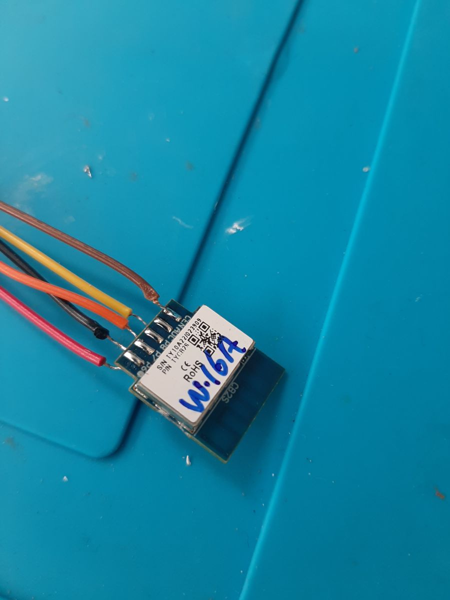

  • #756 20100639
    AcuarioCat
    Posts: 8
    Rate: 10
    @p.kaczmarek2 Yes the Smart Home WiFi Smart Switch has a TW-02 module whic has a W600 processor - unless they have updated it since the ones I bought.
    I did a 'transplant' to an ESP on one device which works fine but much better to use the native device.

    #758 20100904
    Posts: 14724
    Rate: 12806
    It seems I just forget to add the callback for relay change. No a problem, I can add it fifteen minutes.
    https://github.com/openshwprojects/OpenBK7231...mmit/cd920de7e96edc39d4a352067e057badcd782786
    Here, done, can you check now? Sending power should be working automatically, no scripting needed. I will also look into the dimmer and RGB.
    WARNING: you MUST use correct channel indexes. I tested it with two power metering plugs. It will work correctly if you use channel 0 (not 1!) for relay on obk, because it expects channel 0 to be the first channel. Here is my test setup:
    The only issue is that I don't have any ESP8266 RGB lights, nor any RGBCW. Can you recommend me where can I buy ESP8266 LED bulb?
    Otherwise I will try to implement it blindly, would you be able to test that in this case, @ferbulous ?
    One of the things I am unsure of currently, is the DGR protocol of Tasmota supposed to send raw RGB color and dimmer separately, and then I shall do finalColor = dimmer * rawColor, or is the color send by Tasmota DGR already a final value?
    I am confident that "ToggleChannelOnToggle" is not using Button code at all, thus "OnClick" won't work for that, the same goes for "OnHold" and "OnDblClick".
    Would you like me to add a special "OnToggle" callback for this specific purpose?

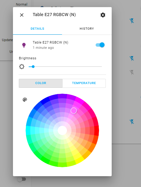

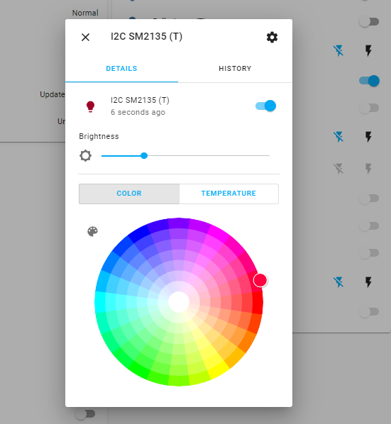

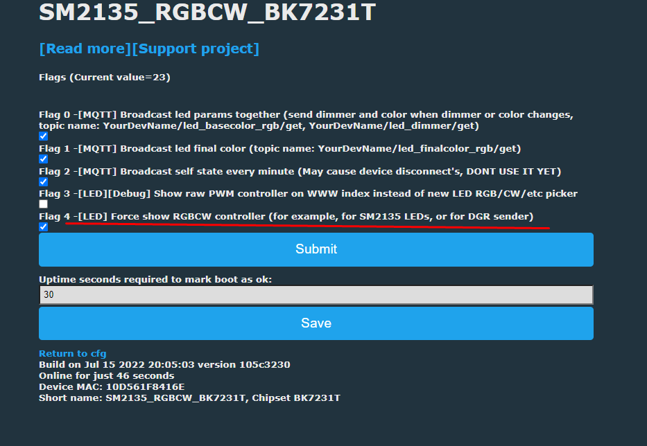

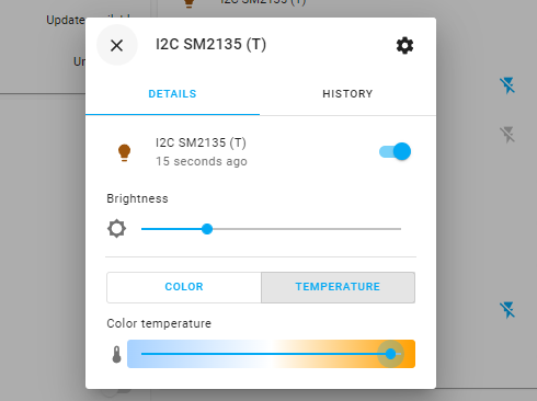

    @rawilson SM2135 setup
      - platform: mqtt
        name: "I2C SM2135 (T)"
        rgb_command_template: "{{ '%02x%02x%02x' | format(red, green, blue)}}"
        rgb_state_topic: "SM2135_RGBCW_BK7231T/led_basecolor_rgb/get"
        rgb_command_topic: "cmnd/SM2135_RGBCW_BK7231T/led_basecolor_rgb"
        rgb_value_template: "{{ value[0:2]|int(base=16) }},{{ value[2:4]|int(base=16) }},{{ value[4:6]|int(base=16) }}"
        #rgb_value_template: "{{ '%02x%02x%02x'| format(red, green, blue) }}"
        command_topic: "cmnd/SM2135_RGBCW_BK7231T/led_enableAll"
        state_topic: "SM2135_RGBCW_BK7231T/led_enableAll/get"
        availability_topic: "SM2135_RGBCW_BK7231T/connected"
        payload_on: 1
        payload_off: 0
        brightness_command_topic: "cmnd/SM2135_RGBCW_BK7231T/led_dimmer"
        brightness_scale: 100
        brightness_state_topic: "SM2135_RGBCW_BK7231T/led_dimmer/get"
        brightness_value_template: "{{value}}"
        color_temp_command_topic: "cmnd/SM2135_RGBCW_BK7231T/led_temperature"
        color_temp_state_topic: "SM2135_RGBCW_BK7231T/led_temperature/get"
        #color_temp_value_template: "{{value}}"
        retain: true
    i didn't have much time to test it but I will help you if any issue arise
    UPDATE: as I said, it won't work this way, because ToggleOnToggle is not using button code.
    I have added a specific callback for this purpose:
    https://github.com/openshwprojects/OpenBK7231...mmit/dea3e827baaf09a2401e9b79aec441fd2e7206d9
    If you're using ToggleChannelOnToggle, you should use:
    addEventHandler OnToggle 14 SendGet http://192.168.1.198/cm?cmnd=Power0%20Toggle
    where 14 is a index of toggle pin and not a channel index
    But, also keep in mind that automatic Tasmota Device Groups power send was added last hour, so there is no need for so much scripting now.
    What else would you like me to add?

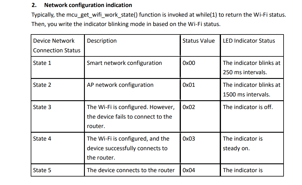

    Now I need to know how to configure the wifi led indicator, which is connected to the TuyaMCU
  • WiFi state is not a dpID and needs implementation
    #760 20101704
    Posts: 14724
    Rate: 12806
    Sorry @marioalmeida , I've been away, but I see you have worked it out partially. That's great! Btw, you can also consult this topic:
    https://www.elektroda.com/rtvforum/topic3895301.html
    As for WiFi LED indicator... well, I'm not sure. Is WiFi LED indicator also a dpId, or isn't it?
    If WiFi LED indicator is not a dpId, then you'll have to wait, as I haven't implemented it yet.
    Would you have time to test it if I were to implement that? I don't have any devices with TuyaMCU wifi indicator at hand.
    Second option - can you tell me where to buy the device you have?
    ALSO: If you need some special kind of GUI for the TuyaMCU (for example for timeouts), just tell me, I will try to organize something.
    EDIT: WiFi state is not a dpID:
    but it should be easy to implement that

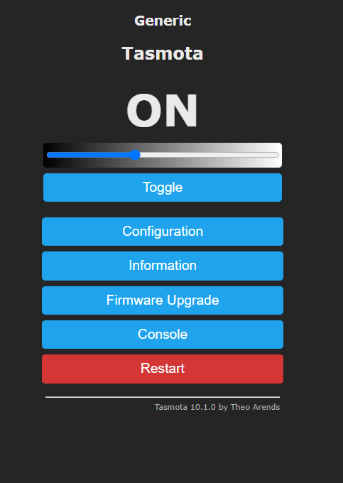

  • Questions about double press, Tasmota groups, and Tuya restore
    #761 20101761
    ferbulous
    Posts: 419
    Help: 8
    Rate: 56
    @p.kaczmarek2
    I believe sonoff B05-BL-A60 still has esp
    Thanks for the new update, I tried OnToggle for the addevent handler and it works
    Is there a different command for double press or long press with ToggleChannelOnToggle since OnHold & OnDblClick is not using button code?
    For tasmota group, it doesn't seem to work for me on 1.7.5, neither tasmota lamp/switch or openbk switch are being controlled even after adding to same group. That and I'm unable to access the webpage or ping after 5-6 minutes for the openbkswitch that I'm testing but the switch still functions normally and listed as connected in the router settings. I'll try flashing openbkt on another device and see if this still persists.
    Also, is there a proper step for restoring back to original tuya firmware if I need to?
    I backed up the cb3s firmware with bk7231tools, dissected rbl and I'm getting bootloader_1.00.bin & app_1.00.bin. But I'm not sure for the next step

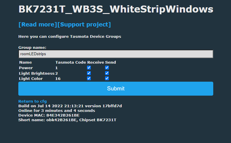

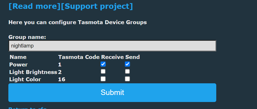

    There is no "double press" and no "onDblClick" for ToggleChannelOnToggle. Are you sure you know how ToggleChannelOnToggle works? ToggleChannelOnToggle is for case where you have old switch in the wall and still want to reuse it. Normally, you'd use a Button pin.
    Please post photos of both device configurations. The "Tasmota lamp" is not enough information for me, do by "a lamp" you mean a relay?
    Do your OpenBK device has any PWM pins set in the pins config?
    What exactly do you need to synchronize, power states, LED state?

    UPDATE: Tasmota device groups bugfix and improvement is on the way, should be up in the next 12 hours.
    Change 1: fixed rare logical error leading to device reverting to old state
    Change 2: added correct LED driver gui (1:1 like in Tasmota) for single color LED strip
    Change 3: single color LED strips now are also 100% DGR compatible (automatically, just like the relays)
    See:
    Now I would also like to do:
    - support for WarmWhite/ColdWhite strips and DGR
    - support for RGB bulbs and DGR
    - support for RGBW and RGBCW bulbs
    but I lack items for testing, I will try to order some bulbs here in Poland and maybe I will get something with esp.
    Again - can anyone help with testing?

    @p.kaczmarek2
    I see, i thought that's the option to pick if I need to enable to multipress action like on tasmota (decouple relay with s073 and obtain multiple button states)
    I need to know how different your configuration is.
    My config is:
    - Tasmota device (power metering plug) with single relay on channel 0
    - Obk device (power metering plug) with single relay on channel 0
    No extra channels, no PWM pins. Both of them have a button.
    Tasmota DGR communication is this case works in both ways.
    My devices are:
    a) 4 tasmota bulbs
    b) 1 tasmota wall switch (3 relays - 1 relay assigned to group (devgrouptie)
    c) 1 openbkt wall switch (3 relays) - No PWM set in the pins
    Just trying to sychronize power states for now
    Also, is your device T or N?
    It's N (CB3S)

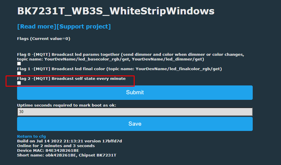

    Wait, do you mean that MQTT gets unresponsive after few minutes of using Tasmota Device Groups, or in general?
    Are you using that option?
    I already had reports that there is an issue with MQTT LWIP library and sending too many requests may crash the device.
    Are you using those "broadcast" options as well? How many MQTT broadcast options do you have enabled?
    Or to put it differently:
    1. Does the crash occur if you don't use DGR but use all MQTT publish options?
    2. Does the crash occur if you disable all MQTT publish option flags?
    3. Does the crash occur if MQTT is disabled at all?
    4. Does the crash occur if MQTT is disabled but DGR enabled?

    I think that I just managed to recreate the same issue (with all MQTT broadcast flags enabled) on my RGBCW bulb (thanks to your input) and the issue is now fixed. The device now could only disconnect MQTT, but should not crash/lock itself any more, but more testing is needed.
    Please try latest updates and report back here. I will also do more tests as the day comes.

    Hi,
    I bought two ELIVCO LSPA9 in Ali (7$)
    I opened one of them and this is the version with WB2S + BL0937. Different than the described by pkaczmarek2 in one of his fantastic how-to.
    Following the instructions in that link, I could flash the WB2S with OpenBK7231T_UA_1.9.0. In this case, I could use bk_writer1.60 but I had to desolder TX1 and RX1 to achieve the connection using my USB TTL 3.3V.
    The device boots and I can configure the wifi. With this configuration I have the basic functionality:
    P7 BL0937 CF 0
    P8 BL0937 CF1 0
    P10 Btn 1
    P24 BL0937 SEL 0
    P26 Rel 1
    The button works, I can enable the relay (web and button) and I get Voltage/Current/Power information (uncalibrated) if I execute the "startDriver BL0937" in the log part of the web app. The blue led is fixed blue and it turns to red when the relay is enabled.
    If I add "P6 Rel_n 1" I get the red and blue leds mixed when the relay is on. I would like to use the blue led to inform about wifi activity... but I did not find how.
    The problem is that I can not see any information about BL0937 in the logs and I can not enable any checkbox in that screen related to BL0937. I can only see continously this BLXXX messages in the logs section:
    "Info:BL0942:Consumed 255 unwanted non-header byte in BL0942 buffer"
    If I execute the calibration commands, like "VoltageSet [correntVoltageVal], CurrentSet [correntCurrentVal] i PowerSet [correntPowerVal]" nothing is shown in the screen... and then I can not calibrate.
    Probably it is my fault, I am "rookie" with this thigs... Can anybody explain to me how to enable the messages?
    In the other hand, if you can include a profile for this LSPA9 WB2S+BL0937, It would be great.
    Thank you for your fantastic job. Thank you.
  • SM2135 RGB channels appear mixed up
    #769 20103663
    Tych0
    Posts: 15
    Rate: 20
    Awesome work on the SM2135 LED driver :-)
    Very cool project, keep up the good work everyone!
    I have two devices with a SM2135. I started off with a LSC GU10 RGBCW from Action store with BK7231T. Upgraded to the latest 1.9.0 version. Nice work on the Tasmota alike GUI btw.
    At first everything seemed to work nicely. There is one small issue... the colours are mixed up and HA is acting weird, color picker jumps from red to green for example when I try to set red. Tried to re-order RGB to BRG but that made it even worse...
    Color temps on the CW leds works flawless. Brightness is also working.
    I messed around with the YAML you posted here for the SM2135 but I can't figure out how to correct the issue.
    Does anyone has any idea what's wrong?

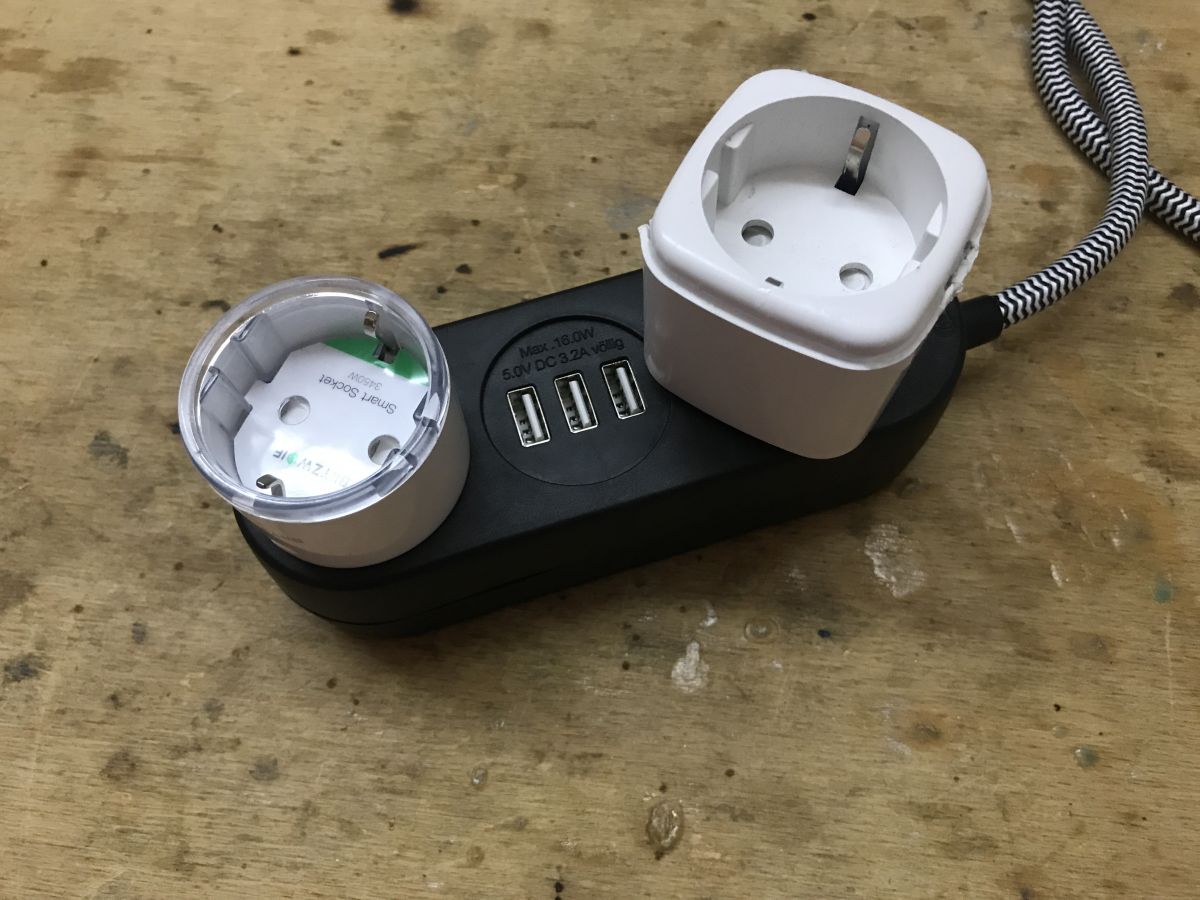

    BL0937 LSPA9... yes, I have two LSPA9, one with BL0942 and second with BL0937.
    I have many sockets, thanks to one polish donor:
    I have BL0937 guide on the way.
    xostia wrote:
    P7 BL0937 CF 0
    P8 BL0937 CF1 0
    P10 Btn 1
    P24 BL0937 SEL 0
    P26 Rel 1
    This is OK. I will also add a autostart of BL0937 driver when one has pin specified.
    Is the issue on MQTT/HA communication side, or in the wrong channels used for RGB?
    Please disable MQTT totally, make sure that your device is disconnected, and then, on OpenBeken gui, set the color to:
    1. set to 100% RED (255 0 0) - is the color red?
    2. set to 100% GREEN (0 255 0) - is the color green?
    3. set to 100% BLUE (0 0 255) - is the color blue?
    Tell me the results and I will provide futher instructions. I might add per-channel role setting to the SM2135 driver if needed.
    For me, SM2135 driver works great so it's not possible to debug this issue on my side.
    [UPDATE] I went and checked my socket, and well, my LSPA9 BL0937 seems to be working.. 60W bulb test, no calibration yet
    Some of my sockets, with one of them ESP8266, used for testing Tasmota Device Groups device state synchronization:
    one of them is older LSPA9 with WB2S+BL0937, second LSPA9 here is newer one with CB2S and BL0942

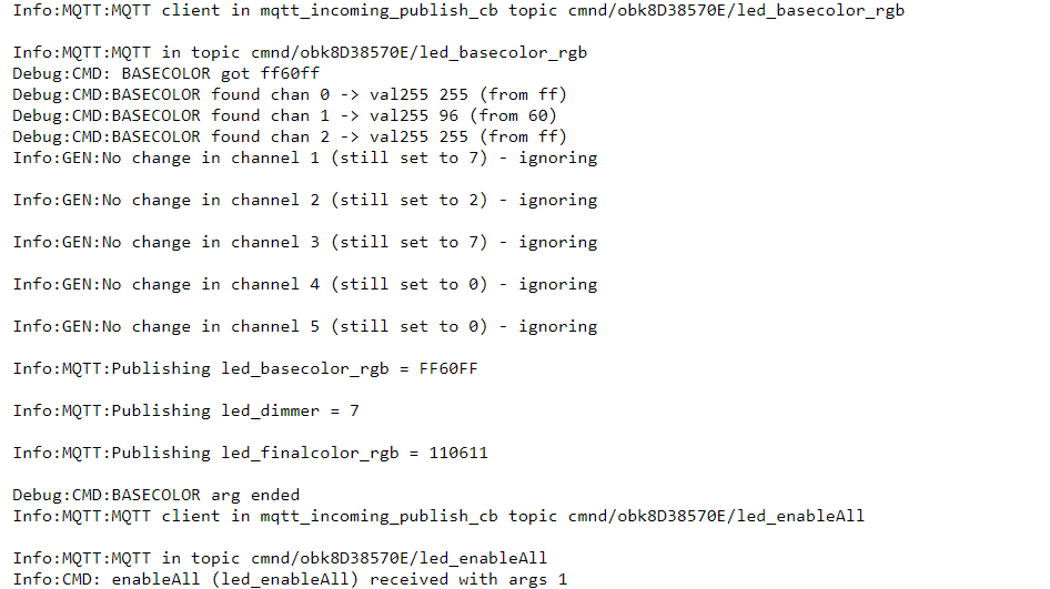

    Obviously, I have no clue what's going on... MQTT 'disabled' by changing server IP to non-existing address.
    I can't find where to change the colours in the OpenBeken GUI... I would expect to see it on the main page, right?
    The only way to get the LED light up using the GUI is to send led_enableAll 1 as command. led_enableAll 0 also turns them off again. But SetChannel 1 100 does nothing. Not sure what I'm doing wrong... sorry.
    Works:
    Debug:CMD:cmd [led_enableAll 1]
    Info:CMD: enableAll (led_enableAll) received with args 1
    Info:GEN:CHANNEL_Set channel 1 has changed to 100 (flags 2)
    Info:GEN:CHANNEL_Set channel 2 has changed to 100 (flags 2)
    Info:GEN:CHANNEL_Set channel 3 has changed to 100 (flags 2)
    Info:GEN:No change in channel 4 (still set to 0) - ignoring
    Info:GEN:No change in channel 5 (still set to 0) - ignoring
    Does not work:
    Debug:CMD:cmd [SetChannel 1 0]
    Info:GEN:CHANNEL_Set channel 1 has changed to 0 (flags 0)
    I also noticed that most of the time I have to repeatedly send the commands before the show up in the log.
    Oh and de "Status" page in the WebApp say's: 0:0 role
    Not sure if this is normal behaviour.
    Ah, I see... you might have an older version. The current version requires you to set this flag:
    The setChannel doesn't work right now for SM2135. SM2135 is connected to new led driver. There is a scriptable command to get around it:
     startDriver SM2135
     SM2135_RGBCW FF00000000
    but it's not required for normal operation.
    Still, the advanced scripting with "IF" and "WHILE" etc statements is also coming soon, I already have working prototype. It will be very simple to use, with a simple, user-friendly syntax.
    Altough I must note that I am not sure how the final configuration system for SM2135 will look like. I don't how which SM2135 use cases should we expect. I will update the system on the fly, I might also add a direct access to SM2135 channels, it should be very easy as well.
    For example, is SM2135 used with only Cool White/Warm White lights as well? It wouldn't make sense, would it?
    Check. I was on 1.9.0 and updated to 1.10.1. Set the flag, and yes I can now change stuff on the main page. But... same behaviour. When I change the color in the GUI to red, the green LED's turn on. Exactly the same pattern when I use HA and MQTT. I don't know if there are different SM2135 versions. This is a bulb with a SM2135EH.
    I have another one, different brand with a SM2135E. Same issue as the other one, mixed-up colours. And the Cold en Warm LED's do not seem to work on this one... which is working perfectly on the bulb I been talking thus far. (side note, I had trouble flashing this one and I might have fried it while doing so...)
    Thanks so far, I really appreciate your help!

    xostia
    Posts: 14
    Respect @p.kaczmarek2 and LSPA9 WB2S+BL0937.
    There is a checkbox to select "BL0942" messages but no "BL0937". In any case, you say that the logs are disabled, I hope that in future versions we can select both.
    I have nothing in my autoexec.bat, the BL0942 boots by itself ... I started BL0937 by hand in a command (If you have time, associate the Enter key of the keyboard with the launch command button... I realised that Enter does not work to execute commands, I must click with the mouse).
    When I try to calibrate, I get always a 000.00000 value, ¿do you know why? It seems that the calibration commands only run in BL0942, that is running but it is invalid for this device. How can I stop the BL0942 module?
    Thanks for your help
    This is by default in the 1.9 version in the startup:
    backlog startDriver BL0942; VREF 15987.125000; PREF -683.023987; IREF 272302.687500
    Added after 12 [minutes]:
    Now it seems that I can calibrate with VoltageSet XXX en so on...
    I replaced the default startup BL0942 with BL0937. There is no log information but the calibration messages answer with regular values... before always 000.0000.
    I will update now to 1.10.2 also. Thank you, this is great.
    One question... is there any way to connect by console (putty or similar) to enable/disable the relay?. I would like to have a simple access to my devices like this...
  • SM2135 output remapping command added
    #775 20103930
    Posts: 14724
    Rate: 12806
    Ah ok, that's very simple, @Tych0 . It's just that the order of outputs from SM2135 is not standarized and the manufacturers do whatever they please.
    I have added a command to remap it. Can you check?
    https://github.com/openshwprojects/OpenBK7231...mmit/84b982a7177f40fd60c90bd1f310c90b764c24a9
    Usage:
    SM2135_Map 2 1 0 4 3
    this is the default order, you might try SM2135_Map 0 1 2 4 3
    Remember that setting is not saved, so add the command call to the "short startup command"
    PS: SM2135 is started automatically now if you have set the pins, no need for StartDriver SM2135. If you need multiple commands, use "backlog yyy; zzzz; xxxxx; " etc

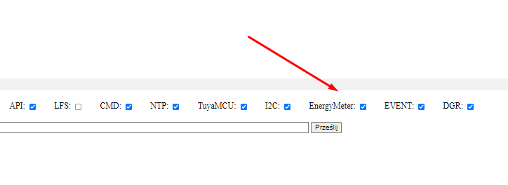

  • Power Metering checkbox renamed from BL0942 logging
    #778 20103954
    Posts: 14724
    Rate: 12806
    Thank you for reporting this, this was indeed a left over from times where I had only BL0942 driver.
    Now I renamed it to "Power Metering". This checkbox is only to show/hide logging.

    I include here my startup text (that includes the calibration of my device LSPA9 WB2S+BL0937). I performed the calibration using the original firmware in the other unit (it can not be perfect but more or less... it works).
    backlog startDriver BL0937; VREF 0.121402; PREF 1.235294; IREF 10.192307
