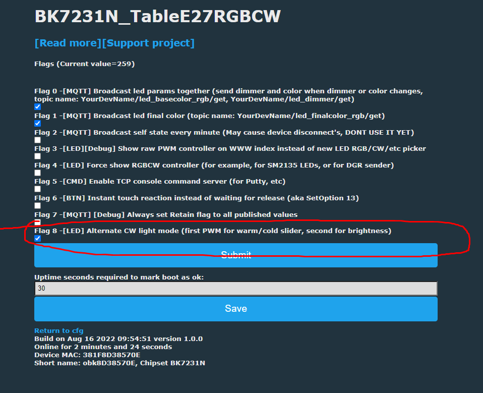

    Some of my lights have to start with a default brightness and color when powered on. I use a startup command for that. This works just fine.
    But when the light ia on and I change the brightness and/or color in HA. Turn off the light (cut power). And turn it on again. The light starts with the brightness and color as I configured it in the strap command. But... HA still shows the brightness and color that I changed in the GUI before I turned it off.
    I noticed the temp and dimmer messages in the MQTT state topic are not updated when the light is completely booted. Do I need to change something, misconfigured anything? Or is this a feature request?

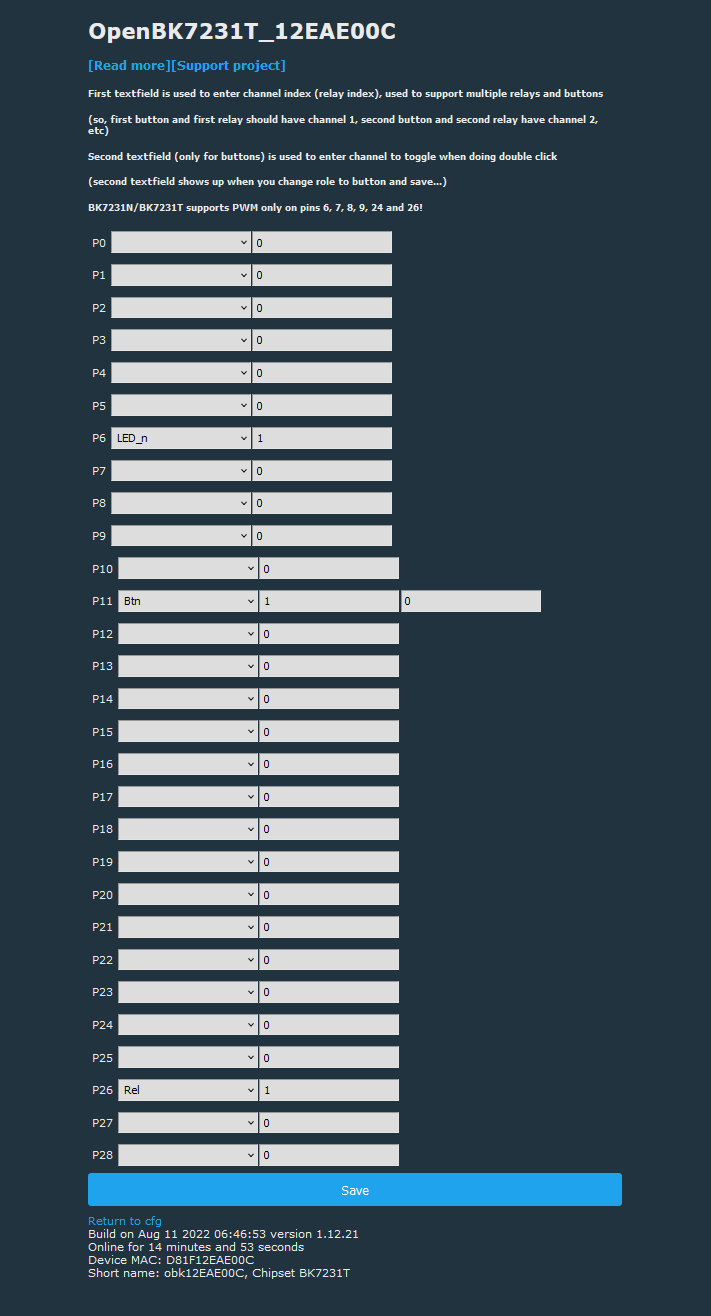

    rcayadi
    Hi All,
    I'm new to try flash smart breaker from brand BARDI (indonesia brand) https://bardi.co.id/products/on-off-breaker-sb-10a-nem/ they using WB2S , the flash is going OK and im using
    P24 - Rel
    P6 - Btn
    P7 - LED (but this led is on when OFF and led off wen ON) how to solve this?
    and then the wifi connection is offline immediately ? first i thought that about limited user in my router but it going off after i try off some wifi it's still happen. This flash device not offline immediately before i configure module. How to solved this
    Use LED_n option, which is an inverted LED. Same goes for REL (if you want), there is a REL_N option.

    rcayadi
    Thx now its working correctly
    P6 - Btn
    P7 - Led_n
    P24 - Rel

    if not, specify how do you drive your lights and show the HA yaml config.
    I've set flag 0 but that doesn't fix the issue. I assume, and makes sense, that the startup command is executed before the module has connected to the WiFi and MQTT and therefore does not send the new state message.

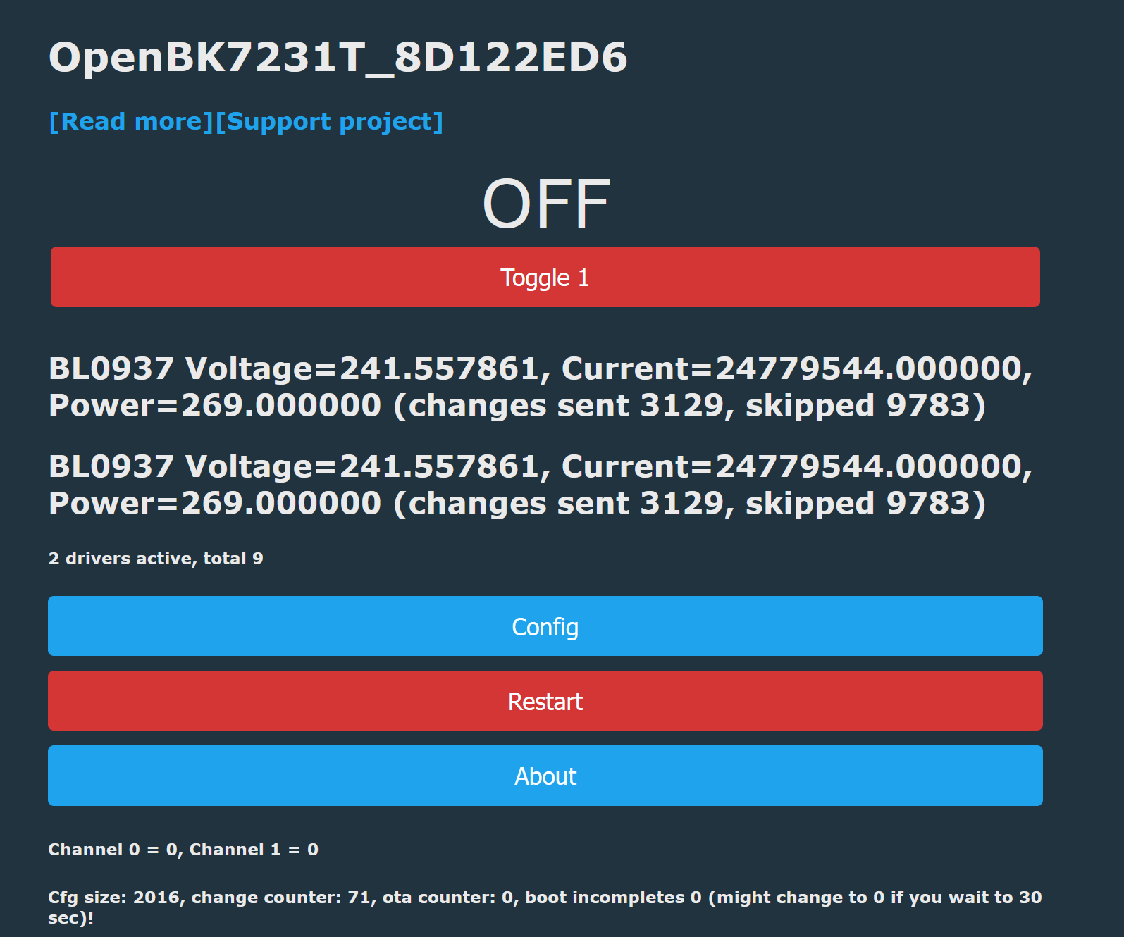

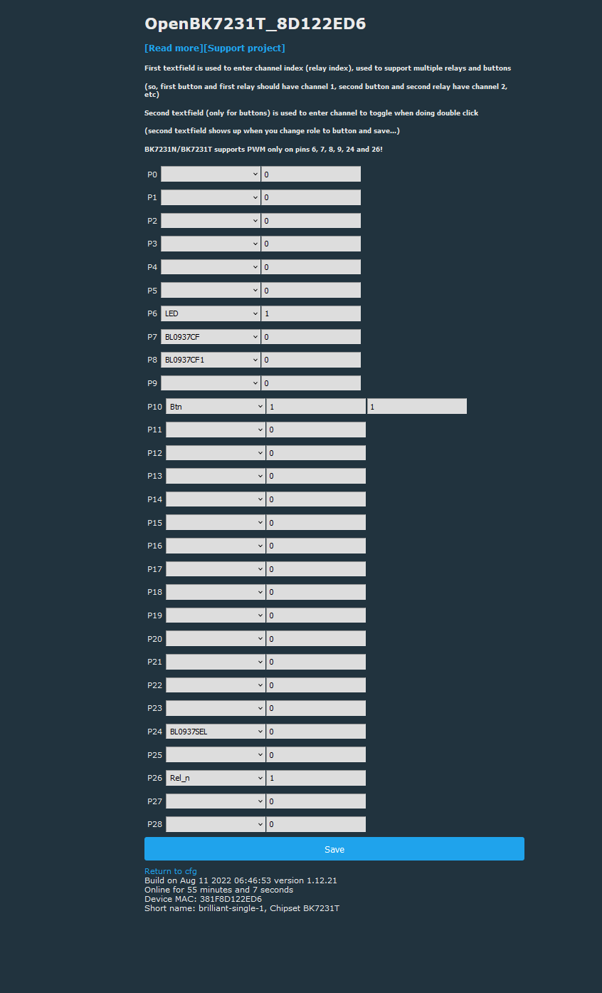

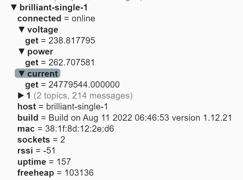

    Hi -I thought I'd share my config of an Australian plug/socket with power management The make and model are:
    Brilliant Smart
    20925 Series II
    The chip is BK7231T and the board is a WB2S-V1
    When I copied the Home assistant MQTT set-up the device showed up fine but the switch was inversed so I changed the relay to be rel_n. It is inverted in the browser but correct in HA. Any idea's why. *** Edit - I changed the Relay bck to Rel and inverted the HA MQTT switch!
    Also, I'm a bit confused as to how the power management (BL0937) is working. The menu page shows 2 drivers? Why not just 1?
    Also, while the power measurement is correct the display of the current is not (it just looks like a count). Below is a snap from my MQTT explorer.

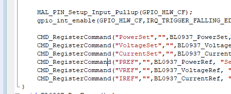

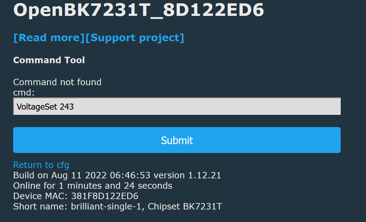

    ** Edit - I don't seem to be able to calibrate the BL0937, I'm getting "command not found"?
    Same for VoltageSet and PowerSet and CurrentSet.

    I have a RGBCW bulb with a setting of RED color in startup command, but it seems that my Home Assistant overwrites the change (bulb is red after restart but after connecting to HA it's white again).
    Here is my full log:

    Look, my device does publish self color, red:
    Info:MQTT:mqtt_publish requies 32, has 1024
    Info:MQTT:Publishing led_basecolor_rgb = FF0000
    Info:MQTT:mqtt_publish requies 43, has 1024
    Info:MQTT:Publishing led_finalcolor_rgb = C60000
    but HA still overwrites it:
    Info:MQTT:mqtt_publish requies 44, has 1024
    Info:MQTT:MQTT client in mqtt_incoming_publish_cb topic cmnd/obk8D38570E/led_basecolor_rgb
    Info:MQTT:MQTT in topic cmnd/obk8D38570E/led_basecolor_rgb
    Debug:CMD: BASECOLOR got ffffff
    Can you check your device, do you also experience same issue?

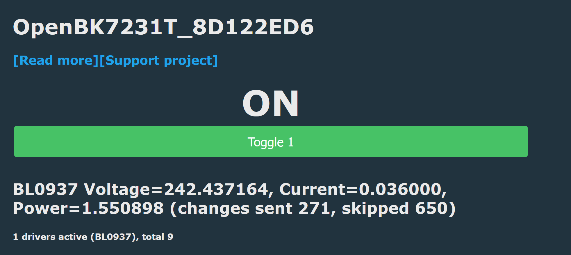

    @skylineh44 I think the "VoltageSet" etc commands are missing because you have not initialized the driver.
    Why do you have 2 drivers running and the interface twice? Have you started both BL0942 and BL0937 together? You should use only one.
    I will change the current WWW panel code to display the list of drivers that are running...

    Whilst trying to get the unit configured i did explore some preset examples (which had the different power monitoring chip). This would go someway to explain the multiple drivers. However, I tried to get back to a datum by using the 'Empty' template but maybe it doesn't eradicate all previous settings for the pins/drivers, or maybe I failed to do this correctly.
    As for the VoltageSet command. I have preceeded this command with the "startDriver BL0937" cmd which works fine, but then non of the 3 power calibration commands is understood. As I mentioned in my edit, it works fine the in /app

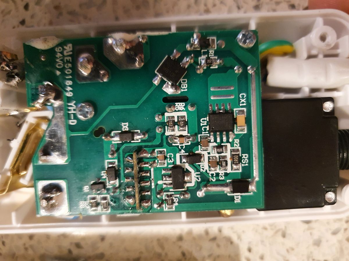

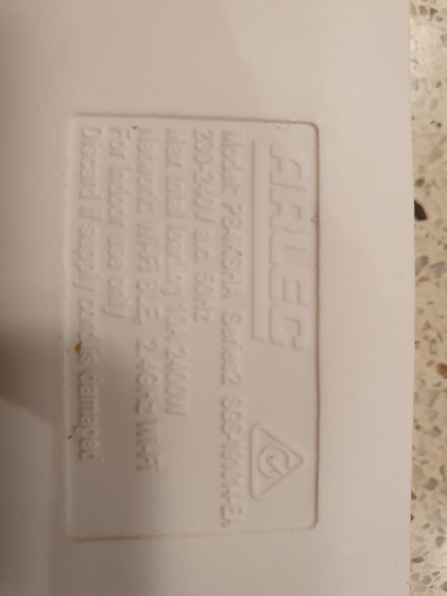

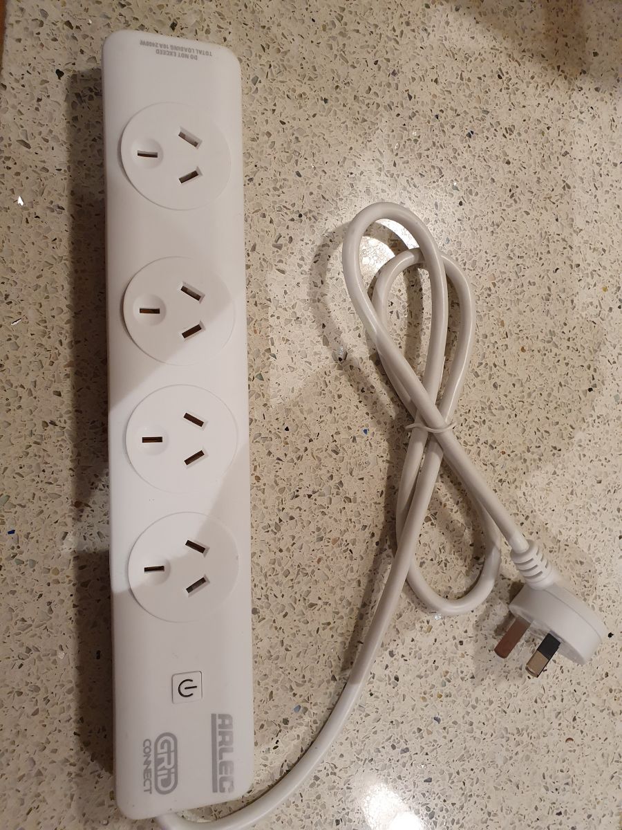

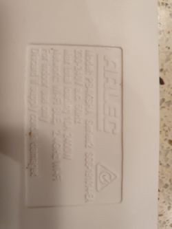

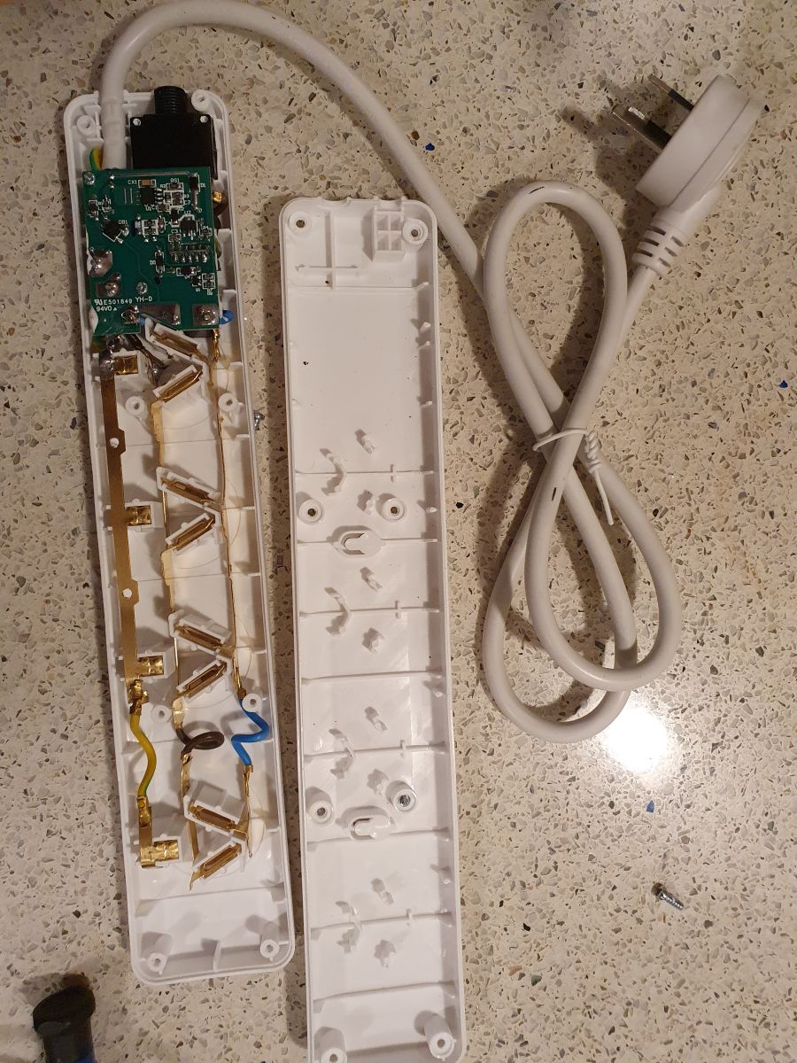

    Here's another device to add to the list. An Arlec powerboard P/N PB4KSHA Series 2. A simple 4 way powerboard with one push button and 1 relay.
    [BK7231T] My HTTP server, configurator, MQTT support from Home Assistant [BK7231T] My HTTP server, configurator, MQTT support from Home Assistant [img-2] [BK7231T] My HTTP server, configurator, MQTT support from Home Assistant [BK7231T] My HTTP server, configurator, MQTT support from Home Assistant [BK7231T] My HTTP server, configurator, MQTT support from Home Assistant
    And here is the configuration:
    [img-0]
    Again I de-soldered the WB2S module, it takes only a few minutes with a soldering iron and some copper braid! :D
    No fancy power monitoring in this product (Only $22 in Bunnings). Internal wiring and some of the components are a bit dodgy. Not a quality piece of hardware, but what can i expect at this price. I would not use on a heavy load, never mind the claimed 10A.

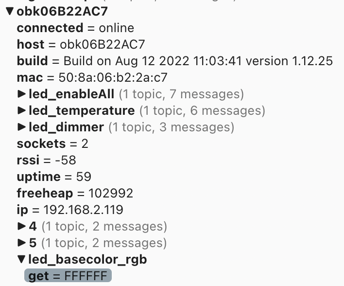

    I've noticed the same behaviour on a RGB light. And if I remember correctly, solved it by clearing the cmnd topic for that specific device. I don't use the retain flag on cmnd messages. But still the device seem to pick them up...
    The 1.12.25 release does seem to work just fine on a CW only light I just checked. Very nice, thank you!
    I also noticed, when I change temp and/or color in HA, a led_basecolor_rgb message (get = FFFFFF) is published in the state topic of my CW light. I don't expect that at all...
    I'll do some tests on a RGBCW device tomorrow.

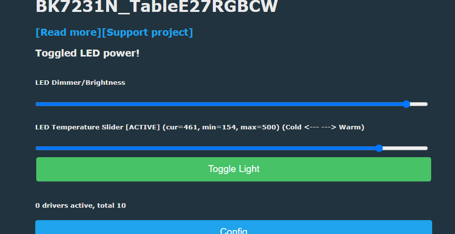

    Thanks to your testing I decided to add a display of active drivers in order to help users with configuration:
    https://github.com/openshwprojects/OpenBK7231...mmit/97f873f374de4c81c63bfb17a510f898e5a7c7a7
    Is there anything else I could add?
    I am not sure what you mean by "clearing the cmnd topic". The reporting back of color when it changes was requested by some user some time ago. There is also led_finalcolor_rgb
    I am aware about it from the start, that's because I had no CW lights for testing and the API is common for all light types. It should be very easy to fix, just add a condition if PWMcount == 2 then don't send RGB. It's just that I don't have all possible light types (RGB, single-color, RGBCW, CW or maybe RGBW....) at hand so it's hard for me to check all possible cases
    I think we can sort it out tomorrow, but we both will need to test the updated version
    EDIT: how is your CW light configured? Do you have 3 dummy channels for RGB (or dummy PWMs?) and 4-5 are CW, or just 2 channels (2 PWMs)?
    EDIT2: Do you have "broadcast led parameters together" flag set?

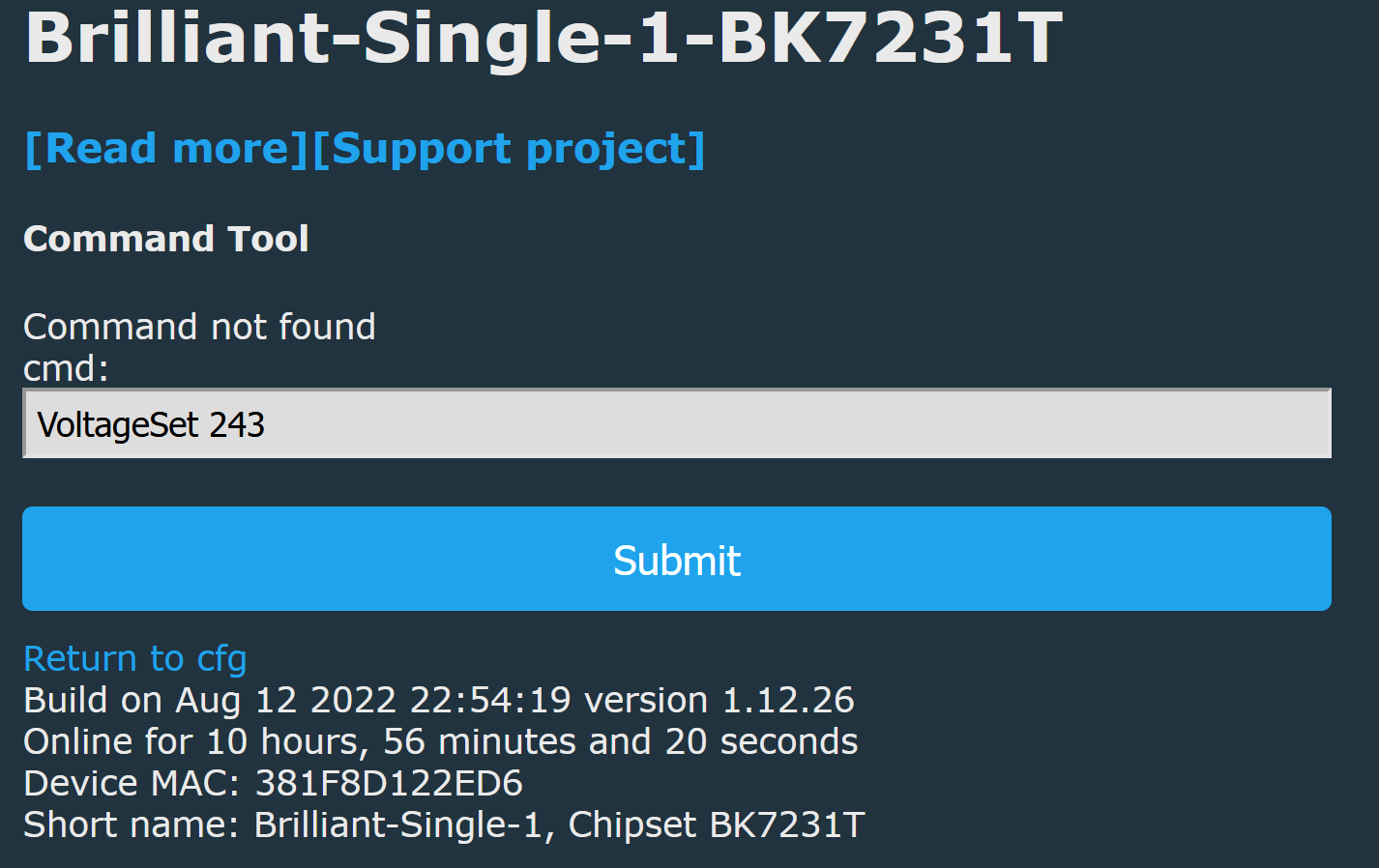

    I updated to the latest version via OTA. And the driver is now listed - thanks.
    The 3 calibration commands are still "unknown"
    Another minor issue in the/ app is that when I issue the VoltageSet command it responds with "CurrentSet". It does this for all 3 of the commands. Here is a cut/paste of the 2 lines in the log:
    Debug:CMD:cmd [VoltageSet 243]
    Info:EnergyMeter:CurrentSet: you gave 243.000000, set ref to 0.140706
    Ouh, I'm sorry, it's my copy/paste error. Should be fixed in:
    https://github.com/openshwprojects/OpenBK7231...mmit/9acd5bb256d59196d5941c29a05371c0523eb7a7
    thanks for reporting.
    I am still not sure what you mean by missing commands.
    Here are the BL0937 supported ones:

    skylineh44
    Level 4  
    This is what I am referring to, I thought putting the command here would work?
    I experienced the same issue. But when I disabled MQTT (by changing the MQTT server address on the device to a non-existing IP) the issue disappeared. So, I assumed it had to be an MQTT 'thing'. After removing the cmnd topic (using MQTT Explorer) for that specific device, everything was playing nice.
    I did test the version you made available yesterday, 1.2.25 I think, and could not re-produce the issue. The device nicely send the state messages and HA got aware of it and updated the status. Thx for that.
    2 channels. Only 4 and 5 for CW.
    Yes I did. But for my CW light it should not send 'YourDevName/led_basecolor_rgb/get'. So the suggested fix could fix that ;)
  • #870 20146052
    Posts: 14660
    Help: 656
    Rate: 12670
    I have added a small new feature to LED driver - support for CW lights where one PWM control brightness and second PWM controls light temperature (cold and warm together)
    https://github.com/openshwprojects/OpenBK7231...mmit/55c308813cb1a5a49a859bf3abe90c89ffb90836
    Do anyone here have such light? It's a different approach then the lights using one PWM for warm and second for cold white.
    @Tych0 it should be fixed now, but to be honest, I have no idea how you managed to get CW light working in earlier version without setting dummy PWMs for RGB, the correct solution has been added just today and still it's not a final one as I don't have such light to test....
