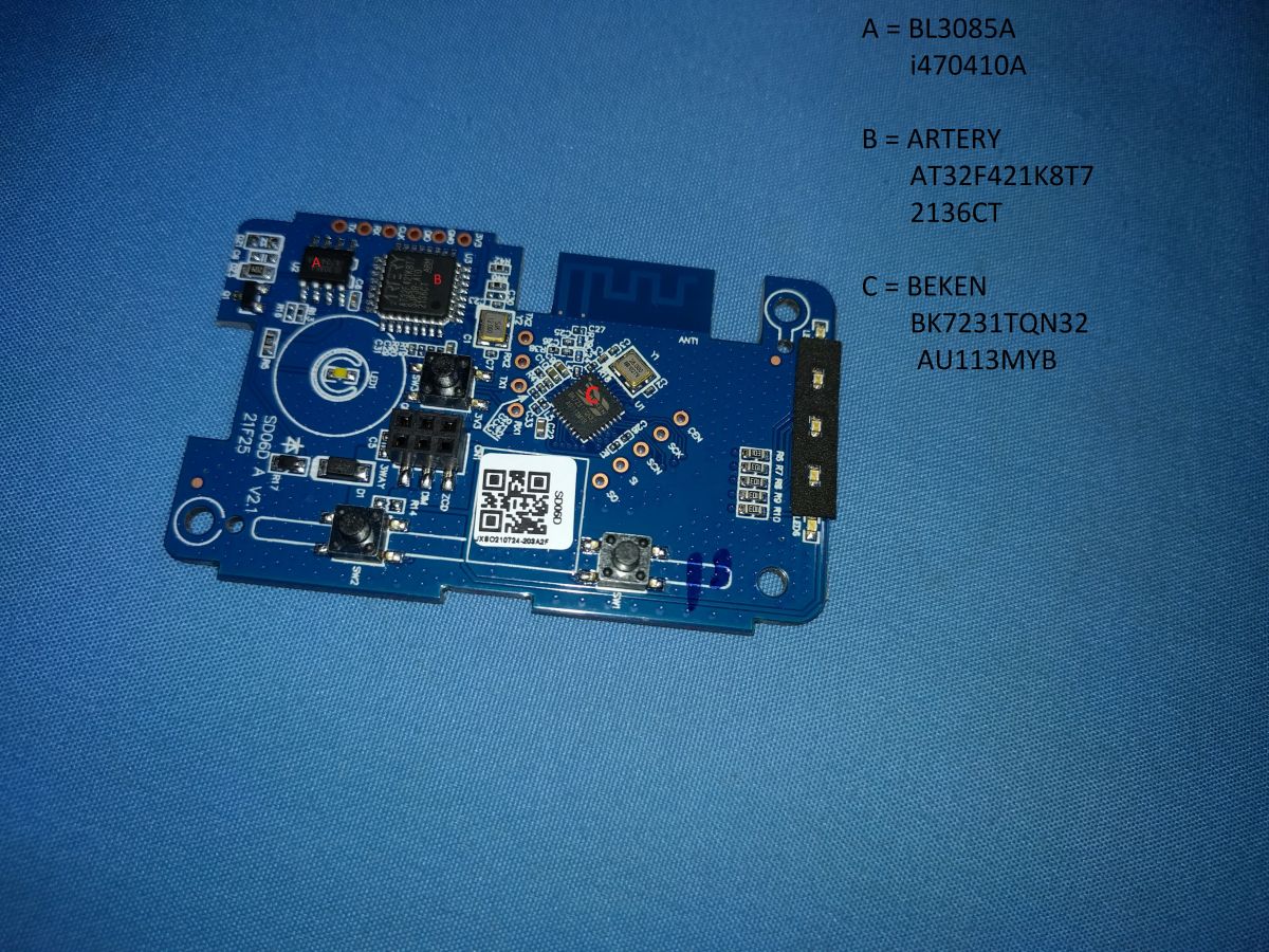

    I have never tested a Tuya smart door lock before. Can you make some photos and provide a short description how is it supposed to work?
    Is it the one with the keyboard? Is it TuyaMCU-based?
    Will do my best to get it working.
    It is base on Tuya but not sure if it has TuyaMCU or controlled directly by any Beken chip. Once I am back in U.A.E, will get more details on the same. This is lock that I have https://amzn.eu/d/9j0uPzS
  • #813 20116773
    Posts: 14724
    Rate: 12807
    It would be exciting to see a teardown of such device.

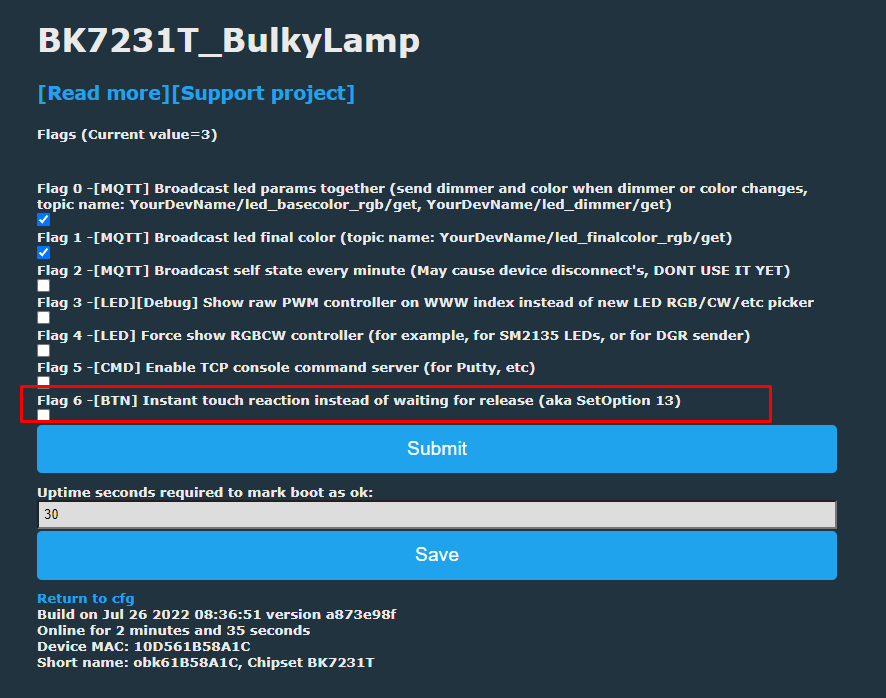

    Secondary VUE panel updated - now it displays the device chip name:
    Added SetOption13 equivalent for immediate button reactions - see flags:

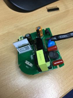

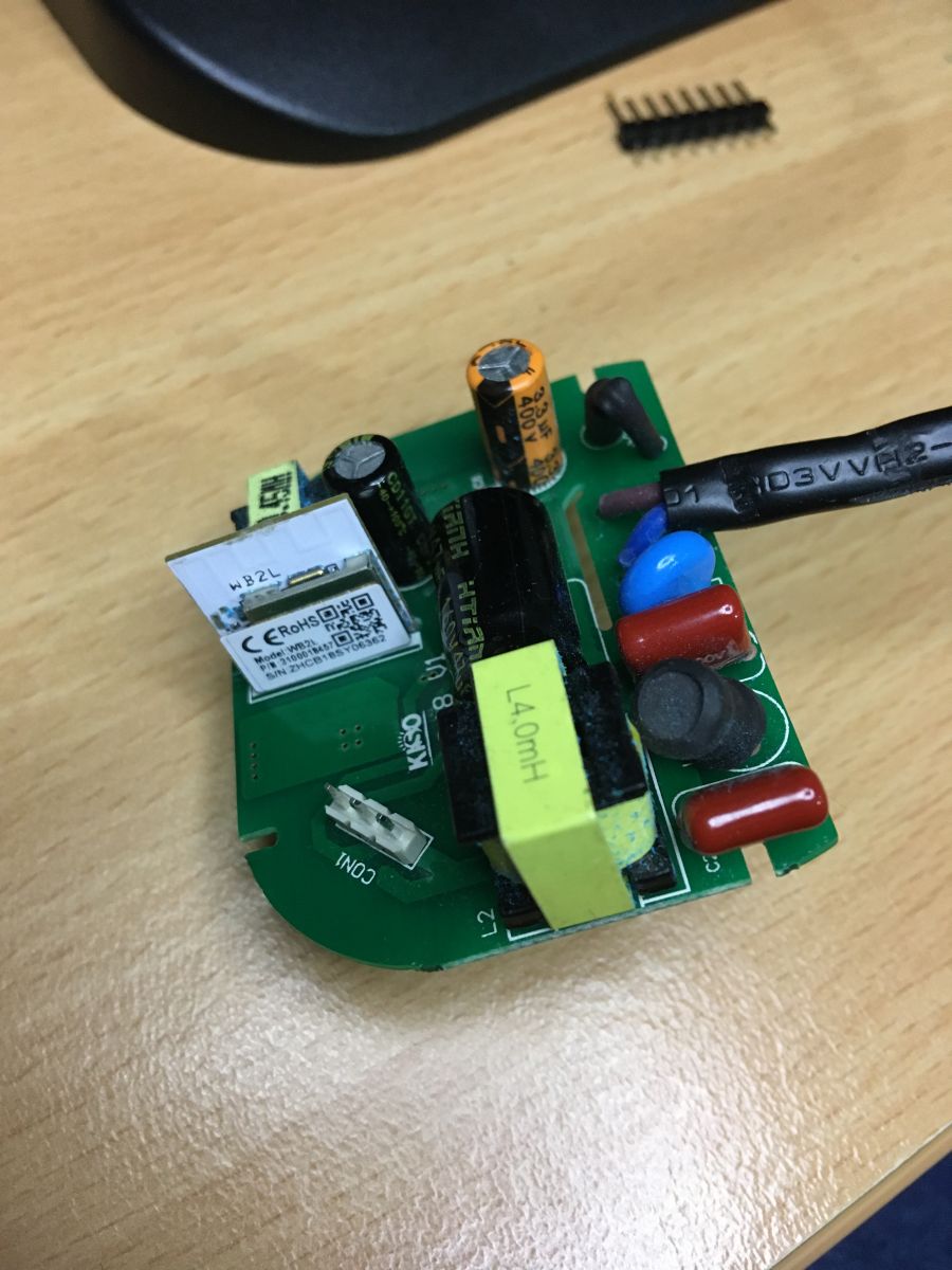

    What I mean by "old" is the ESP chips that were easily flashed OTA. I'm only new to the home automation game in the past month, so I missed out on those glory days :D
    I've got a PIR sensor open on my desk at the moment, https://www.brilliantlighting.com.au/product/smart-wifi-outdoor-sensor-2b562b
    It uses the WR3 module. I haven't managed to get it to even power up using the USB to TTL. Maybe it can't provide enough juice?

    WR3 module is based on RTL8710BN. I have already started working on SDK for that 3 months ago:
    https://github.com/openshwprojects/OpenRTL8710BN
    I will continue it soon. I might switch to a newer version, but don't worry, release for WR3 is near.
    I also have some PIR sensors, but they are based on XR809 which I already support.

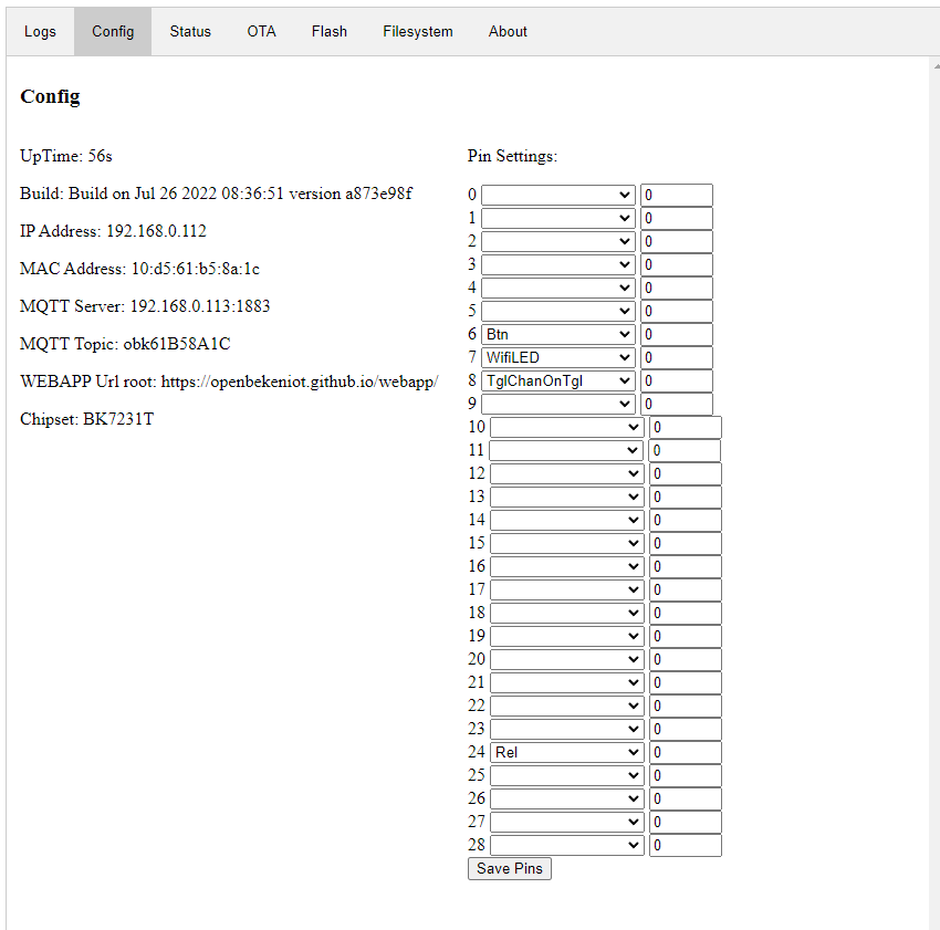

  • Clarifying Save Pins response and BL0937 voltage command
    #818 20118772
    marioalmeida
    Posts: 47
    Rate: 24
    @p.kaczmarek2
    under webapp (/app) when "Save Pins" button is pressed it get below message
    Error: {"success":200,"msg":"OK"}
    Is it error or success? bit confusing version 1.12.0

    I double-checked and it saves pins correctly. It's just a debug display of JSON reply message.
    The JS panel is still WIP and is developed by @btsimonh , I can't really tell much more about it. It's source code is also on github, but remember that this panel fetches javascript source from web, and it's not present in the .bin build of firmwares.
    It's a very new approach, totally different from Tasmota. Also, the panel source does not eat up the flash memory on the chips.
    Of course, the "classic" http panel is also present on OpenBeken, it's the WWW page you all know.

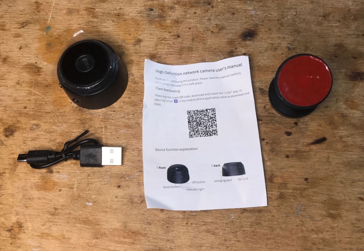

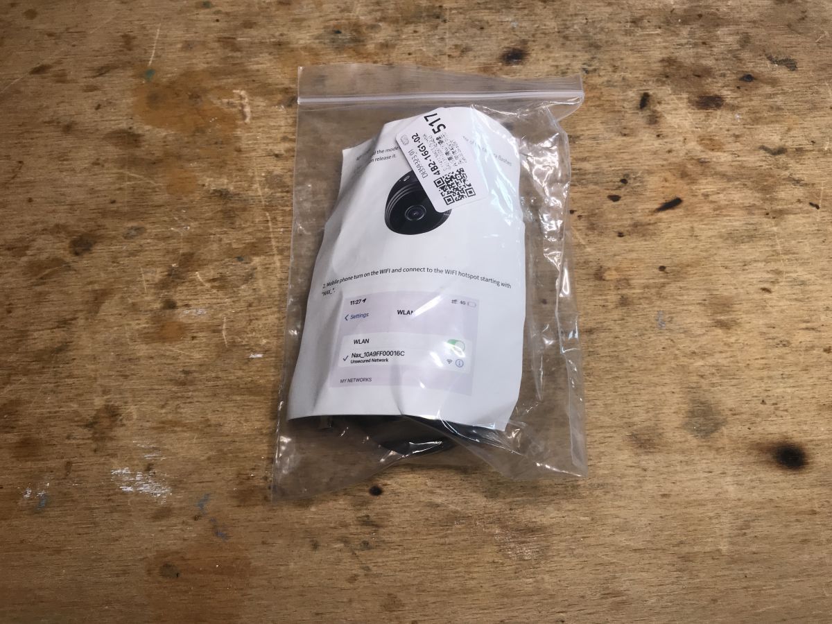

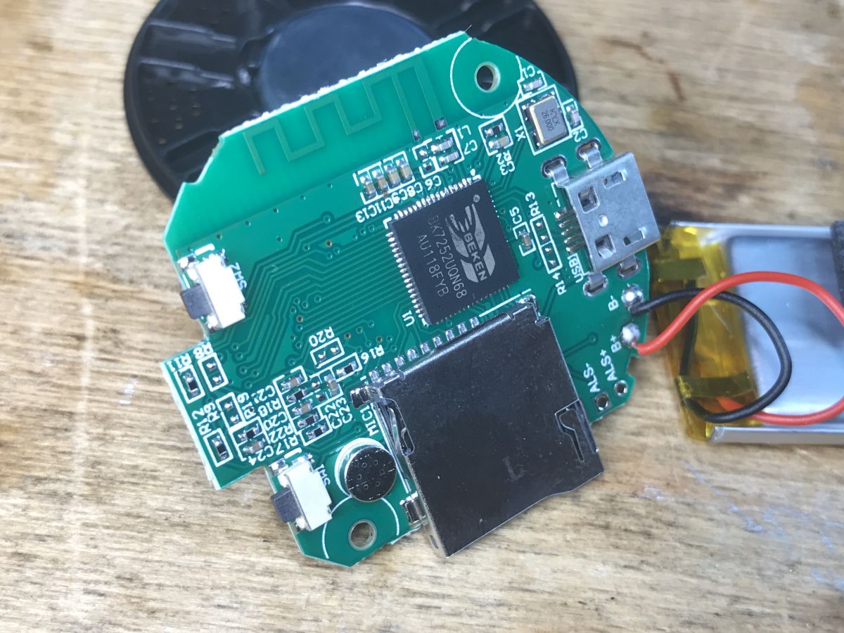

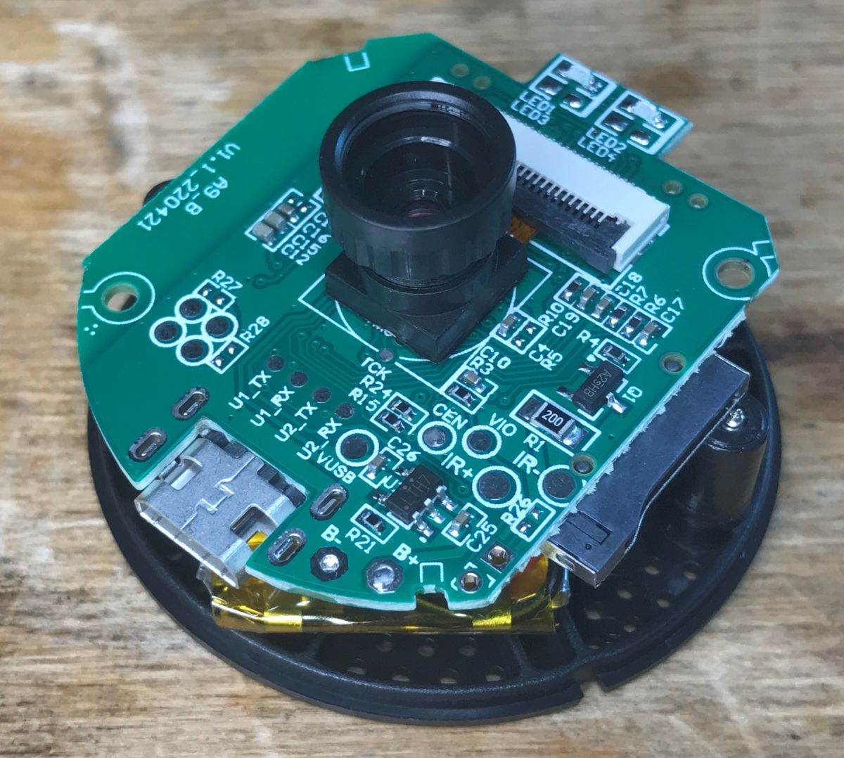

    Btw, the camera requested by some user about a month ago just arrived. It's time to hack some things!
    A9 Mini camera, bought on ebay for 9$ (+4$ VAT).
    The postman just put the package into the mailbox, no receive confirmation. Cheapest shipping, took a long time.
    [BK7231T] My HTTP server, configurator, MQTT support from Home Assistant [BK7231T] My HTTP server, configurator, MQTT support from Home Assistant [BK7231T] My HTTP server, configurator, MQTT support from Home Assistant
    It's using BK7252.
    And I have a question to community... do anyone here have this camera??

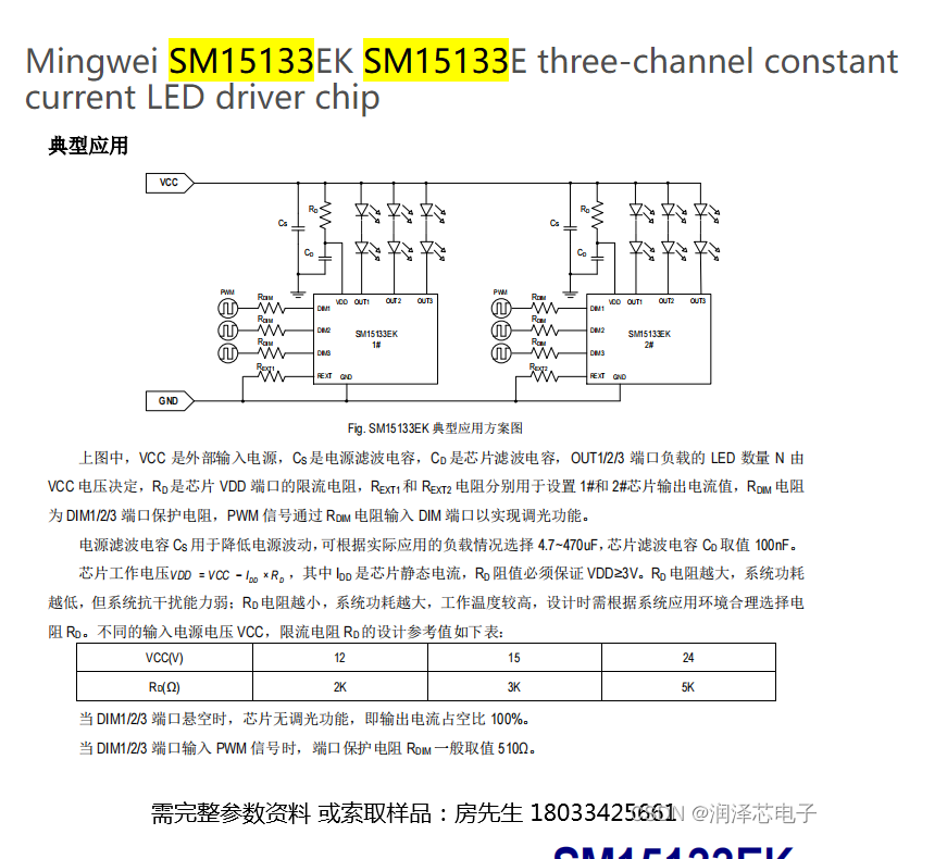

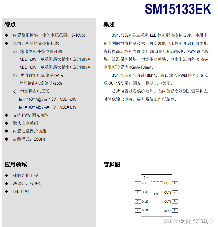

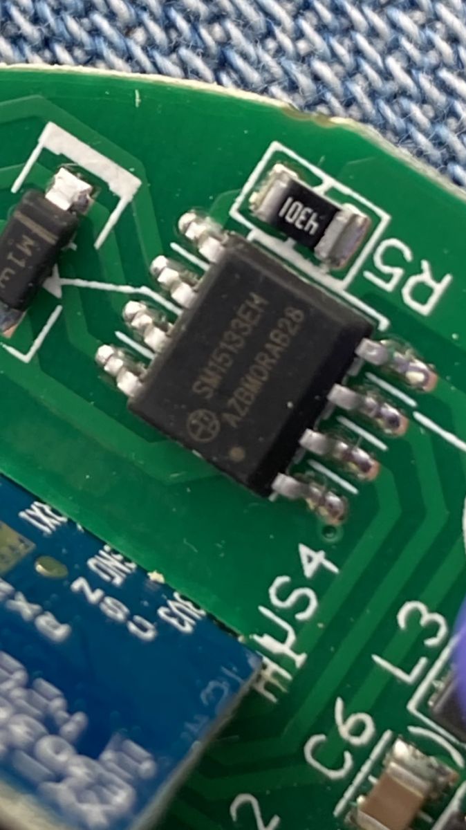

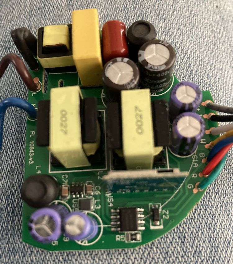

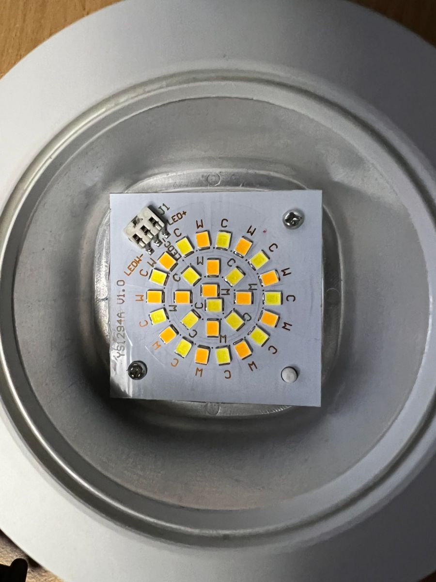

    Meanwhile I encountered another LED driver challenge... I've bought a couple of LSC RGBCW ceiling LED lights from the Action store. The article nr is 3007231. And the packaging looks like:
    Teardown is a breeze. There is a CB2S on there. While I expected a SM2135 LED driver, this is what I found:
    On this:
    I don't want to desolder the CB2S and use a ESP02S if there is a chance there will be a driver available for the OpenBK firmware any time soon... I tried the SM2135 driver but this 'obviously' didn't work. I googled SM15133 but could not find much (other than some Chinese) information.

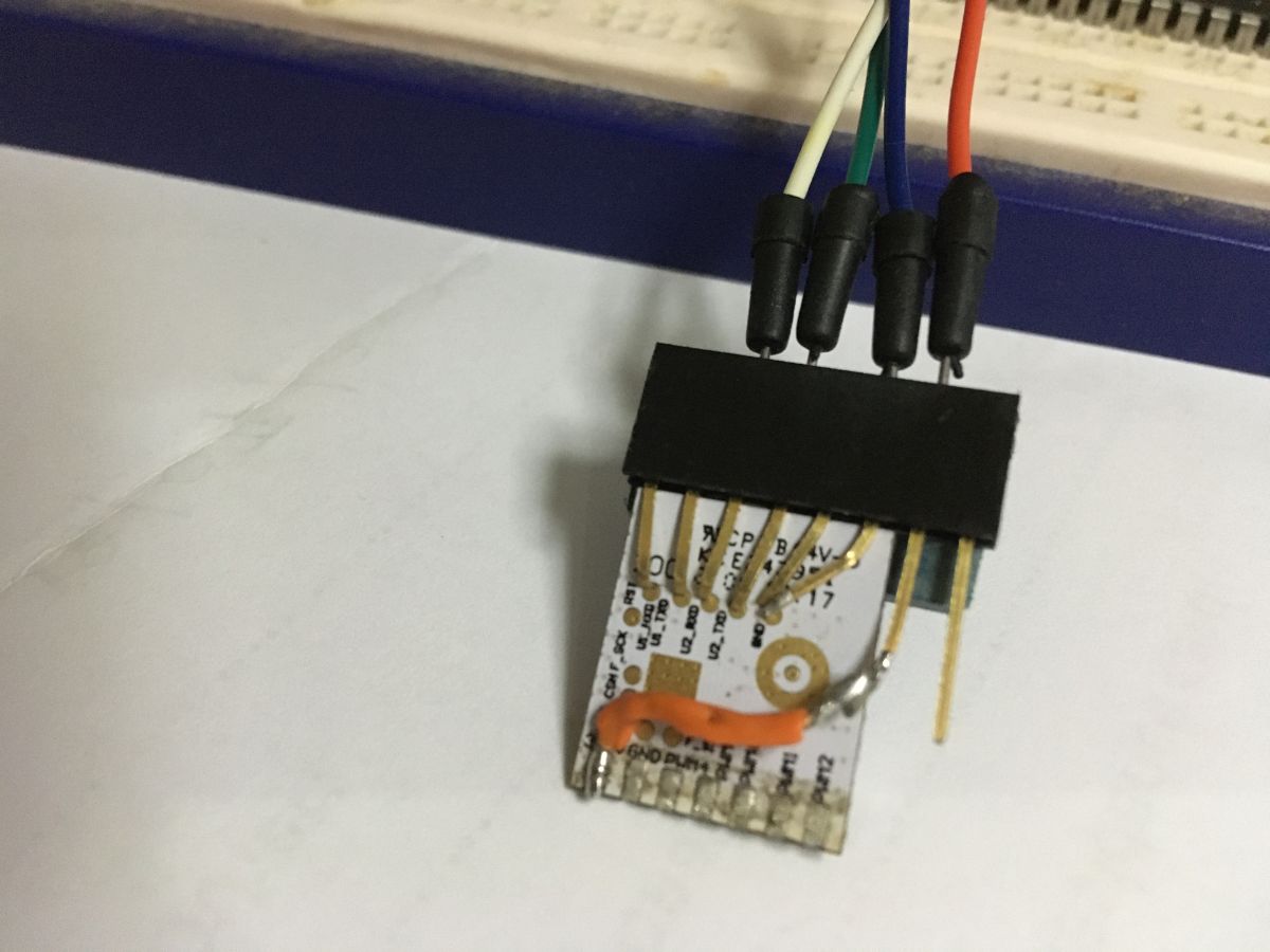

    BTW: I struggled flashing the BK7231N (CB2S) using my MacBook using python (hid_download_py), couldn't 'get bus' or 'set baud rate failed'... it never worked. While the python script worked like a charm on any BK7231T thus far. Sadly enough :) , a Windows machine flashed the CB2S perfectly.

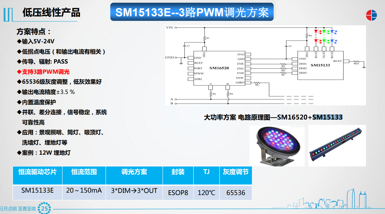

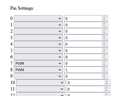

    Ok, regarding SM15133....
    I'd rather say it's a simple PWM-based driver. Have you tried controlling it by PWMs?
    Still, it's a rather interesting finding! Feel free to post the config, photos, and datasheet in our teardowns section when you get it working.

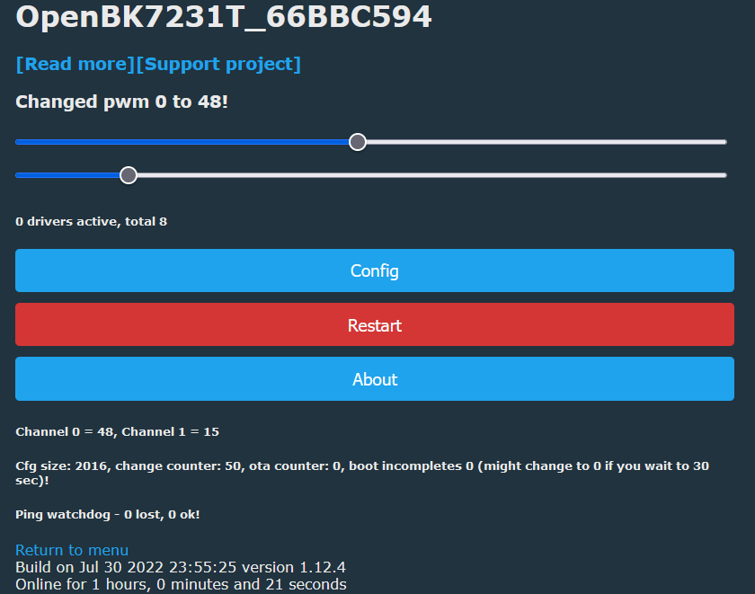

    Oops you're right. I didn't even tried to control it with PWM's. So yes, works just fine by settings 6,7,8,24,26 to PWM. I'll post a teardown, even though is very easy/basic.

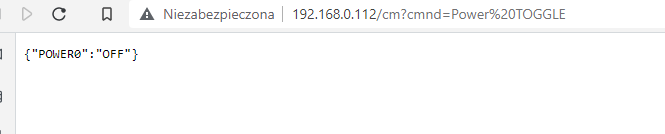

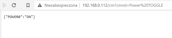

    Hi p.kaczmarek2 ... new weekend, new fight :-)
    Did you take a decision about the modification of the commands to make them tasmota compatible? these are enough to start...
    http://ipaddress/cm?cmnd=Status%208 (power consumption)
    http://ipaddress/cm?cmnd=Power (status of the relay)
    http://ipaddress/cm?cmnd=Power%20On (on)
    http://ipaddress/cm?cmnd=Power%20off (off)
    http://ipaddress/cm?cmnd=Power%20TOGGLE

    To be honest, those commands were already support for months:
    xostia wrote:
    It's just they always returned invalid JSON string.
    Still, I have updated them to return a bit more correct json now.

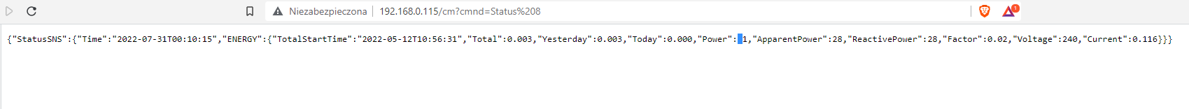

    xostia wrote:
    As for that, ok, but power factor now always returns 0:
    Please check all new features, and tell me if there is anything to improve or any more commands to add. Futhermore, please specify the expected command return value as well.

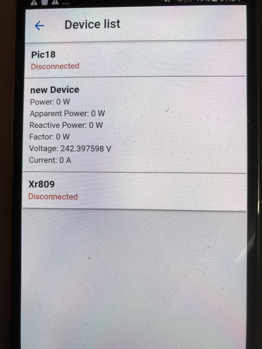

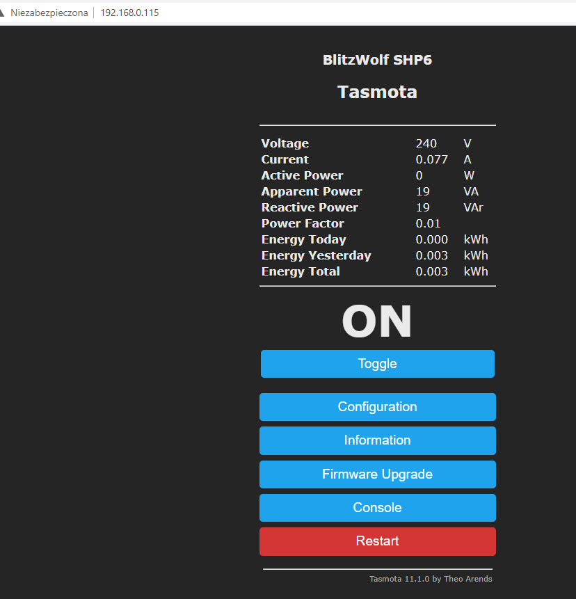

    Thank you @p.kaczmarek2... faster impossible :-)
    ON, OFF and Toggle works! ... great! but the answer is different in TASMOTA. For example, with the "Power on" command:
    Tasmota answers:
    OpenBK answers:
    Probably Tasmota check if there is only one relay and, in this case does not answer with a number after "POWER" string. It is interestint to note that, in your case, the answer was POWER0 and in my LSPA9 the answer is POWER1. They are details but for compatibility can be important.
    In the case of the "Status 8" command, there are less information (no date and time... for example, normal in this stage) but both behave practically the same in JSON... with one small difference, you added one space after Power and ApparentPower, I understand that JSON is also valid:
    I think that is a good practice to provide the same fields and the same name... and if there is some missing info, that field will not appear, that is good.
    Resuming: except the detail with POWER, POWER0, POWER1, the rest behaves the same.
    It is funny, because now "Tasmotrol", an app for Android, detects both OpenBK devices but it asks for user and password and it does not want to add their profiles (it does detect the tasmota devices... they are also without password but in this case it adds the profiles and the devices can me controlled). I do not know what kind of connection Tasmotrol tryes or the commands used to behave like this.

    Hey @xostia , regarding Tasmota Control app, I used to make a PIC18F67J60 compatible smart home driver for that once in the past, have you seen my article?
    https://www.elektroda.com/rtvforum/topic3789324.html
    We can both refer to my old work to see what's required by that app.
    altough I must admit, I had a bit more free time back then!
    Thanks for the great analysis. I will try to implement the fixes you mentioned, but keep in mind that you could also do that by submitting a pull request.
    The Power0/Power1 with digit will be stripped now if there is a single relay.
    The Power0/Power1 difference comes from the relay indexing in pins configuration, some people set index 1 for the first relay and some people start with 1.
    EDIT: some fixes added to repo
    EDIT: wait, my Tasmota device returns the string with spaces as well:
    I'd rather say that I didn't add any spaces, I just copy-pasted Tasmota JSON as above and it already had spaces, hmm

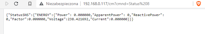

    Yes, exactly, I just found the same bug as I am now testing it with my power metering plugs.
    It should be fixed already.
    I will look into full status string next.
    For reference, this is what worked for my PIC18F67J60 compatible with Tasmota Control as a return value for generic STATUS command:
    {"Status":{"Module":0,"DeviceName":"Tasmota","FriendlyName":["Tasmota","Tasmota2","Tasmota3","Tasmota4"],"Topic":"tasmota_EC3F8F","ButtonTopic":"0","Power":0,"PowerOnState":3,"LedState":1,"LedMask":"FFFF","SaveData":1,"SaveState":1,"SwitchTopic":"0","SwitchMode":[0,0,0,0,0,0,0,0],"ButtonRetain":0,"SwitchRetain":0,"SensorRetain":0,"PowerRetain":0},"StatusFWR":{"Version":"0.1(pic18f)","BuildDateTime":"2020-11-07T11:57:45","Boot":6,"Core":"0","SDK":"0","CpuFrequency":80,"Hardware":"ESP8266EX","CR":"367/699"},"StatusNET":{"Hostname":"tasmota_EC3F8F-8079","IPAddress":"192.168.0.50","Gateway":"192.168.0.1","Subnetmask":"255.255.255.0","DNSServer":"192.168.0.1","Mac":"5C:CF:7F:EC:3F:8F","Webserver":2,"WifiConfig":4,"WifiPower":17.0},"StatusSNS":{"Time":"2021-01-10T19:27:53","DS18B20":{ "Temperature":16},"TempUnit":"C"},"StatusSTS":{"Time":"2021-01-10T19:27:54","Uptime":"0T00:41:19","UptimeSec":2479,"Heap":24,"SleepMode":"Dynamic","Sleep":50,"LoadAvg":37,"MqttCount":0,"POWER1":"OFF","POWER2":"OFF","POWER3":"OFF","POWER4":"OFF","Wifi":{"AP":1,"SSId":"5G_FULL_POWER","BSSId":"30:B5:C2:5D:70:72","Channel":9,"RSSI":98,"Signal":-51,"LinkCount":1,"Downtime":"0T00:00:03"}}}
    (4 relays and temperature sensor)
    And this is what my Tasmota BW-SHP6 returns:
    {"Status":{"Module":0,"DeviceName":"Tasmota","FriendlyName":["Tasmota"],"Topic":"tasmota_48E7F3","ButtonTopic":"0","Power":1,"PowerOnState":3,"LedState":1,"LedMask":"FFFF","SaveData":1,"SaveState":1,"SwitchTopic":"0","SwitchMode":[0,0,0,0,0,0,0,0],"ButtonRetain":0,"SwitchRetain":0,"SensorRetain":0,"PowerRetain":0,"InfoRetain":0,"StateRetain":0}}
    (single switch only)
  • Status 8 and status currently return the same data
    #829 20123022
    xostia
    Posts: 14
    OK, Perfect
    Right now, there is no difference in your implementation between "Status 8" and "Status". The first one should show the Power/Current/etc... the generic Status shows different information (name, friendly name, power status 1/9, etc).
    Probably it is how you explain... status is the command used by the Android App to identify the device. The extrange thing is that right now it detects it in the network... but as protected with user and password.

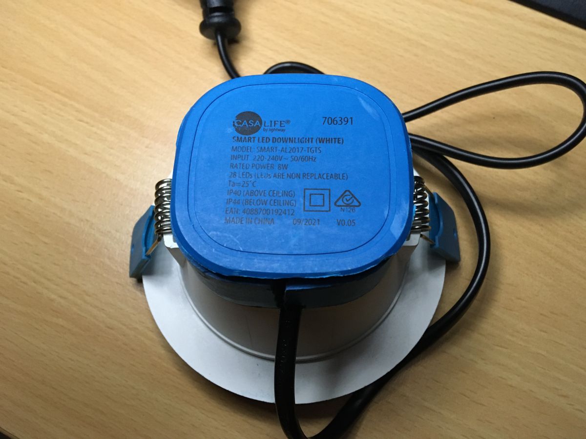

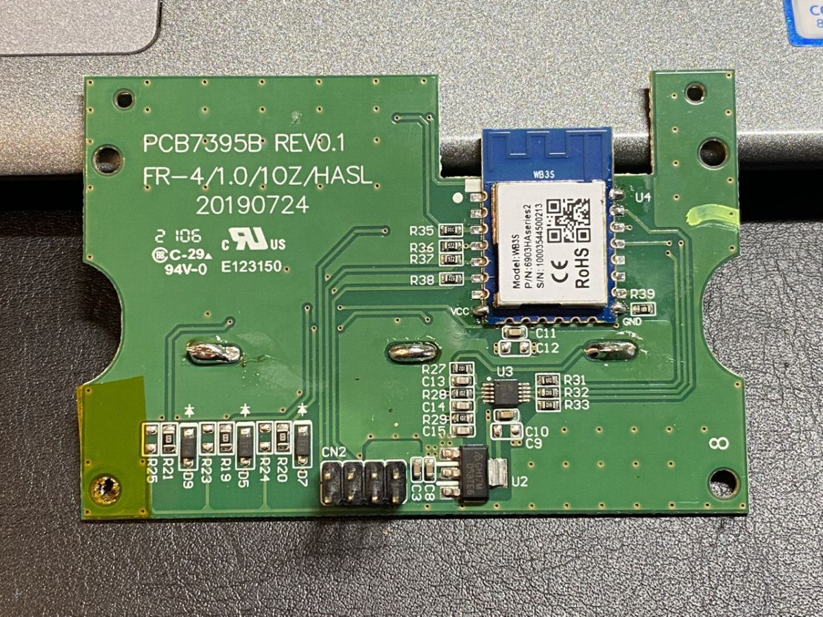

  • WB2L downlight flashed and PWM mapped for CCT control
    #832 20123466
    ilengyel
    Posts: 20
    Rate: 9

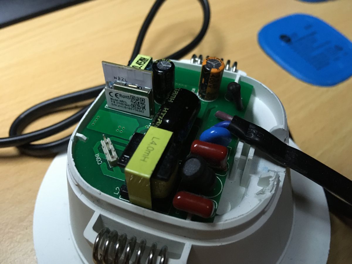

    Hello, Thanks for the great project. I have successfully flashed a WB2L based downlight
    CasaLife Smart LED Downlight
    These LED downlights were sold by ALDI Australia in 2 flavours: RGBCW and CW/WW. This one is the Cool/Warm white downlight. Some pictures:
    [BK7231T] My HTTP server, configurator, MQTT support from Home Assistant [BK7231T] My HTTP server, configurator, MQTT support from Home Assistant [BK7231T] My HTTP server, configurator, MQTT support from Home Assistant [BK7231T] My HTTP server, configurator, MQTT support from Home Assistant
    I de-soldered the WB2L module and flashed it with a single CP2104 USB to UART module, as per instructions in the previous thread.
    After setting up the config as such:
    P7/Channel 0/PWM1 Controls the colour temperature with values 0(warm) - 100(cool)
    P8/Channel 1/PWM2 Controls the brightness with values 0 - 100 as a percentage
    Because of this, it is recommended to enable "Flag 3 -[LED][Debug] Show raw PWM controller on WWW index instead of new LED RGB/CW/etc picker" in the Configure General section.
    Let me know if you would like any other info on this downlight.

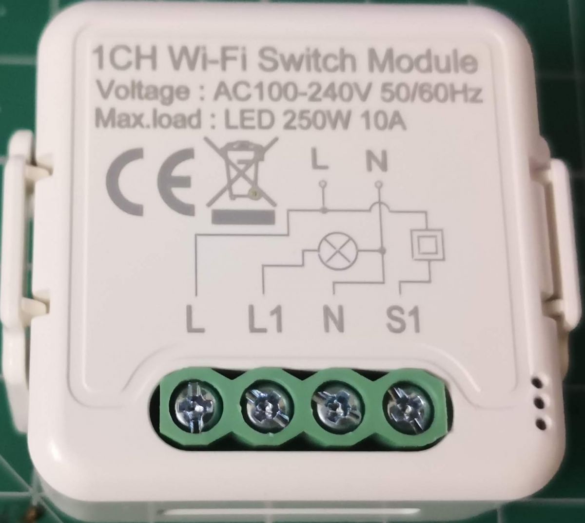

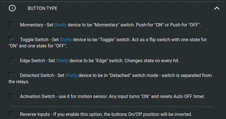

    1) How can I set relay status and countdown without TuyaMCU from home assistant?
    2) What is the option to enable switch_inching?
    I have this Tuya wifi switch module (BK7231N)
    When S1 is connect to L, the relay is not toggled, I need to connect and disconnect S1 immediately to toggle the relay, Is there a way to add button type options what you get in Shelly devices?
    Current firmware:
    Build on Aug 4 2022 13:01:05 version 1.12.10
    Added after 14 [minutes]:
    In the logs I get "key_long_press_hold" when S1 is always connected to L
  • ToggleChannelOnToggle switch kind suggested for pins config
    #839 20129840
    Posts: 14724
    Rate: 12807
    @marioalmeida once a channel is mapped to TuyaMCU dpID, then you can just toggle a channel on gui and it will toggle on tuyaMCU
    If you don't have a channel displayed on WWW panel, then you can do:
    setChannelType 2 Toggle
    etc, etc
    @marioalmeida I think the switch kind you are looking for is called "ToggleChannelOnToggle",, it's already supported, set it in pins config. Can you check if that's what you need?

    @p.kaczmarek2, yes ToggleChannelOnToggle worked
    setPinRole 8 TglChanOnTgl
    What is the cmd to set new start value for a channel? I need change "For 'remember last power state', use -1 as a special value" via MQTT
