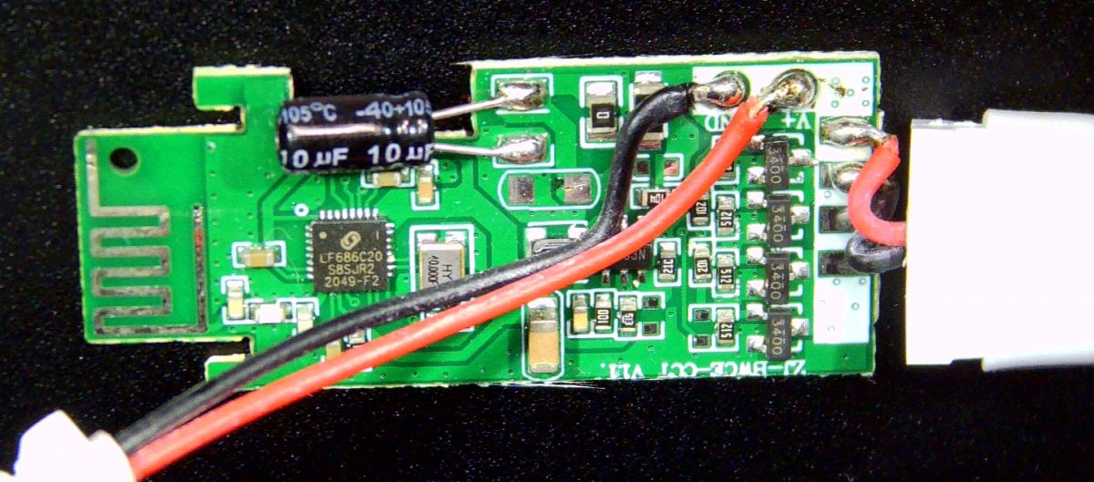

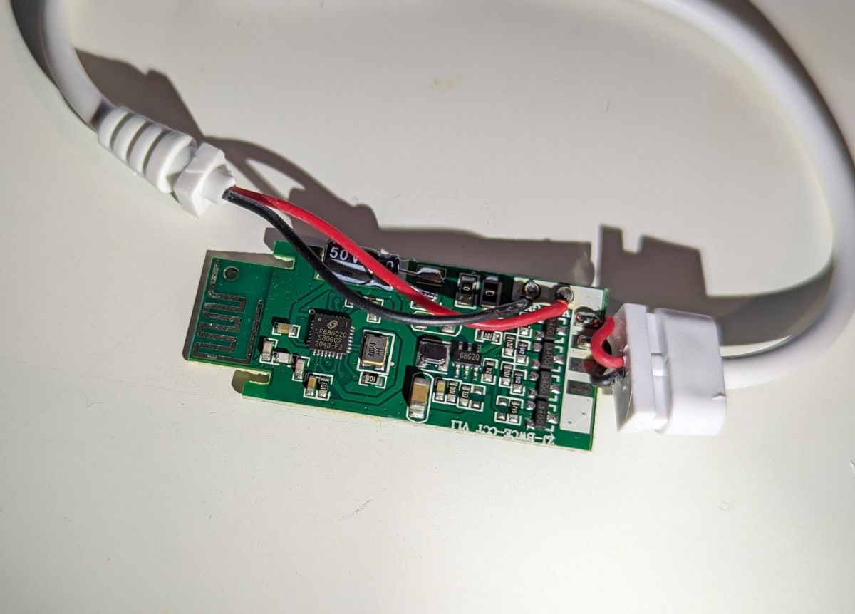

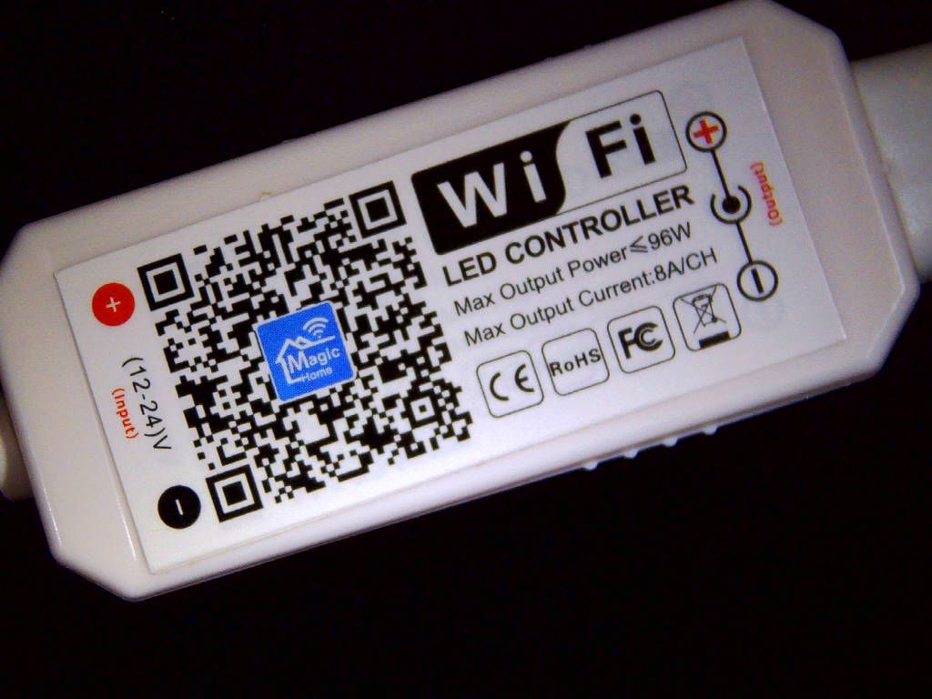

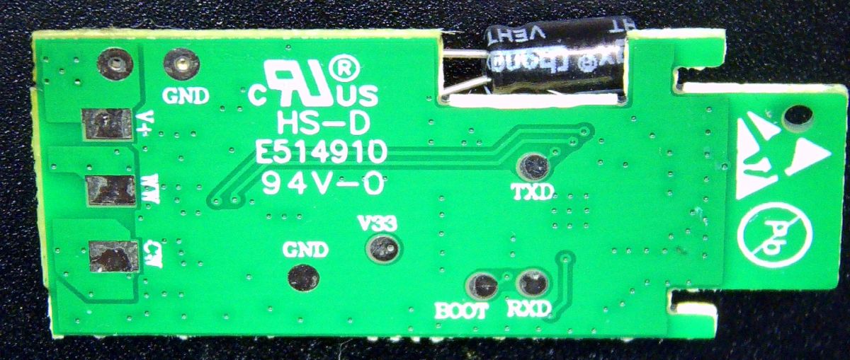

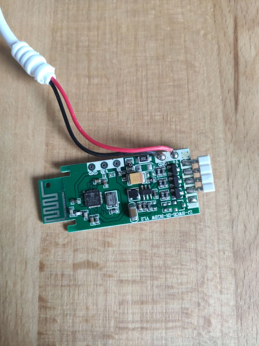

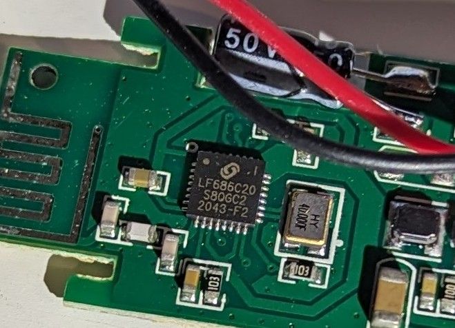

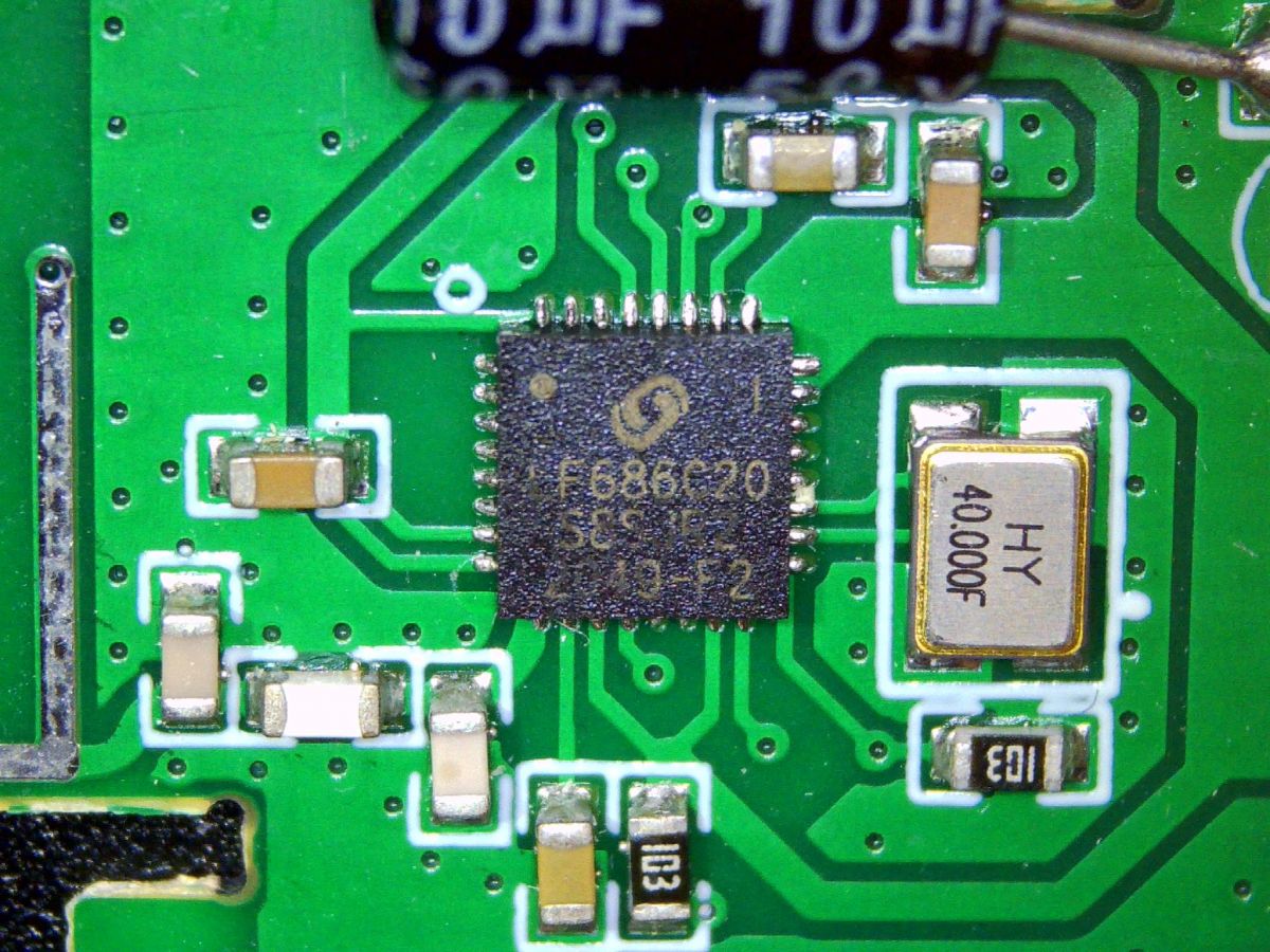

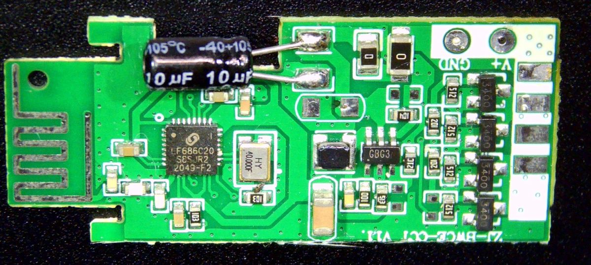

    Managed to flash a Magic Home 1 channel LED controller quite easily.
    Contains the LF686 chip. Flashed as BL602.
    Pin 20 is the output pin for controlling the output.
    Integrated easily with Home Assistant much like OpenBK on many other devices I have.
    Single-channel Magic Home LED controller with LF686 chip on a green circuit board. Close-up of an electronic board with LF686C20 chip and connected wires. Close-up of a circuit board with wires connected for programming a Magic Home LED controller.

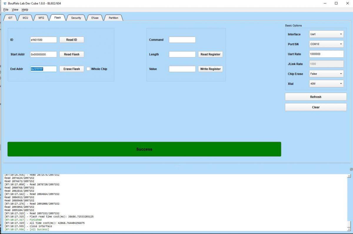

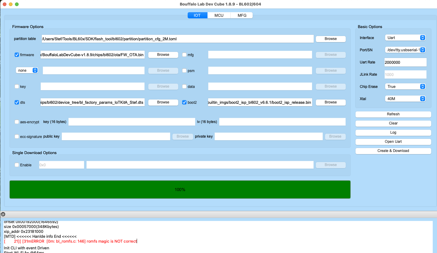

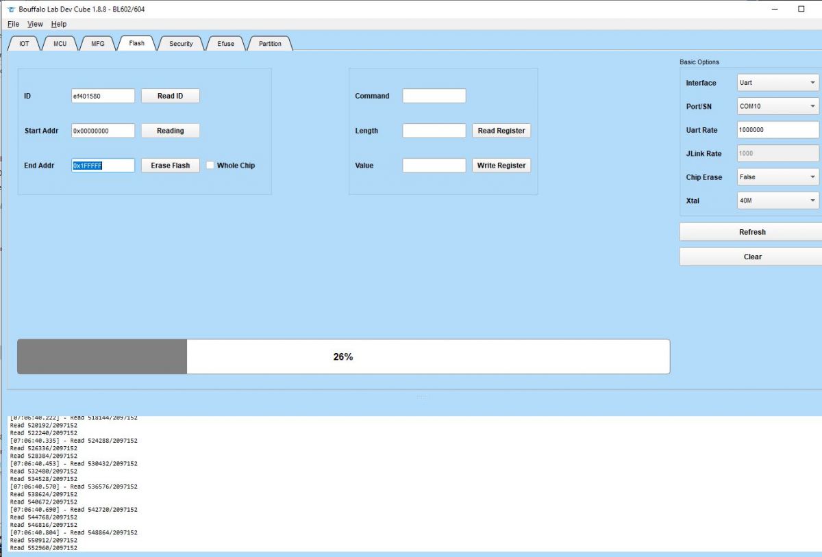

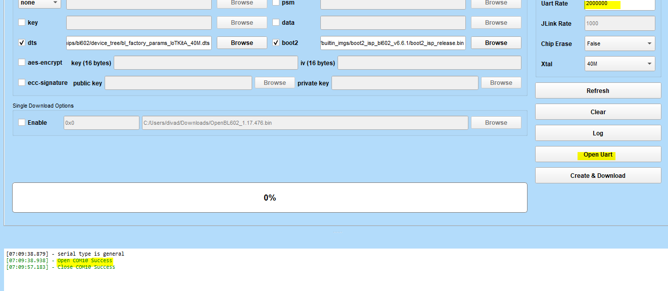

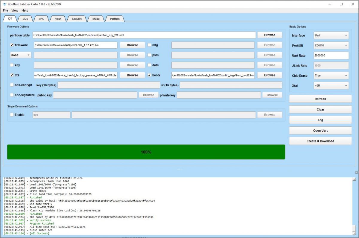

    @mjleonard @p.kaczmarek2 did you ever find a solution for "bl_romfs.c: 146] romfs magic is NOT correct"?
    I've a SM-028_V1.3 from a 16a mini DIY breaker that's flashing fine in DevCube 1.8.8/9 (old 1.4.8 JEDEC ID error - doesn't recognise newer flash inside BL602?)
    This is my boot log. It loops. I am using an external XL4015 PSU set at 1A max and 3.45V. I've also soldered it back into original device but no AP.
    boot log (this is trying older OpenBLbuild. same with latest)

    [        43][ERROR : bl_romfs.c: 146] romfs magic is NOT correct

    flash ID log
    [06:57:13.889] - Version: eflash_loader_v2.4.8
    [06:57:13.891] - Program Start
    [06:57:13.891] - ========= eflash loader cmd arguments =========
    [06:57:13.893] - Config file: C:\Users\divad\Documents\!FLASHED!\BouffaloLabDevCube-v1.8.8\chips\bl602\eflash_loader\eflash_loader_cfg.ini
    [06:57:13.894] - serial port is COM10
    [06:57:13.895] - cpu_reset=False
    [06:57:13.896] - chiptype: bl602
    [06:57:13.898] - ========= Interface is uart =========
    [06:57:13.899] - com speed: 1000000
    [06:57:13.900] - Eflash load helper file: C:\Users\divad\Documents\!FLASHED!\BouffaloLabDevCube-v1.8.8\chips\bl602\eflash_loader/eflash_loader_40m.bin
    [06:57:13.902] - ========= load eflash_loader.bin =========
    [06:57:13.902] - Load eflash_loader.bin via uart
    [06:57:13.903] - ========= image load =========
    [06:57:14.136] - Not ack OK
    [06:57:14.137] - FL
    [06:57:14.137] - result: FL
    [06:57:14.415] - tx rx and power off, press the machine!
    [06:57:14.416] - cutoff time is 0.1
    [06:57:14.523] - power on tx and rx
    [06:57:15.332] - reset cnt: 0, reset hold: 0.005, shake hand delay: 0.1
    [06:57:15.333] - clean buf
    [06:57:15.336] - send sync
    [06:57:15.551] - ack is 4f4b
    [06:57:15.599] - shake hand success
    [06:57:15.615] - get_boot_info
    [06:57:15.624] - data read is b'01000000000000000300000097040b29d8ac1c00'
    [06:57:15.625] - ========= chipid: acd8290b0497 =========
    [06:57:15.625] - last boot info: None
    [06:57:15.625] - sign is 0 encrypt is 0
    [06:57:15.626] - segcnt is 1
    [06:57:15.656] - segdata_len is 38512
    [06:57:15.752] - 4080/38512
    [06:57:15.848] - 8160/38512
    [06:57:15.944] - 12240/38512
    [06:57:16.039] - 16320/38512
    [06:57:16.136] - 20400/38512
    [06:57:16.231] - 24480/38512
    [06:57:16.328] - 28560/38512
    [06:57:16.423] - 32640/38512
    [06:57:16.519] - 36720/38512
    [06:57:16.567] - 38512/38512
    [06:57:16.583] - Run img
    [06:57:16.714] - Load helper bin time cost(ms): 2811.795166015625
    [06:57:16.824] - Flash load shake hand
    [06:57:16.837] - default set DTR high
    [06:57:16.948] - clean buf
    [06:57:16.951] - send sync
    [06:57:17.170] - ack is 4f4b
    [06:57:17.216] - Read mac addr
    [06:57:17.223] - macaddr: 97040b29d8ac
    [06:57:17.224] - flash set para
    [06:57:17.224] - ========= flash read jedec ID =========
    [06:57:17.239] - Read flash jedec ID
    [06:57:17.240] - flash jedec id: ef401580
    [06:57:17.241] - Finished
    [06:57:17.246] - get flash size: 0x00200000
    [06:57:17.247] - ========= flash read jedec ID =========
    [06:57:17.255] - Read flash jedec ID
    [06:57:17.255] - flash jedec id: ef401580
    [06:57:17.257] - Finished
    other info. i've used old and new boot2, partition table and dts files. and I've tried flashing, successfully, with blflash. I also compiled the forked blflash from https://github.com/feilongfl/blflash and flashed with that. I've also performed whole chip erase.
    Screenshot of the Bouffalo Lab Dev Cube interface showing firmware configuration options and flash operation log. Bouffalo Lab Dev Cube interface with flash memory reading. Bouffalo Lab Dev Cube 1.8.8 software interface with flash memory readout.
  • Need BL602 flashing failure diagnosis

    ChrizZz
    Posts: 10
    Small printed circuit board with various electronic components on a wooden surface.
    This is the chip - how do I see if 1mb or 2mb?

  • Device disappears after joining configured Wi‑Fi
    #402 20994509
    pa66
    Hi,
    today I have flashed magic home rgb controller with BL602. Flashing was okay, AP is okay. If I set my own network and password, I do not see the device in Fritzbox. Also I do not see this device with a network analycer app.
    Also I have try to change Mac adress before changing network.
    I have also set option erase chip...same problem.
    I used OpenBL602_1.17.494.bin with devcube 1.4.8 and also with 1.8.9
    Any idea whats the problem?
    best regards
  • #403 20994571
    Zhekos555
    Posts: 8
    I had the same problem with bl-xt02 modules, just not booting up, was asking here but didn't get the answer. External power supply was used, flashed different sw and chip worked. So the problem with openbeken.
  • #404 20994679
    pa66
    now Device is in APMode..if I press Log in devcube I get:
    {"ErrorCode": "0001","ErrorMsg":"BFLB EFLASH LOADER SHAKEHAND FAIL"}
    [19:34:42.688] - Shake hand redo
    [19:34:43.236] - FL4d69 unknown
    [19:34:43.236] - Not ack OK
    [19:34:43.236] - Read log
    [19:34:43.236] - Read Fail
    Edit: btw If I try to search Network nothing happens...so I always try to fill in manually my network.

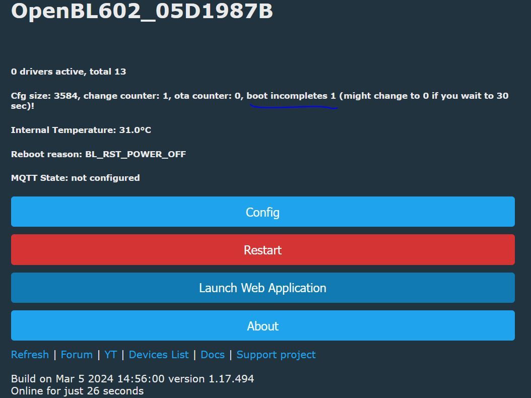

  • Boot incomplete after Wi-Fi setup on BL602L20
    #406 20997238
    pa66
    Hi,
    I have short cables directly to USB-TTL and 10k resistor.
    Also I have tried extern Power suply and Power from USB-TLL (3,3V)
    Both flashing is successful and i get Access Point. But after I enter wifi nothing happens. (access point is closing).
    Chip is BL602L20
    Should I send any logs? If yes, I need instuction how to ;-)
    Edit: Today I have tried to flash with another Laptop (win10). same result.
    Screenshot of the OpenBL602 software interface showing a boot error message.
    Always I get boot is incomplete.
  • Dev Cube flash log for BL602 image creation

    [11:11:31.504] - Load 30720/405176 {"progress":7}
    [11:11:31.544] - Load 32768/405176 {"progress":8}
    [11:11:31.591] - Load 34816/405176 {"progress":8}
    [11:11:31.637] - Load 36864/405176 {"progress":9}
    [11:11:31.675] - Load 38912/405176 {"progress":9}
    [11:11:31.722] - Load 40960/405176 {"progress":10}
    [11:11:31.760] - Load 43008/405176 {"progress":10}
    [11:11:31.807] - Load 45056/405176 {"progress":11}
    [11:11:31.844] - Load 47104/405176 {"progress":11}
    [11:11:31.891] - Load 49152/405176 {"progress":12}
    [11:11:31.944] - Load 51200/405176 {"progress":12}
    [11:11:31.976] - Load 53248/405176 {"progress":13}
    [11:11:32.022] - Load 55296/405176 {"progress":13}
    [11:11:32.060] - Load 57344/405176 {"progress":14}
    [11:11:32.107] - Load 59392/405176 {"progress":14}
    [11:11:32.160] - Load 61440/405176 {"progress":15}
    [11:11:32.192] - Load 63488/405176 {"progress":15}
    [11:11:32.245] - Load 65536/405176 {"progress":16}
    [11:11:32.292] - Load 67584/405176 {"progress":16}
    [11:11:32.323] - Load 69632/405176 {"progress":17}
    [11:11:32.377] - Load 71680/405176 {"progress":17}
    [11:11:32.424] - Load 73728/405176 {"progress":18}
    [11:11:32.461] - Load 75776/405176 {"progress":18}
    [11:11:32.508] - Load 77824/405176 {"progress":19}
    [11:11:32.546] - Load 79872/405176 {"progress":19}
    [11:11:32.593] - Load 81920/405176 {"progress":20}
    [11:11:32.640] - Load 83968/405176 {"progress":20}
    [11:11:32.677] - Load 86016/405176 {"progress":21}
    [11:11:32.724] - Load 88064/405176 {"progress":21}
    [11:11:32.777] - Load 90112/405176 {"progress":22}
    [11:11:32.809] - Load 92160/405176 {"progress":22}
    [11:11:32.862] - Load 94208/405176 {"progress":23}
    [11:11:32.909] - Load 96256/405176 {"progress":23}
    [11:11:32.946] - Load 98304/405176 {"progress":24}
    [11:11:32.993] - Load 100352/405176 {"progress":24}
    [11:11:33.040] - Load 102400/405176 {"progress":25}
    [11:11:33.078] - Load 104448/405176 {"progress":25}
    [11:11:33.125] - Load 106496/405176 {"progress":26}
    [11:11:33.162] - Load 108544/405176 {"progress":26}
    [11:11:33.209] - Load 110592/405176 {"progress":27}
    [11:11:33.246] - Load 112640/405176 {"progress":27}
    [11:11:33.293] - Load 114688/405176 {"progress":28}
    [11:11:33.346] - Load 116736/405176 {"progress":28}
    [11:11:33.378] - Load 118784/405176 {"progress":29}
    [11:11:33.425] - Load 120832/405176 {"progress":29}
    [11:11:33.478] - Load 122880/405176 {"progress":30}
    [11:11:33.509] - Load 124928/405176 {"progress":30}
    [11:11:33.562] - Load 126976/405176 {"progress":31}
    [11:11:33.609] - Load 129024/405176 {"progress":31}
    [11:11:33.646] - Load 131072/405176 {"progress":32}
    [11:11:33.693] - Load 133120/405176 {"progress":32}
    [11:11:33.740] - Load 135168/405176 {"progress":33}
    [11:11:33.778] - Load 137216/405176 {"progress":33}
    [11:11:33.825] - Load 139264/405176 {"progress":34}
    [11:11:33.862] - Load 141312/405176 {"progress":34}
    [11:11:33.909] - Load 143360/405176 {"progress":35}
    [11:11:33.962] - Load 145408/405176 {"progress":35}
    [11:11:33.993] - Load 147456/405176 {"progress":36}
    [11:11:34.046] - Load 149504/405176 {"progress":36}
    [11:11:34.093] - Load 151552/405176 {"progress":37}
    [11:11:34.124] - Load 153600/405176 {"progress":37}
    [11:11:34.178] - Load 155648/405176 {"progress":38}
    [11:11:34.209] - Load 157696/405176 {"progress":38}
    [11:11:34.262] - Load 159744/405176 {"progress":39}
    [11:11:34.309] - Load 161792/405176 {"progress":39}
    [11:11:34.347] - Load 163840/405176 {"progress":40}
    [11:11:34.394] - Load 165888/405176 {"progress":40}
    [11:11:34.441] - Load 167936/405176 {"progress":41}
    [11:11:34.478] - Load 169984/405176 {"progress":41}
    [11:11:34.525] - Load 172032/405176 {"progress":42}
    [11:11:34.562] - Load 174080/405176 {"progress":42}
    [11:11:34.609] - Load 176128/405176 {"progress":43}
    [11:11:34.663] - Load 178176/405176 {"progress":43}
    [11:11:34.694] - Load 180224/405176 {"progress":44}
    [11:11:34.747] - Load 182272/405176 {"progress":44}
    [11:11:34.794] - Load 184320/405176 {"progress":45}
    [11:11:34.826] - Load 186368/405176 {"progress":45}
    [11:11:34.879] - Load 188416/405176 {"progress":46}
    [11:11:34.926] - Load 190464/405176 {"progress":47}
    [11:11:34.964] - Load 192512/405176 {"progress":47}
    [11:11:35.011] - Load 194560/405176 {"progress":48}
    [11:11:35.048] - Load 196608/405176 {"progress":48}
    [11:11:35.095] - Load 198656/405176 {"progress":49}
    [11:11:35.142] - Load 200704/405176 {"progress":49}
    [11:11:35.180] - Load 202752/405176 {"progress":50}
    [11:11:35.227] - Load 204800/405176 {"progress":50}
    [11:11:35.264] - Load 206848/405176 {"progress":51}
    [11:11:35.311] - Load 208896/405176 {"progress":51}
    [11:11:35.359] - Load 210944/405176 {"progress":52}
    [11:11:35.401] - Load 212992/405176 {"progress":52}
    [11:11:35.447] - Load 215040/405176 {"progress":53}
    [11:11:35.485] - Load 217088/405176 {"progress":53}
    [11:11:35.532] - Load 219136/405176 {"progress":54}
    [11:11:35.570] - Load 221184/405176 {"progress":54}
    [11:11:35.617] - Load 223232/405176 {"progress":55}
    [11:11:35.664] - Load 225280/405176 {"progress":55}
    [11:11:35.702] - Load 227328/405176 {"progress":56}
    [11:11:35.749] - Load 229376/405176 {"progress":56}
    [11:11:35.802] - Load 231424/405176 {"progress":57}
    [11:11:35.833] - Load 233472/405176 {"progress":57}
    [11:11:35.887] - Load 235520/405176 {"progress":58}
    [11:11:35.918] - Load 237568/405176 {"progress":58}
    [11:11:35.971] - Load 239616/405176 {"progress":59}
    [11:11:36.018] - Load 241664/405176 {"progress":59}
    [11:11:36.049] - Load 243712/405176 {"progress":60}
    [11:11:36.103] - Load 245760/405176 {"progress":60}
    [11:11:36.149] - Load 247808/405176 {"progress":61}
    [11:11:36.187] - Load 249856/405176 {"progress":61}
    [11:11:36.234] - Load 251904/405176 {"progress":62}
    [11:11:36.272] - Load 253952/405176 {"progress":62}
    [11:11:36.318] - Load 256000/405176 {"progress":63}
    [11:11:36.365] - Load 258048/405176 {"progress":63}
    [11:11:36.403] - Load 260096/405176 {"progress":64}
    [11:11:36.450] - Load 262144/405176 {"progress":64}
    [11:11:36.488] - Load 264192/405176 {"progress":65}
    [11:11:36.535] - Load 266240/405176 {"progress":65}
    [11:11:36.573] - Load 268288/405176 {"progress":66}
    [11:11:36.620] - Load 270336/405176 {"progress":66}
    [11:11:36.667] - Load 272384/405176 {"progress":67}
    [11:11:36.704] - Load 274432/405176 {"progress":67}
    [11:11:36.751] - Load 276480/405176 {"progress":68}
    [11:11:36.789] - Load 278528/405176 {"progress":68}
    [11:11:36.835] - Load 280576/405176 {"progress":69}
    [11:11:36.889] - Load 282624/405176 {"progress":69}
    [11:11:36.920] - Load 284672/405176 {"progress":70}
    [11:11:36.973] - Load 286720/405176 {"progress":70}
    [11:11:37.021] - Load 288768/405176 {"progress":71}
    [11:11:37.052] - Load 290816/405176 {"progress":71}
    [11:11:37.105] - Load 292864/405176 {"progress":72}
    [11:11:37.152] - Load 294912/405176 {"progress":72}
    [11:11:37.190] - Load 296960/405176 {"progress":73}
    [11:11:37.237] - Load 299008/405176 {"progress":73}
    [11:11:37.274] - Load 301056/405176 {"progress":74}
    [11:11:37.321] - Load 303104/405176 {"progress":74}
    [11:11:37.368] - Load 305152/405176 {"progress":75}
    [11:11:37.406] - Load 307200/405176 {"progress":75}
    [11:11:37.453] - Load 309248/405176 {"progress":76}
    [11:11:37.491] - Load 311296/405176 {"progress":76}
    [11:11:37.537] - Load 313344/405176 {"progress":77}
    [11:11:37.575] - Load 315392/405176 {"progress":77}
    [11:11:37.622] - Load 317440/405176 {"progress":78}
    [11:11:37.675] - Load 319488/405176 {"progress":78}
    [11:11:37.706] - Load 321536/405176 {"progress":79}
    [11:11:37.753] - Load 323584/405176 {"progress":79}
    [11:11:37.791] - Load 325632/405176 {"progress":80}
    [11:11:37.838] - Load 327680/405176 {"progress":80}
    [11:11:37.891] - Load 329728/405176 {"progress":81}
    [11:11:37.922] - Load 331776/405176 {"progress":81}
    [11:11:37.975] - Load 333824/405176 {"progress":82}
    [11:11:38.022] - Load 335872/405176 {"progress":82}
    [11:11:38.054] - Load 337920/405176 {"progress":83}
    [11:11:38.107] - Load 339968/405176 {"progress":83}
    [11:11:38.154] - Load 342016/405176 {"progress":84}
    [11:11:38.191] - Load 344064/405176 {"progress":84}
    [11:11:38.238] - Load 346112/405176 {"progress":85}
    [11:11:38.276] - Load 348160/405176 {"progress":85}
    [11:11:38.322] - Load 350208/405176 {"progress":86}
    [11:11:38.376] - Load 352256/405176 {"progress":86}
    [11:11:38.407] - Load 354304/405176 {"progress":87}
    [11:11:38.454] - Load 356352/405176 {"progress":87}
    [11:11:38.507] - Load 358400/405176 {"progress":88}
    [11:11:38.539] - Load 360448/405176 {"progress":88}
    [11:11:38.592] - Load 362496/405176 {"progress":89}
    [11:11:38.639] - Load 364544/405176 {"progress":89}
    [11:11:38.676] - Load 366592/405176 {"progress":90}
    [11:11:38.723] - Load 368640/405176 {"progress":90}
    [11:11:38.755] - Load 370688/405176 {"progress":91}
    [11:11:38.808] - Load 372736/405176 {"progress":91}
    [11:11:38.855] - Load 374784/405176 {"progress":92}
    [11:11:38.892] - Load 376832/405176 {"progress":93}
    [11:11:38.939] - Load 378880/405176 {"progress":93}
    [11:11:38.977] - Load 380928/405176 {"progress":94}
    [11:11:39.024] - Load 382976/405176 {"progress":94}
    [11:11:39.071] - Load 385024/405176 {"progress":95}
    [11:11:39.108] - Load 387072/405176 {"progress":95}
    [11:11:39.155] - Load 389120/405176 {"progress":96}
    [11:11:39.193] - Load 391168/405176 {"progress":96}
    [11:11:39.240] - Load 393216/405176 {"progress":97}
    [11:11:39.277] - Load 395264/405176 {"progress":97}
    [11:11:39.324] - Load 397312/405176 {"progress":98}
    [11:11:39.377] - Load 399360/405176 {"progress":98}
    [11:11:39.409] - Load 401408/405176 {"progress":99}
    [11:11:39.456] - Load 403456/405176 {"progress":99}
    [11:11:39.493] - Load 405176/405176 {"progress":100}
    [11:11:39.493] - Write check
    [11:11:39.524] - Flash load time cost(ms): 9114.286376953125
    [11:11:39.540] - Finished
    [11:11:39.540] - Sha caled by host: 669d9ff97c68c57fc944c7c4530ac938bcaf20131da5638996bd93a08499385d
    [11:11:39.540] - xip mode Verify
    [11:11:39.756] - Read Sha256/760816
    [11:11:39.756] - Flash xip readsha time cost(ms): 216.021484375
    [11:11:39.756] - Finished
    [11:11:39.756] - Sha caled by dev: 669d9ff97c68c57fc944c7c4530ac938bcaf20131da5638996bd93a08499385d
    [11:11:39.756] - Verify success
    [11:11:39.756] - Dealing Index 4
    [11:11:39.756] - ========= programming chips\bl602\device_tree\ro_params.dtb to 0x001F8000
    [11:11:39.756] - ========= flash load =========
    [11:11:39.756] - decompress write rx timeout: 24.576
    [11:11:39.778] - decompress flash load 1584
    [11:11:39.810] - Load 1584/1584 {"progress":100}
    [11:11:39.810] - Write check
    [11:11:39.825] - Flash load time cost(ms): 69.203125
    [11:11:39.841] - Finished
    [11:11:39.841] - Sha caled by host: 2030ce2a98174d1e1bc02905472a5c55ff0df9d7274c49efd787982af2430e58
    [11:11:39.841] - xip mode Verify
    [11:11:39.841] - Read Sha256/5982
    [11:11:39.841] - Flash xip readsha time cost(ms): 0.0
    [11:11:39.841] - Sha caled by dev: 2030ce2a98174d1e1bc02905472a5c55ff0df9d7274c49efd787982af2430e58
    [11:11:39.841] - Verify success
    [11:11:39.841] - Program Finished
    [11:11:39.841] - All time cost(ms): 17949.369140625
    [11:11:39.957] - close interface
    [11:11:39.957] - [All Success]

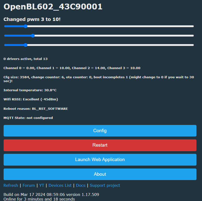

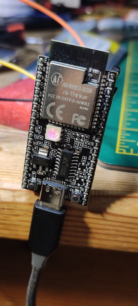

    just to add to the public record that this is the boot log of OBK flashed to a BL602 4mb dev board (http://www.ai-thinker.com/pro_view-113.html). powered by 5V USB-C. Flashed first time using BLDC 1.8.9, as you'd expect for a dev board. flash ID c8401680. perhaps useful to know what the log output from a BL602 NOT in a freed Tuya IOT device
    on-board RGB LED tested fine with
    "3": "PWM;3",
    "14": "PWM;1",
    "17": "PWM;2"
    BL602 AI-Thinker development board with a connected USB-C cable.
    Screenshot of the OpenBL602_43C90001 interface with PWM slider and Wi-Fi information.
    Added after 55 [minutes]:
    tell you what though, it's still a bit finicky. I did OTA to latest OBK and the AP didn't come back up. board was not boot looping.
    flashed again/erased/flashed but still no AP. flashed using BLDC 1.4.8 and now AP again. Maybe the key is to get it straight onto a network on first boot? Not sure why reflashing wouldn't wipe it clean though. or why 1.4.8 is any different.

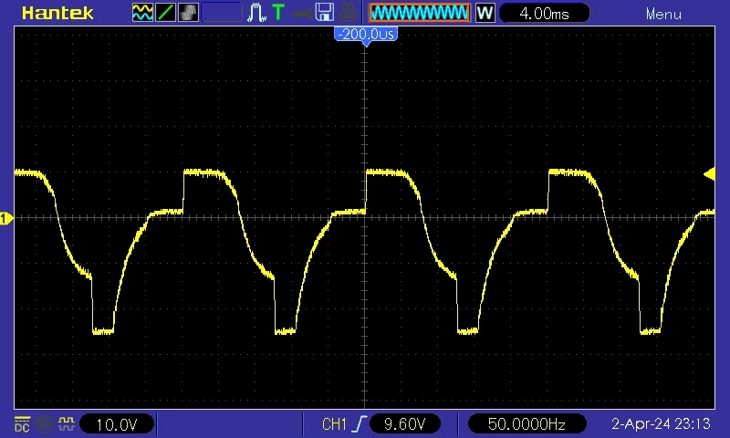

    #412 21029310
    Raufaser
    Posts: 47
    Rate: 16
    >>20969494
    I go the same device from aliexpress.
    WiFi LED controller with a QR code and specifications on the casing.
    That is how it is originally wired:
    PCB with electronic components, a capacitor, and wires.
    Better views of the PCB front and back:
    Close-up of a PCB with various electronic components. Close-up of the back side of a printed circuit board with markings.
    And a close up of the chip.
    Close-up of a PCB with F68C20 chip and electronic components.
    Flashed es BL602 without problems with Buffalo Lab Dev Cube 1.8.9

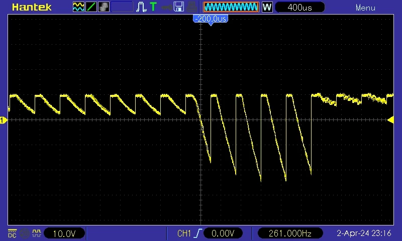

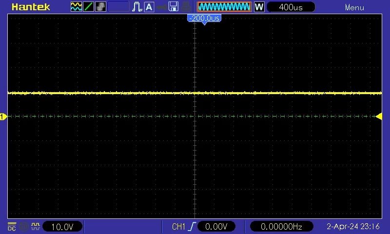

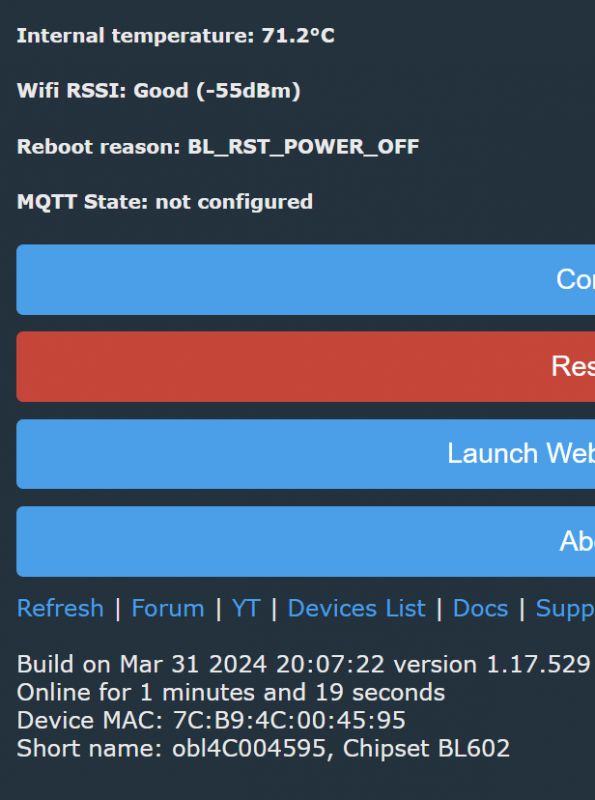

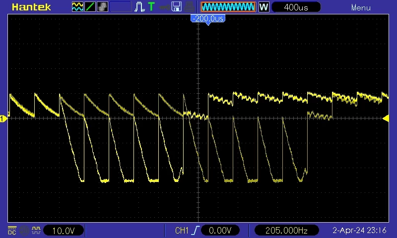

    But somehow my device acts weird. I connect it to a 10V DC power supply. Without doing anything it heats up pretty quickly above 70C
    Screenshot of a device interface indicating a high internal temperature of 71.2°C.
    This is what is see at the output on my scope:
    Tasmota replacement for BL602, programming, pairing with Home Assistant, now with OTA working!
    Where does that come from? It is not my power supply. That is true 10V DC.
    10V DC is what i get when i turn the dimmer on at 100%:
    At 50% i get this:
    At 0% this is what my scope shows:
    Any ideas?

  • Boot log reveals romfs magic error is factory firmware issue
    #414 21040960
    Posts: 5236
    Help: 450
    Rate: 919
    I hadn't realised that actually this error (?) is seen in the boot log of an untouched Tuya factory fw output, before OBK goes anywhere near it.
    https://www.elektroda.com/rtvforum/topic4024917-30.html#21040727
    So, does this make it part of the bootloader? either way, nothing to do with OBK.
    I've been harping on about this error for ages! 😳
    Added after 4 [minutes]:
    killah78 wrote:
    Is that a software thing, that can be fixed? All my other mini smart switches have a BK7231N and connect fine with WPA2+3 setting. And don'T know yet if I want to stick with WPA2 only mode.
    it can be fixed probably with newer SDK wifi driver updates, but I don't have the time or expertise currently. Not sure who else does.
    killah78 wrote:
    Second question: how can I show the boot log? When I tried with putty with 2m baudrate I got strange charcters only. Tried some other baudrates, but always showed rubbish.
    I mostly use the UART log display of BL Dev Cube itself for this. It seems better at interpreting characters than Putty for the BL602s
    User interface of software for programming a microcontroller with UART log.
  • #415 21055300

    I wanted to flash a Sonoff MiniR3 with the BL602 chip.
    After flashing with the current Bouffalo Lab Dev Cube 1.8.9
    and rebooting, the device falls into a boot loop and shows the error
    [ 21][ERROR : bl_romfs.c: 146] romfs magic is NOT correct
    Screenshot of Bouffalo Lab Dev Cube 1.8.9 software showing device flashing configuration and an error message.
    are you powering by USB-TTL or external PSU still at this point? I've had BL602 boot loop because of this but then is fine on normal device power.
    I don't believe this is anything to be concerned about. I've the same in at least 3 factory firmware boot log outputs - before OpenBeken touches the device. My realisation is only a few posts above https://www.elektroda.com/rtvforum/topic3889041-390.html#21040960
