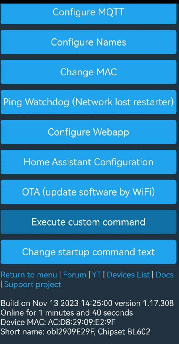

  • OpenBL602/OpenBeken ports Tasmota-style firmware to the BL602, letting closed IoT devices join Home Assistant over MQTT.
  • It flashes the chip through a USB-to-UART adapter and BLDevCube, then exposes an OpenBL602 access point for Tasmota-like Wi‑Fi, pin, and MQTT setup.
  • Compilation required the older BL IoT SDK commit b3898a520d6e5a34a5f4de8241fcc1c1d3b071b9, because the latest GitHub SDK would not build correctly.
  • The BL602 RGB strip controller worked in Home Assistant, and OTA is reported working, with the strip driven by three PWM outputs.
  • Limitations include no IR-remote support yet, Home Assistant not restoring brightness or color after restart, and a programming warning about disconnecting external power.

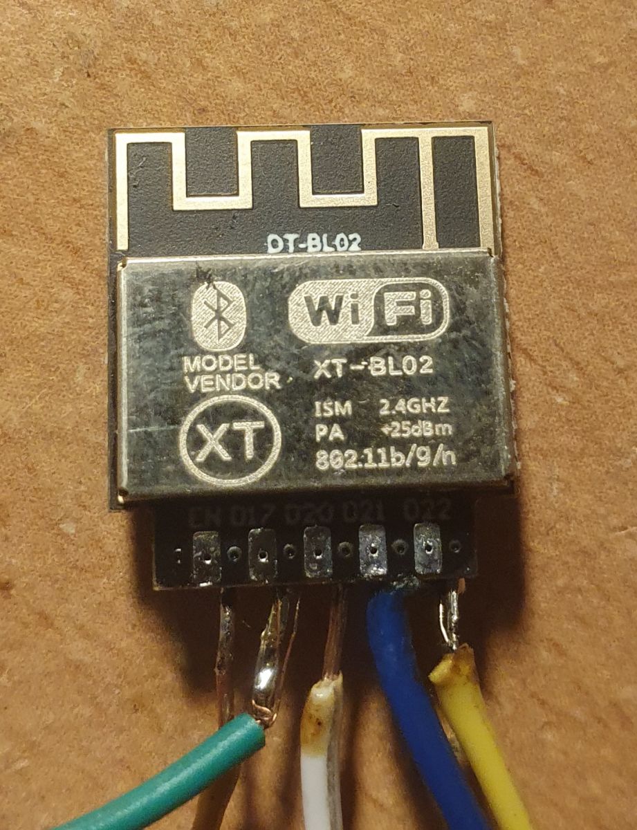

    Was anyone able to flash openbeken to chip xt-bl02? Tried bldevcube latest version and blflash, as result no boot. On boot external power jumps to 0.02amps for a second and then to 0.00. Tried all , chip not booting, any experience?
    WiFi module XT-BL02 with visible wire connections.
  • #364 20823704
    Posts: 14770
    Rate: 12913
    We had several reports that chip will flash but will not boot if you power it from a low-current 3.3V power supply. For example, it happens if you get 3.3V directly from USB to UART converter. How are you powering your chip?
  • BL602 bootloader runs but OpenBeken hangs
    #365 20823733
    Zhekos555
    Posts: 8
    10amp laboratory supply, 3.3 very stable, have done many other chips with no issues at all. Golden ch340 is the flasher. Could it be that this bl602 has incompatible hw with openbeken? I have read here some topics that some versions of bl602 not compatible. Altrhough i have sucessfully flashed sonoff bulbs with the same bl602. Any help? Or just order esp-02s and forget it?
    Ps, I have tried to put it onboard back, same result, 0 activity.
    P.p.s. bootloader shows activity on serial, but stuck on booting openbeken fw

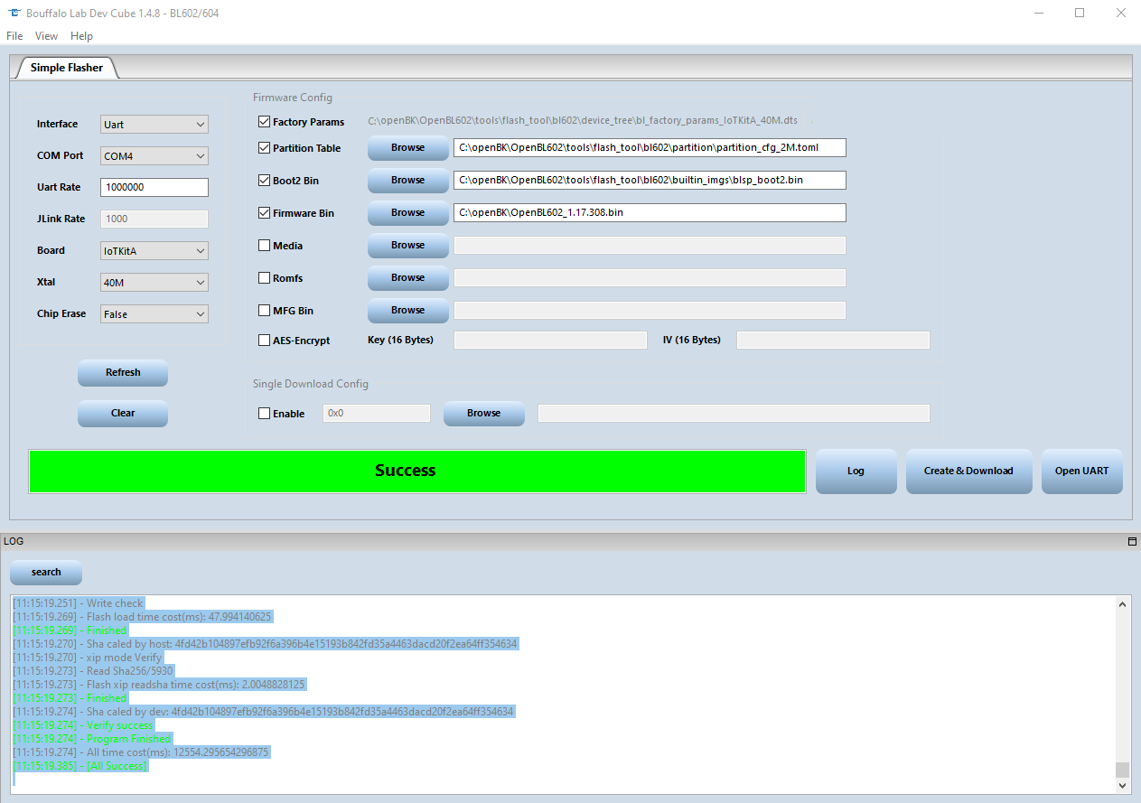

    Hello everyone,
    I am hoping for your help:
    I have a Magic Home LED controller with LF686 chip. According to Github, it can be flashed like a BL602.
    I have connected the board to a USB->TTL adapter as described here in the forum. TX->RX, RX->TX, GND->GND 3.3V->3.3V->10k resistor -> Boot
    In BLDevCube 1.8.6 I have set the parameters as shown in the screenshot. I have flashed the current firmware version 1.17.308.bin.
    The process was also displayed as 100% successful in BLDevCube. However, no WiFi can be found and the LED strip is not lit.
    How can I proceed with the troubleshooting? I have flashed it a second time. Same problem.
    The output of BLDevCube if it could help troubleshooting.
    debug.txt (19.9 kB)You must be logged in to download this attachment.
    Thank you very much!

    Some time ago I had similiar bug report and it turned out that the used USB to UART converted was not able to provide enough current for device to boot. Have you tried to, first, disconnect BOOT signal and then power the device from the original power supply, and not from the USB to UART converter?

    #368 20830103
    EricHughes
    Thank you for your answer. My first attempt was actually with an external power supply (12V 2.5A power supply, the one I actually used is unfortunately permanently installed). It also ran successfully, but no WiFI was visible. I then also connected the 3V3 connection of the UART adapter to the 3V3 connection of the LED controller and left out the power supply unit.
    To make it clear once again:
    I connect
    UART Converter:________LED Controller:
    GND ->_________________GND
    TX ->___________________RX
    RX ->___________________TX
    ________________________3V3 ->over 10k Resistor ->Boot
    ________________________12 V power supply unit to the LED controller.
    Is the sequence relevant?
    I have done it as follows so far. UART adapter connected to the computer and BLDevCube opened. LED controller switched off and connected as described above. Then connect the power supply unit and wait briefly. Flash. 10k resistor disconnect. Disconnect power supply unit. Wait briefly Connect controller to LED strip and connect power supply unit.
    Added after 48 [minutes]:
    I tried again with 12V external power supply an no 3V3 connection from the UART Converter.
    Now i get the Error: {ErrorCode: 0050, ErrorMsg: BFLB IMG LOAD SHAKEHAND FAIL}

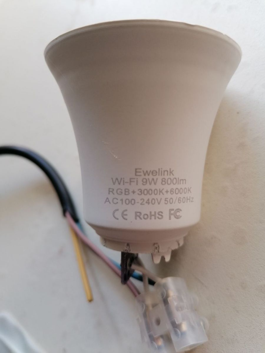

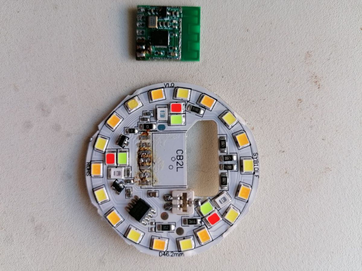

    Hello, first of all, congratulations on your work.
    I have flashed an eWeLink light bulb with the bl602 chip.
    Smart bulb eWeLink with visible technical specifications.
    Two close-ups of a bl602 chip circuit board showing the front and back sides.
    Close-up of eWeLink light bulb circuit board with BL602 chip.
    Close-up of a circuit board with LED lights and a chip.
    Screenshot of Bouffalo Lab Dev Cube software for flashing the bl602 chip.
    Sorry for the resolution of the images
    I have managed to associate it with my WiFi, but a few seconds after obtaining the IP it stops responding to the ping. I have managed to get the website to appear but it does not load anymore.
    Screenshot displaying Wi-Fi connection details for a device.
    The light bulb is two meters from the WiFi router.
    It's funny, in AP mode, you can navigate through the settings without problems.
    User interface with configuration options like MQTT, MAC change, and Home Assistant setup.
    Do you know what can happen?
  • #370 20834704
    Zhekos555
    Posts: 8
    I had the same issue, flash it again and then leave it powered ON for 10-15 minutes, dont try to connect over wifi, just wait. Then its going to work just fine.

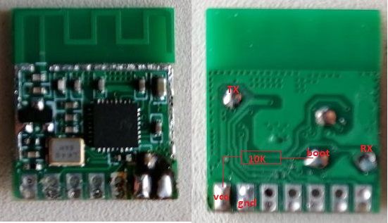

    #371 20835147
    Posts: 14770
    Rate: 12913
    Regarding WIFI issue - I haven't seen it yet, but maybe you have two devices with the same MAC on your WiFi? Have you tried different router? What does the debug log output say?
    EricHughes wrote:
    I connect
    This sounds correct, altough I recently had a BL808 (yes, 808) flash issue on one of PCs that made it impossible to flash it. It worked on another PC. Both Windows 10. I am not sure what's wrong. So maybe try other PC... I will investigate it more.
    Apart from that, remember:
    - keep flashing wires length short
    - make sure you power device from a good 3.3V power supply
    - make sure you disconnect and RESET after flashing
    - do not clear the whole device flash/do not use different flashing config because you might erase MAC and I don't know how to recover it on BL602 yet
    In a meantime, here are our both BL602 tutorials:

    EricHughes
    >>20843549
    Hello everyone,
    I'll get back to you again.
    In the meantime I have tried another USB->UART converter, no change. The flash process runs completely but no WLAN is displayed.
    I have also tried it on another Windows PC. Here I now get the following Error:
    {list index out of range}
    After File "core\bflb_iot_tool.py", line 1801, in flasher_download_thread
    Does anyone else have an idea?

    Hey, have you tried to reset the device after flashing, do a power off/on cycle? Are you powering it from good enough power supply? We've already had reports that AP was not appearing after flashing due to a weak power supply used.
    What does the log output say?
  • Refers to log output posted in #365

    EricHughes
    Hey,
    Of course, i've removed first the boot-connection, then the 3,3V power-connection an then pluged in 3,3V again. I also installed it in the previous envoroment with it's default power supply and the led-stripes.
    See above.
    I've posted the log in #365.

    Posts: 14770
    Rate: 12913
    This is not the OpenBeken firmware/BL602 firmware log output. It's a log of the flasher tool. I've asked about the log output of BL602 during boot, so you need to connect USB to UART converter to RX/TX, open UART port in realterm, set baud (as far as I remember it's the same as the one used for flashing), then disconnect power, clear UART window, and reconnect power. You should see a boot log of BL602 along with later OBK messages in your UART window in realtime.
    I am asking for this log because it can at least tell us whether OBK firmware starts properly or not.

  • BL602L20 flash boots fail after OpenBL602 image
    #386 20928839
    gianniveloce
    winux22 wrote:
    Hello i flashed OpenBL602_1.12.8.bin on a Sonoff MiniR3 as described above.
    Flash was successful but the device does not boot after opening the boot-3,3V connection and power cycling.
    When i try to log in DevCube i get an error. Do i need a different Partition Table or Params?
    The Chip is a BL602L20.
    Some Pics and flash logs are in the attachment.
    Cheers Winux
    Kudos Mate!
    Grace to your post I managed to flash my MiniR3 smoothly and then connected to Home Assistant.
    Best wishes
    GV
