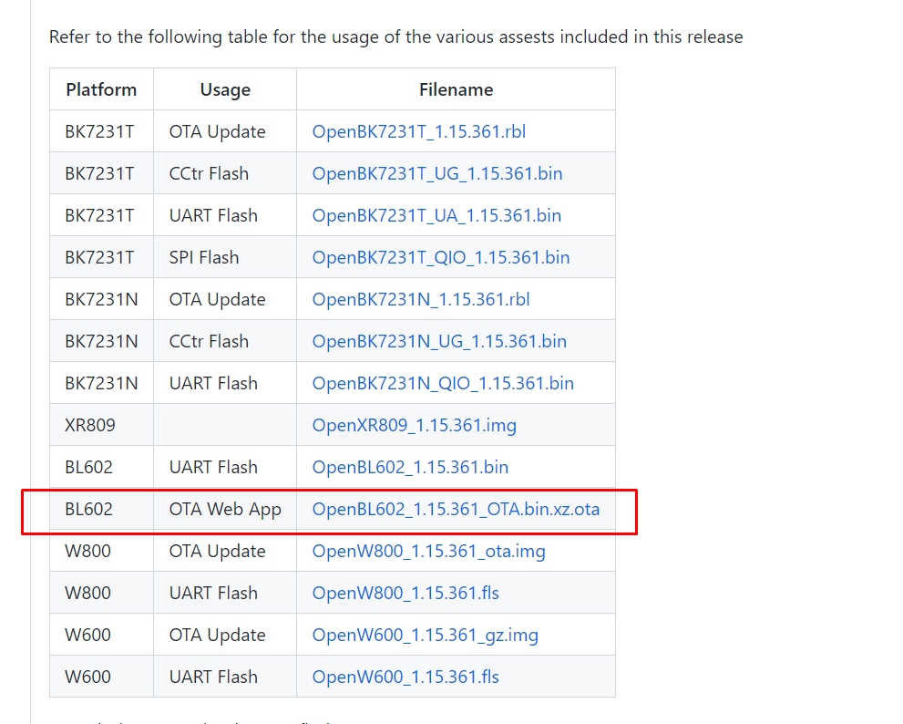

Tasmota replacement for BL602, programming, pairing with Home Assistant, now with OTA working!
p.kaczmarek2 147786 503
  • OpenBL602/OpenBeken ports Tasmota-style firmware to the BL602, letting closed IoT devices join Home Assistant over MQTT.
  • It flashes the chip through a USB-to-UART adapter and BLDevCube, then exposes an OpenBL602 access point for Tasmota-like Wi‑Fi, pin, and MQTT setup.
  • Compilation required the older BL IoT SDK commit b3898a520d6e5a34a5f4de8241fcc1c1d3b071b9, because the latest GitHub SDK would not build correctly.
  • The BL602 RGB strip controller worked in Home Assistant, and OTA is reported working, with the strip driven by three PWM outputs.
  • Limitations include no IR-remote support yet, Home Assistant not restoring brightness or color after restart, and a programming warning about disconnecting external power.

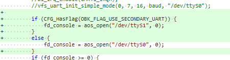

    Wait, I will add an option to switch between "/dev/ttyS0" and "/dev/ttyS1" UARTs without recompile tomorrow so you can check both of them.
    It seems that S1 will be the answer and not S0.

    Yes, I'd seen that snippet of code when I was digging through stuff... I'll watch the release notes and Git history to see when you've added it in.
  • UART flag added; need to identify active DTS
    #243 20366504
    Posts: 14770
    Rate: 12913

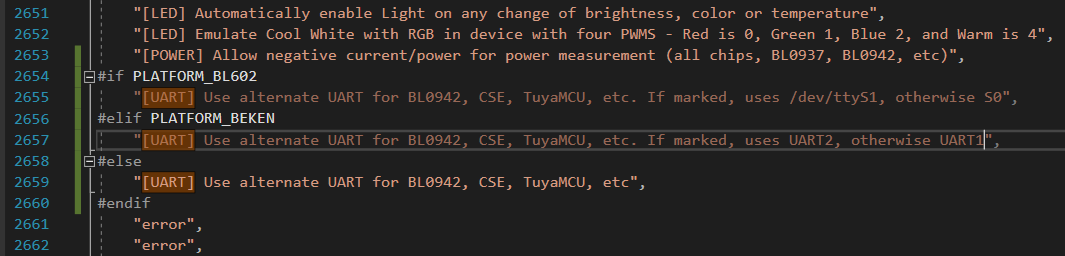

    @davidcpurdy I have added a flag to select UART

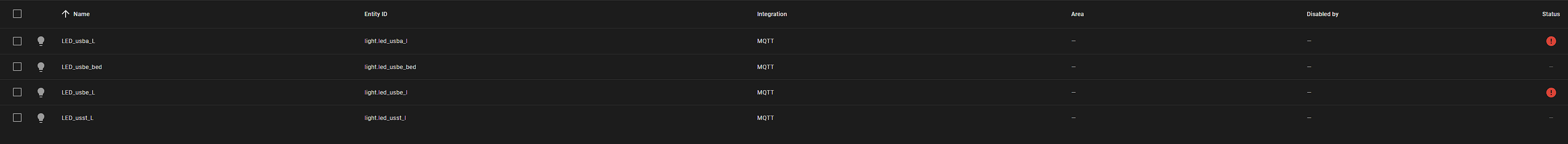

  • Home Assistant MQTT discovery not working on BL602

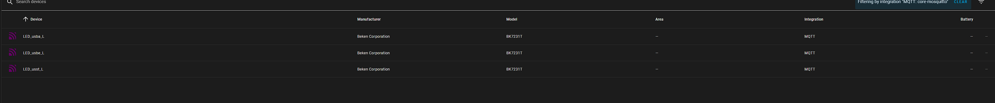

    #244 20366514

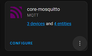

    leifmjcb
    Posts: 7
    @p.kaczmarek2 sorry to pester but any chance you could help with this?
    leifmjcb wrote:
    Hi all, Happy new year!
    As my new years resolution, I've decided to stop pulling my hair out over these BL602 MagicHome LED controllers and come here for some help.
    I've flashed 6 of these now originally with 1.15.149 and today with 1.15.273.
    The config, operation, wifi & MQTT all seem to be working fine. I have no errors in logs.
    However I cant for the life of me get discovery to work. The only way I can connect via HA is by manually adding via YAML conf. But when I do this only an entity appears, no device.
    I am still learning HA and MQTT but I'm only having this problem with BL602, I've got many ESP and BK7231T devices working fine and with discovery.
    Here's my conf for this device:
    mqtt:
    light:
    - unique_id: "LED-UpstairsBedroom-BedLights_light"
    rgb_command_template: "{{ '#%02x%02x%02x0000' | format(red, green, blue)}}"
    rgb_value_template: "{{ value[0:2]|int(base=16) }},{{ value[2:4]|int(base=16) }},{{ value[4:6]|int(base=16) }}"
    rgb_state_topic: "LED_usbe_bed/led_basecolor_rgb/get"
    rgb_command_topic: "cmnd/LED_usbe_bed/led_basecolor_rgb"
    command_topic: "cmnd/LED_usbe_bed/led_enableAll"
    state_topic: "LED_usbe_bed/led_enableAll/get"
    availability_topic: "LED_usbe_bed/connected"
    payload_on: "1"
    payload_off: "0"
    brightness_command_topic: "cmnd/LED_usbe_bed/led_dimmer"
    brightness_state_topic: "LED_usbe_bed/led_dimmer/get"
    brightness_scale: 100
    Apologies is this is a newbie question. But any help would be much appreciated.
    Screenshots attached
    Thanks!
    Leif Tasmota replacement for BL602, programming, pairing with Home Assistant, now with OTA working! Tasmota replacement for BL602, programming, pairing with Home Assistant, now with OTA working! Tasmota replacement for BL602, programming, pairing with Home Assistant, now with OTA working!

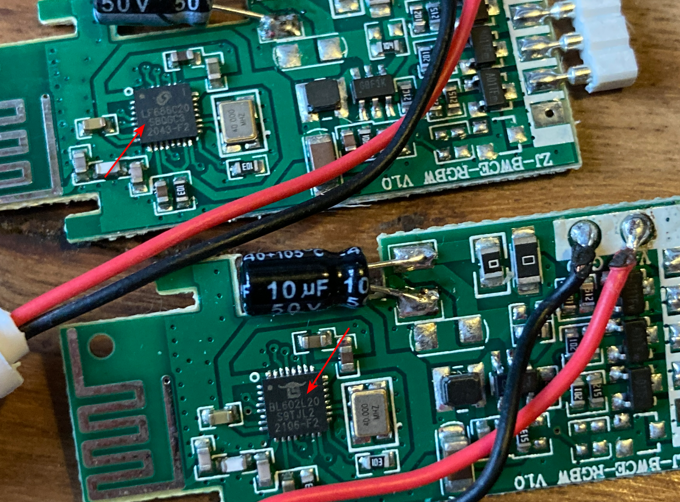

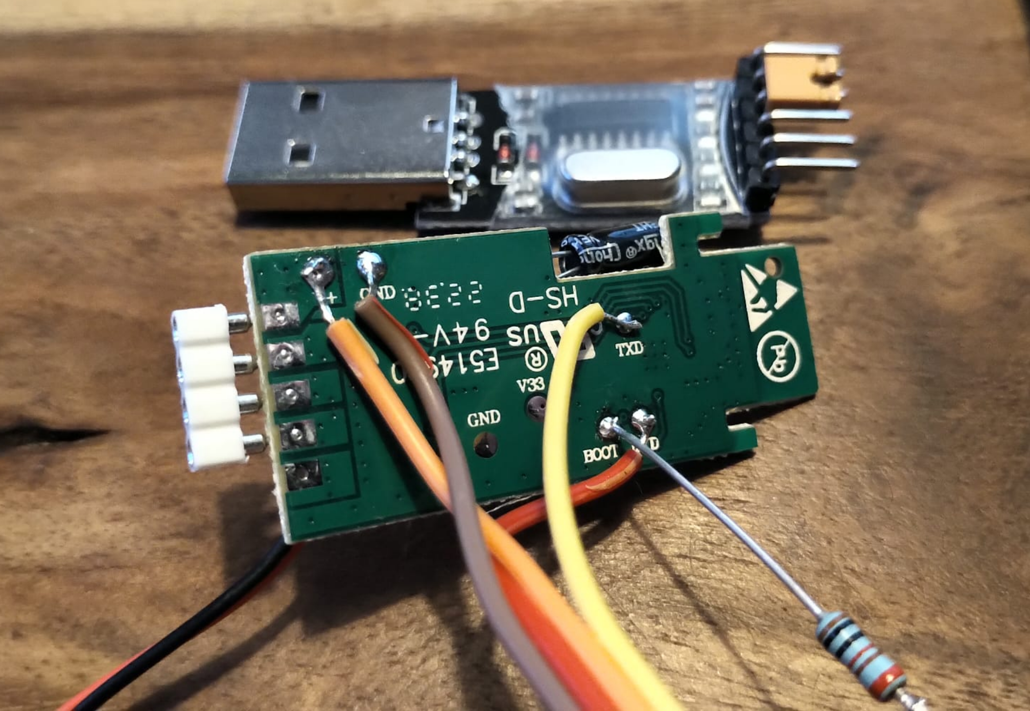

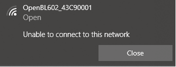

  • BL602 flashing works but OpenBeken AP won’t connect

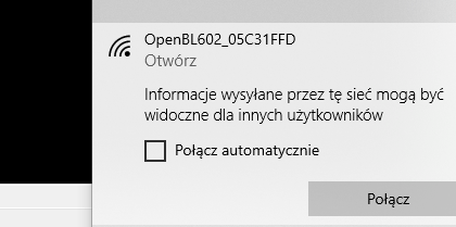

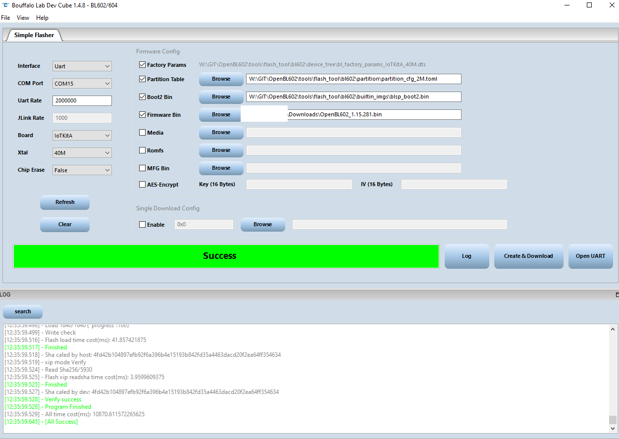

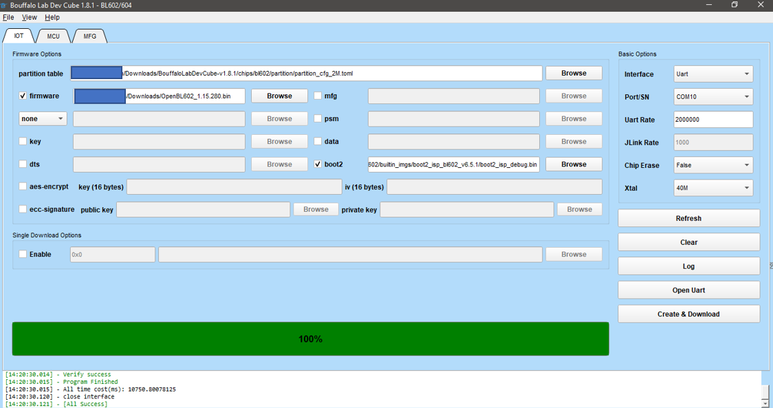

    #246 20368704
    timaseth

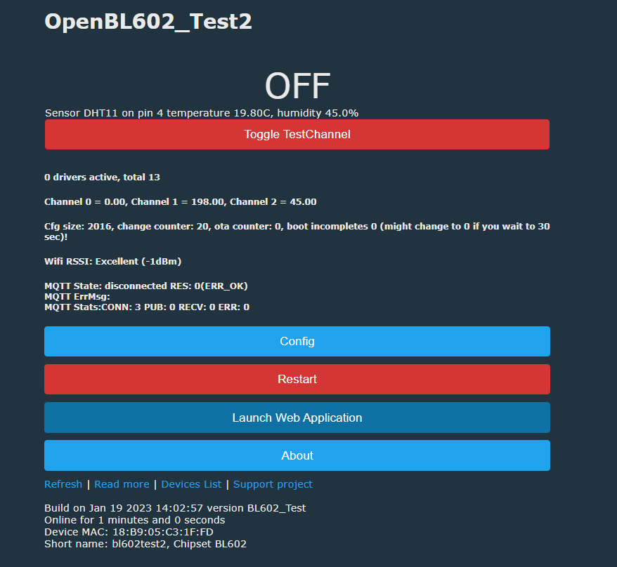

    Dear Friends,
    My first post here.
    Tried flashing a RGB Magic Home led controller which has a BL602 chip.
    I was not able to find the software version 1.48 of BLDevCube so had to use the latest (1.81) one that is on their website.
    The flashing happened as expected.
    Here are some screen shots:
    Tasmota replacement for BL602, programming, pairing with Home Assistant, now with OTA working! [/img]
    I tried using the OpenBL602_1.15.275.bin which resulted in an OpenBeken hotspot but I am unable to connect to it (even after putting a stic IP of 192.168.4.x range)
    With BLOpenBL602_1.15.280.bin, I get no AP.
    Any and help help is welcome!
    Thanks for your project, I must add!

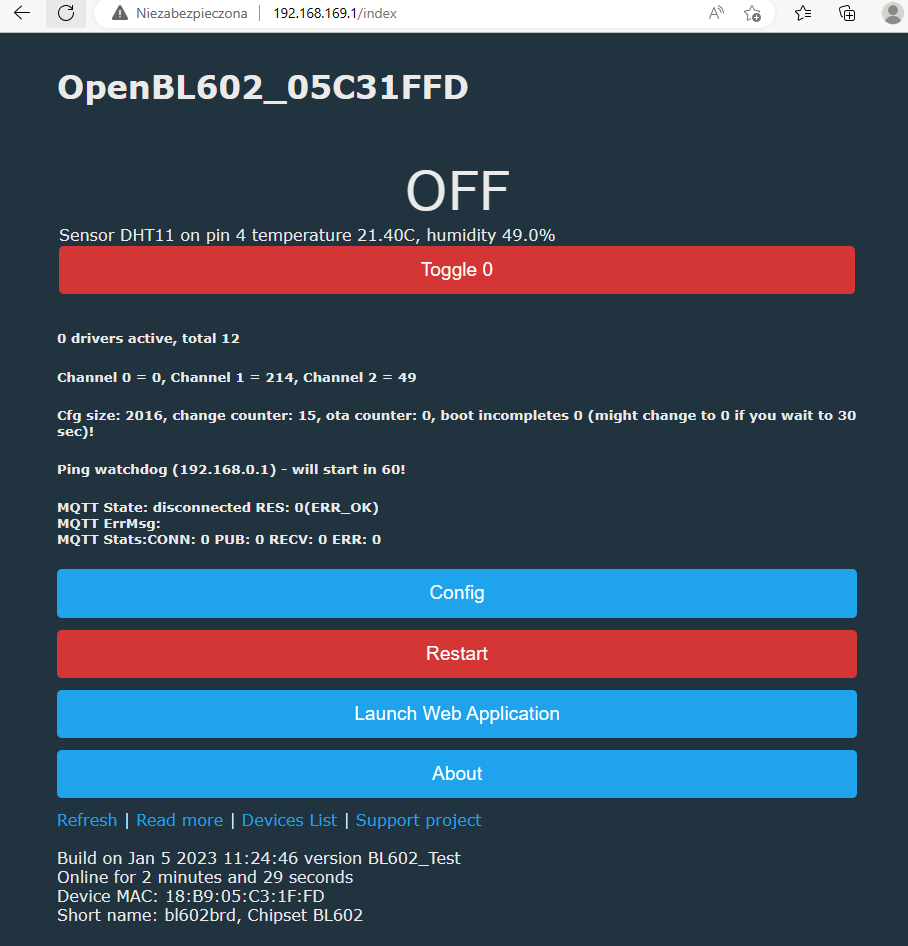

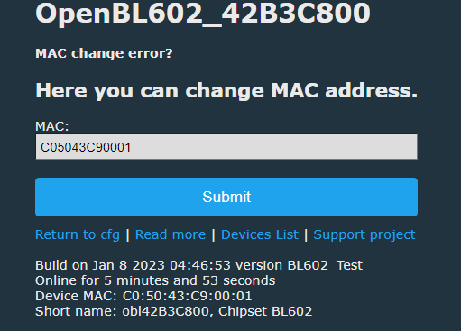

  • BL602 AP uses 192.168.169.1 instead of 4.1
    #247 20368883
    Posts: 14770
    Rate: 12913
    Hello @timaseth, I am not aware about any changes that could break BL602 in those releases, but let me check... let's say OpenBL602_1.15.281.bin version
    It seems to work?
    And AP...
    Ah, now I see what you mean.
    The IP is 192.168.169.1, not 4.1, we must look into changing it soon.
  • DevCube zip download fixed BL602 flashing and AP access

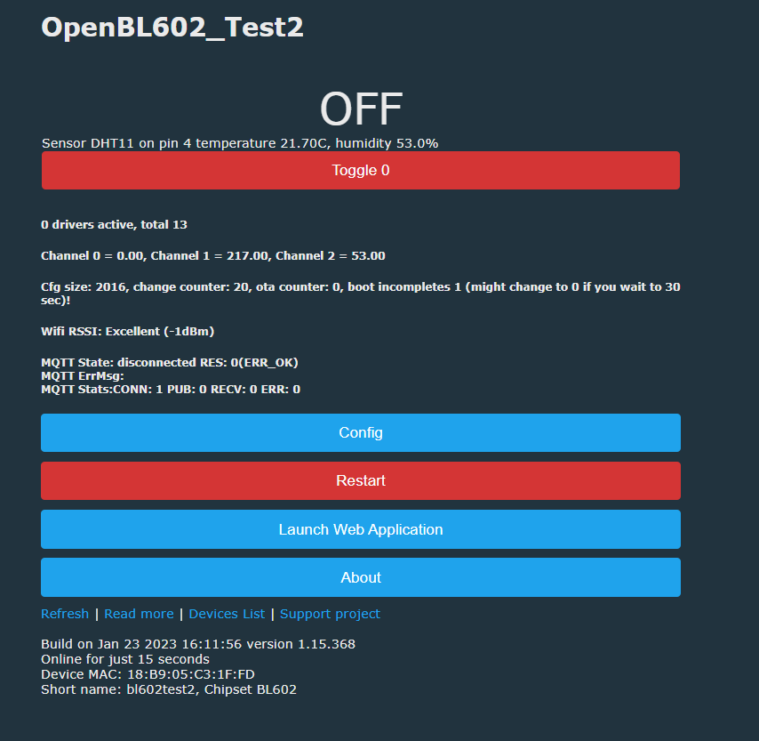

    #248 20369004
    timaseth
    Thanks for the quick reply.
    I tried once more to connect to the AP using fixed IP of 192.168.169.99 but failed to do so.
    Perhaps the software is creating some issues?
    Do you have a link from where I can download the same exe of DevCube which you are using? Many thanks for your help.
    Added after 17 [minutes]:
    Yipee!!!
    I downloaded the entire zip from Github and achieved 100% result.
    It works using 192.168.169.1 as the webpage!
    Many thanks!!

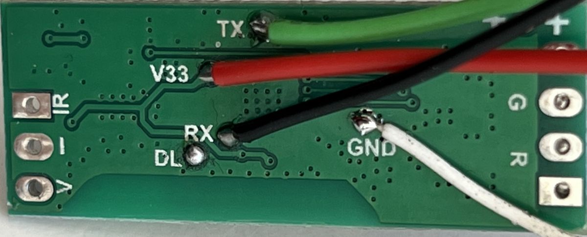

  • UART1 test command to verify expected TX output
    #249 20369067
    Posts: 14770
    Rate: 12913
    My BLDevCube is here:
    https://github.com/openshwprojects/OpenBL602/tree/master/tools/flash_tool
    I apologize for that IP mess, it seems that there was some trouble with setting 192.168.4.1 as a default IP. I must look into it, but it's hard while there are so few BL602 devices and so many BK7231....
    If you have a BL602 device and you are reading this topic, please post here! I need to know how many of you guys with BL's are there!
    @davidcpurdy S0 or UART0 is used for log output. You can disable it with "logtype none" in short startup command. But you don't need that, you have your CSE chip on S1/UART1, right?
    Can you connect UART to USB converter to S1 TX and then start CSE driver and maybe try "uartSendASCII Test123" command and see if anything is being sent out of EXPECTED TX pin?

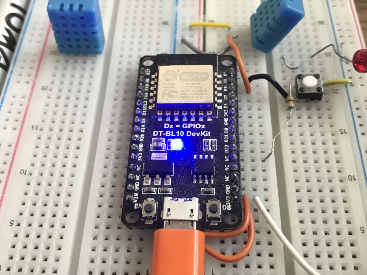

  • GPIO demo works, but Tasmota shows invalid config
    #250 20371930
    mjleonard
    That's a strange error, I have never seen it before.
    At first, can you try downloading compiled GPIO demo from their SDK, here:
    https://www.elektroda.com/rtvforum/topic3889041-90.html#20117857
    and checking if at least it works on your device? It has an UART console to control pins. Try commands from the first post from this topic, gpio-func, gpio-set, etc...

    #252 20373050
    questoculus70
    Hello guys and a Happy new Year!
    also many thanks for your great job @p.kaczmarek2 !!!
    bought 2 Magic Home Controller a few days ago and flashed one of them with a BL602 succesfully.
    the second one has a LF686 ? is it also possible to flash? Flashing ok with BL602, Firmware OpenBL602_1.15.317.bin
    what was the exact "Reset Method" for the Controller? 4 Times On/Off? OK, found it! -> It is also possible to reset/safe mode the device by doing 3 or more turn on and off power cycles with running device for less than about 30 seconds (power on, wait 3 sec, power off, etc 3 times). It will enable open access point again and also might disable IO (so don't bother testing GPIO in the safe mode).
    do you know about problems with "Fritz Router" 2,4 GHz Wlan Connections? Solved! Only Wlan Security Setting "WPA + WPA2" is working. with all other option you get no connection working.
  • Need a way to change BL602 MAC address
    #253 20374784
    benek194
    Rate: 16
    Hello Guys,
    I've flashed 2 devices Magic Home Led Controller ZJ-BWCE-RGBW V1.0 to BL602,
    I was able also to link them both with Home Assistant but only one in a time.
    Both can not work together because the MAC address duplication, I am getting the error while trying to change it even in newest build. (OpenBL602_1.15.296)
    Is there other way to change the MAC in BL602, but without using development tool and compiling new binary file?
    Thanks in advance for any help.

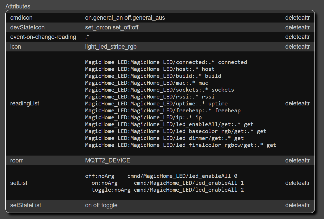

    questoculus70
    hey guys,
    i cant get the mqtt interface to work! server connection runs fine but what is a working example to switch the led controller ON or OFF ? everytime when i send commands like:
    obl42A9B04A/led_enableAll/set 0 or 1 nothing happens?
    trying to implemet it to FHEM.
    thanks and regards
    ok, solved it!

  • Check BOOT pin release after flashing
    #255 20383849
    Posts: 14770
    Rate: 12913
    It was a wrong topic, we are trying to use Tasmota syntax.
    More updates soon.
    @benek194 very good job and thank you for information
    @questoculus70 LF686 is under considerations but I don't have that device at hand...
    @_Roli_ surprisingly, the Magic Home single colour device is not on templates list - can you share information about it and show your config so we can include it in our database?
    @mjleonard you should get at least a console output, even without OpenBL602. Maybe you are missing something, for example, maybe you don't disconnect BOOT pin after flashing and don't reset the chip later?
    The firmware won't start itself if you keep device in the boot mode. And you won't get log output.
  • BLDevCube 1.8.1 flashes but firmware won’t boot
    #256 20388048
    mittermayr
    Hello @p.kaczmarek2 — thanks for putting so much effort and time into this project and helping so many of us out here!
    I wanted to report an issue I wasn't able to solve with (possibly?) an unseen variant of a RGB controller, running on the BL602. I brought some photos for others to compare to, maybe you can solve it. Controller is: BL602 L10.
    Problem is: I cannot program with 1.4.8 (see error in spoiler below). Does not work.
    But, I can program it with BL Dev Cube 1.8.1, but it does not really work after I boot (likely because of the new partition format). When I boot, the bootloader seems to start but then gets stuck (doesn't load your firmware). See the last spoiler all the way down for the boot log I captured via the serial port.
    So, to summarize:
    BL Dev Cube 1.4.8 — no chance to flash, always fails (error in Spoiler below).
    BL Dev Cube 1.8.1 — flashes completely, but firmware does not boot correctly.
    Here's what I know so far:
    - I connect the DL pin to 3.3V on board via 10k resistor during power-on. After programming, I power-cycle without the DL pin connected. If I don't do this, I also can not program even with BF Dev Cube 1.8.1.
    - I tried with 230.4k baud (Mac OS), 500k baud (Windows 11), 2M baud (Windows 11), no difference.
    - I tried with bfflash (eflash loader works, but for the firmware, it complains that the sha hashes could not be verified). No success.
    - I tried with your SDK GPIO demo from this thread, fails to flash with 1.4.8. I can flash it with 1.8.1, and it boots and works (!)
    - Every time I try to flash with BLDevCube 1.4.8 (from this thread), the flash process errors out with:
    {"ErrorCode": "003D","ErrorMsg":"BFLB FLASH MATCH TYPE FAIL"}
    . When I flash with BLDevCube 1.8.1, it flashes okay and I can boot, but the booting process gets stuck (see spoiler at the bottom for serial log)
    Is there a chance I accidentally "upgraded" the way the chip stores information/efuses and now it doesn't work with 1.4.8 because that's the old format? Or, in other words, have you ever managed to try and upload with the latest uploader version?
    Could I self-compile the BL602 firmware with the new partition format you think?
    Do you think they are shipping a new chip and BL Dev Cube 1.4.8 simply does not work anymore?
    The official app they're using is called CozyLife. Looked a lot like Tuya, again.
    Here is the full programming log on BL DevCube 1.4.8 from this thread (using the 10k resistor between DL and 3.3V on board to boot into flash mode), and an FTDI232 board on 3.3V (jumpered) via USB on Windows 11:
    Spoiler:
    [10:20:19.504] - [param]
    interface_type = "Uart"
    comport_uart = "COM6"
    speed_uart = "2000000"
    speed_jlink = "1000"
    bl60x_brd = "IoTKitA"
    bl60x_xtal = "40M"
    aes_key = ""
    aes_iv = ""
    addr = "0x0"
    [check_box]
    partition_download = true
    boot2_download = true
    bin_download = true
    media_download = false
    use_romfs = false
    mfg_download = false
    ro_params_download = true
    ckb_erase_all = "False"
    encrypt = false
    download_single = false
    [input_path]
    pt_bin_input = "C:\\Users\\roman\\Downloads\\flash_tool2\\flash_tool\\bl602\\partition\\partition_cfg_2M.toml"
    boot2_bin_input = "C:\\Users\\roman\\Downloads\\flash_tool2\\flash_tool\\bl602\\builtin_imgs\\blsp_boot2.bin"
    cfg2_bin_input = "C:\\Users\\roman\\Desktop\\OpenBL602_1.15.319.bin"
    meida_bin_input = ""
    romfs_dir_input = ""
    mfg_bin_input = ""
    img_bin_input = ""
    [10:20:19.514] - ========= Interface is Uart =========
    [10:20:19.516] - eflash loader bin is eflash_loader_40m.bin
    [10:20:19.521] - ========= chip flash id: ef4015 =========
    [10:20:19.529] - Update flash cfg finished
    [10:20:19.532] - create partition.bin, pt_new is True
    [10:20:19.533] - bl60x_fw_boot_head_gen xtal: 40M
    [10:20:19.538] - Create bootheader using C:\Users\roman\Downloads\flash_tool2\flash_tool\bl602\efuse_bootheader/efuse_bootheader_cfg.ini
    [10:20:19.538] - Updating data according to <C:\Users\roman\Downloads\flash_tool2\flash_tool\bl602\efuse_bootheader/efuse_bootheader_cfg.ini[BOOTHEADER_CFG]>
    [10:20:19.541] - Created file len:176
    [10:20:19.544] - Create efuse using C:\Users\roman\Downloads\flash_tool2\flash_tool\bl602\efuse_bootheader/efuse_bootheader_cfg.ini
    [10:20:19.544] - Updating data according to <C:\Users\roman\Downloads\flash_tool2\flash_tool\bl602\efuse_bootheader/efuse_bootheader_cfg.ini[EFUSE_CFG]>
    [10:20:19.547] - Created file len:128
    [10:20:19.553] - ========= sp image create =========
    [10:20:19.555] - Image hash is b'c5e2ce515a5783ac80efdd4910238a466572f882b53b3284e63c763e1da9847f'
    [10:20:19.555] - Header crc: b'52b188af'
    [10:20:19.555] - Write flash img
    [10:20:19.555] - bl60x_fw_boot_head_gen xtal: 40M
    [10:20:19.563] - Create bootheader using C:\Users\roman\Downloads\flash_tool2\flash_tool\bl602\efuse_bootheader/efuse_bootheader_cfg.ini
    [10:20:19.563] - Updating data according to <C:\Users\roman\Downloads\flash_tool2\flash_tool\bl602\efuse_bootheader/efuse_bootheader_cfg.ini[BOOTHEADER_CFG]>
    [10:20:19.568] - Created file len:176
    [10:20:19.570] - Create efuse using C:\Users\roman\Downloads\flash_tool2\flash_tool\bl602\efuse_bootheader/efuse_bootheader_cfg.ini
    [10:20:19.572] - Updating data according to <C:\Users\roman\Downloads\flash_tool2\flash_tool\bl602\efuse_bootheader/efuse_bootheader_cfg.ini[EFUSE_CFG]>
    [10:20:19.572] - Created file len:128
    [10:20:19.576] - ========= sp image create =========
    [10:20:19.587] - Image hash is b'3136f3c31a398c12aacbd4426d81fb3b6ae4bbcf1a3c2776802e25ea93f5e06b'
    [10:20:19.588] - Header crc: b'd90300fd'
    [10:20:19.589] - Write flash img
    [10:20:19.599] - FW Header is 176, 3920 still needed
    [10:20:19.599] - FW OTA bin header is Done. Len is 4096
    [10:20:19.821] - FW OTA bin is Done. Len is 828624
    [10:20:20.517] - FW OTA xz is Done
    [10:20:20.517] - ========= eflash loader config =========
    [10:20:20.591] - =========C:\Users\roman\Downloads\flash_tool2\flash_tool\bl602\device_tree/bl_factory_params_IoTKitA_40M.dts ——> bl602/device_tree/ro_params.dtb=========
    [10:20:20.780] - Version: bflb_eflash_loader_v2.0.0
    [10:20:20.780] - Program Start
    [10:20:20.780] - ========= eflash loader cmd arguments =========
    chipname : None
    chipid : False
    usage : False
    flash : True
    efuse : False
    write : True
    erase : False
    read : False
    none : False
    port : COM6
    baudrate : None
    config : None
    interface : None
    xtal : None
    start : None
    end : None
    addr : None
    mac : None
    file : None
    data : None
    mass : None
    loadstr : None
    loadfile : None
    userarea : None
    csvfile : None
    csvaddr : None
    para : None
    aeskey : None
    aesiv : None
    key : None
    ecdh : False
    echo : False
    auto : False
    version : False
    [10:20:20.831] - Config file: C:\Users\roman\Downloads\flash_tool2\flash_tool\bl602\eflash_loader/eflash_loader_cfg.ini
    [10:20:20.832] - serial port is COM6
    [10:20:20.834] - chiptype: bl602
    [10:20:20.834] - ========= Interface is Uart =========
    [10:20:20.834] - com speed: 2000000
    [10:20:20.834] - Eflash load helper file: C:\Users\roman\Downloads\flash_tool2\flash_tool\bl602\eflash_loader/eflash_loader_40m.bin
    [10:20:20.834] - ========= load eflash_loader.bin =========
    [10:20:20.834] - Load eflash_loader.bin via uart
    [10:20:20.834] - ========= image load =========
    [10:20:21.112] - tx rx and power off, press the machine!
    [10:20:21.113] - cutoff time is 0.1
    [10:20:21.223] - power on tx and rx
    [10:20:22.037] - reset cnt: 0, reset hold: 0.005, shake hand delay: 0.1
    [10:20:22.037] - clean buf
    [10:20:22.149] - send sync
    [10:20:22.370] - ack is b'4f4b'
    [10:20:22.416] - shake hand success
    [10:20:22.432] - get_boot_info
    [10:20:22.439] - data read is b'0100000000000000030000005121b14cb97c1a00'
    [10:20:22.439] - sign is 0 encrypt is 0
    [10:20:22.453] - segcnt is 1
    [10:20:22.487] - segdata_len is 30192
    [10:20:22.578] - 4080/30192
    [10:20:22.669] - 8160/30192
    [10:20:22.770] - 12240/30192
    [10:20:22.862] - 16320/30192
    [10:20:22.958] - 20400/30192
    [10:20:23.055] - 24480/30192
    [10:20:23.150] - 28560/30192
    [10:20:23.198] - 30192/30192
    [10:20:23.216] - Run img
    [10:20:23.341] - Load helper bin time cost(ms): 2507.72705078125
    [10:20:23.452] - ========= flash read jedec ID =========
    [10:20:23.452] - Flash load shake hand
    [10:20:23.452] - clean buf
    [10:20:23.563] - send sync
    [10:20:23.785] - ack is b'4f4b'
    [10:20:23.843] - Read flash jedec ID
    [10:20:23.845] - readdata:
    [10:20:23.847] - b'c2201400'
    [10:20:23.847] - Finished
    [10:20:23.849] - {"ErrorCode": "003D","ErrorMsg":"BFLB FLASH MATCH TYPE FAIL"}
    [10:20:23.849] - Burn Retry
    [10:20:23.849] - 0
    [10:20:23.849] - Burn return with retry fail
    This is what the boot process shows if I flash with BL Dev Cube 1.8.1, which I know isn't the one you used/recommended, but it is the ONLY VERSION that produces a serial output after flashing. Unfortunately nothing useful:

    Finally, this is the output of the SDK GPIO test (can only flash with 1.8.1):
    Spoiler:
    Simple Malloc 5120
    custom 0x0000
    flash init 0
    BLSP Boot2 start:Oct 17 2022,16:36:29
    Group=1,CPU Count=1
    ver:6.5.1
    user_fw
    Active PT:0,Age 0
    read mfg flag addr:0019f000
    entry ID 0 found
    pass param addr 42049c00,len 4
    pass param addr 42049c04,len 272
    pass param addr 42049d14,len 92
    Boot start
    Media boot main
    R header from 00010000
    Cal hash addr 0x00011000,len 78352
    Hash Success
    ps_mode 0,efuse hbn_check_sign 0
    group[0] offset 00011000 ,core[0] offset 00000000 bootentry 2300000Starting bl602 now....

  • #257 20388222
    hellriser777
    hello
    mqtt not working with home assistant
    ty

    Posts: 61
    Rate: 20
    Is there a way to add alexa to Openbeken ?
    Tasmota has 2 emulation options so that alexa can find the device

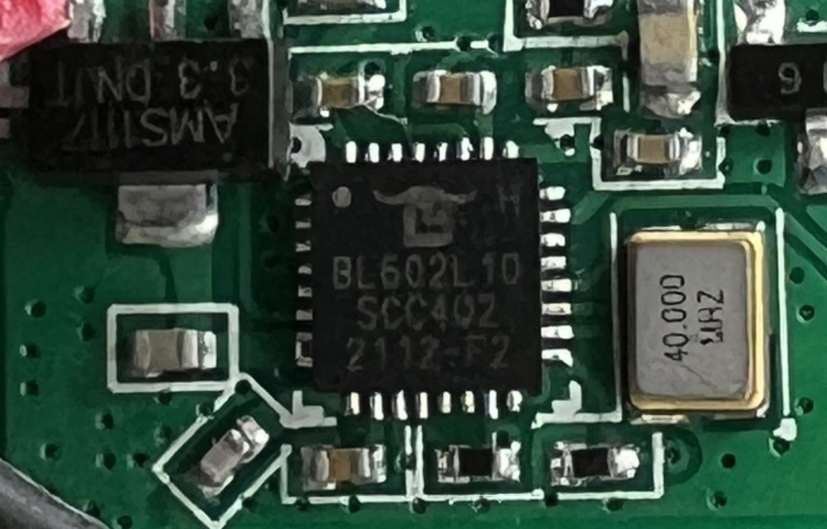

  • Buffalo Lab chip variant may cause flashing issues
    #261 20394141
    Posts: 14770
    Rate: 12913
    It seems that Buffalo Lab has a version of chip that is not compatible with older ones, this is why a strange problems with flashing happen. I will look into it later.
    Alexa support is a great idea, I'll add it to TODO list.
    HA discovery was broken for lights in few releases, but it's fixed now.
    Thank you @droege, can you narrow down the issue? Did it broke just in 1.15.342 and 1.15.340 is working, or which one release broke?
    EDIT: I looked at my DHT11 humidity/temperature board and it seems that 1.15.342 is fine for me?
    I can even set channel label...
    setChannelLabel 0 TestChannel

  • Newer BL Dev Cube partition table may break booting
    #264 20395522
    mittermayr
    If I can assist in debugging/figuring out the chip variation (as documented a few posts up here) on the (possible) newer version of the BL620 I have here for this super cheap light strip, then I would love to help. I sit in front of it every evening trying to figure out a solution.
    The newer BL Dev Cube 1.8.1 seems to have a slightly modified partition table (firmware starts at the same 0x10000, but seems to be larger now). Only noticed that when comparing the partition toml from 1.8.1 to the version you have here (1.4.8).
    I tried using blflash with the latest efloader (read that on GitHub somewhere) in place to see if that maybe does the trick, but it reports constant sha256 mismatches, so that doesn't work.
    Programming with 1.8.1 works, but the firmware doesn't boot.
    I wonder if I can build your BL602 firmware and somehow use a different partition format? I guess the bin file contains not just the firmware that is placed at 0x10000 but some parts of the boot2 or bootloader stuff, too, and that maybe is in the wrong places?
    BL Dev Cube would allow me to flash the firmware at a specific location (like 0x10000), but for that (I think) I would need to have JUST the firmware in the bin to work (unsure).
    Would be interesting to see what adjustment it takes for you to successfully flash with 1.8.1 to your dev board. I think if that works, then we could all move up to 1.8.1., regardless of chip version.
    Like I said, if you need specific data, I want to help. If you're busy (I am sure you are), no rush. I just have everything connected and ready to debug here and wanted to help.
  • BL602 OTA added in testing firmware
    #265 20399186
    Posts: 14770
    Rate: 12913
    Due to the larger number of BL602 device reports, OTA has been added to BL602.
    OTA file is now released here:
    This is a testing version, but seem to works for me. More coming soon. I will be also adding missing functionality to BL602.
    Please tell me what is needed now and if there are any unsupported devices with BLs.

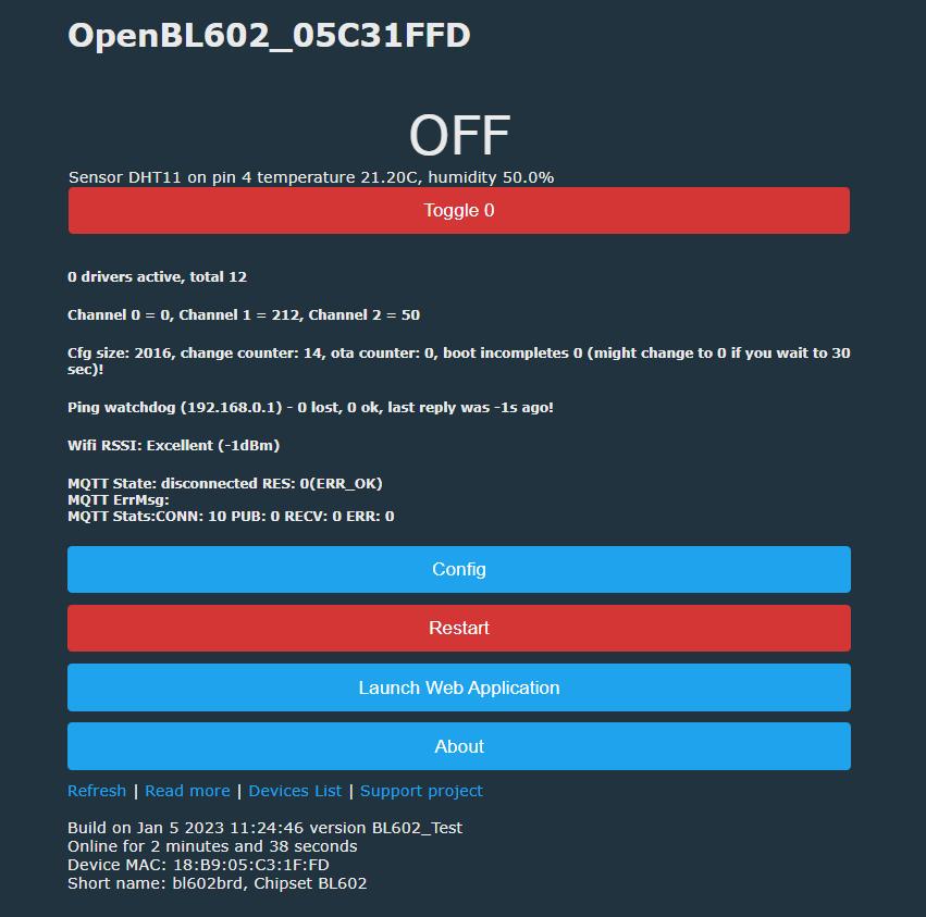

    DHT11 also works with BL602.

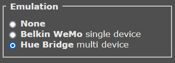

    Posts: 14770
    Rate: 12913
    Alexa (WEMO) integration is almost ready! I am just waiting for feedback from tester (or can someone else help with testing?)
    In a meantime, I fixed some Tasmota emulation stuff and now ioBroker sonoff plugin works as well!
    Please see video below (it's taken from OBK Windows Simulator):
    ioBroker will of course work with all our platforms, BK7231N, BK7231T, BL602, W800/W801, W600/W601, T34, XR809 (XR3), etc...
