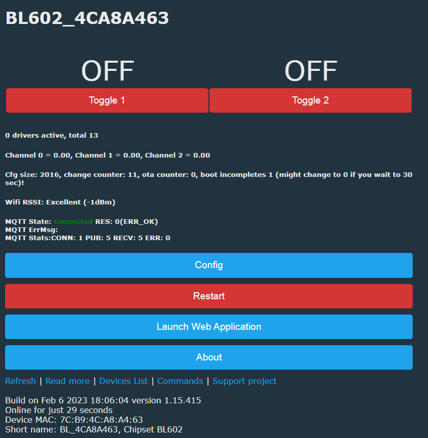

  • OpenBL602/OpenBeken ports Tasmota-style firmware to the BL602, letting closed IoT devices join Home Assistant over MQTT.
  • It flashes the chip through a USB-to-UART adapter and BLDevCube, then exposes an OpenBL602 access point for Tasmota-like Wi‑Fi, pin, and MQTT setup.
  • Compilation required the older BL IoT SDK commit b3898a520d6e5a34a5f4de8241fcc1c1d3b071b9, because the latest GitHub SDK would not build correctly.

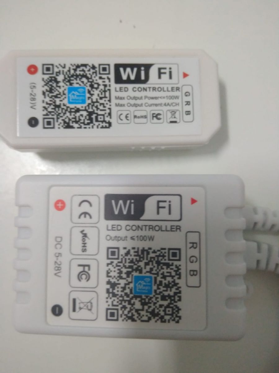

  • The BL602 RGB strip controller worked in Home Assistant, and OTA is reported working, with the strip driven by three PWM outputs.
  • Limitations include no IR-remote support yet, Home Assistant not restoring brightness or color after restart, and a programming warning about disconnecting external power.
  • BK7231 devices preferred for testing drivers

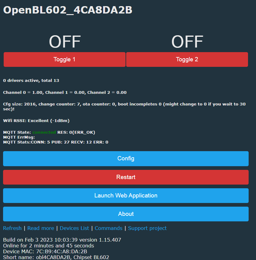

    @Zain00 do you have any BK7231 devices? That would be better touse for testing to minimalize the potential other platform differences testing impact...
    All drivers are first done for BKs because they are more popular, then enabled on other platforms.
    Or, maybe should I say, all drivers are first done on Windows - because, as you may know, our firmware runs on Windows which makes the development lighting fast!

    Yes, I do have a BK7231N Bulb.

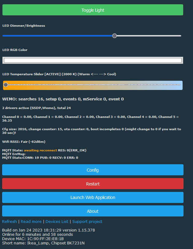

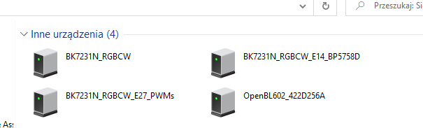

  • Wemo emulation test and log diagnostics
    #273 20402872
    Posts: 14770
    Rate: 12913
    The following process will work on BK and not on BL, but I will enable it on BL when it's stable enough.
    We are trying to emulate Belkin WEMO Single Device integration, just as in Tasmota, under the same hacky logic. Let me quote their docs:
    Tasmota replacement for BL602, programming, pairing with Home Assistant, now with OTA working!
    On OpenBeken device, run:
    backlog startDriver WEMO; startDriver SSDP
    WEMO works in the following way
    1. first there is UDP MSEARCH just like in SSDP
    2. then wemo devices responds with its page link
    3. then there is a HTTP get call to XML
    4. and finally, to set state, the HTTP post is called
    I don't have alexa and i am unable to check if my code works. I need to know how much works and when it fails.
    This should show WEMO stats:
    What do you get here?
    Do you get any POST EVENTs in log?
    The event processing is not implemented yet, I need to know at the moment if it even is able to reach to that point.
  • Alexa discovery log shows WEMO and SSDP drivers starting
    #274 20403407
    Zain00
    Posts: 61
    Rate: 20
    @p.kaczmarek2
    I ran device discovery on Alexa and this is the log

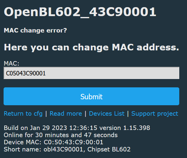

    #283 20413308
    nemo700
    benek194 wrote:
    I've flashed 2 devices Magic Home Led Controller ZJ-BWCE-RGBW V1.0 to BL602,
    I was able also to link them both with Home Assistant but only one in a time.
    Both can not work together because the MAC address duplication, I am getting the error while trying to change it even in newest build. (OpenBL602_1.15.296)
    I have the same problem as benek194.
    I flashed two (switch-sw) relay devices with bl602 with the current version 1.15.398 and both get the same MAC address. (C0:50:43:C9:00:01)
    All attempts to change this have failed. Is there a way to customize this?

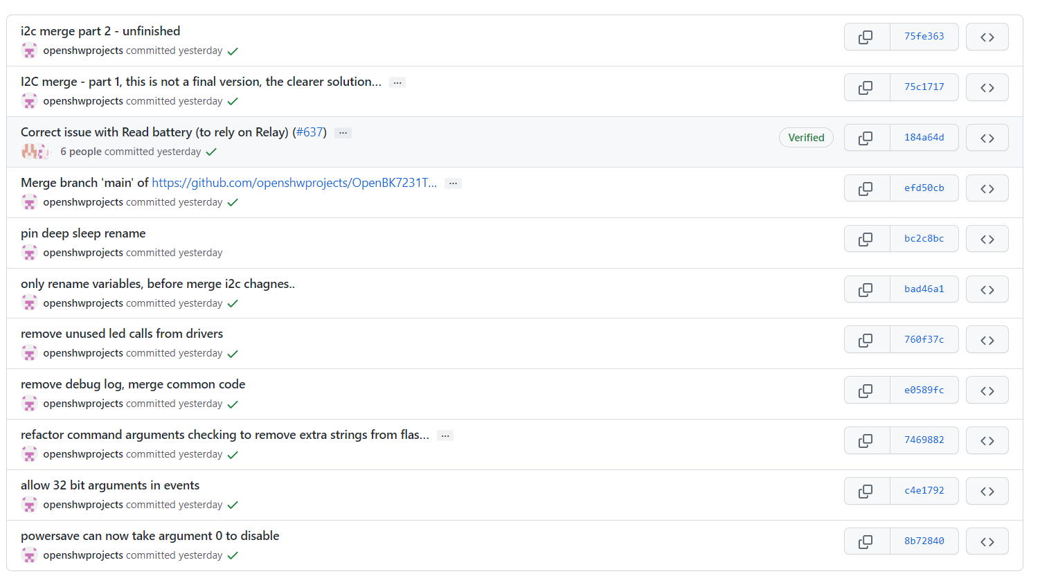

  • Refactored I2C and LED drivers, reduced binary size
    #288 20433598
    Posts: 14770
    Rate: 12913
    Nice update @omelchuk890 , you have much more BL devices than me.

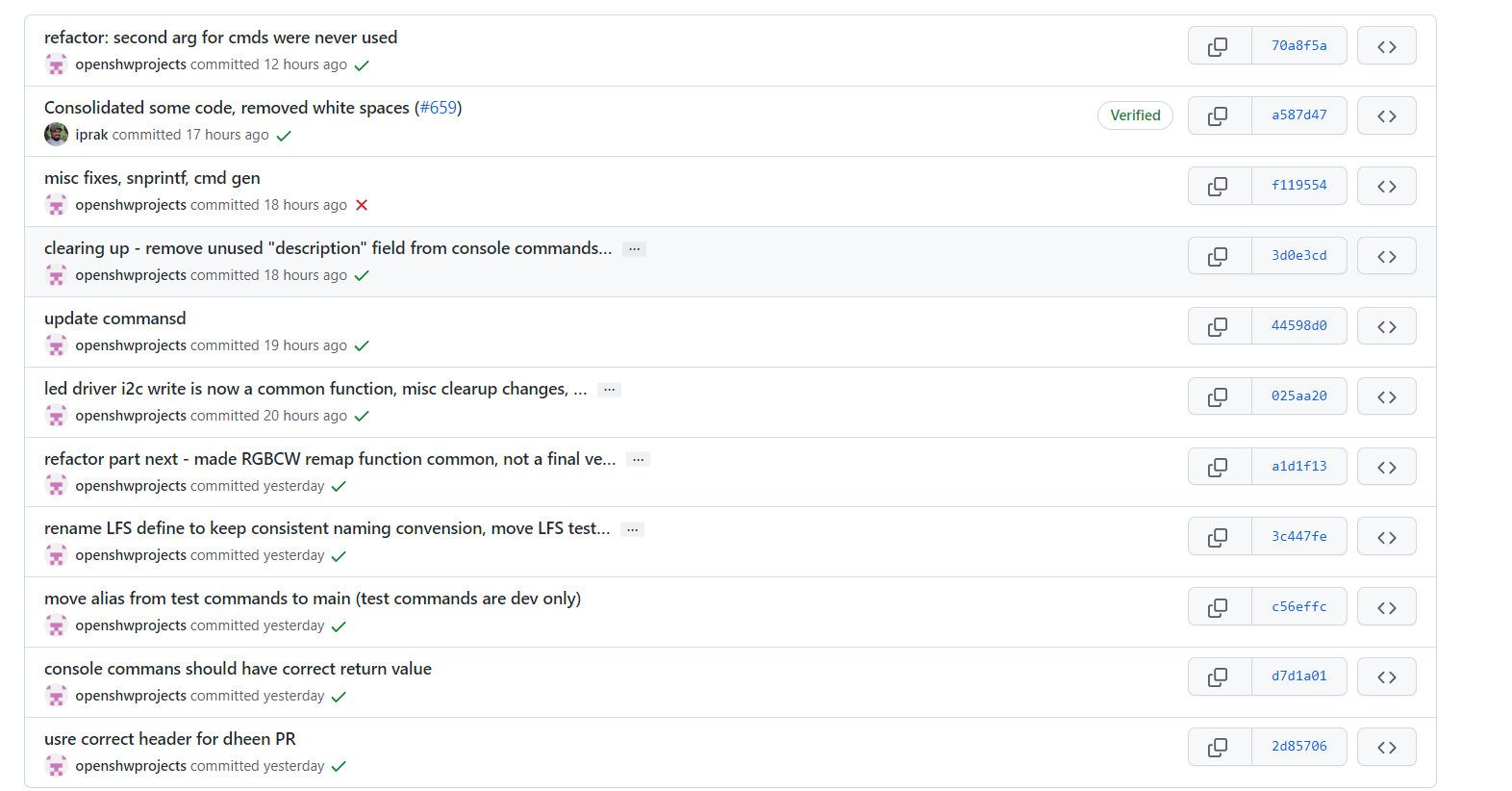

    Well, currently we have done a little refactor of I2C and LED drivers and reduced binary size for all platforms. No new features, just a maintenance work:

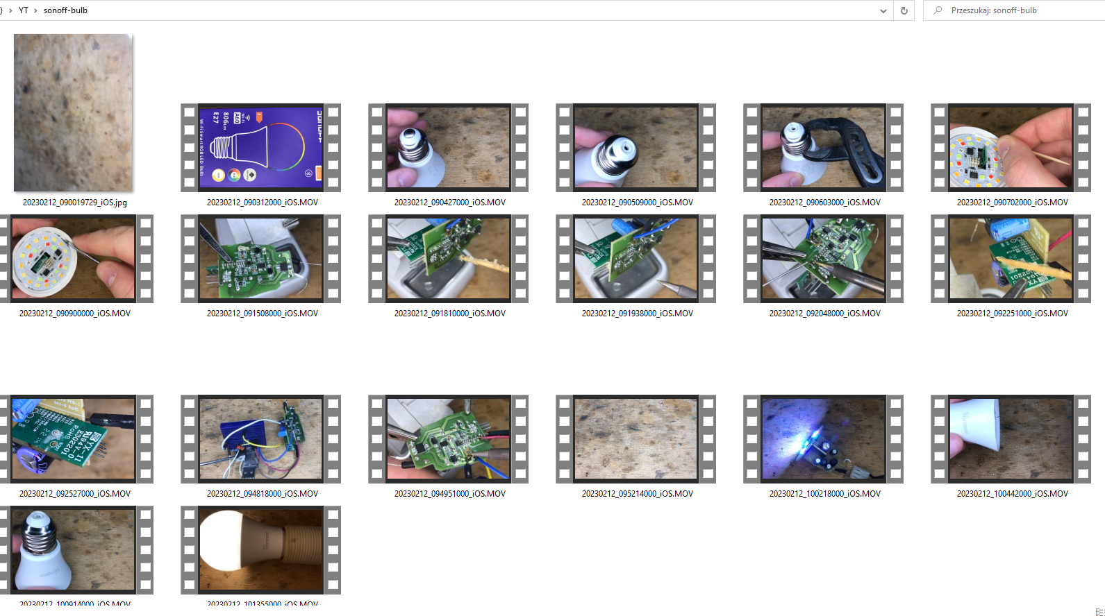

    Okay, we have started working on YT video featuring a Sonoff Bulb (a donation from one of the users), so far only recording part is done:
    I will also try to use this bulb to find out potential issues with LED driver.

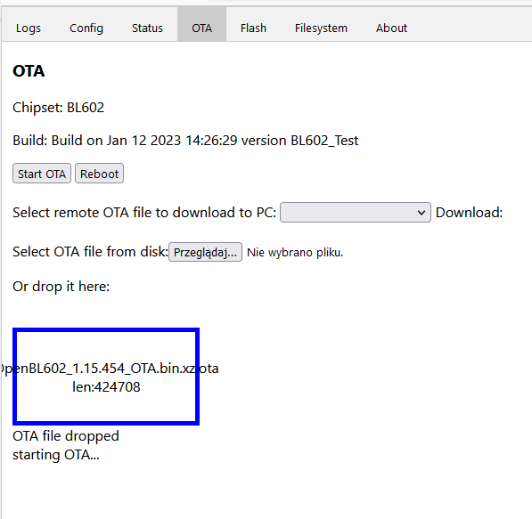

    What could be the reason that OTA is not working?
    There is info starting OTA ... and nothing more...
    Maybe im doing something wrong>?
  • #294 20443284
    Posts: 14770
    Rate: 12913
    According the commits history, the BL602 OTA was added on January 22 and you have build from Jan 12.

  • Duplicate MAC addresses and lost relay state after power loss
    #295 20443433
    nomek
    Posts: 446
    Rate: 34
    Yes, You are right.. probably i was blind yesterday.. :-)
    now is the newest Build on Feb 17 2023 06:32:35 version 1.15.454

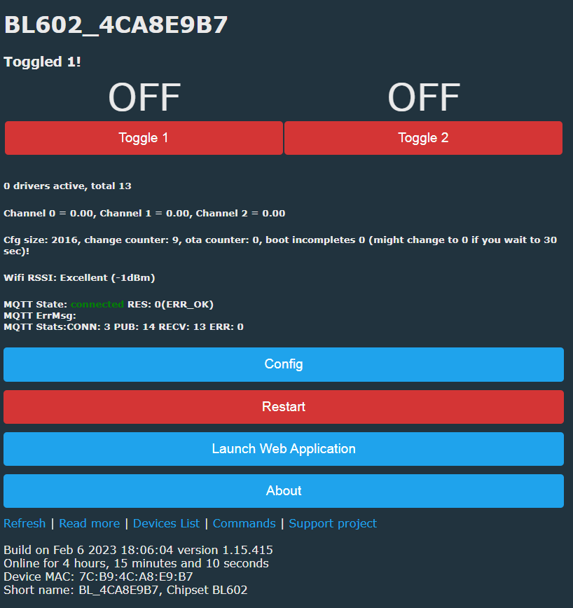

    Successfully flashed 2 devices but im facing the same MAC problem.
    Both starts with the same MAC (C0:50:43:C9:00:01) so without MAC change they cannot be both in the network :-( ....
    And one more - device should remember last Relay state - now after power down is always OFF.

    SSDP driver on BL602 is enabled (DDP for xLights as well)
    In short startup command do "startDriver SSDP", Windows will now detect your device:
