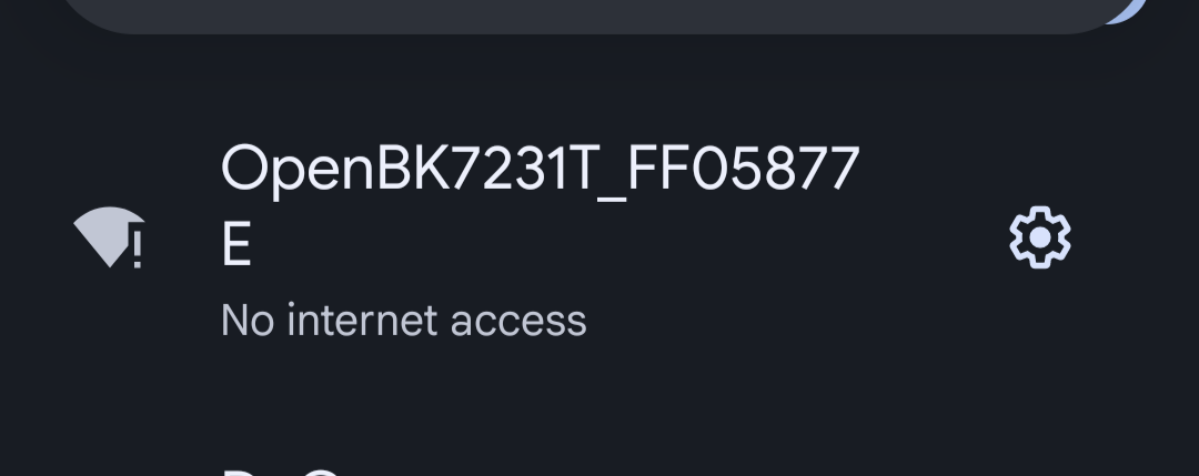

    hi, ok did and I see it as AP on my phone....
    Phone message indicating no internet access for Wi-Fi network OpenBK7231T_FF05877.
  • #68 20857267
    Posts: 14755
    Rate: 12881
    So it's not dead, connect to it and configure your WIFI SSID/password, hm

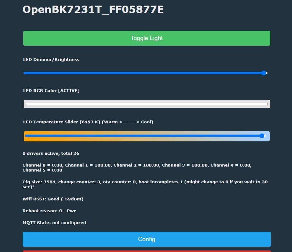

    soldered wires, connected to uart to usb device, hooked up to my pc ... and it right away showed connected to the wifi, signal GOOD, etc..
    can no problem get to it from my pc:
    Screenshot of OpenBK7231T interface with LED settings control.
    now back to experts to tell me :) but I suspect something on those white boards that this WB3S is connected to is just a crap?

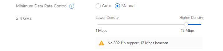

    OK, before I revert the change on my wifi as described in above post, I went on and turned on the lights I have not modified\flashed... and I was able to add with the same wifi ssid two lights to my wifi on original firmware, almost right away. o.O
    So for others out there.... I have UniFi Dream Machine Pro here with U6-LR APs.
    When WiFI network is created, the "Minimum Data Rate Control" is set to AUTO and well... allows 802.11b support. But you do not want that. I did not even realize that it was like that in a first place, but investigated differences when, with UART2USB device it was added fine to wifi on the custom firmware, but when connected to mains it was not. I will later today revert the changes on the wifi to "allow" it to do "b" again and see how my flashed device behaves, and will update what happens.
    When you change to MANUAL and modify for 2.4GHz the Density to 12 Mbps it will disable 802.11b support.
    Those lights default to 802.11b if I guess AP allows it, and here you go I went thru hell to figure it out :)
    I will be flashing them all as I want to get them anyways on my HA and have it not talk to China :)
    @p.kaczmarek2 it was an honor to work with you on this one, but dont go anywhere as more questions to come about other stuff haha. I've learnt a ton and I have a ton more to learn with this new firmware :) You are the best :)
    the two wifi I test with have no 5GHz enabled on them at all, just 2.4GHz.
    Added after 1 [hours] 7 [minutes]:
    OK I confirmed that if I allow on my UniFi network in WiFi settings support for 802.11b, even with a device flashed with OBK firmware it will not connect to my wifi.... while the device is connected on the mains.
    Here is a configuration that works for me:
    Screenshot of WiFi minimum data rate control configuration with manual setting at 12 Mbps.
    so in short... don't do AUTO. Make it Manual and slide to 12Mbps.
    FYI

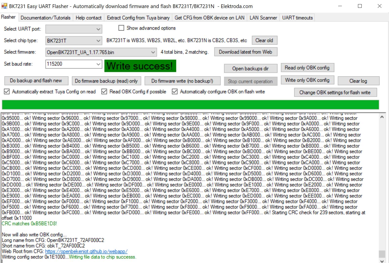

    EDIT...I got it to work but I don't understand why.
    I flashed it again but unchecked the "automatically configure OBK on flash write". This time my phone did not get the no internet connection error but the phone never switched into the config screen like Tasmota usually does. I manually typed 192.168.4.1 into a phone web page and I am now at the config screen. I entered my SSID info and then pulled it up with my local address.
    Next go to the configure module tab and enter the following:
    P6: PWM/5
    P8: PWM/4
    P9: PWM/1
    P24: PWM/2
    P26: PWM/3
    Now the light should work and be controllable from its web address page.
    I also like to have the light turn back on to its last previous state when I flip the wall switch or if there is a power failure so check flag 12 on the configure general/flags screen.
    I hope this helps someone or at least I will have it document for myself if I ever get another pack of these lights.

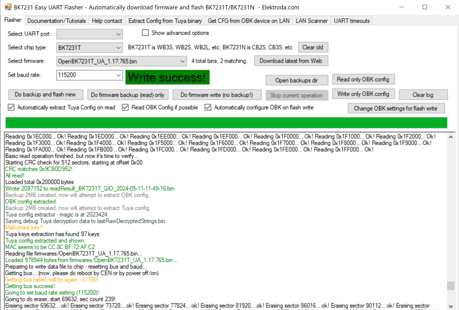

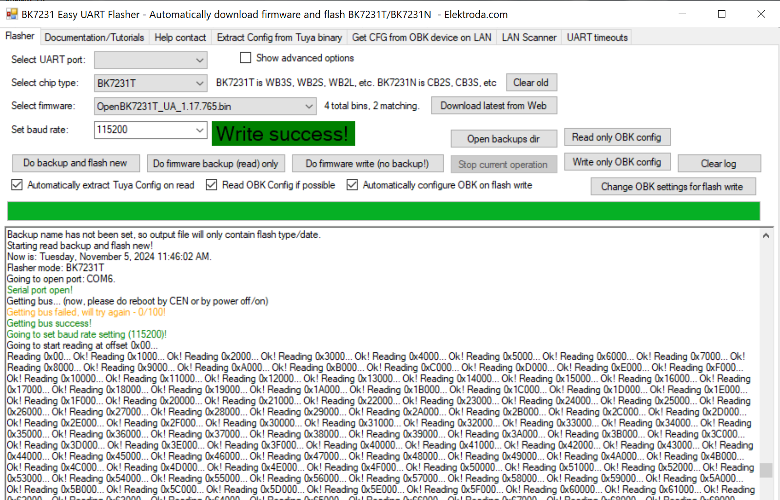

    I'm looking for some help. I purchased a 6 pack of these and never installed them. I now have time and wanted to get all 6 flashed and operational.
    I flashed one of these almost 2 years ago (post #12 in this thread) and it is still working fine. I can access it through a web address and control all of the config pages. Obviously, this was flashed with an older version of the tool and the firmware than what is available today.
    Today, I went to work on the rest of the 6 pack and I successfully flashed one with the recommended online tool. It successfully reads, erases, and writes the new firmware. I disconnect the light from the PC and hook it back up to mains and I am getting the AP (Open-BX7231T_xxxxx) on my phone. I click on it and it successfully connects but then I receive an error message of no internet connection. So, I am never getting the initial config page to enter my SSID info.
    Any ideas?
    Screenshot of BK7231 Easy UART Flasher showing successful firmware write. Screenshot of BK7231 Easy UART Flasher tool with a successful write message. BK7231 Easy UART Flasher interface with Write success! message.
