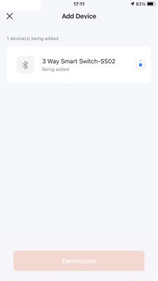

    This little button is used to enter pairing mode:
    [BK7231T/WB3S] Treatlife SS02 FCC ID 2ANIFSS01) 3-Way-Smart-Switch
    I paired with the Tuya app, there were no problems.

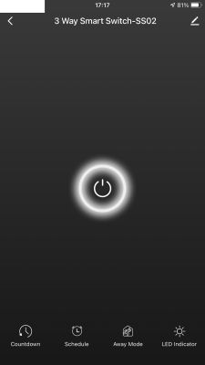

    In the application, it is striking that Tuya does not know whether the light is on or not - and yet it could be checked on the basis of the initial states of the switches (with the appropriate connection of the wires marked as "traveler")
    In the switch configuration, I also see some remnants of the functionality of an ordinary switch, e.g. the ability to combine the state of the LED with the state of the relay (or negate them), only what sense does it make if the second stairway has an unknown state to us?
    It would make sense if the application somehow paired two selected stair switches and would know if the light is on - but for me it didn't even show the light status ...

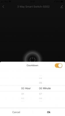

    Of course, you can also set a countdown, which after a given time simply changes the state of the relay to the opposite.

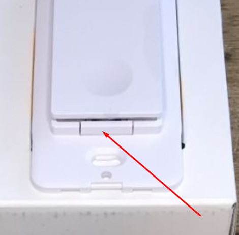

    It is enough to pry the housing, but you need to use some force. The hooks are very strong.

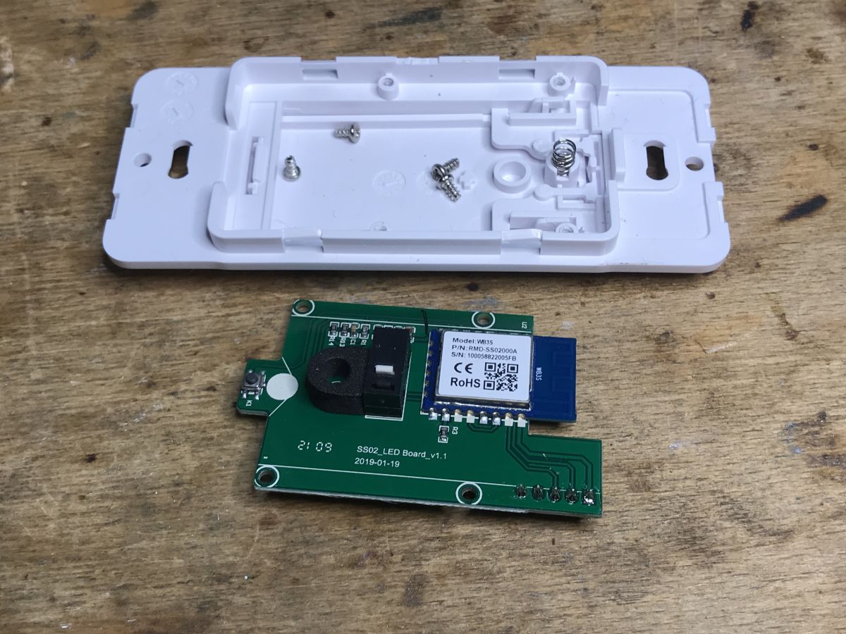

    Now the WiFi board:
    [BK7231T/WB3S] Treatlife SS02 FCC ID 2ANIFSS01) 3-Way-Smart-Switch [BK7231T/WB3S] Treatlife SS02 FCC ID 2ANIFSS01) 3-Way-Smart-Switch
    You need to unscrew some screws. Be careful not to lose the spring!
    Inside is the WB3S module, i.e. BK7231T. Classic. Fully supported.
